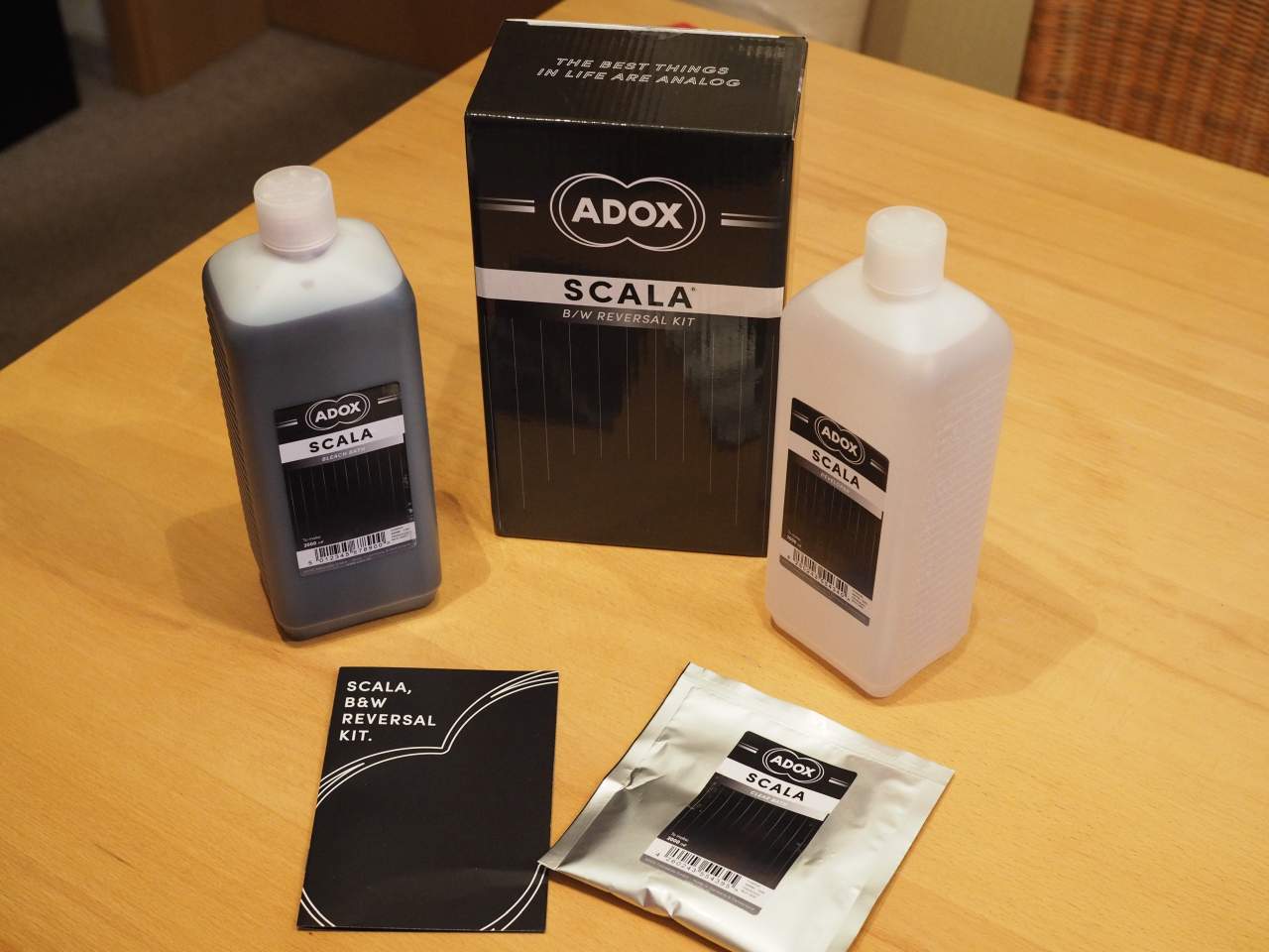

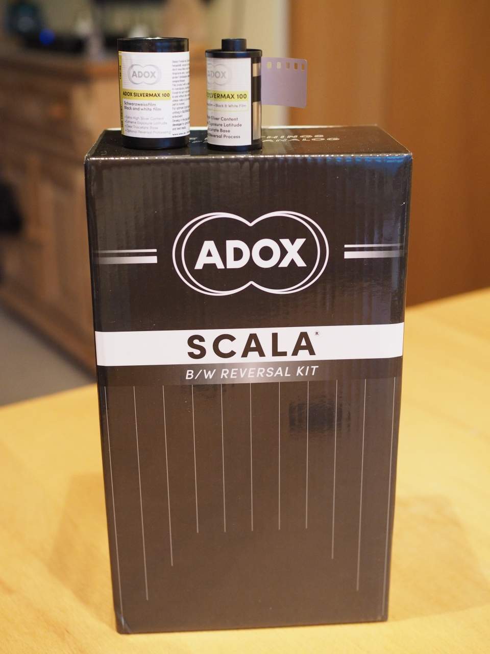

I'm at home and had a look at the kit. Indeed the bleach and the clearing bath packages say that they are not hazardous. The bleach is KMnO4 based, IMHO. I can see the distinct violet colour when I move the bottle and a thin film of liquid is running down the inside wall.
The guide is in English, only. Fine with me, but some German customers will likely moan about it. The chemicals show a production date around July. That corresponds with the postings by Team Adox, that they have been waiting for the packaging. It seems this kit had to go out in style, rather than in a plastic bag.
I'll attach some pictures:
