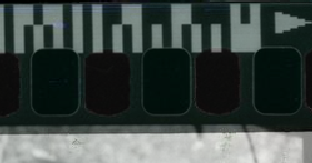

Out of my own curiosity I made comparison between Color Mission sprockets and HP5 sprockets:
The width is the same, spacing is of course also the same. The Color Mission film-film sprockets seem to be a bit more rounded as HP5 is more rectangle'ish.

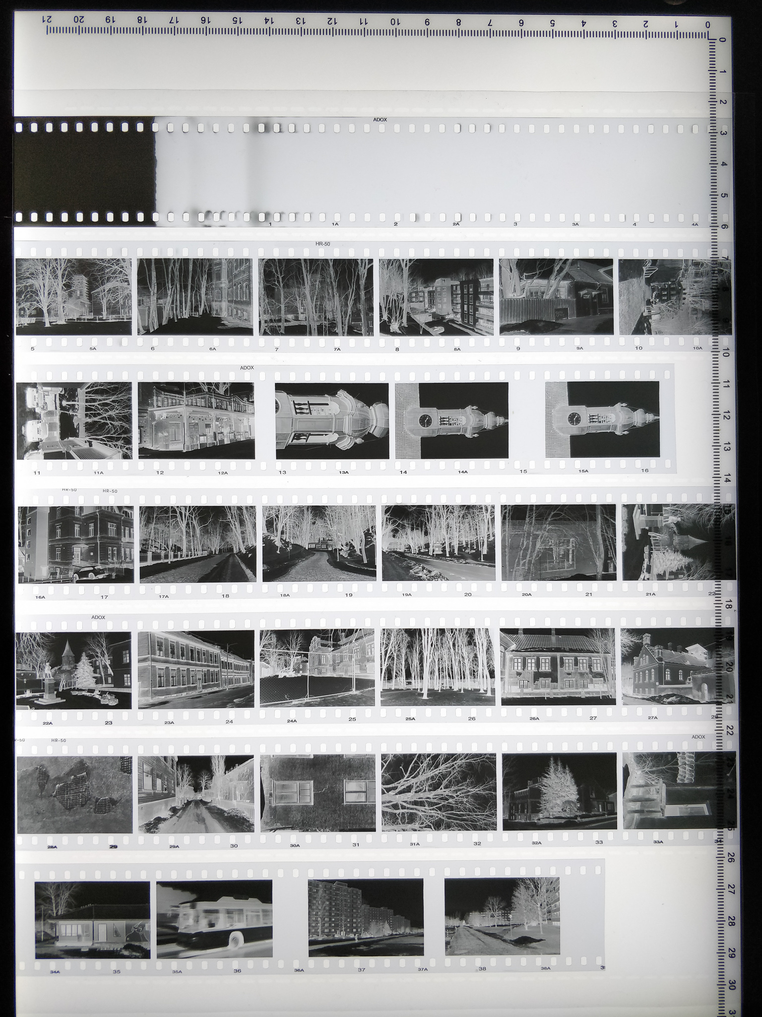

So I've just developed a roll of HR-50 with BH perforations. Results are not as bad as I feared, but still visible. On total I got 34 frames and had no overlapping frames. I also reviewed CineStill films I shot and so far overlapping frames appeared once in total of three rolls.
It seems to me, that the sensor sometimes does not count a perforation and winds the film one or two perforations two far. It could be, that BH perforations are 0.127 mm shorter (along film) than KS perforations, which then makes sense that the sensor sometimes misses.
Interested to see EOS 3 results as well.
