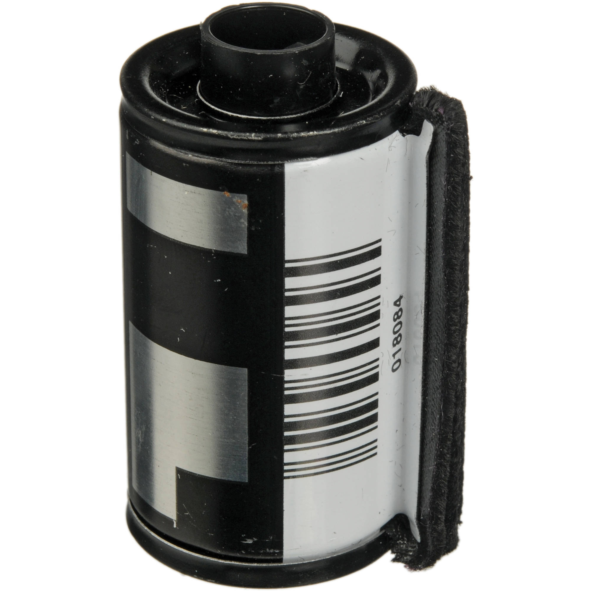

I'm in no way suggesting that this film has anything to do with Kodak. It's just that the cartridge is coded with the same DX number (not DX code!) as Kodak Farbwelt/Gold so automatic minilabs will adjust filtering accordingly. But as Jörg wrote not every lab seems to use this coding you find next to the DX code on all cartridges meant to be automatically processed.

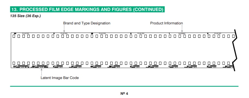

Most films have a barcode on the negative itself, that is used by automated printing/scanning labs so they know which color corrections to apply. This tells the machine what's the film type they're scanning. The settings are called a "channel" in their jargon.
Long ago, Kodak engineered most of their films to be "printed on the same channel than the Kodak Gold films", that means, that many different color Kodak films will require identical corrections.
The only thing we know is that ADOX chose to print on their film a barcode that tells any automated minilab "use the same corrections as if this was Kodak Farbwelt 200". It doesn't mean anything else. It just means that the corrections for printing Kodak Farbwelt 200 (the "channel") will be OK for Adox Color Mission. Again, there are MANY films that will work fine on such channel.
Why didn't ADOX create its own new code? Because that would mean that an automated minilab, most likely, won't have that new code, and won't know what to do with the film. Using an existing code means increasing the chances for the regular user to get better prints (or scans) from a minilab.
In short: I wouldn't read too much into it.

The talk here is about the code printed on the canister. I really wonder what minilabs read this code and adjust scanning parameters based on this. AFAIK Frontiers/Noritsus don't...
If this film cassette code is what is being referred to,
then this has no bearing on how the film is scanned. Bear in mind that used cassettes from various film brands can be reloaded and a sticker put over the original name, logo and details.

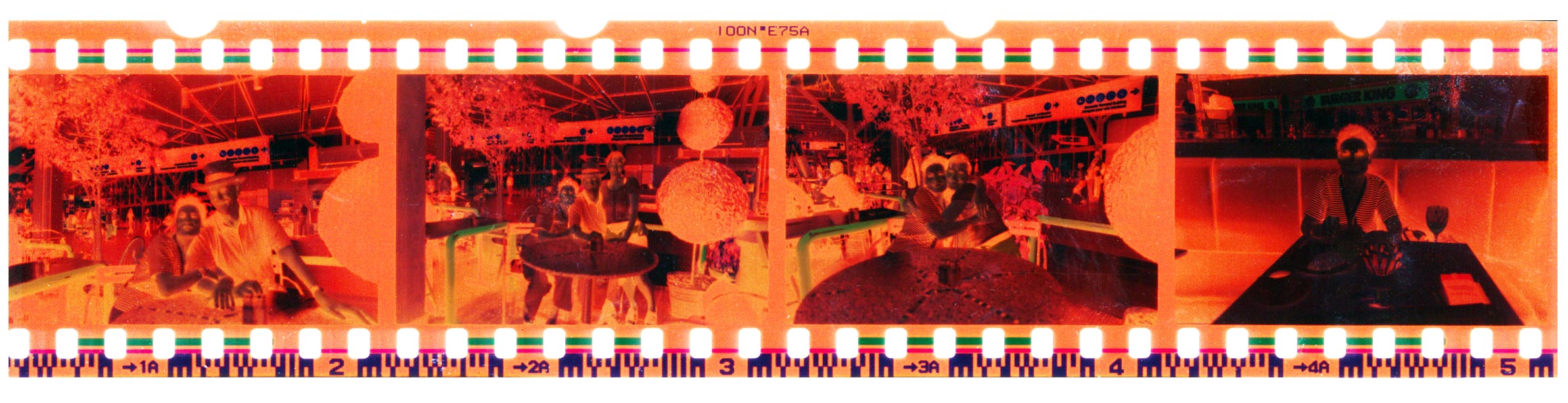

The lab film scanner will read the barcode on the developed film. This sample, below, has the Fuji red and green line-markings on the top and bottom.
On the bottom is a set of barcodes that identify the film and the frame numbers for the lab scanner.

If the film has no barcodes, then the lab film scanner will use a unichannell for colour and density and impose its own frame numbers.

Oh! Thanks for the clarification. I thought they were talking about barcode in the film itself!!
The code in the canister, IMO, is meaningless, i guess they're sourcing the canisters from elsewhere...
Probably just a generic code for labs to use.
This is the correct answer. We had to chosse an existing code which is close and already set in most machines. As you can see we deliberately printed it on the new stickers which we use to overlable the casettes. We will continue to use different casettes btw. which have a printing underneath the sticker. This has also nothing to do with Color Mission. These casettes are simply in stock. Also this code is to my opinion only used to sort films into the C-41 process as opposed to E-6 or B&W.
