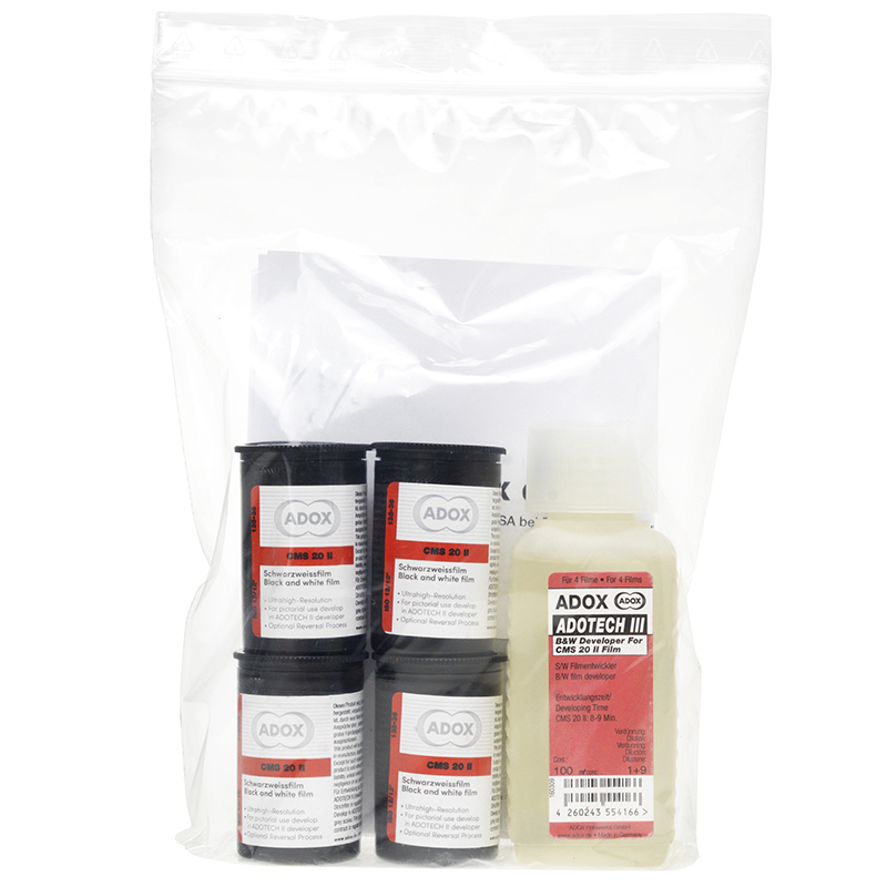

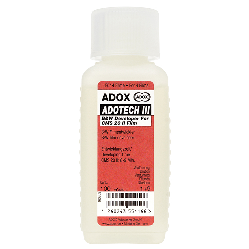

Have you ever loaded a sheet of 4x5 film into a 35mm camera? OK it´s most likely going to give what the Germans call film-salad but with our CMS 20 35mm film you can achive the resolution of 4x5 in your 35mm camera. This beats by far ANY digital camera even medium format backs.
With the new ADOTECH III developer this will be now simpler than it ever was. Many improvements have been built into the third generation of this chemistry:
- Even less likeliness to cause turbulences in large homogenoeus grey areas
- Much better keeping properties. You don´t need to refill the concentrate with water and do kryptic math each time you redilute it. Also the working solution now keeps up to 4 weeks which does not require the development of two rolls at a time in order to get full yield.
- ADOTECH III can be diluted in a higher dilution to mix the required amount of working solution for larger tanks
We are delighted by all the advantages of this new version. Highresolution Photography was never this easy to perform.
Introductory offer until May 1st 2016:
We sell the new 4 film kits at the same price per film than we sold the 6 film kits before.
https://www.fotoimpex.de/…/adox-cms-20-ii-13536-4-pack-plus…
https://www.fotoimpex.de/…/adox-cms-20-ii-rollfilm-4-pack-p…

Just making sure you saw this data sheet:
https://www.fotoimpex.de/shop/images/products/media/33535_5_PDF-Datasheet.pdf
You use the entire 100ml bottle to mix 1,000ml working solution. That appears to be the only dilution they publish.
1+11 is another dilution for 600ml.

BTW:
"... The content 100 ml is good in a dilution 1+9 for the preparation of 1000 ml working solution to process 4 CMS20 ... "
So you can develop 90x4=360 films with this single order.
:smile:
TheToadMen, I am now completely confused. The Adox instructions says 4 films from 100ml concentrate but goes on to say the correct dilution is 1+9 and this develops 4 films. I presume that the logic is as follows: If 100ml concentrate give a working stock solution of 1000ml and assuming you need a minimum of 250ml to develop 1 film and also assuming the developer is one shot then dump that does mean that 1000ml only does 4 films
The Adox instructions seem to be correct. This means that it is quite an expensive developer but in return for its price you get amazing resolution form 35mm film. I cannot work out how 360 films are possible
Thanks in anticipation of an explanation
pentaxuser.
Hi pentaxuser, I hope this helps?
{start of quote}
Processing of ADOX CMS 20 in ADOX ADOTECH III Developer (100 ml PE-HD bottle)
(ADOTECH III has improved keeping properties over ADOTECH I and II so the refilling of the bottle with water has become obsolet. Instead of this we recomend the use of protective gas or squeeze the botle in a way that no air is left inside)
Processing of 2 films in 500ml of working solution (Jobo Tank)
Mix 500ml from 50ml of concentrate.
Dilution 1+9.
With the working solution of 500m 2 rolls of film (120 or 35mm) can be processed (one after the other).
The overall capacity of the 100ml bottle is thus 4 rolls of film.
Increase the developing time by 10 to 15% for the second roll to be processed in the working solution.
Developing time 35mm film exposed to 12 ASA, dilution 1+9, 20°C: 8 Minutes.
Developing time 120 film exposed to 12 ASA, dilution 1+9, 20°C: 9 Minutes.
Developing time 35mm film exposed to 20 ASA, dilution 1+9, 24°C: 7 Minutes.
Developing time 120 film exposed to 20 ASA, dilution 1+9, 24°C: 8 Minutes.
If stored in a completely filled (no air left) glas bottle the working solution can be kept for 4 weeks
Thus you do not need to process the second roll of film on the same day like with ADOTECH II.
Processing of 2 films in 600ml of working solution (Various Tanks)
In case your tank does not fully cover a rollfilm with 500ml you can dilute the developer higher (1+11) in order to get 600ml of working solution.
Your developing times need to be adjusted in this case.
Developing time 35mm film exposed to 12 ASA, dilution 1+11, 20°C: 10 to 10,5 Minutes.
Developing time 120 film exposed to 12 ASA, dilution 1+11,20°C: 11 to 11,5 Minutes.
Developing of 15 sheets of 4x5 Film in 1000ml of working solution
Mix 1000ml of working solution using the entire bottle of 100ml.
We recomend for sheetfilms tray development with a constant sligth agitation.
Tilt the tray gently from each side (not just from one side).
Process each sheet separately. After the 8th sheet the developing time needs to be slightly increased by 10 after the 12th sheet by an additional 5% (yielding a total of 15% to the standard developing time).
Developing time sheetfilm exposed to 12 ASA, dilution 1+9, 20°C: 9 Minutes.
{end of quote}
It's explained in their datasheet "ADOX CMS 20 Ultrahigh-Resolution-Film", see: https://www.fotoimpex.de/shop/images/products/media/58675_5_PDF-Datasheet.pdf
