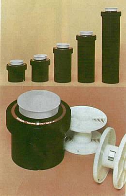

Matt. Which version of tank did I end up getting from you? The System 4 or Super System 4? It looks like the Super, but I don't know what the old one looked like.
You have two of the "Universal" version of the Super System 4 - they have the Tupperware type lids.
Here is a poor image of the older System 4 tanks - actually the 4th version of the tanks. They were discontinued in 1981:
