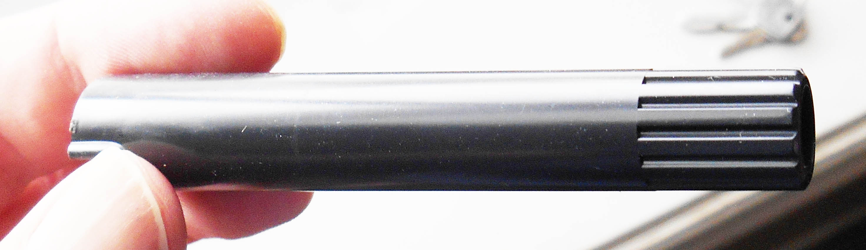

Question. I have this part that looks like it fits in the funnel section of the Paterson tank. What is it used or needed for?
Yes. it goes into the funnel and engages the reel. It's for agitation. You spin it gently.
I supposed that is only when you dont want to invert the tank with the cover on? What procedures would be needed to spin instead of invert?
I supposed that is only when you don't want to invert the tank with the cover on?
I don't invert the Patterson tanks but you certainly can. I don't even use the swizzle stick very much. I usually just pick the tank up and make a kinda wobbly figure 8 motion.
Bringing up a related topic... I stopped inversion and started using “spin-gently” agitation. Two back-and-girth’s (about 5 seconds) every minute. I get good results in all processing scenarios: single 120, single 135, and double 135... and no leakage, drips or spills.
Paterson's instructions say to use the swizzle stick only for the first short portion of the development, because if you use it for the entire time you may end up with uneven development.
