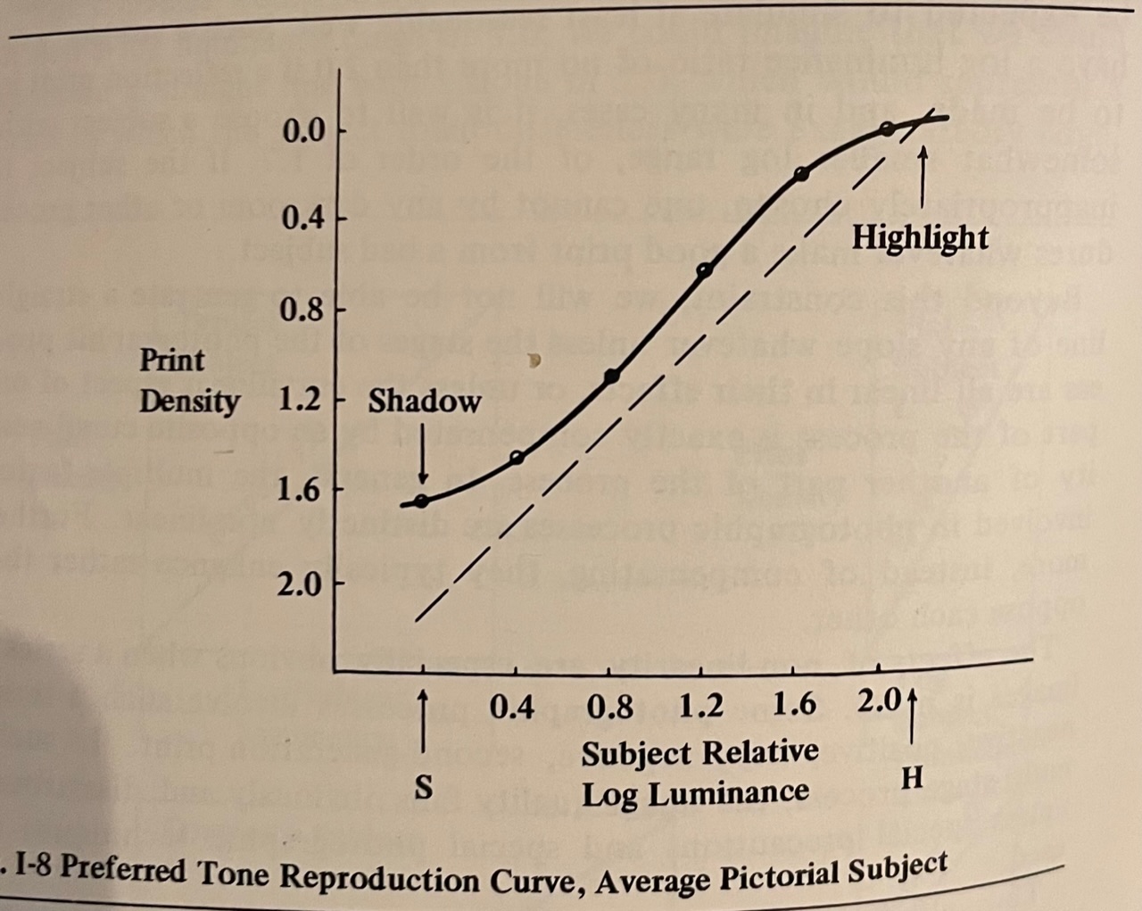

Using the zs presupposes that fitting a long Subject Brightness Range (SBR) or narrow SBR onto a fixed scale (so that the tones will map according to the "Visualization") is "good".
But it means that the mid-tones will be distorted, and no longer "map" at a 1:1 ratio to the scene. This is easily noticed, and such prints from "expanded" or "contracted" negatives will look unnatural and contrived. You may want to consult this:
Most relevant passage:
Although photographers speak of "important highlights" and "important shadows," for the most part it is actually the middle tones which are most important of all. Middle tones are, of course, the range of grays between highlights and shadows. Stated differently, middle tones of a negative or print are those densities which are not associated with toe or shoulder areas of the characteristic curve.
It has been found through a series of comprehensive tests that for the great majority of scenes the middle tones should be reproduced at a gradient of 1.0 on a tone reproduction curve. This curve is a plot of densities in the print versus the logarithms of the luminances or "brightnesses" of corresponding areas in the scene. A gradient of 1.0 means that if there is a 10 percent difference between two tones in the scene, then these same tones should be reproduced with a 10 percent difference in the print. Generally speaking, the middle tones should be reproduced with a gradient of 1.0, even if this can be done only at a sacrifice of gradient in the highlights and shadows.
In other words, the majority of people want the middle tones of the print to reproduce most original subjects as closely as possible, regardless of the lighting conditions that prevailed when the pictures were taken. To do this, all negatives should be developed to the same contrast or gamma for the same printing conditions and paper grade.

By the way, the quoted material in your recent post is from before the change in the ASA speed standards, so no doubt is influences by the greater safety margin built into that standard than the one that has been in place since when I was four years old.

The change in film speed has no effect on the discussion from the Kodak book, by the way.
Augustus - it is not the right of that book or article you quoted, or anyone else for that matter, to decide for another person which tones in an image count the most. In fact, I treat every single image as it's own case, worthy of printing in any manner I personally feel is best, and don't apply any procedural rubber stamp to any of it. And I really don't care what "most people" want (with "most" itself being a presumptive assertion). Most people are poor photographers, and don't print at all.

I think you have misunderstood the Kodak text. This was the result of a large experiment conducted over many years, and the results are explained in that text. This book was intended for professional photographers (portrait and commercial), and thus it offers guidance for them to produce "professional" results as expected by their clients. Thus it certainly does matter what observers prefer. And that is the basis of their recommendations, namely, that mid-tones are the most important of all. I happen to agree. Your attitude is not uncommon, and I understand what you mean, but I can easily detect zs contrast manipulation in a print. It just doesn't look "right". What if you wanted to photograph a plain wall, all uniform in tone? Would it be "artistic" to manipulate it so that it had a pure white and black? What would that achieve?

@Augustus Caesar
The Kodak passage describes this tone reproduction curve and asserts all negatives should be developed to match this curve in the finished print.
Before the Zone System was introduced it threw shade on its main premise. It overtly disparages “expose for the shadows and develop for the highlights”.
Sure, the study is an amazing body of intellect and it informs all the photolabs who develop film to match that curve. And the study is behind all Kodak advice to amateurs. It’s right.
But so is Ansel Adams’ Zone System which has has been taught over the years in books, schools and workshops and is practiced by “a vast majority” of black and white photographers who want to make fine art prints.
