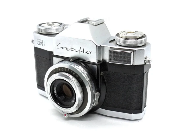

1/300 sec @ F/16 on a Nikon with an FP shutter will give less exposure than 1/300 sec @ F/16 on a Contaflex with a leaf shutter.

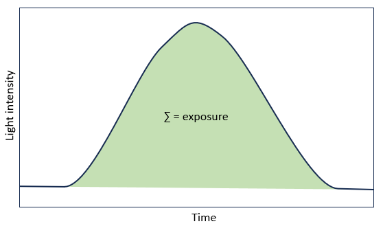

A focal plane shutter will expose the film at short exposure times by moving an open slit across the film plane (vertically or horizontally). Since the shutter is close to the focal plane (what's in a name), there's virtually no intermediate zone between open and closed shutter. Each spot on the film/sensor virtually instantaneously 'sees' light as the slit arrives and then goes dark again once the slit leaves that spot. The light flux intensity vs. time plot would look something like this:
For a slow speed, the above plot will also be true for a leaf shutter. Take e.g. a 1 second exposure: the opening of the shutter leaves is virtually instantaneous in relation to the long overall duration of the exposure, and the process of opening and closing of the leaves won't affect the exposure much. It's different for high speeds, where a leaf shutter will start to show this kind of behavior:
Keep in mind that what matters is how much actual exposure each bit of the film/sensor receives: the green area underneath the plot.
Now, in your post, you seem to make an assumption of the shutter speed being the time the shutter starts to open and finishes closing. I don't think that's accurate, because shutter manufacturers have been aware of the above issue for over a century, and they figured out long ago that in order to maintain reciprocity between exposures (i.e. a 1/500 exposure is really half as much as a 1/250, which in turn is half as much as 1/125, etc.), they would have to take into account the opening and closing of the aperture blades. Consider this:
The actual shutter speed for a fast time on a leaf shutter will not be T2a-T1a, but rather T2b-T1b. Of course, there's the practical challenge of actually making getting this exactly right in a small mechanical device that should function reliably for decades under adverse conditions, but decades and decades of innovation in mechanical engineering have resulted in rather reliable mechanical leaf shutters that do reasonably well up to reasonably fast speeds.
Now, the problem with the aperture is that if the aperture is extremely close to the leaf shutter (it's evidently never close to a focal plane shutter), a very small aperture opening (large f/number) would block a large part of the light falling through the open shutter. This would result in small apertures (large f/numbers) giving relatively more exposure (not less, as you suggested) at such apertures compared to shooting wide open. However, in a practical design, the aperture is always a little bit offset from the shutter (which optically is a compromise of course) - and even a little bit of distance between a small aperture and an open shutter will still allow a whole lot of light to pass through and reach the film/sensor.
So, to the extent your argument has theoretical merit, it's in the opposite way of what you suggested.

@koraks The bell curve of exposure with a leaf shutter is well known and can explain why digital measurements of shutter speed are less reliable with a leaf shutter at its higher speeds.
But the real quandary is that at smaller apertures, the shutter which is trying to open and close fully in 1/300 second... is going to seem "fully open" instantaneously at f/16 (and then waits til the end to shut immediately). While at f/3.8 there is a bell curve exposure.
Nothing I know can really measure this except to say wide open a high speed leaf will be nominal and at small apertures the leaf shutter will nominally provide a greater exposure due to lack of bell curve.

I know we’re both saying the same thing small aperture gets greater integrated exposure. But the words of our explanations are not clear.
You can’t accurately measure the high shutter speeds of a leaf shutter without characterizing the chosen f/stop(s) for the test(s). So I’ll try again to say the same thing you’re saying.
The smallest aperture would have this curve. It seems to open immediately and seems to close immediately. It gets full exposure the full time of the travel.
The widest aperture would have this curve. It opens relatively slowly and closes relatively slowly but in the same travel time. It doesn’t get as much exposure.
