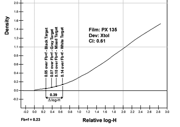

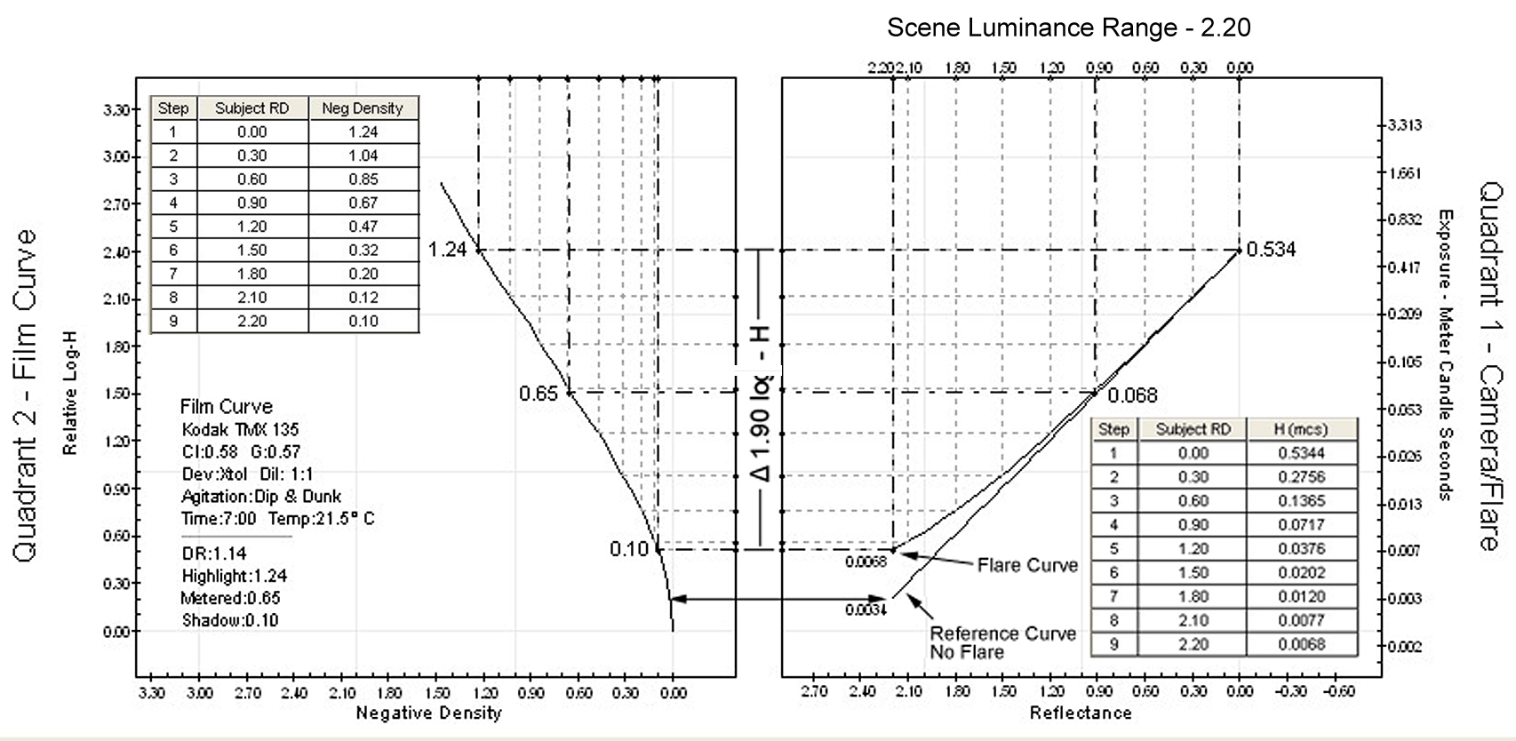

Let me be more precise on flare. Veiling flare is an overall non-imaging forming exposure that compresses the shadows and comes primarily from the luminance of the scene interacting with the optical system of the camera. The average flare for a statistically average scene is around one stop. It can be higher or lower. A stop flare adds a stop exposure to the shadows, changing the placement of the shadow exposure and disproportionately compressing the shadow values. It effectively takes a 7 stop scene and reduces it to a 6 stop illuminance range at the film plane. This is a part of defining "Normal" development.
I did a flare test where a "black box" target was created. A hole was cut into a black velvet lined box. A hood surrounded the opening to reduce extraneous light from entering. Cards of single tones and mixed tones were used to surround the opening and introduce flare. It was shot on 35mm film. An exposure was determined. After the test a sensitometric exposure was place at the end of the roll. The resulting values from the test are placed onto the film curve.
Now, this just shows the change in shadow placement caused by flare and not the compression.
