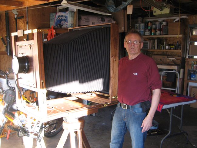

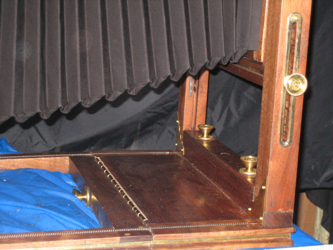

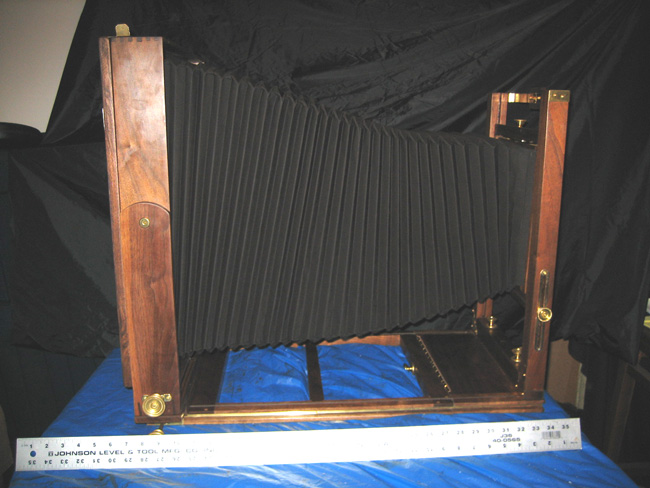

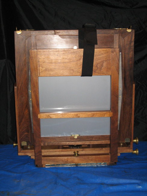

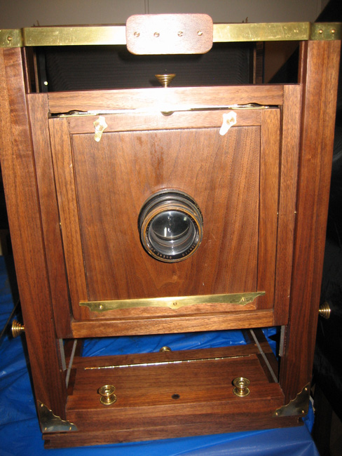

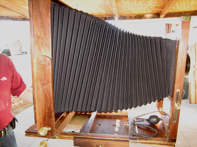

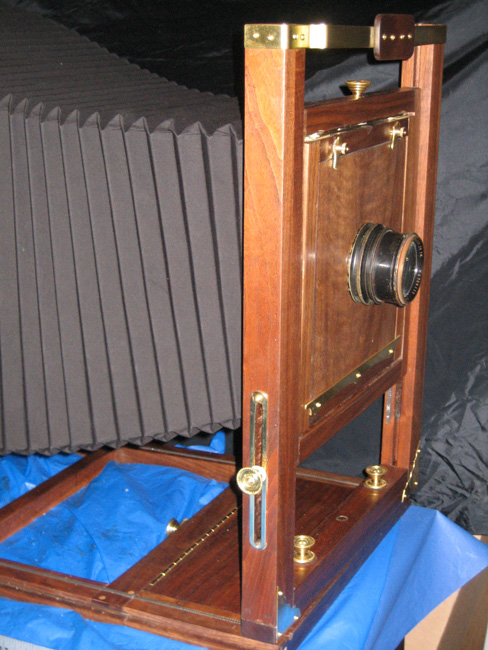

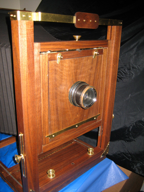

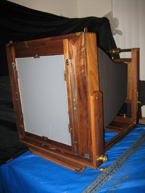

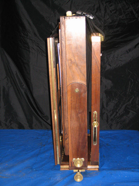

Okay, here it is in all of its glory! When you build any camera there are things that just take time. This weekend was a long one and we managed to get the camera done but we were not able to expose any film. Just to tired and ran out of time and the wind came up. I still have some adjustments to make and some refinements but I could shoot with it if I so desire. My good friend Matt Blais gets a lot of credit for months of help and putting up with my insanity. The camera came in at 22 LBS. My walnut tripod and Gitzo head with Matt's sliding tripod block make it very stable. Setting it up is slow, (ya think!) and I'm not going far from the truck until I get the rolling cart built. It came out very, very nice.

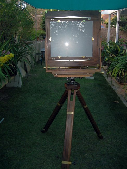

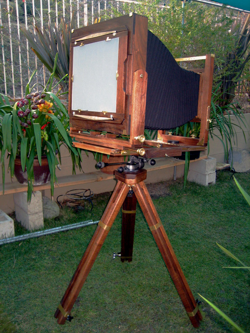

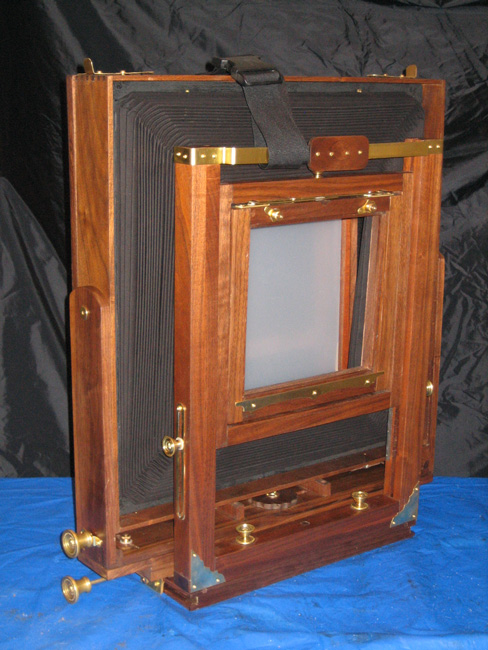

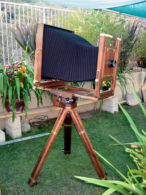

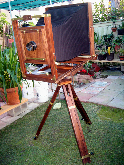

Here are some pictures of the 14x17 on the tripod I built for it and the 11x14. It is rock solid and we built a sliding tripod block which made it much easier to mount the 22 lb. camera on the tripod. The great thing about all this is that the camera works! When you build these things you worry about film registration and film planes, etc. We developed the negatives from the shoot and they look great. So after 7 months she is ready to go!
