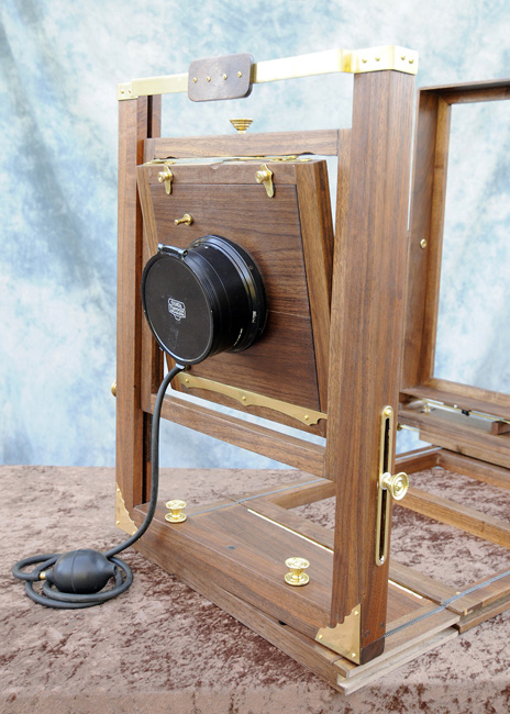

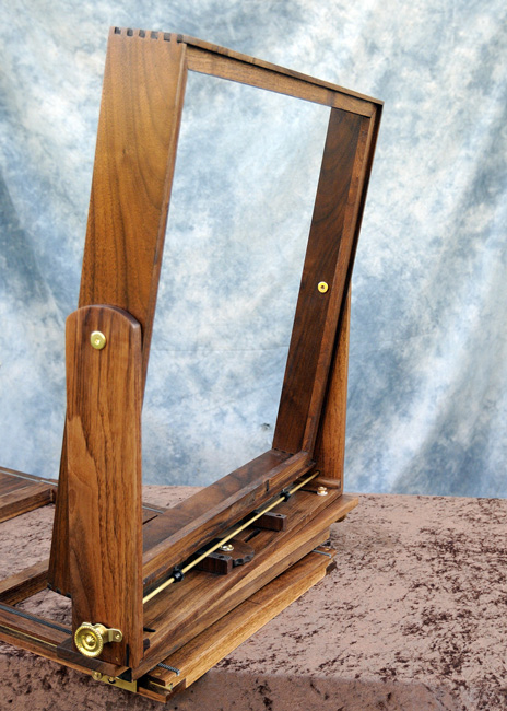

Time for a bit of an update. I'm going to start working on the back GG assembly. I still need the bellows from Custom Bellows but the rest is done. So far it weights 17lbs. This is without the back. I'm thinking it should come in at 20-22 lbs. As it stands now 30" without the extension. Front has geared rise and fall, tilt and swing. Back has geared tilt, swing and shift.

Curt, It is based on a Folmer & Schwing 11x14 that my friend Tri Tran has. I loved the look of the camera so I thought why not. The front standard does not move front to back. The back comes all the way up and the rail folds up.

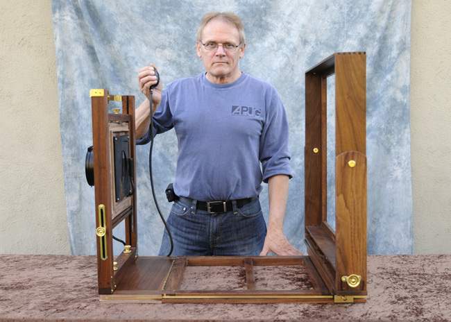

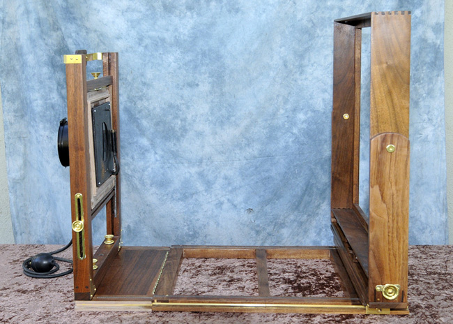

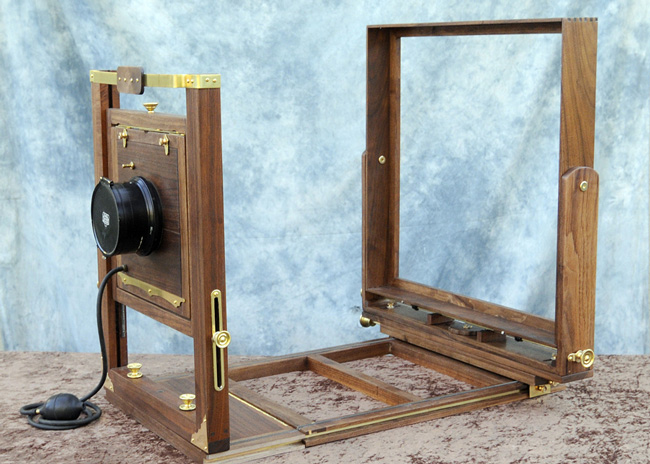

Jim Steel
Some recent photos .... good ones!

I saw the bellows yesterday at Matt Blais home where I had it shipped. I have to say the bellows is fantastic. They put it on my frames perfectly. It has 36" draw and compresses to about 1 1/2". It really puts the size of the camera into perspective when I see it. Going to do final assembly this weekend. I hope to set it up in downtown Riverside on Sunday for its maiden voyage!
