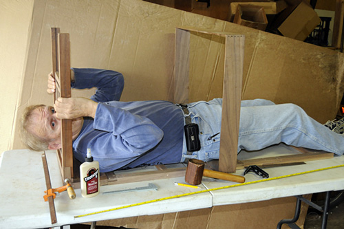

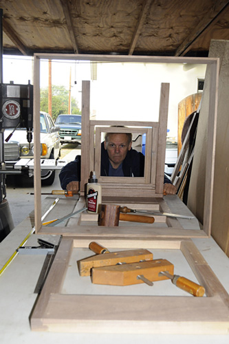

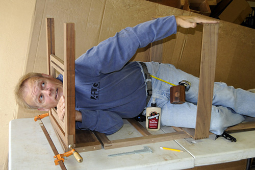

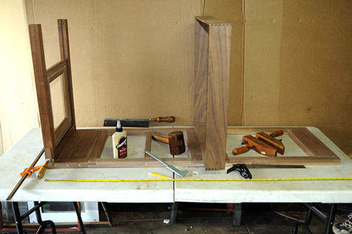

    Well, I finally got some images of the build of the 14x17. My friend and partner in crime on this project, Matt Blais was nice enough to take some pic's of the work in progress. Over all it will have 48" of usable bellows and I'm hoping to come in around 20lbs. or so? Yes the is yours truly inside! You can tell we are having fun! This is my third camera build and I learned that you need to have fun with these things.
    Jim
