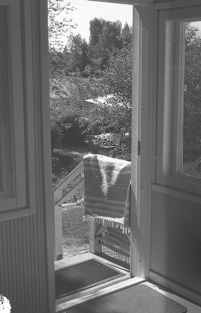

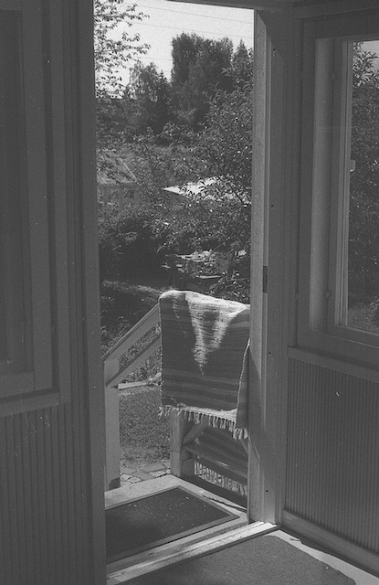

Here is some proof. Shot at 640 and 1280 EI and Rodinal 1+25, 12minutes. Full tonal scan (I know, I know) on Epson V600, no any adjustments.

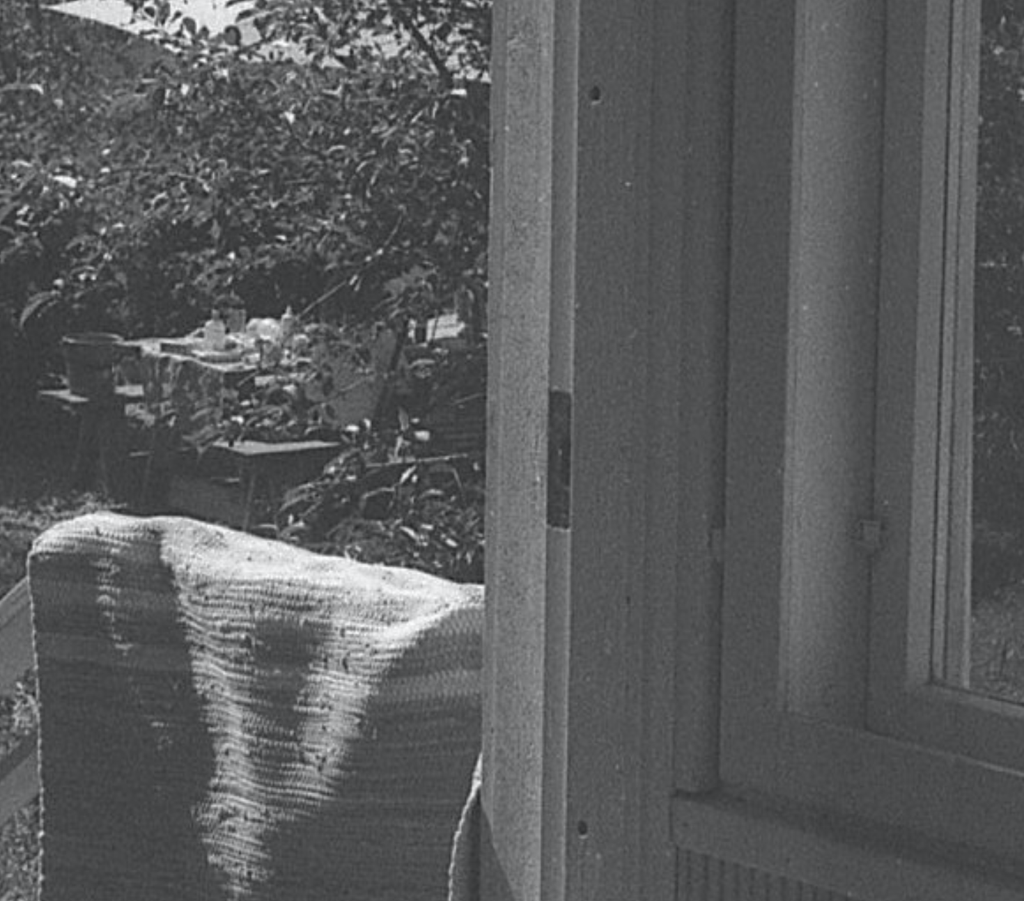

close up:

The highlights on EI 640 were so dense that the scanner couldn't handle it. I actually don't know if the un-adjusted settings crank the output levels to the max or not. But that is not important..
