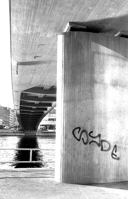

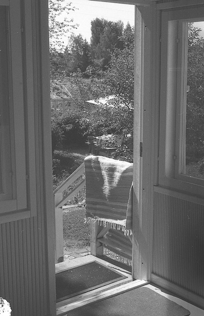

.. and here is EI 160, Rodinal 1+25, 7 minutes, (scan, contrast adjusted):
Nothing new under the sun.. I mean bridge?

Yeah but we have to find out what is problem with my Foma 400 which is always said to be grainy and shouldn't never be developed in Rodinal.

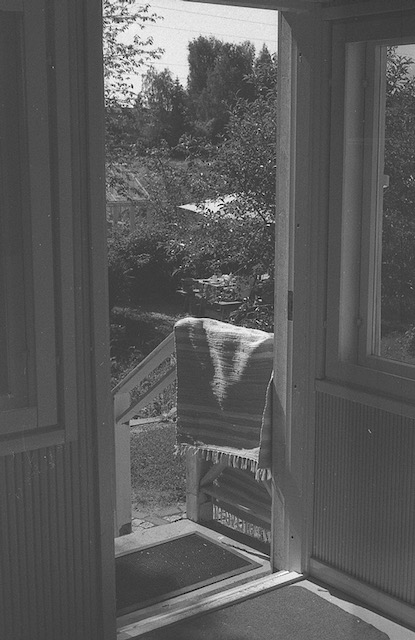

Here is some proof. Shot at 640 and 1280 EI and Rodinal 1+25, 12minutes. Full tonal scan (I know, I know) on Epson V600, no any adjustments.

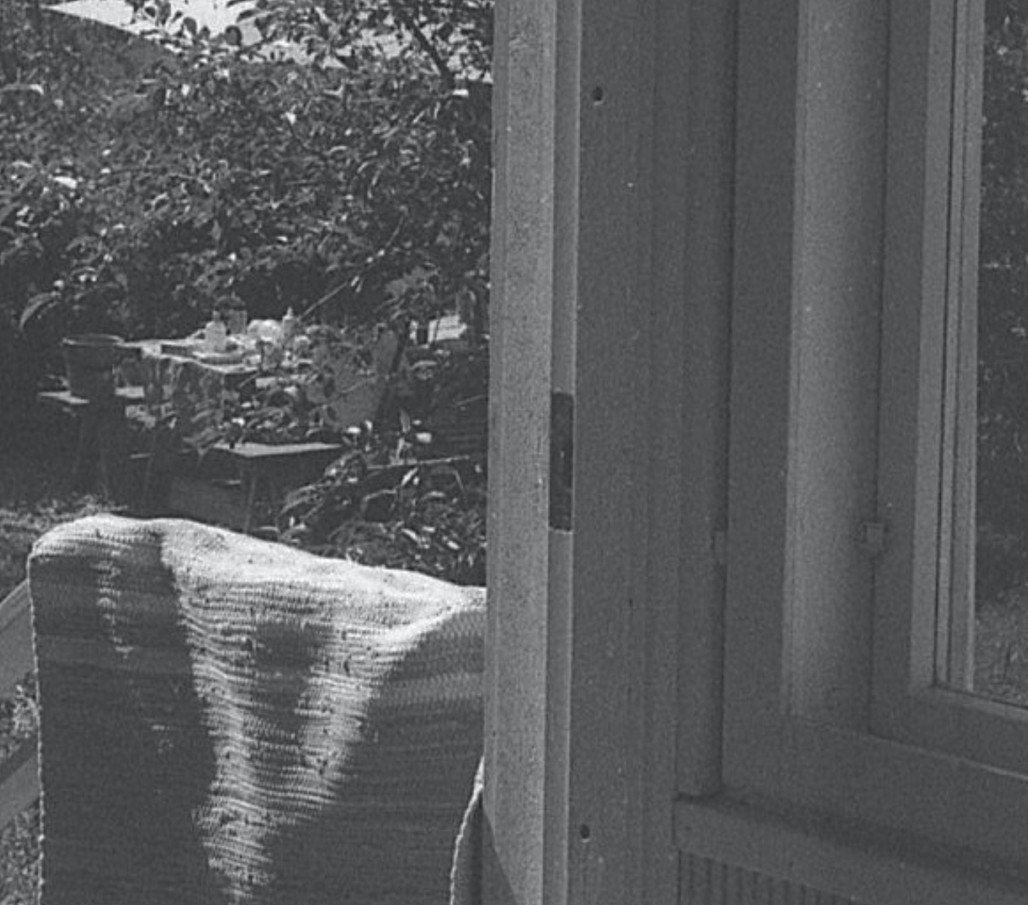

close up:
The highlights on EI 640 were so dense that the scanner couldn't handle it. I actually don't know if the un-adjusted settings crank the output levels to the max or not. But that is not important..
those look really soft / underdeveloped.
the bridge one looks "right" but these one dont

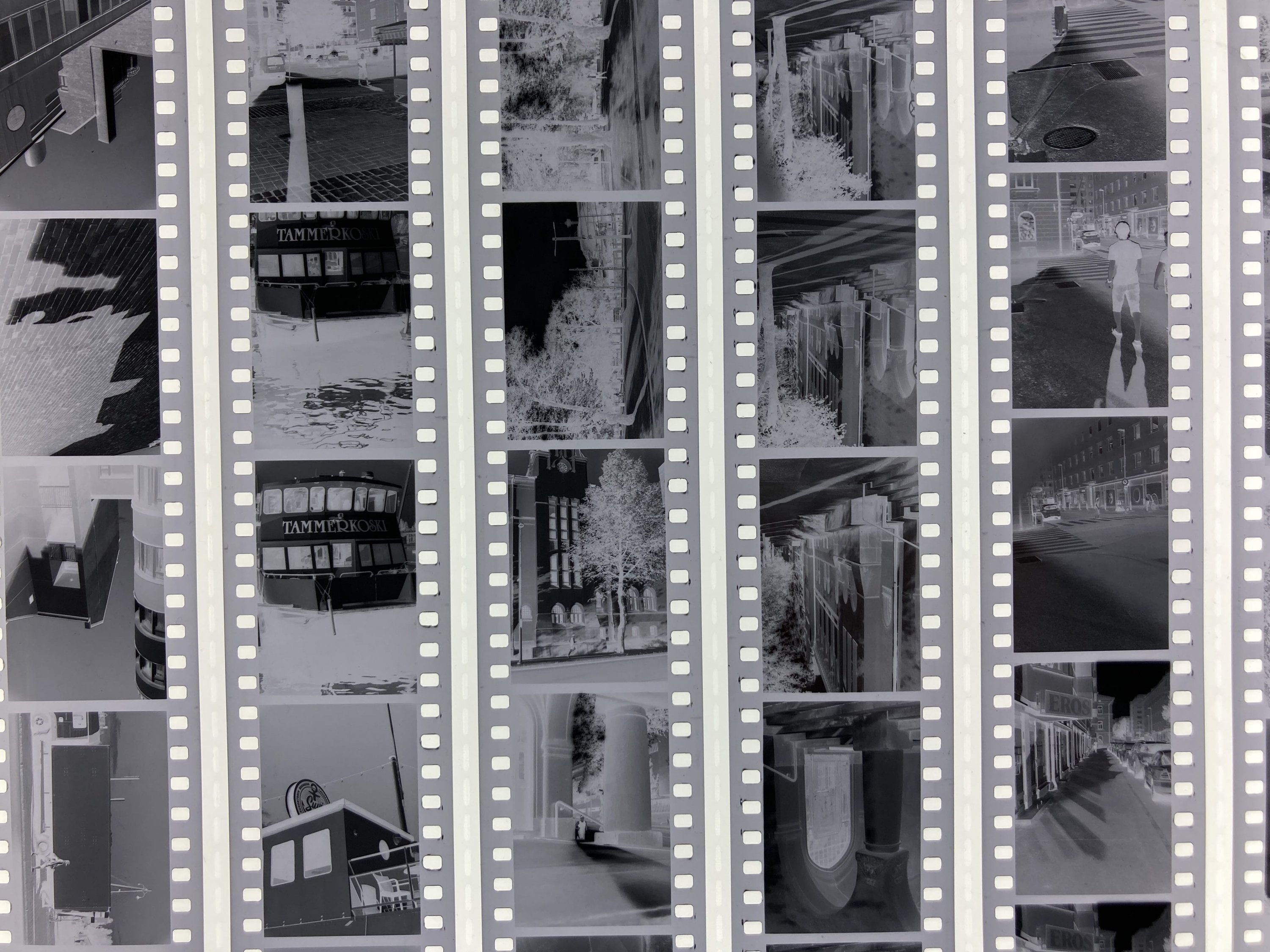

More tests. Foma 400, Pushed 2 stops from real ISO, Rodinal 1+25, 27 degC, 7.5 minutes, 30 sec agitation interval. Reminder that these are flat scans, no adjustments:
Previous examples need to be printed at Grade 1 if they are shot in high SBR. Low SBR would need about grade 3.

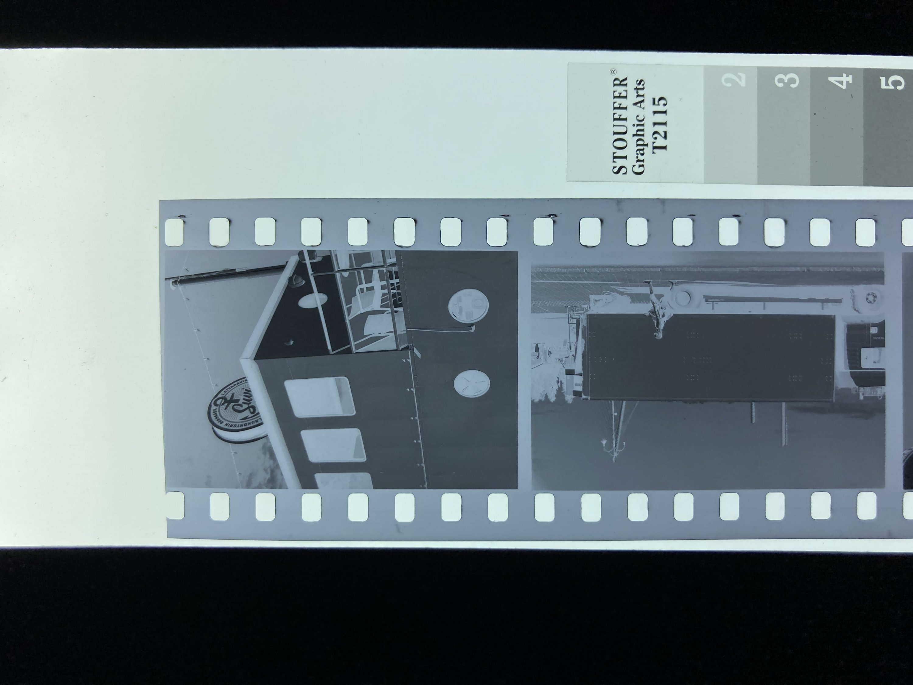

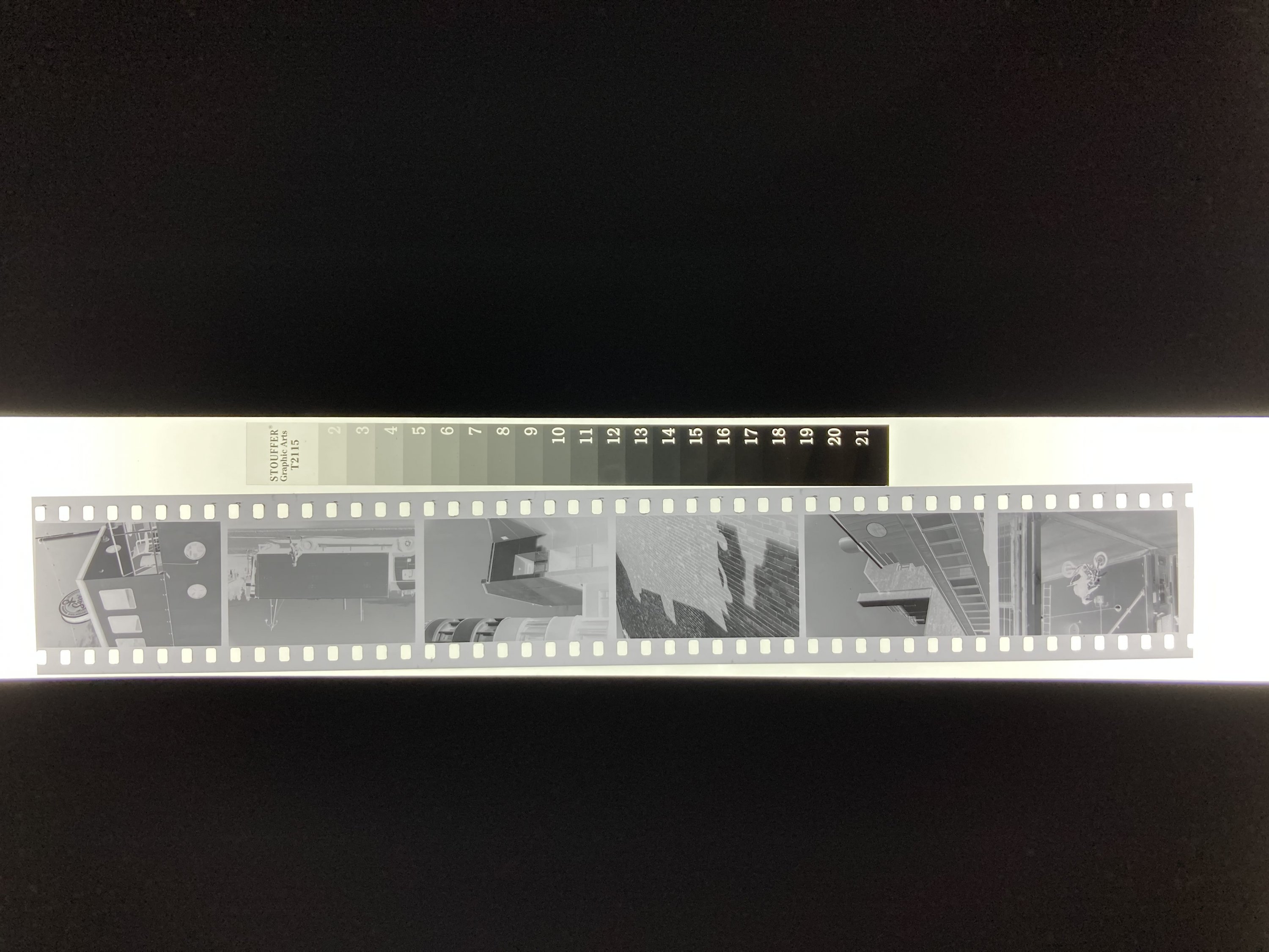

What would be most useful is a piece of uninverted neg with some rebate showing - that'll give a clearer idea as to what is usable detail in the shadows/ toe - and where your exposure is landing, relative to where you want it to land.

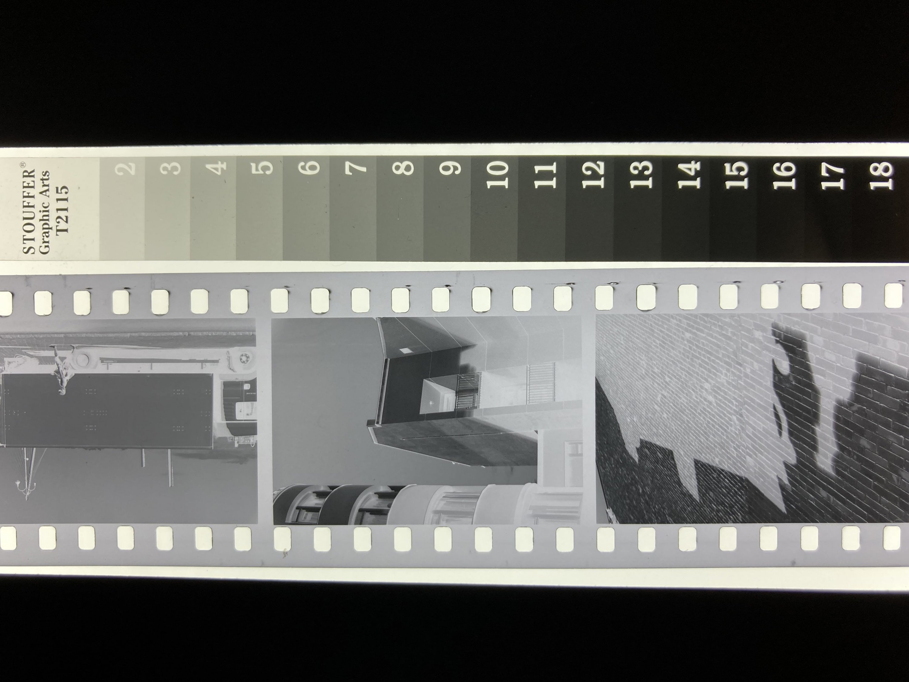

Sure. Here you go, one Stouffer for scale!
