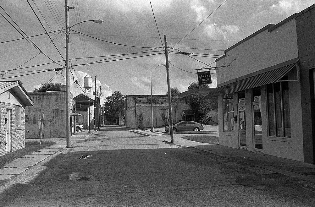

If that's the look you want, try the 100 at 25 ISO w/ a Y fltr and souped in Mic-X. I shot these down in Daytona Beach w/ the Arista EDU version of Foma 100. You can get serious grain if you play w/ your exposures. I probably should get some more Mic-X because I've been testing the 200 and 400 Foma films, and the 400 I really like in D76 full strength. Even the grain. The 200 may be too "modern" for me though. Might try a few rolls w/ different developers. I probably should have used Rodinal w/ it.

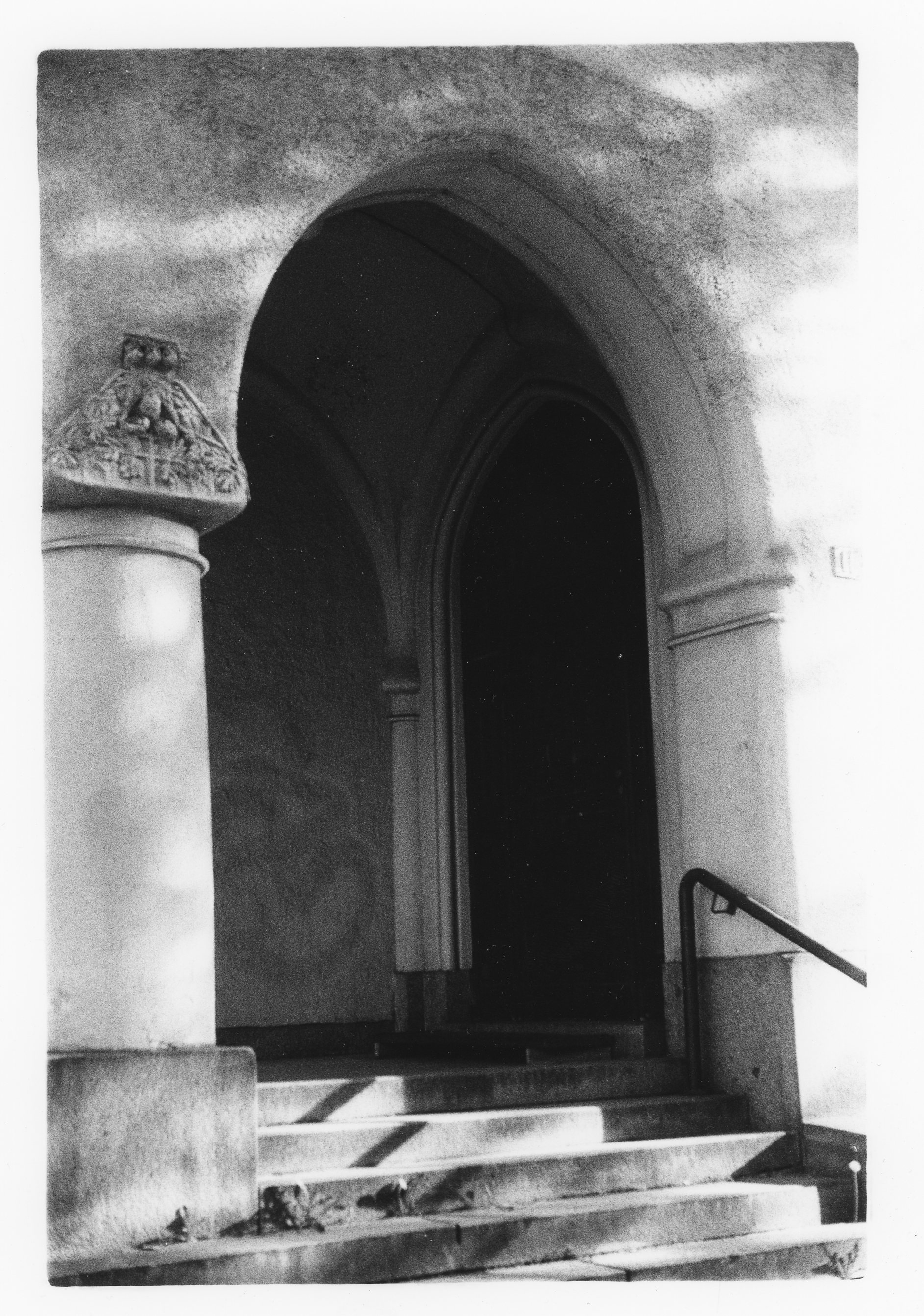

I sweated out for you guys and made one print last night:

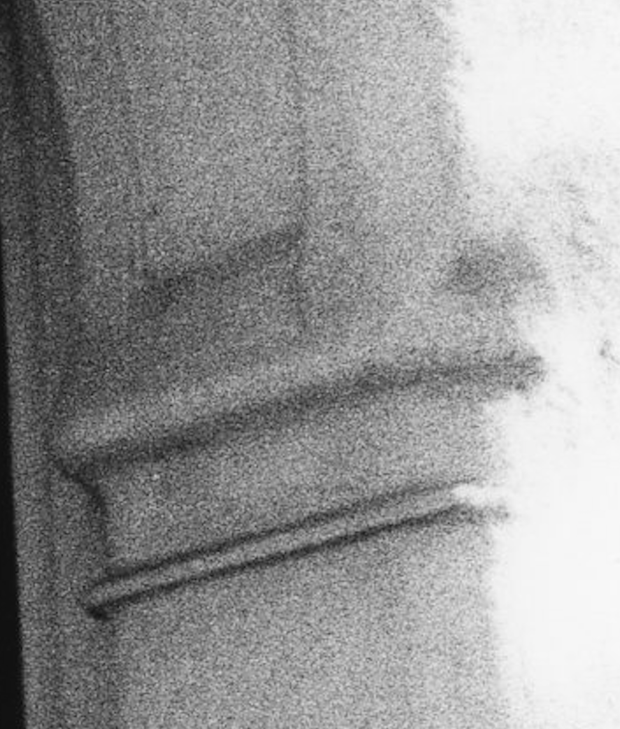

The JPG is smushing the grain a bit, here is a closeup in PNG:
The print is about 7x9" so 17cm x 23cm. This is high contrast print, I would say it is printed about at grade 4.
The grain is visible but in my opinion it is really small. I would say the grain is at normal and in natural level. The negative had pretty normal latitude as this was mostly a low SBR scene. Part of the stairs sunlight and the right side of the passage are blown out, I didn't bother burning those. Also the door is really visible in scans but because of high contrast print, it became totally black.
Remember this is from a negative that is shot at two stops underexposed from real ISO and developed like maniac, high temperature dev and developed TWO times longer than what is suggested (compensated with temperature of course).
I think Foma 400 is much better film than common belief is. The grain theory is totally debunked now. I'm not going to get my club membership to The Grain Lovers Inc. with this submission

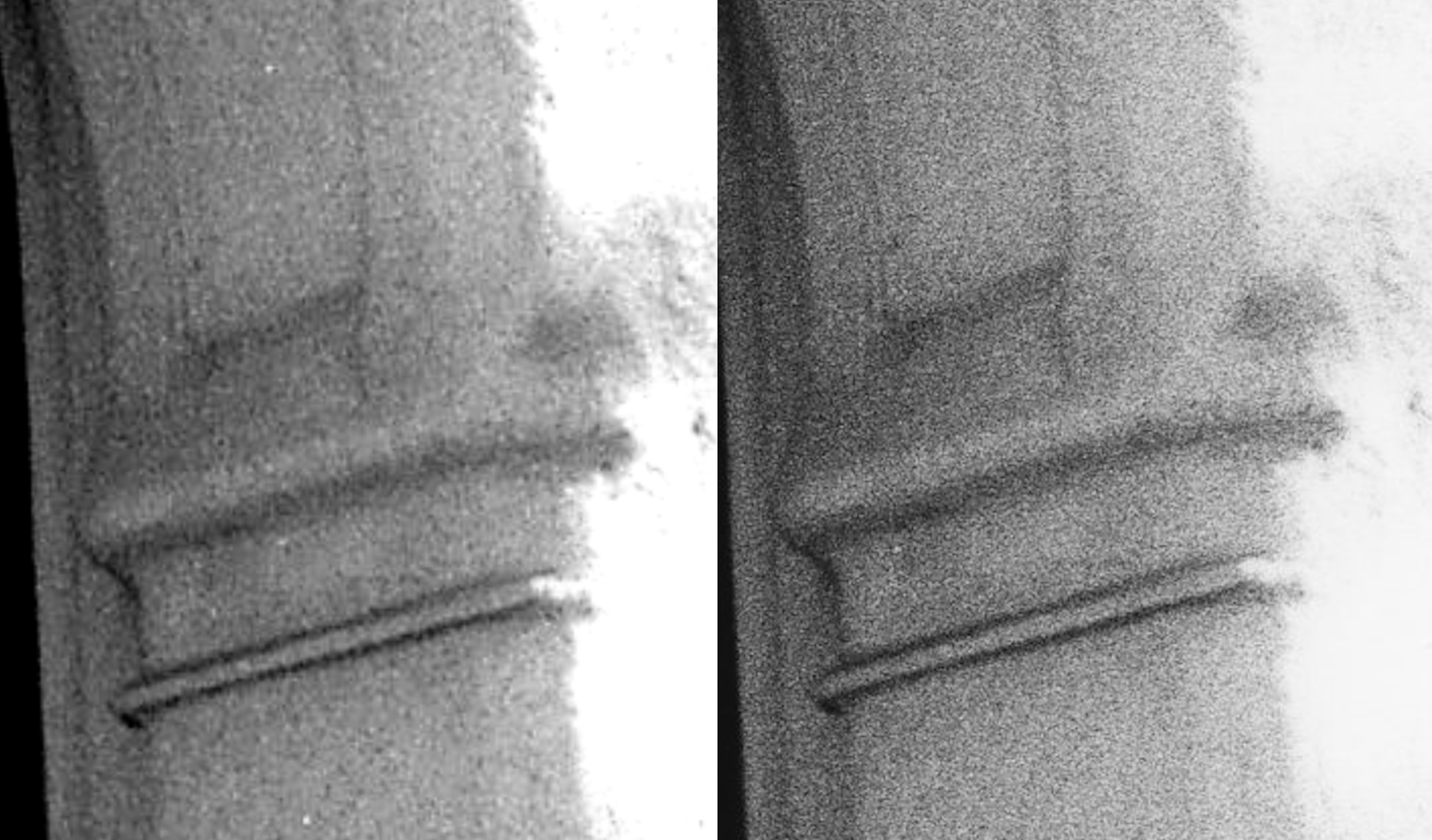

Btw, here is comparison between print scan and negative scan, which is which? Please don't answer if you know, this is more like rethrorical question and time to think things a bit :smile:
That last example says something about the problems of using a flatbed scanner for 35mm. It just never comes out very satisfactorily IMO.
Nice print, the grain is IMO amply present and very pronounced as I'm accustomed to with this film, but doesn't hurt this image.
Thanks!
I think grain works only on certain subjects. It has be used like a tool, like everything else.. Sounds cliché but maybe that way even I will some day remember it..
Also it is imporant (for me) to remember what @Maris wrote that grain on positive representation is the area between grains of negative. So what you see from negative is not actualy the grain, but the spaces between the grains! That makes so much sense.
I assume that the grain on highlights is so dense that there isn't really any spaces between the crystals, right? And in shadows there isn't any silver, so nada there. And if highlights have spaces it might be really tricky or impossible to print the negative, I guess. That is why grain can be used as tool on midtones. This is pretty similar to lith printing..
