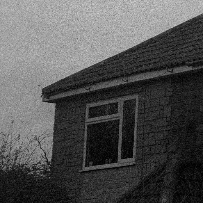

As member of Grain Lovers Inc. I tried to go on crusade to search for the "huge" grain from Fomapan 400.
I've tried evertyhing from underexposing and overdeveloping. I mean heavy overdevelopment. I've tried overexposing. I've been using Rodinal 1+25. I've agitated "like crazy" (30sec intervals).
But I suspect my film is broken. There isn't any large grain. The film works surprisingly well.
The only way to get this notorious and really common grain from Fomapan 400 is to heavily underexpose and scan. There is no way to make prints out of those negatives. And making prints is only thing that counts.
So should I return my film? I thought even showing this film to Rodinal bottle makes it have such acne that I could get my respect in Grain Lovers inc. But they just laugh at me ..

Aha! So my Foma is actually broken!

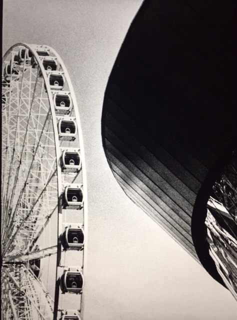

i'm not really sure what really flat scans are supposed to show. The grain will come when you add the contrast...
Yup, the scans do look grainy for the size and contrast. OP, you know when they speak of grain like golf balls that's hyperbole, yes?
The highlights on EI 640 were so dense that the scanner couldn't handle it. I actually don't know if the un-adjusted settings crank the output levels to the max or not. But that is not important..
To my eye that image is full of jpeg artifacts so I don't think you can make a valid conclusion based on it. (edit: i see mine also now have artifacts, Photrio must recompress)

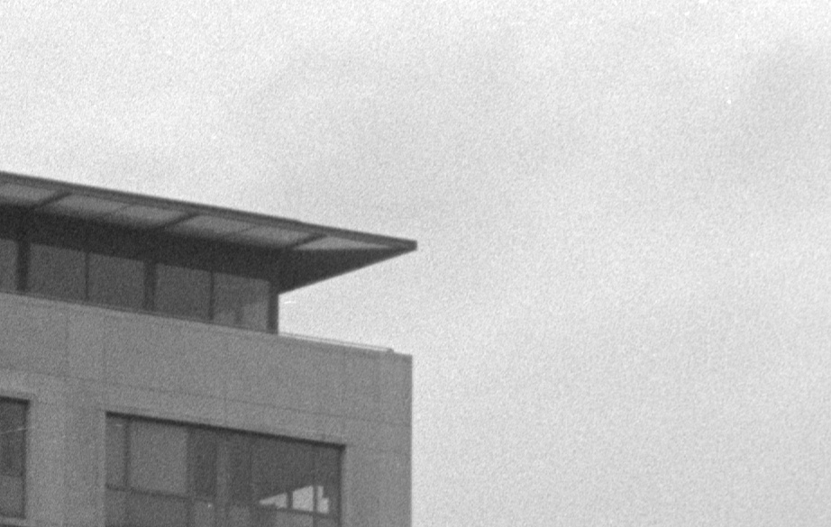

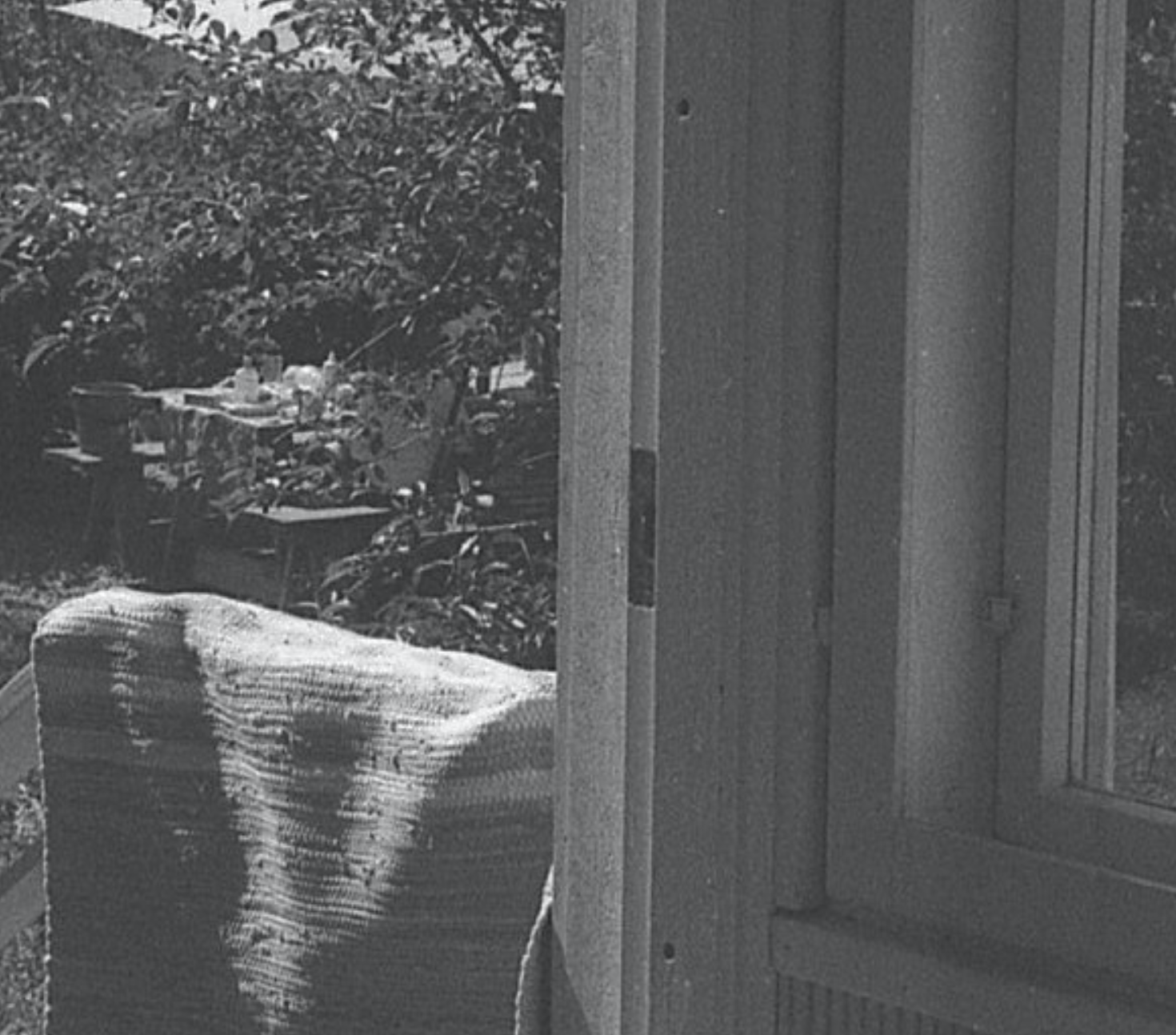

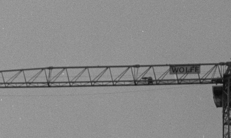

Close-ups:
Raw(*), unsharpened 2400dpi scan (Nikon V-ED), 35mm, Ilfotec HC
As above but 4800dpi, XTOL 1+1
Ditto
As above but Rodinal 1+50. 1st and last time with 35mm for me.
In this gallery, the 2 images which were 120 + rodinal are obvious, despite being amongst 35mm.
Now, don't get me wrong, I like grain, Tri-x + Rodinal are a great match IME, but Foma400s just ain't to my taste.

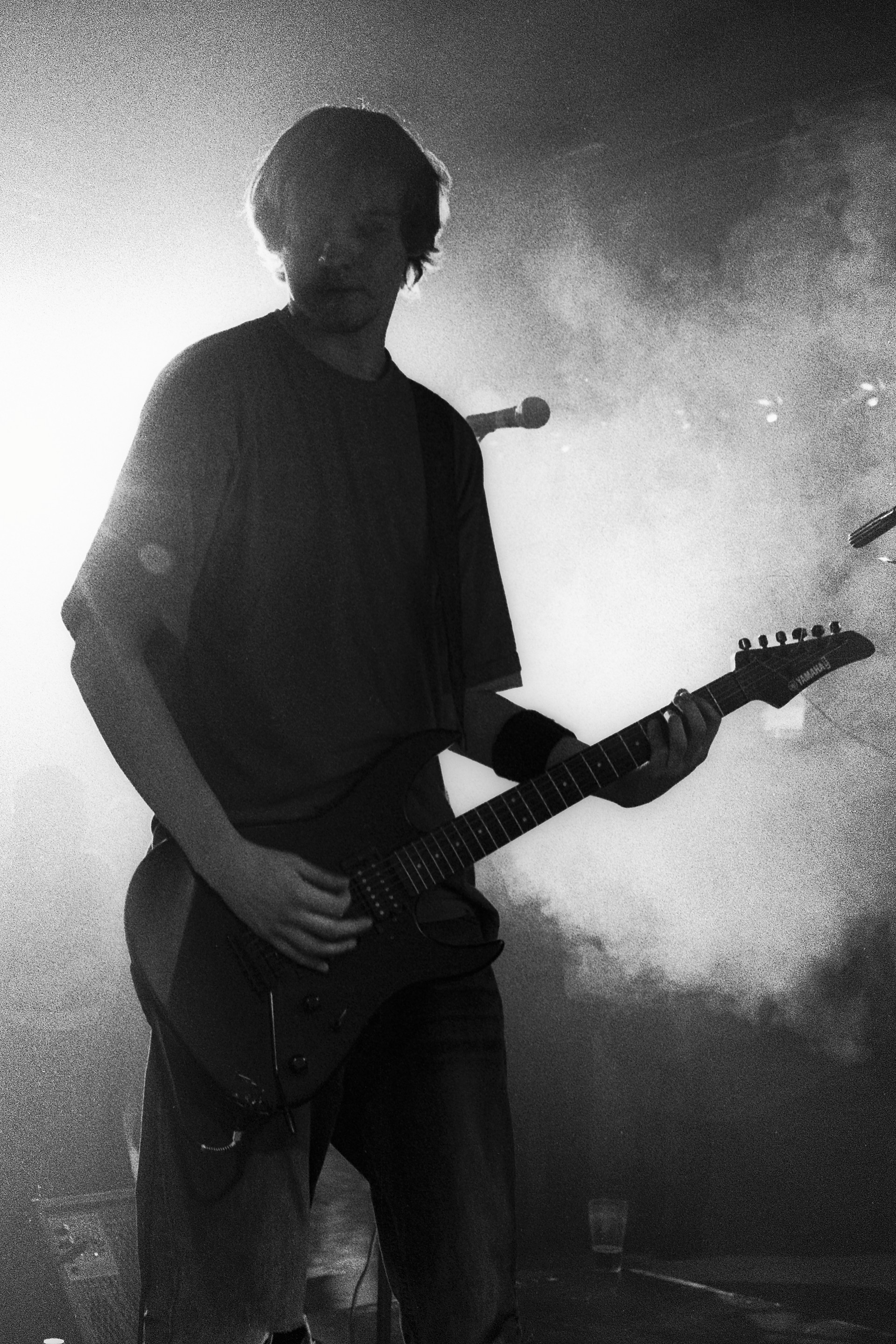

Tri-X@1600 + Rodinal

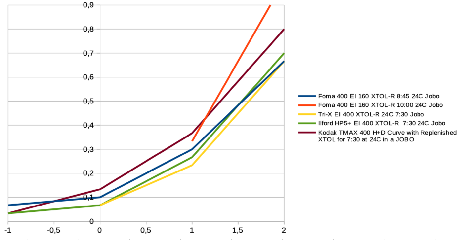

It's the steep toe, oddly nonlinear response in the midtones and the tendency of highlights to blow out.

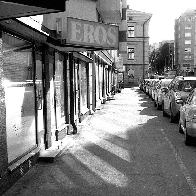

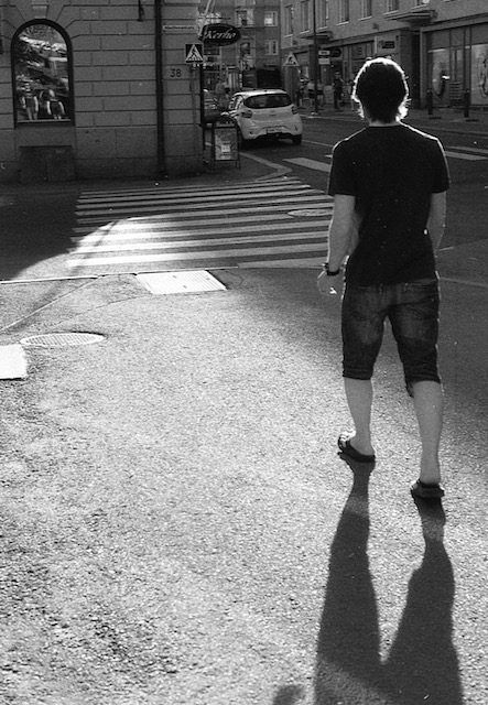

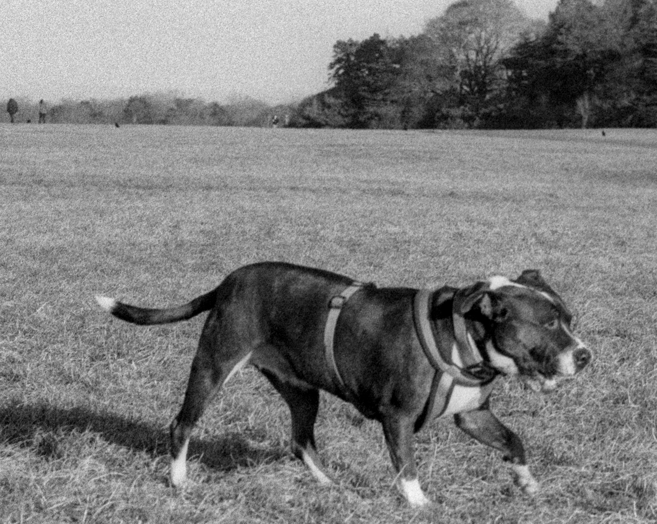

Anyway, here is few to my taste digitally adjusted scans from the 27degC development:
Could I print these with similar look? I have doubts..

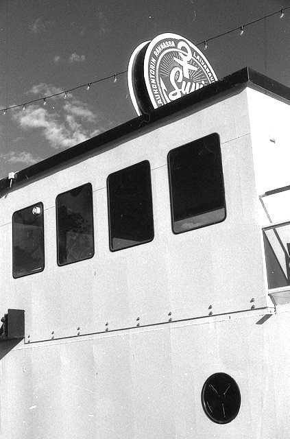

First image TMZ, lots of grain.
Second image Foma 400 in rodinal 1:25, no grain.

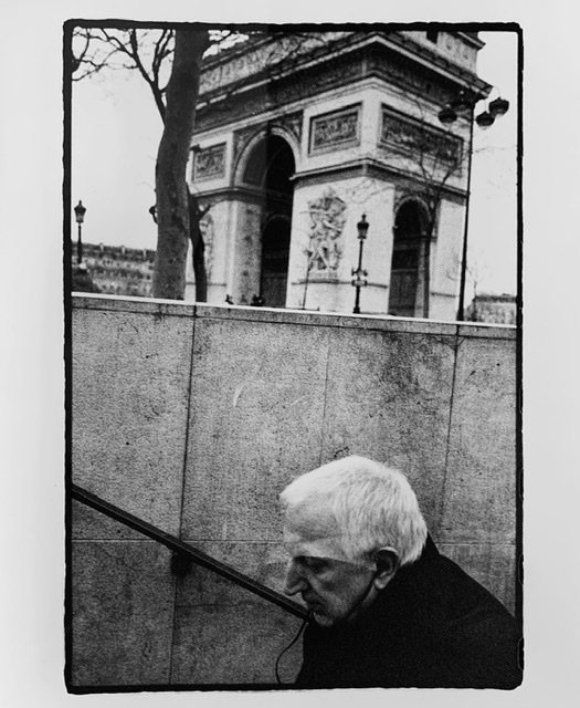

HP5+ lab processed, Pen F, 70mm f2
Nice! Just the look I'm after. What kind of exposure and processing? Is this print? Grade? So many questions!
Yeah, well,I was mostly reminiscing over my own experiences with this film. I got very few keepers to vouch for it, so I went to Rollei RPX400 and then to HP5+. Next stop is probably TMY if I keep heading this way...although I'm so far quite pleased with HP5+ after a disappointing first impression years ago.
I'm also giving HP5 another chance. Same here; I didn't like it first time. But pushing it to 800 or 1600 seems to do the trick! How are you exposing and developing HP5?
It is important to note that Pen F means half frame (24mm x 18mm) negatives!
Perfect for the grain seekers - as long as they don't mind 72 photos on a 135-36 roll :D
Thanks!
The image dates back a few years ago so I’m guessing here, but looking at it now I would have thought the mid tone on the building, since I used the in-built reflected light meter calibrated for mid grey.
I’m afraid I have to hold my hand up here, it’s a Plustek scan so I guess I’ll get banned here.
