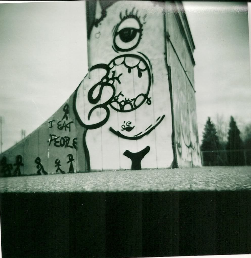

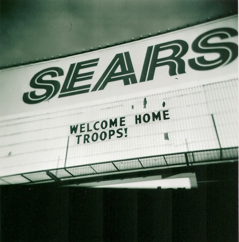

Here they are
Sans rectangular shape, they look good to me. Thanks for all the input.
DLawson
Jun 17, 2009
320
Dayton, Ohio
I like. Especially the second ("I eat people") for reasons that keep seeming just at the edge of the desk, until I look to try to find a good phrasing.
Call me strange, but I like things even more when I can't say why I like them.
