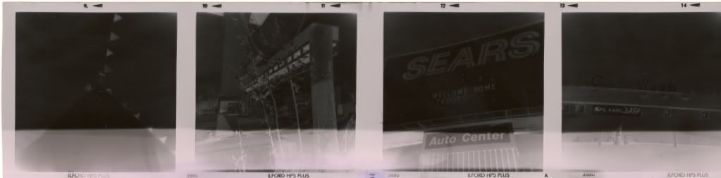

So, I processed my first roll of 120 last night. I was in quite a hurry, but it happened and I see pictures. I learned form my mistakes and Now you all can laugh at me.

Looks like that part didn't get well developed.
Nothing to laugh at, no one is perfect. Let's see how will my first B&W roll come out of the tank...

It seems that the part of the negatives that developed turned out to have a nice density. I wouldn't look at this as a total failure.
I can one up that - I usually do a bunch of rolls at once, saves me time. Well very recently I did just one roll - every thing was exactly perfect - as usually - I am a very precise worker. I made sure I had enough developer for the one roll blah blah blah - one thing wen wrong. The reel with the film was at the top of the tank instead of the bottom.
WTF - is that some kind of dyslexia?

Actually, your picture and experience is a teaching moment for me. I assume the 'mistake' was a shortage of developer in the tank and the top part was the part under the developer during the time when you were not agitating. I've always wondered how much development takes place because the film is submerged and how much development takes place because the developer gets absorbed into the emulsion when it is exposed to developer (i.e. in your case during agitation). You have produced an image that demonstrates just that. Before looking at this I would have guessed that the unsubmerged section would have been much less developed.
Your experience makes me want to experiment with water bath development, which I'll bet was invented by someone who first did something just like you did.
