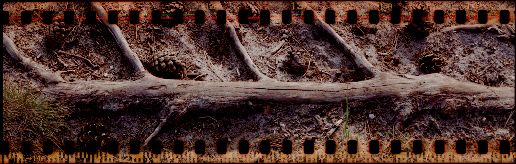

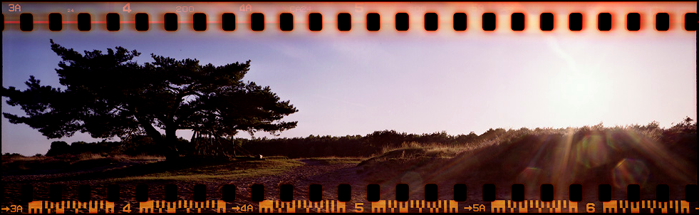

You can actually see the curving problem in one of the images on the page linked to by @xya.
Here's some of my attempts from back then:
This was stopped down pretty far so as to have the depth of field solve the problem with focus. But as you can see, color along the sprocket holes was a bit of a problem.
I still have a vague plan of revisiting this experiment using Kodak Vision3 film with remjet backing, which should be more immune to this problem. I didn't have access to that back when I made the images above, some 10 years ago.

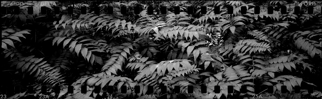

Black and white worked sort of OK, especially in low contrast situations where the halation problem didn't play up that much:

I do think the sprocket holes really do add to those ultra wide panoramas, like saying you're using the entirety of the emulsion. I don't personally like sprocket holes when it feels like they're the only thing carrying the image, but usually in my experience that isn't the case :smile: I think you could also use the sprocket holes for deliberate artistic effect although I don't think I've seen too much of this. I don't know how I'd do it myself.
I love your images here so much, especially the ferns in black and white. It almost feels like the sprocket holes are hiding camouflaged among the foliage.
Thanks for the info on the curling/focus issues and sprocket halations. I'd love to try shooting Vision 3 with this setup actually, once I've worked out the details.
