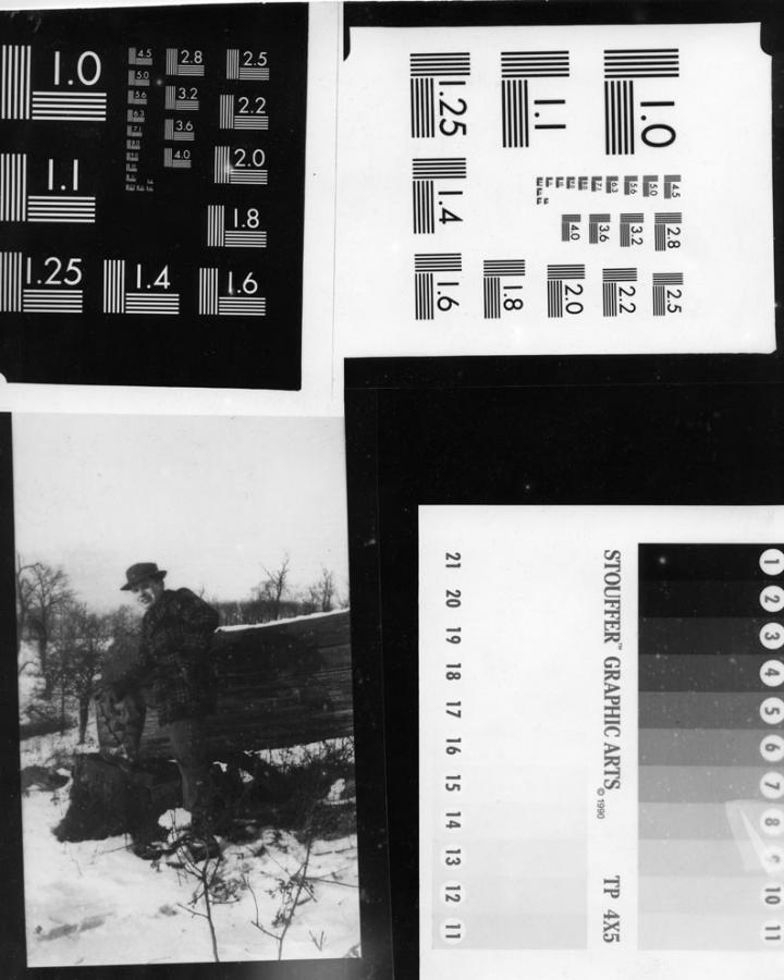

With apologies, I see what happened in some previous posts....
This is a typical exposure on an 8x10 sheet testing with the Stouffer step wedge, 2 resolution charts and a normal photo.
In some previous posts, I had cropped the scan of the prints to illustrate the resolution charts and in another case to illustrate the contrast but I had not shown all 4 in one print.
Right now, I have 3 of the prints here, but cannot locate the full scan of the Ilford, nor the original print. The 4 print set got separated somehow. When I can, I will repost as much as I have here, but the exposure here is pretty typical of how I test my print emulsions.
If anyone wishes to see the film tests, let me know. It is just about the same as this though except shot in a camera.

Thanks, Ron. I'm glad you found the whole step tablet (I was wondering :smile:) I see you are still having surfactant problems (unless these are the same prints from four years ago - they look familiar, but I know you follow the same basic research protocol I do, which is to re-use materials to keep an established baseline.) Keep up the good work. Post often!
I think a lot of things are coming together, each of us in our own areas of particular interest. I can hardly wait to see Ron's superspeed films. Bill Winkler is having very good luck with ortho emulsions and is well on his way to pan. If I were a betting woman, I'd bet Kirk will be busting open the T-grain puzzle soon. I'm almost ready to go public with hand-subbed film, which should make the 'capture' side of emulsions a lot easier. With apologies to Bill, as beautiful as glass is, a backpack full of dry plates is a load going up a trail!. And of course, there's Tim's great work with paper. I hope 'hrst' and 'totalamateur' haven't given up. I can tell you that I'm in regular contact with a number of people who have started working with emulsions, but are too shy to share just yet.
On a tangential note, I submit a gentle elbow nudge to lurkers. I see that there are many more hits to this thread in the last hour or so than views of Ron's jpegs. If you are just lurking here without membership jpeg privileges, you're missing half the fun. It's free and painless to sign up as an APUG member. You can always decide to support the site with a subscription later.
d
Denise;
My surfactant problems came about when I tried to use Photo Flo 600 unfortunately. No amount would work for me. I have used many other surfactants. This includes TX-100 which is the active ingredient in Photo Flo 200. I've used TX-200 and also Alkanol XC with quite good results. My standard is Photo Flo 200, but I do go in and out of problems as we did at the workshop. I find that this is related to some contaminant that yields itself (as we found at the workshop) to plain old soap and water. I am working on a surfactant mix that will solve this type of problem.
Yes, the photos posted above are what you saw in the workshop. I have carted them back and forth to workshops so often they are getting "shop worn :smile: ". That is probably how I mislaid the Ilford originals which are here somewhere or languishing in a corner somewhere in Montana or NYC. :sad:
When I find them, I will post them, but in the meantime I found another set of prints and one of them is coffee stained in the center. I either did it here or one of the students did at a workshop. Baptism by coffee is not good for a print.
The first set of prints and the curves that I posted above were done this spring when I made the Azo comparison.
PE
