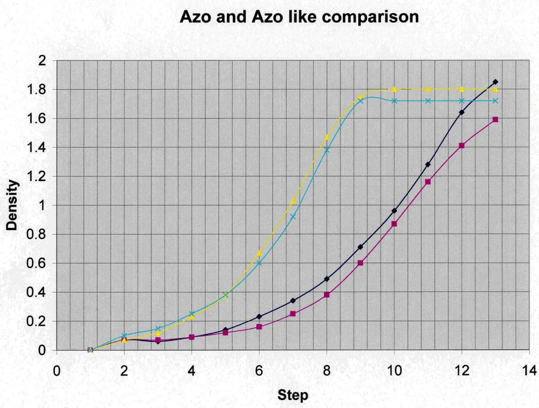

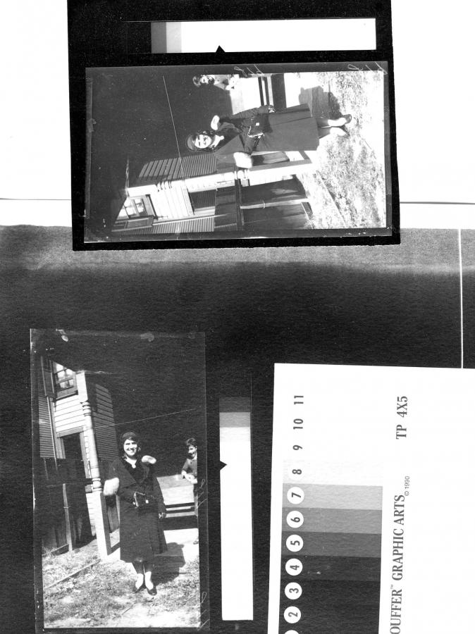

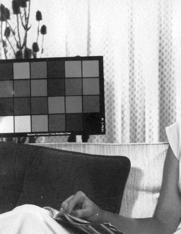

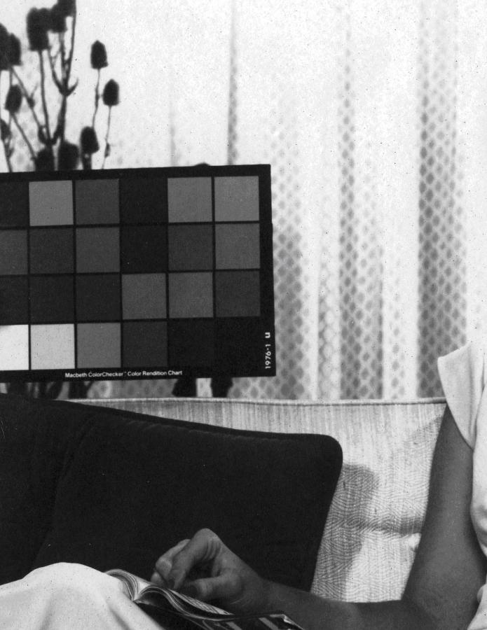

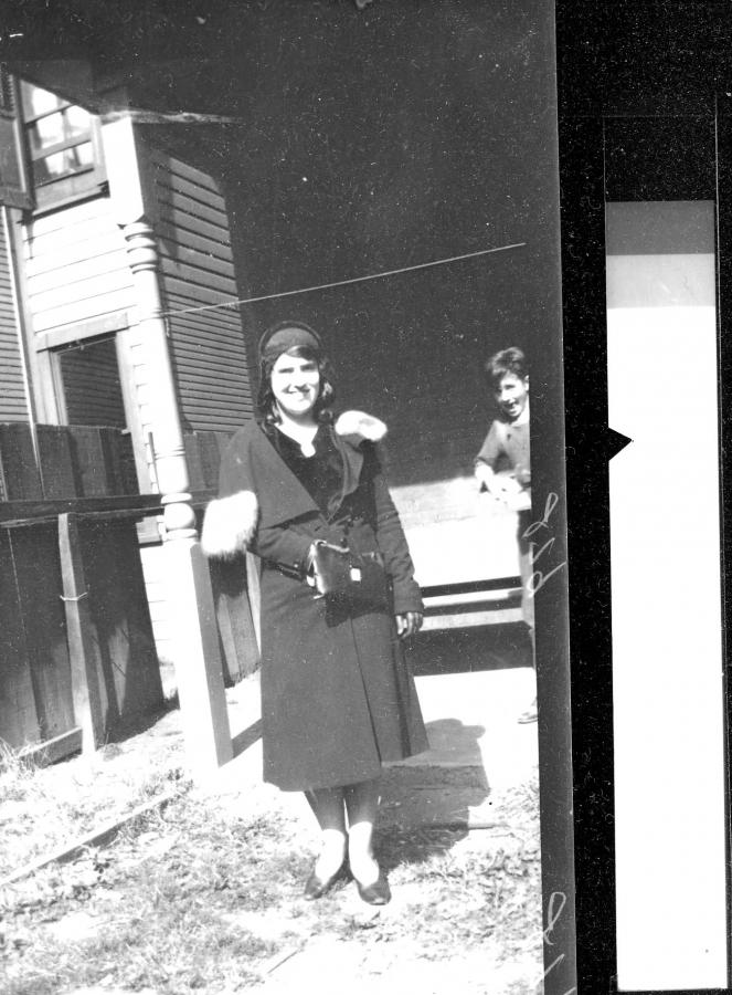

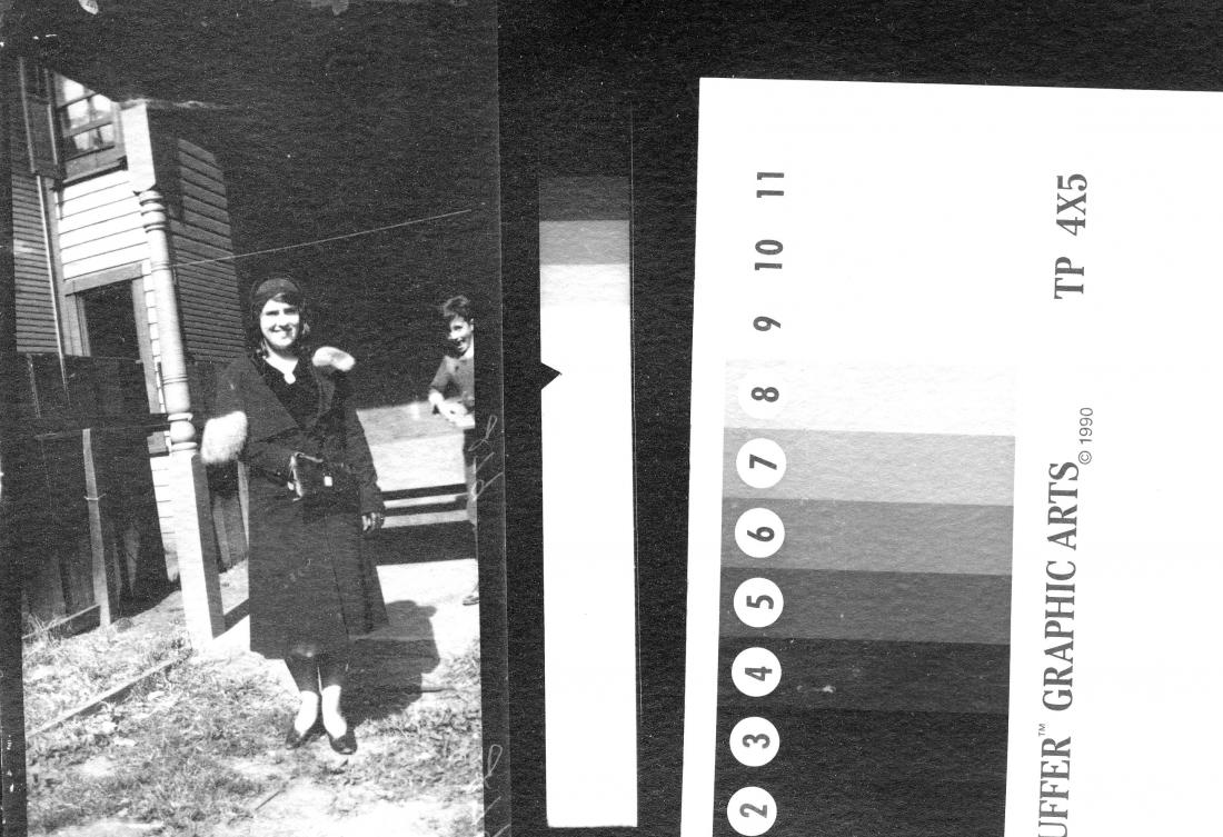

Print comparisons
In the prints below, I have first posted the reference using Ilford MGIV paper with an on-easel enlargement at f11, 12" with 1' in Dektol 1:3. The remaining prints are made using the same process. The filter was grade #2.
Print #2 is the Azo type grade 2-3 paper with 8" exposure, #3 is my enlarging emulsion exposed identically to the Ilford paper but without filtration.
The curves in #4 represent the actual Stouffer curves from the Azo experiments and are from right to left, My Azo type soft (~2), Azo grade 2, my Azo medium (~2-3) and my Azo hard (~3-4).
The next two are comparisons of my Azo medium grade and Azo grade 2. The last photo is an uneditied or cropped photo with both the Azo and Azo scanned on one pass (doing separate scans changed the relationships of the images as you can see from the previous two photos) with identical process and exposure conditions. I used an old negative from the 20s to get that "old time" look.
In the early stages, I used the MacBeth in the photo, then I went to the strip chart and now I am doing a strip chart and a Stouffer wedge.
The strip chart is a Kodak step wedge. It is as valid as the Stouffer wedge.
I hope this helps.
PE
