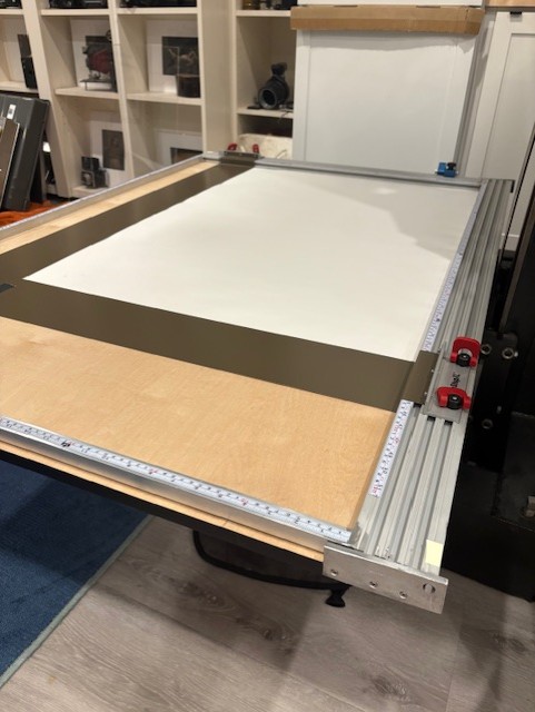

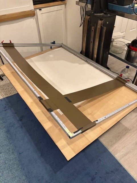

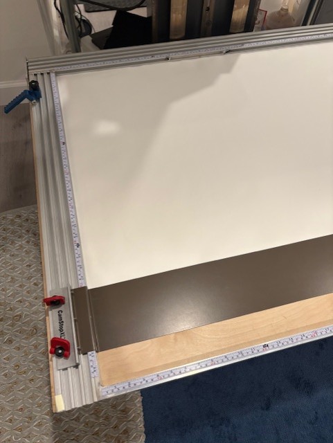

I started out with a magnet system, it was a half sheet of plywood cut in half with a piano hinge in the middle for storage. Then I glued sheet metal to that. I worked fine but it was awkward for me to deal with alone so I decided to build a giant 2 blade easel. It will accommodate a 50” x 30” sheet of paper, and it gives you a full 48'' of exposed area. That size print is a bit beyond my available darkroom space but it’s doable. I wash outside after I roll the prints in the chemistry. I tone outside also. I made it with an extrusion made for specialty table saw fences and other parts and pieces meant for the same thing. It's got 1/4'' brass angle imbedded in the wood under the extrusions to line the paper up nice. It gets me a nice clean border which I like. Once I get it set up exactly like I want I tape the easel blades so it can't move when I open and close it. Took me a minute to put together all the right parts and pieces but it was worth doing..
