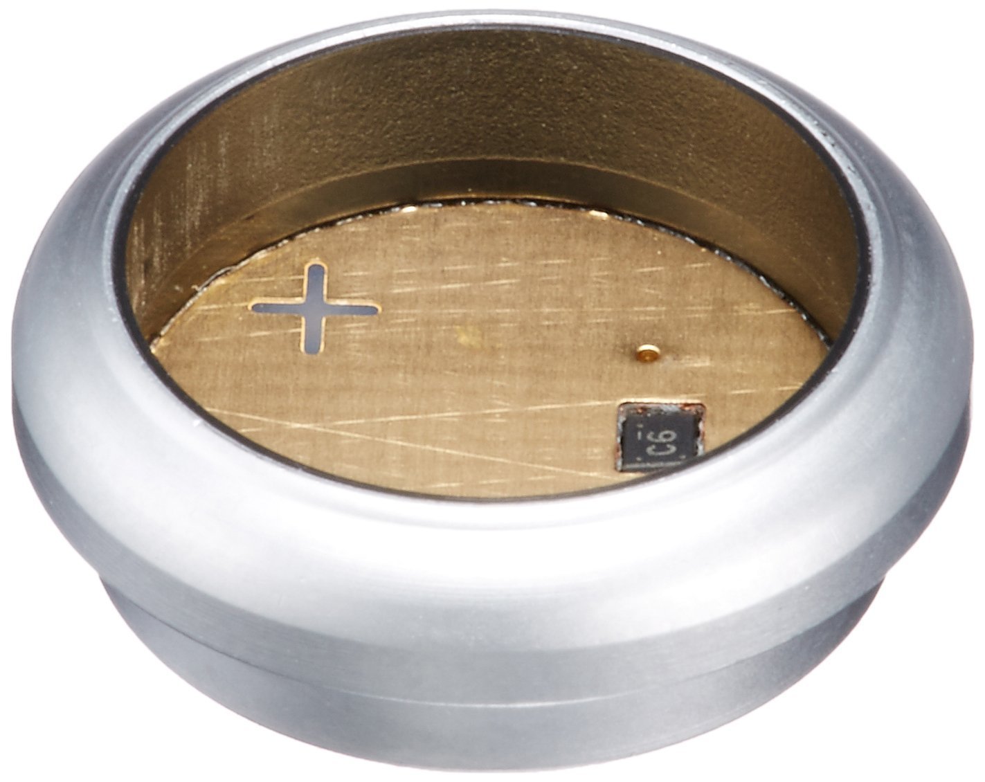

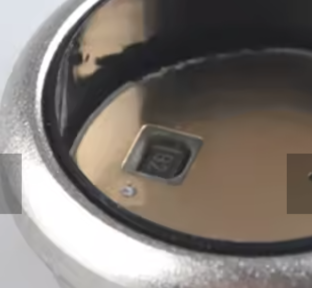

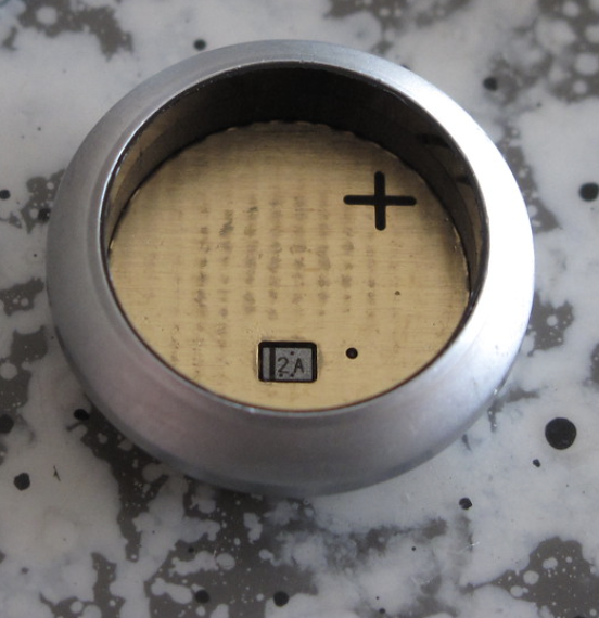

AFAIK it's just a single Schottky diode with an appropriate voltage drop.
I wasn't sure because I did not think the appropriate diodes came in surface mount. I have only used glass diodes. Are you able to identify these surface mount components? BAT54J and BAS70J ?
None of the above look like this, which is what it should have, in my opinion. Mabye I'm missing something. I have never taken one apart.
They do.
Depends on the manufacturer, but often they're not reliably identifiable. The types you mention are also not an exhaustive list of suitable diodes.
Having said that:
I'm 99.9% certain these are SMD SOD package diodes.
This one may be a diode, but it's also possible that it's a voltage regulator. If it's the latter, I would expect to find two small ceramic capacitors somewhere near as well, and given their absence, it's more likely that this, too, is an SMD diode.
YMMV; plenty of people will argue that a simple series diode will be adequate. I expect that these adapters use one, and not the linear regulator you've shown. The regulator is a more fancy solution and arguably better in some ways except probably leakage current (=battery lifetime).
