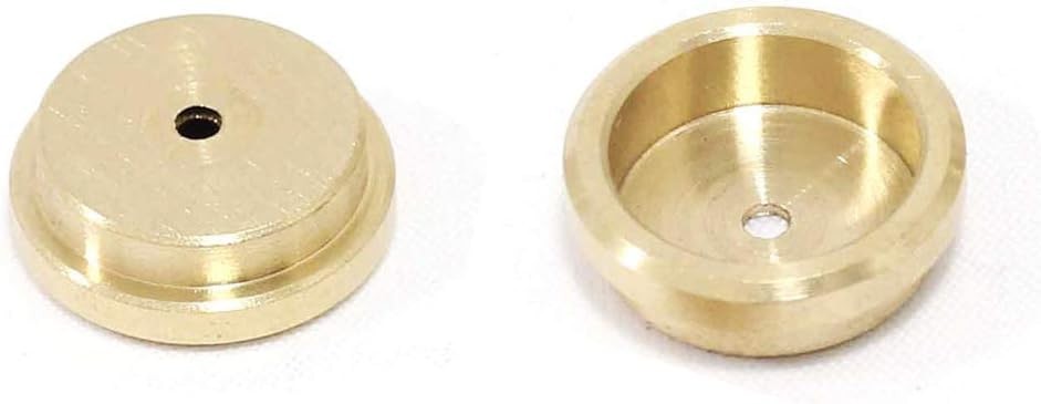

The "386" batteries are the same width as the "76", but about 1mm thinner -- which should not make them more difficult to remove from the adapter, but I've seen a lot of "copy-cap" adapters for sale which are not really copy-cats at all because they don't change the voltage at all -- even though some claim to. They simply physically mimic a 625 battery -- which might work fine in some circumstances. Some have a small hole in the bottom which would made removal of the "76" or "386" battery very easy.

The Canon EF works pretty fine with these, as it regulates its' own tension. I could even make then myself with a scrap of brass. Next step would be to adapt a proper regulator in the F1s
