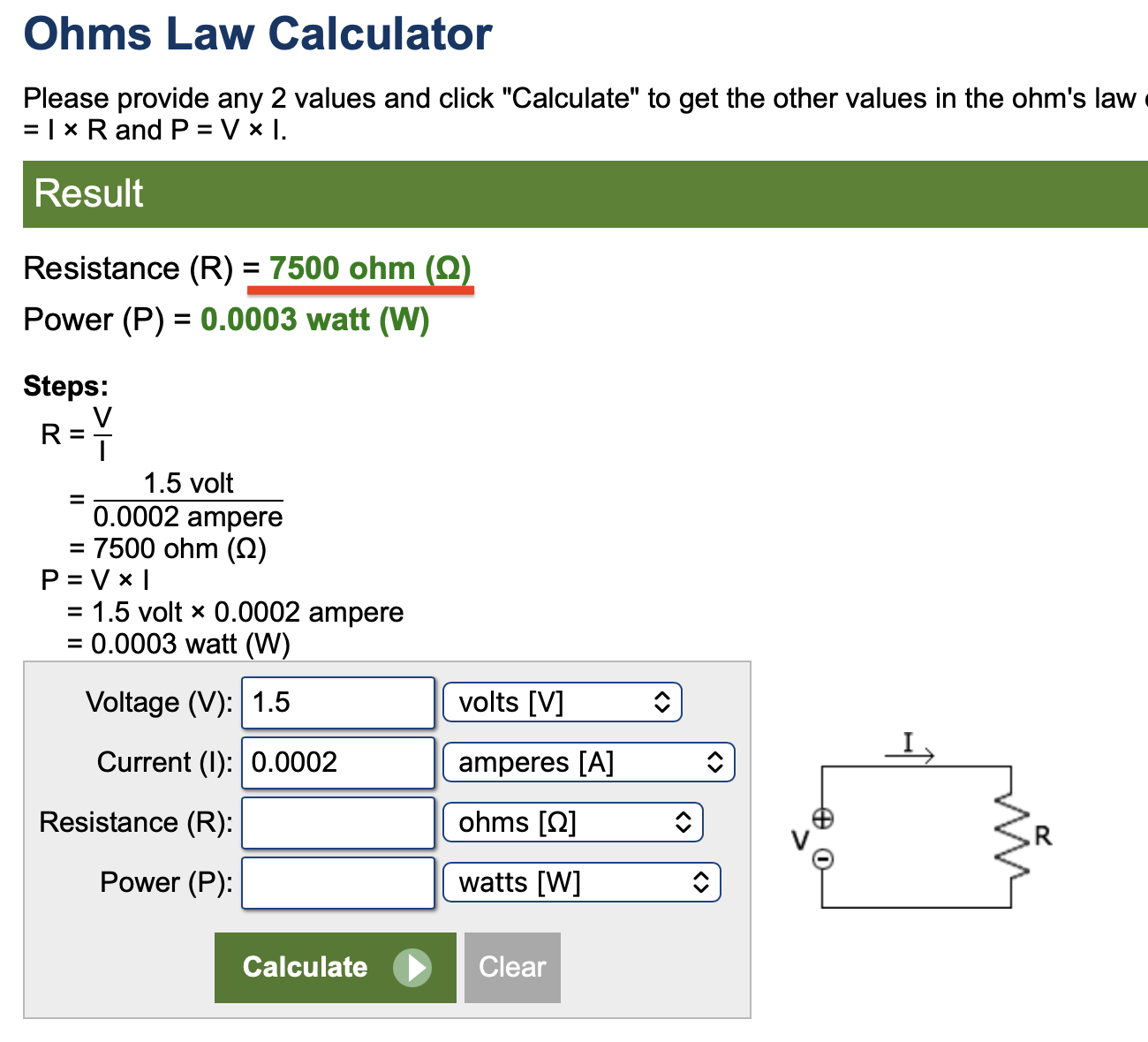

It's designed for a nominal draw of 200 microamps:
When it comes to electronics, I am a real babe-in-the-wood -- so, someone please help.
If I understand correctly (doubtful), and if I got the decimal in the right place for the amps, then is it true that a 7500 ohm resistor would be an appropriate load for testing the MR-9 voltage converter?

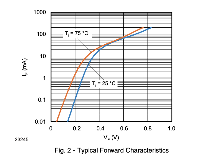

Any type of diode will drop the voltage by some amount that ramps up from zero (it is a knee-like curve) depending on the current draw.
A normal silicon diode (like a 1N4001 rectifier) will drop the voltage by about ~0.7 volts at typical currents like a fraction of an amp. It would probably be about 0.5 volts at the tiny less-than-a-milliamp currents drawn by a light meter. That's too much, so the people who make MR-9 type adapters have to use a different type of diode. Something like a Schottky BAT42 diode would be a good choice. These use a metal-semiconductor junction and have a smaller voltage drop. Here's a datasheet for the BAT42: https://www.vishay.com/docs/85660/bat42.pdf
Figure 2 (see below) shows that at 25 C and a current of 0.2 milliamps, the BAT42 has a forward voltage drop of 0.2 V, which is just about exactly right.
The battery test mode of your multimeter might draw a few milliamps, I think that's what mine draws. This might be close enough to do the test. It would be more controlled to get a resistor and measure the device under a known load - it doesn't have to be exactly a 7.5Kohm resistor, it could be 5K, or 10K, and you'd still get a meaningful result.
