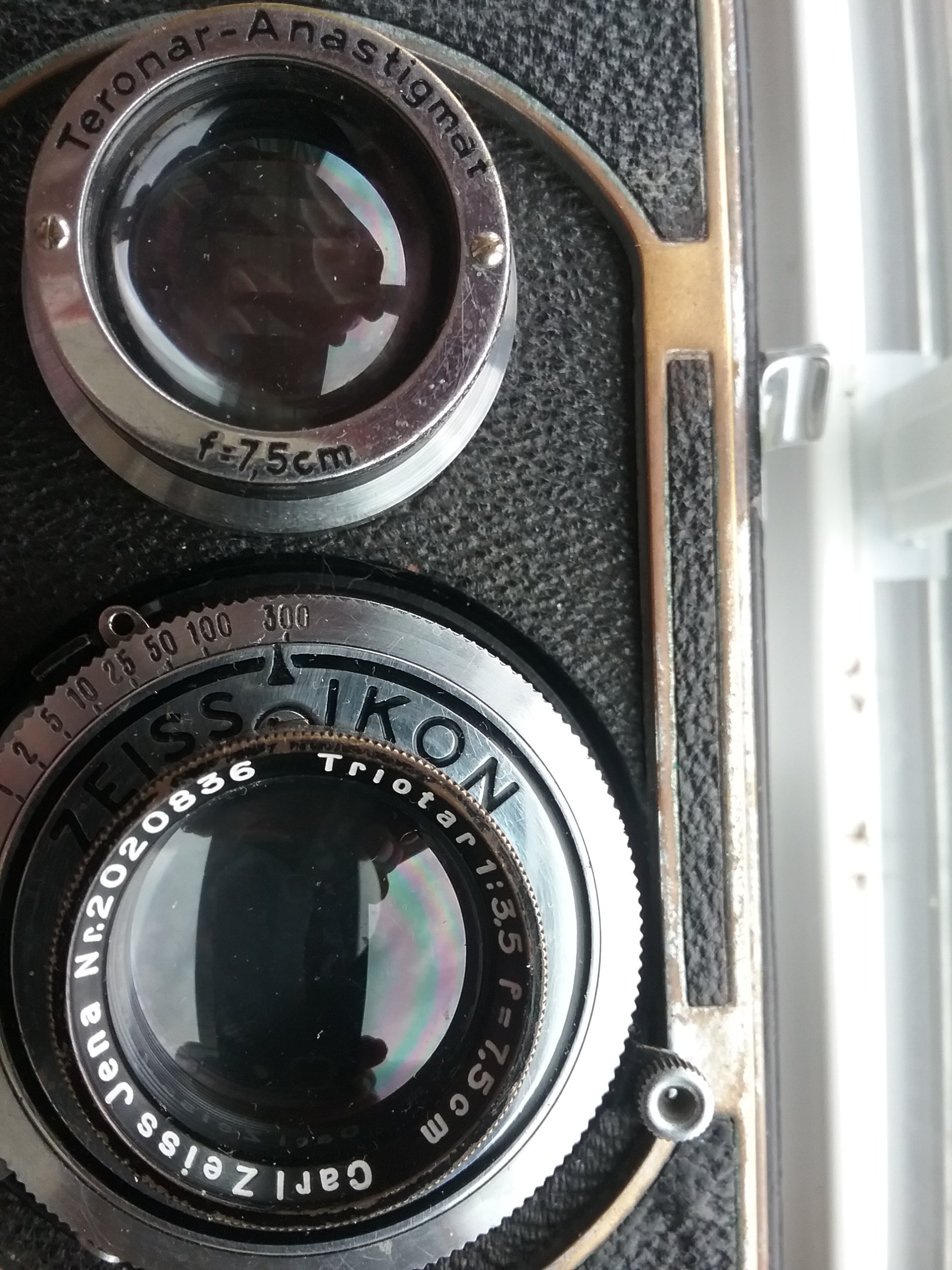

I have been told that it is oxidation built up over the years that enhances contrast and appears to look like an oil slick It is supposed to have been the inspiration for the later coatings on lenses. I have uploaded a photo of the lenses.
It happened to an uncoated Rolleiflex I had a decade ago. Not sure it enhanced the contrast but it did not harm neither.
