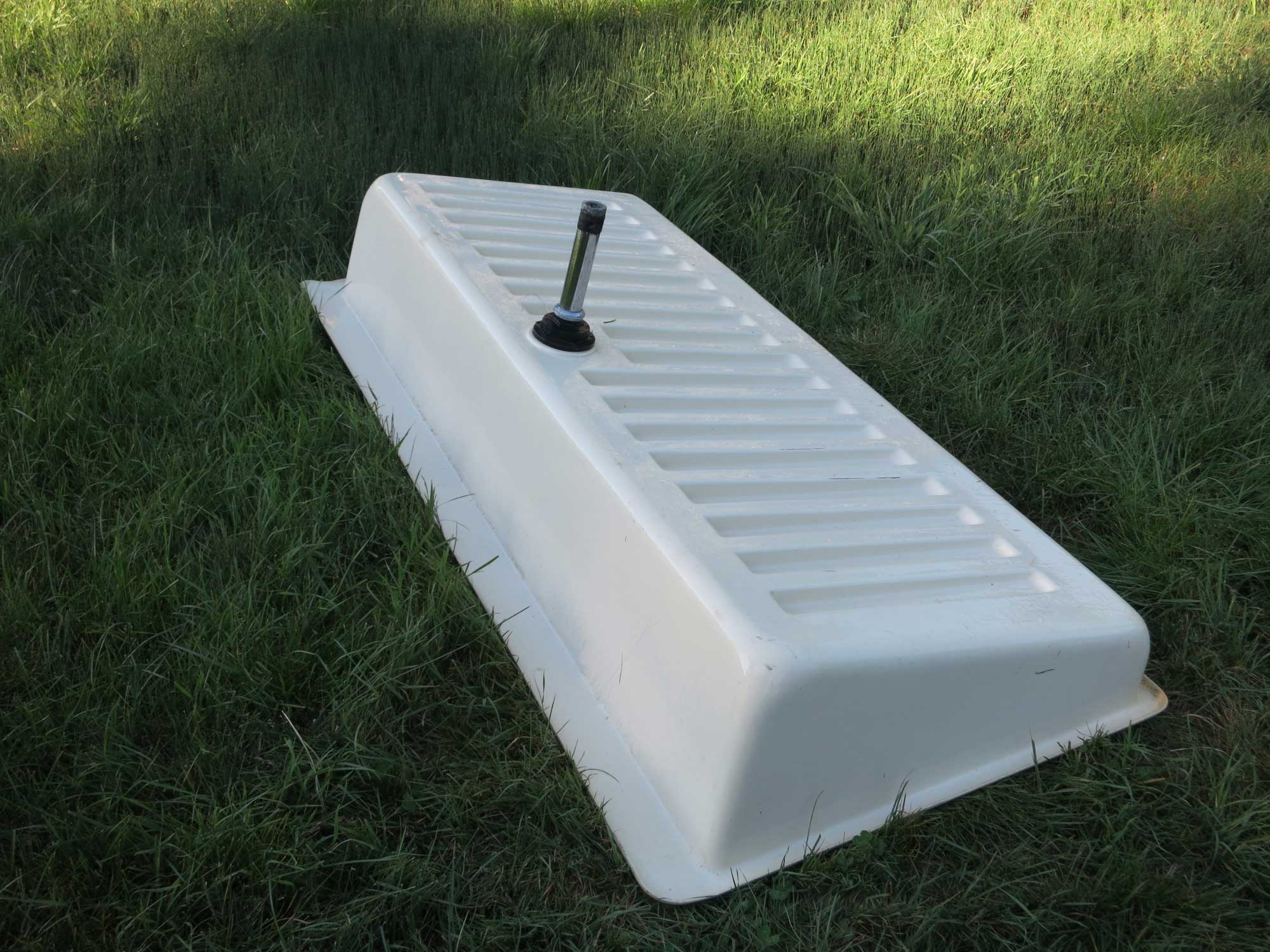

Can't wait to see results from the BIG negative. That will be a challenge to develop and also to scan or photograph or contact print!
Normally I design, calculate, draw, ... everything before I start building, but not this time, not this MSA.
I'll expose the BIG negative rather properly and will unload it in the dark. I've made a water resitant bench for my dark room, that is big enough for this 20x24" negative. So I'm gonna lay if flat on the bench and will use a sponge soaked in developer to "wet wipe develop" it for about 2 minutes or so.
Same thing with Stop and Fix. Then into the bath tub with clean water for rinsing.
I hope it will work out ...
Scanning might be a bit of a problem. So I think I'll use a d*****l camera to photograph it. Using PS to make a positive of the paper negative, I can determine if it did work out all right.
If so, I'll make a contact print later. First I must find a glass plate big enough and determine the right exposure for contact printing this sandwich.

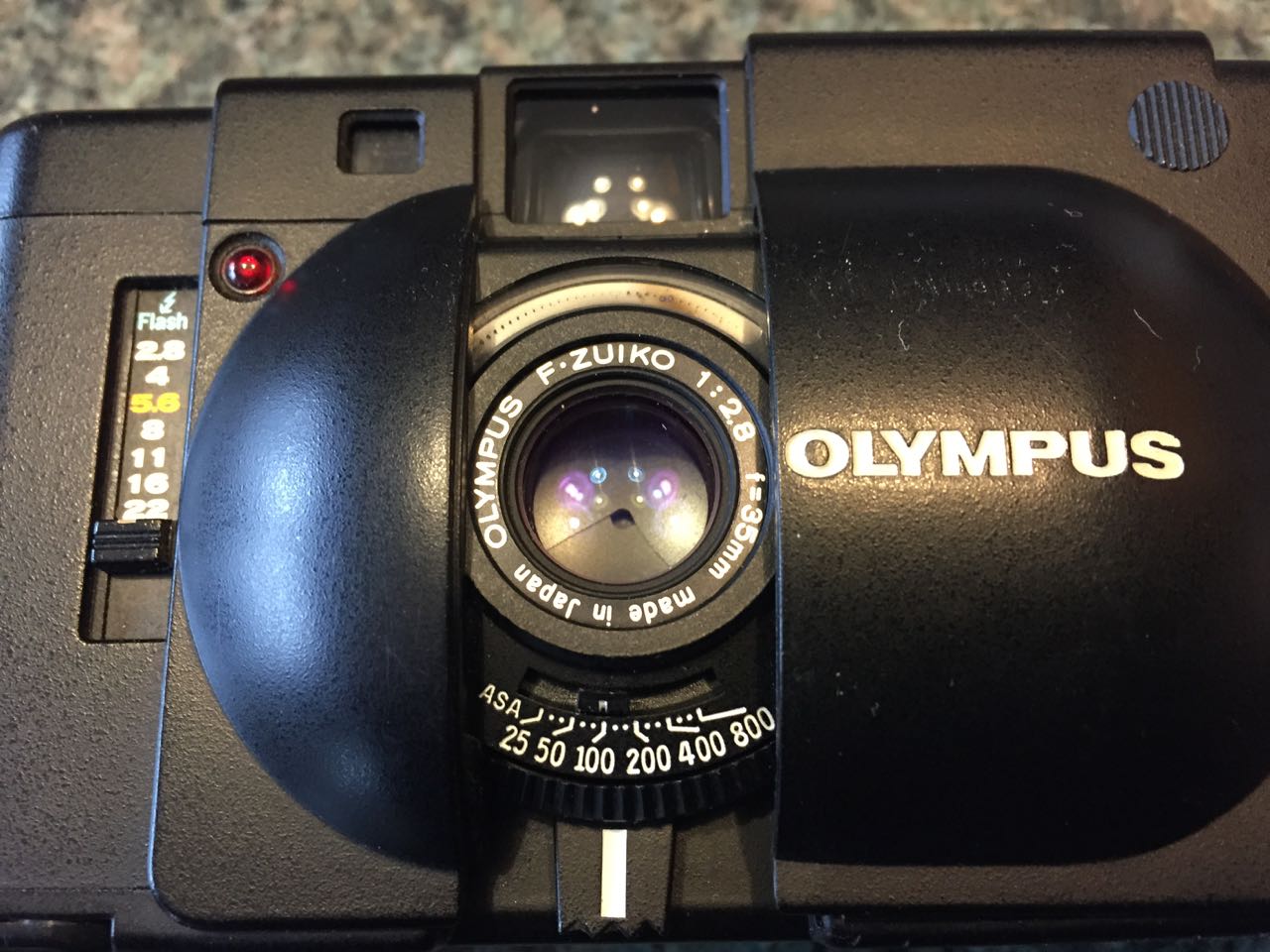

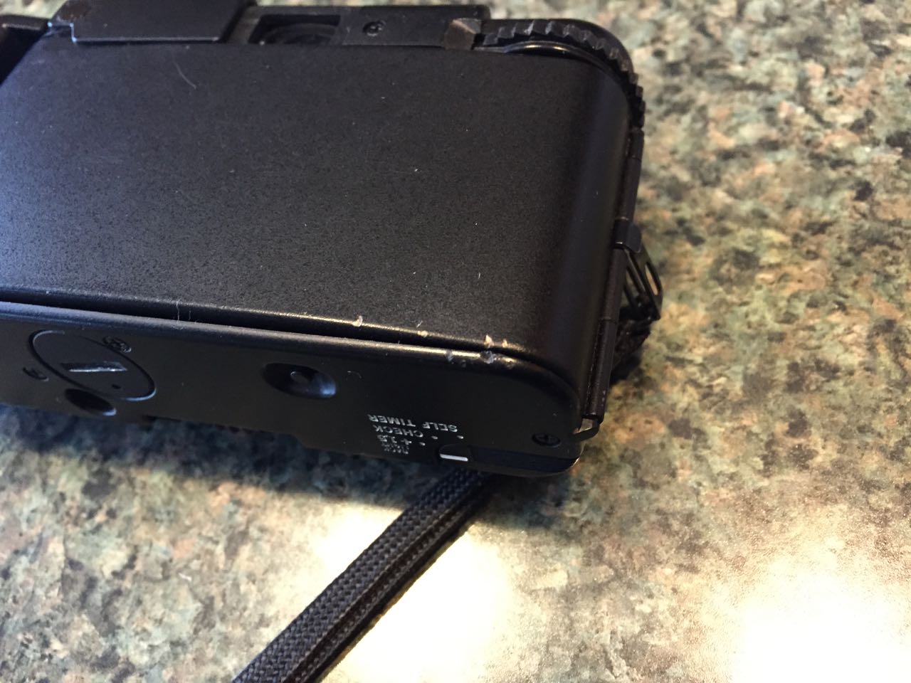

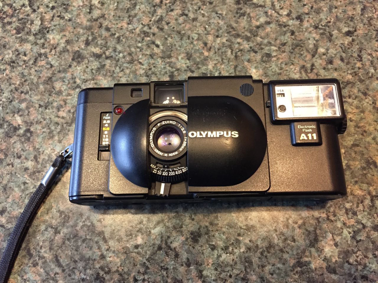

I have this little cheesy Minolta P&S camera, not sure of the model, but it's the one that you click one button and the camera does the rest. It's kind of beat up and ugly looking, but I was surprised at the quality of the photographs.
The camera was loaded at the beginning of January for some pond hockey games in Minneapolis, but I ended up shooting the bulk of the film up North. Ilford FP4+ processed in D76 1+1 and subsequently scanned using Vue Scan and an Epson flatbed. I haven't tweaked the images much in Photoshop, mainly just slight contrast adjustment, dust spotting, and toning that resembles what I do in the darkroom.

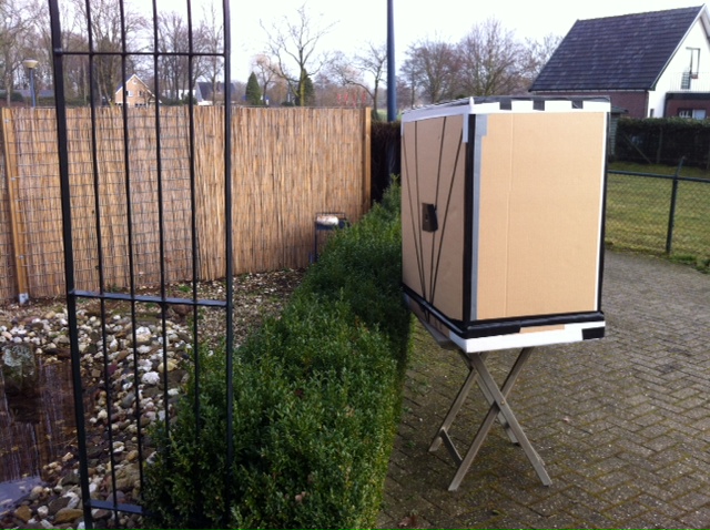

.... This week (Thursday?) I'll make a real exposure and will develop properly (as far as possible with this size since I don't have a tray for it). I hope I'll find the time this week to finish this paper negative and post before Saturday, making the deadline of this MSA at the end of this month.
To be continued ...

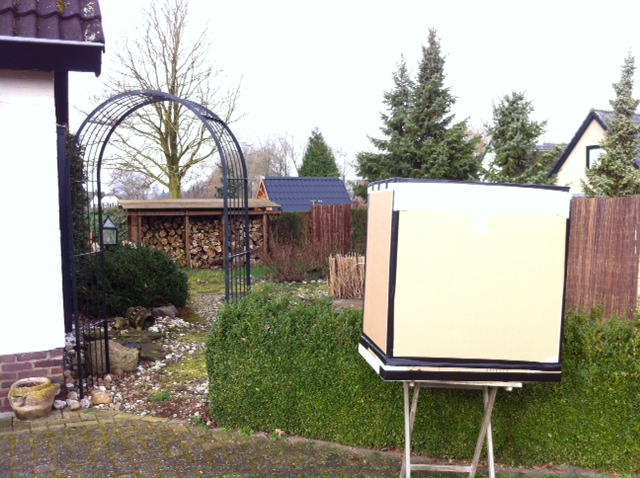

Yesterday (Thursday) was all rain and rain and rain ....
Luckily I had some time this morning because I have to work midday and evening (giving a course). And it is dry this morning!! Even with a very little sunshine through the times every odd moment. So - after finishing preparations for the course) - I took out the 20x24" cardboard pinhole camera and posted it on a table, overlooking my garden. I openend the shutter at 10:10 AM and need an exposure of at least 4 hours (@ f-number 1/1000, ISO 2).
I have to leave in 15 minutes, so I instructed my wife in how to close "the shutter" (= piece of cardboard + tape) in 2 hours and putting the camera inside before it starts to rain again. I hope to be home at 22.00 (10.00 PM) tonight so I can sponge develop the paper negative (20x24"), fix it and flush it before midnight. I'll make a probably bad looking digital photo of the negative, reverse in PS and post the result here before midnight, February 28th - still in time before the closure of this MSA.
Pray for me that it will work out. If not I'll post it on Saturday (one day late). And if the paper negative is any good I'll make a proper contact print later.

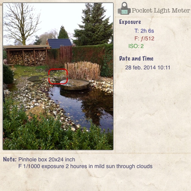

At least here is some proof that I made the shot itself today:

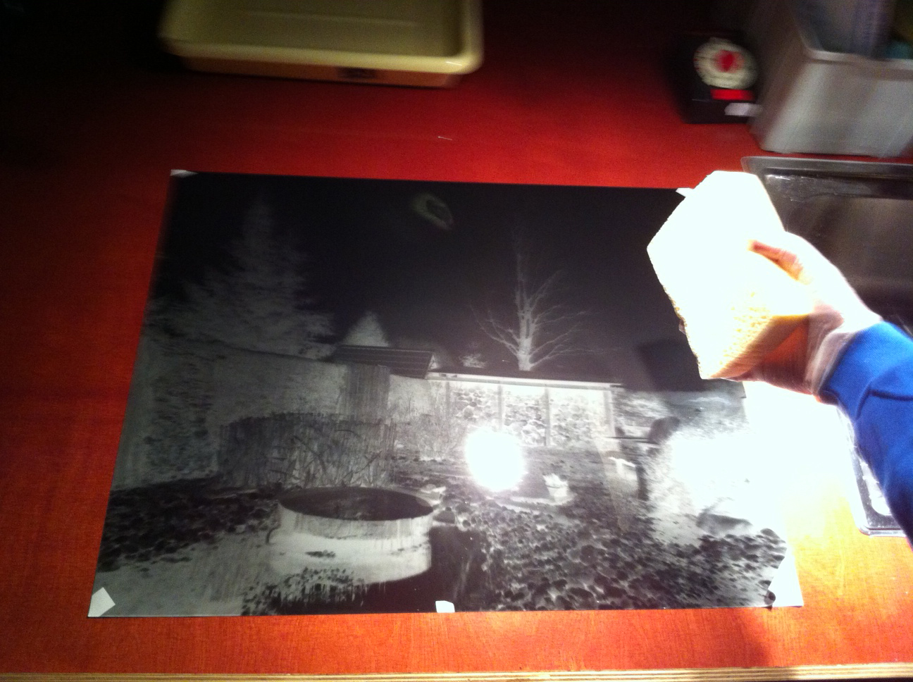

The paper negative was exposed during for 4 hours today. It was a cloudy day with the first 10 minutes some little sunshine. I developed the paper negative this evening. I used a sponge and old, used & left over Maco developer in the dark. I sponged for about 4 minutes with the developer, then sponged Stop for 2 minutes, followed with 10 minutes Fix sponging. Then I flushed the large negative in the bath tub for about 30 minutes.
Using the sponge was surprisingly easy. It is strange to see the developing starting in places where I started sponging. It looked a bit like this:
And WOW: what is this size for a negative impressive!! I've never used such a large negative (20x24 inch), but it makes me wanting to get me a real ULF camera even more!! You don't even need a magnifier to see what's on it.

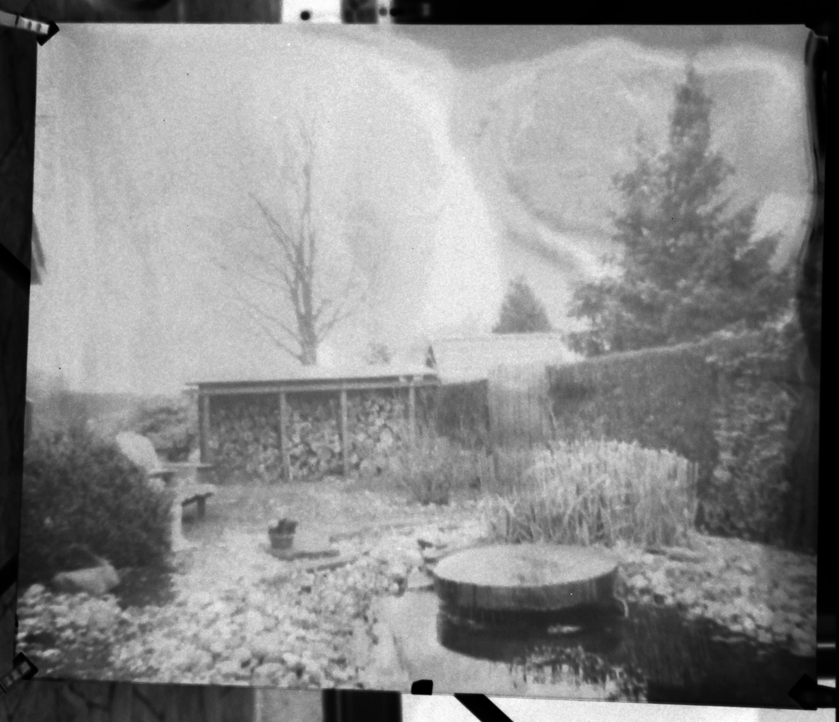

I dried the negative for an hour and then tried to take a digital photo of it. But I haven't found yet how to do this without lamps or whatever reflecting in the negative. I'll give it an other try tomorrow. Maybe I'll think of something tonight.
Here are the first (lousy) results, and yes: posted on February 28th before the official deadline.
I'll try po post a decent "scan" before Sunday night. The original negative is much better and sharper than this poor photograph of it ...
And about the rules of this MSA: Is was cheap, I used a cheap camera and it was a challenge.
The camera is solely made out of old cardboard and outdated Duct tape (not so sticky anymore). No lens used but a simple pinhole (about 0.6 mm) giving me an f-stop of f 1/1000. The photo paper 20x24" is very, very old Ilford RC paper from an opened box that was given to me. I think it expired about 20 years ago. The developer was leftover from a bottle I used before to develop film sheets, as was the Stop and Fix.
The total cost of this project was $0.00 (zero). The fun I had was priceless. This was a fun MSA that inspired me to go further than I did before. I know now that I really can build a camera this big ( next one will be made out of wood), and that I can get the exposure right with paper negatives.
So thank you Adelorenzo for this great assignment!!!

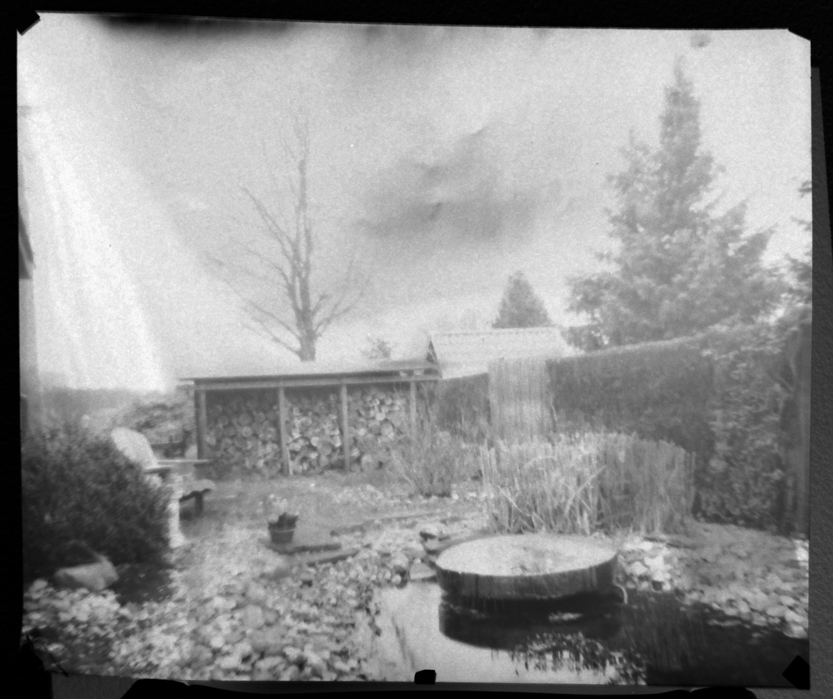

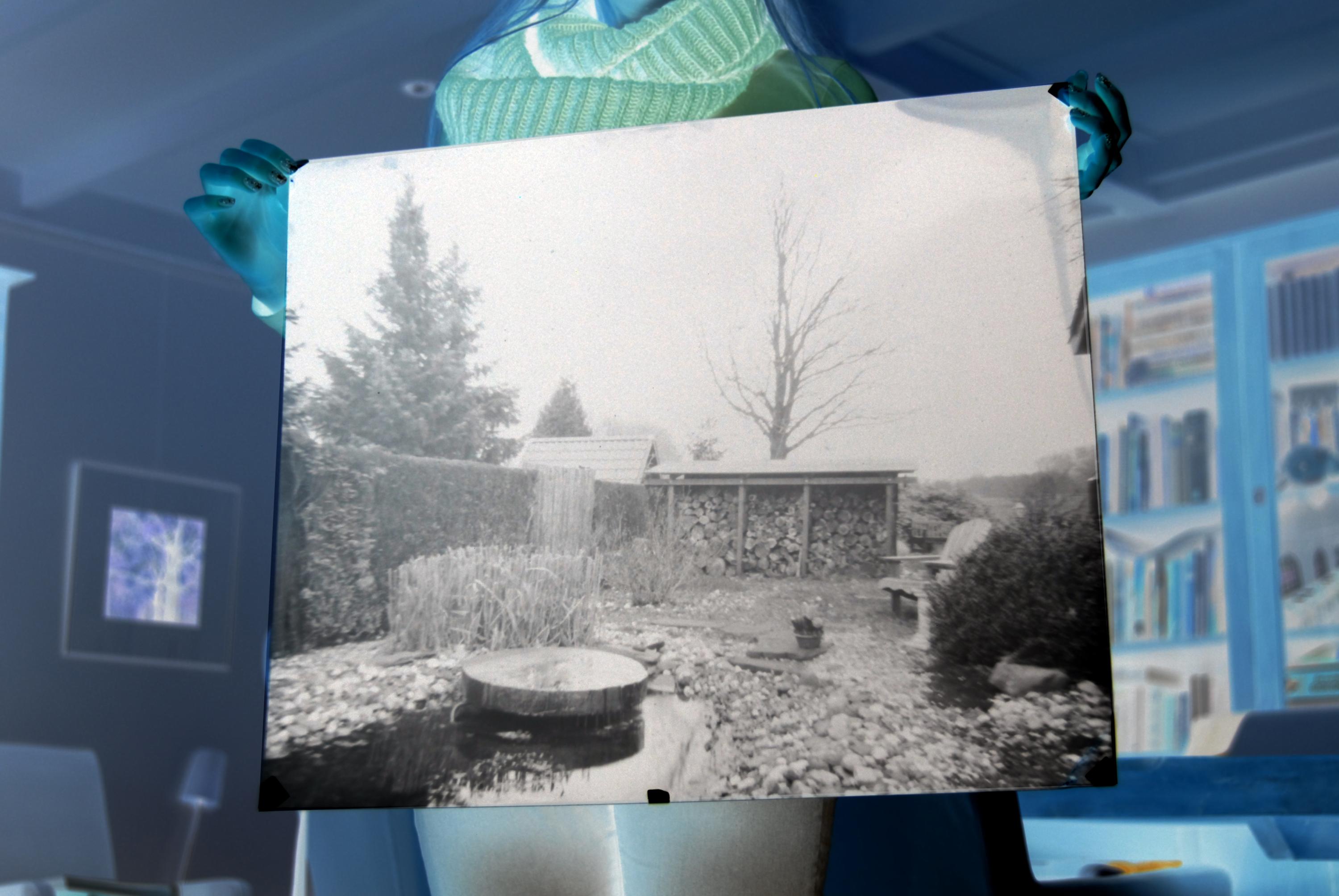

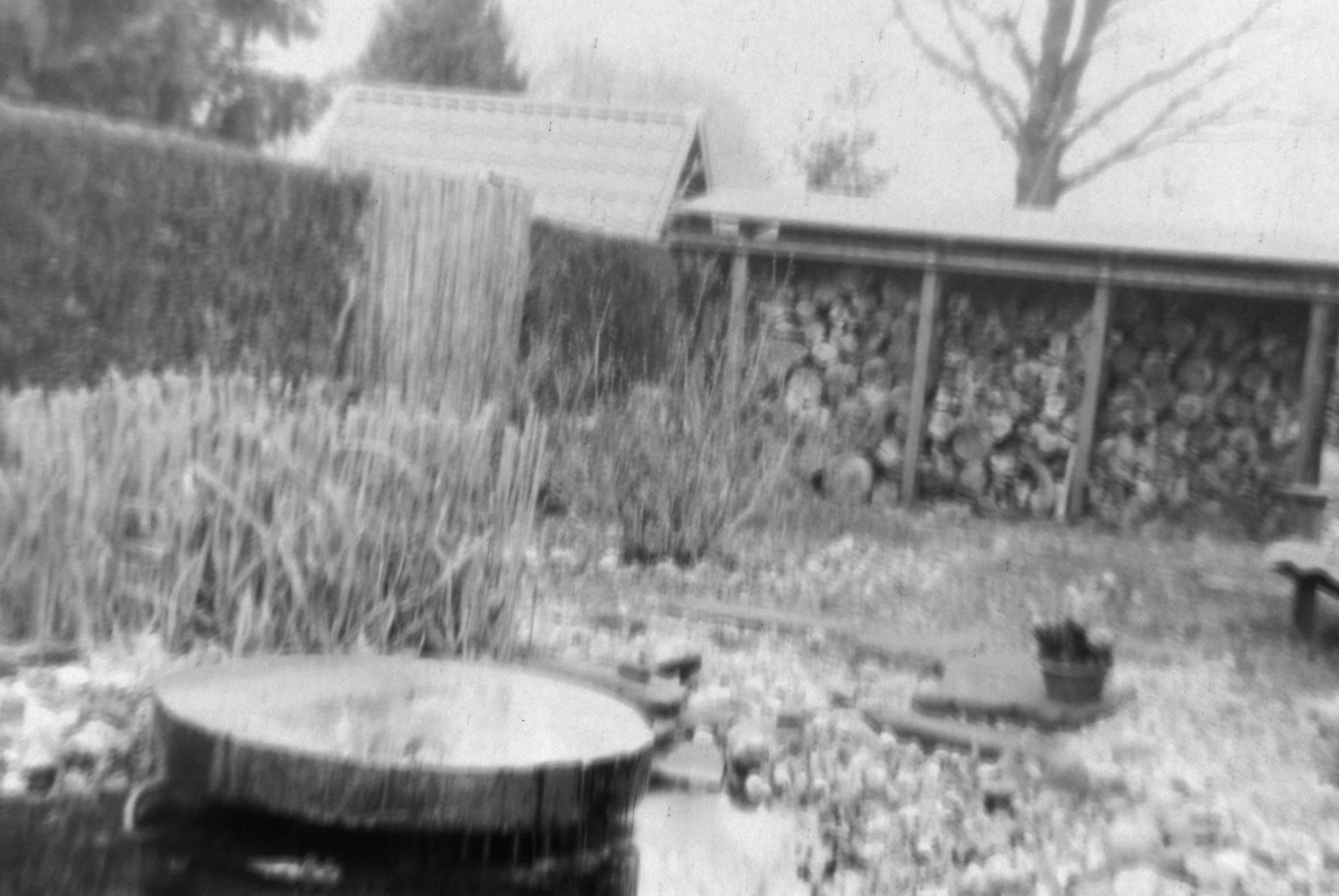

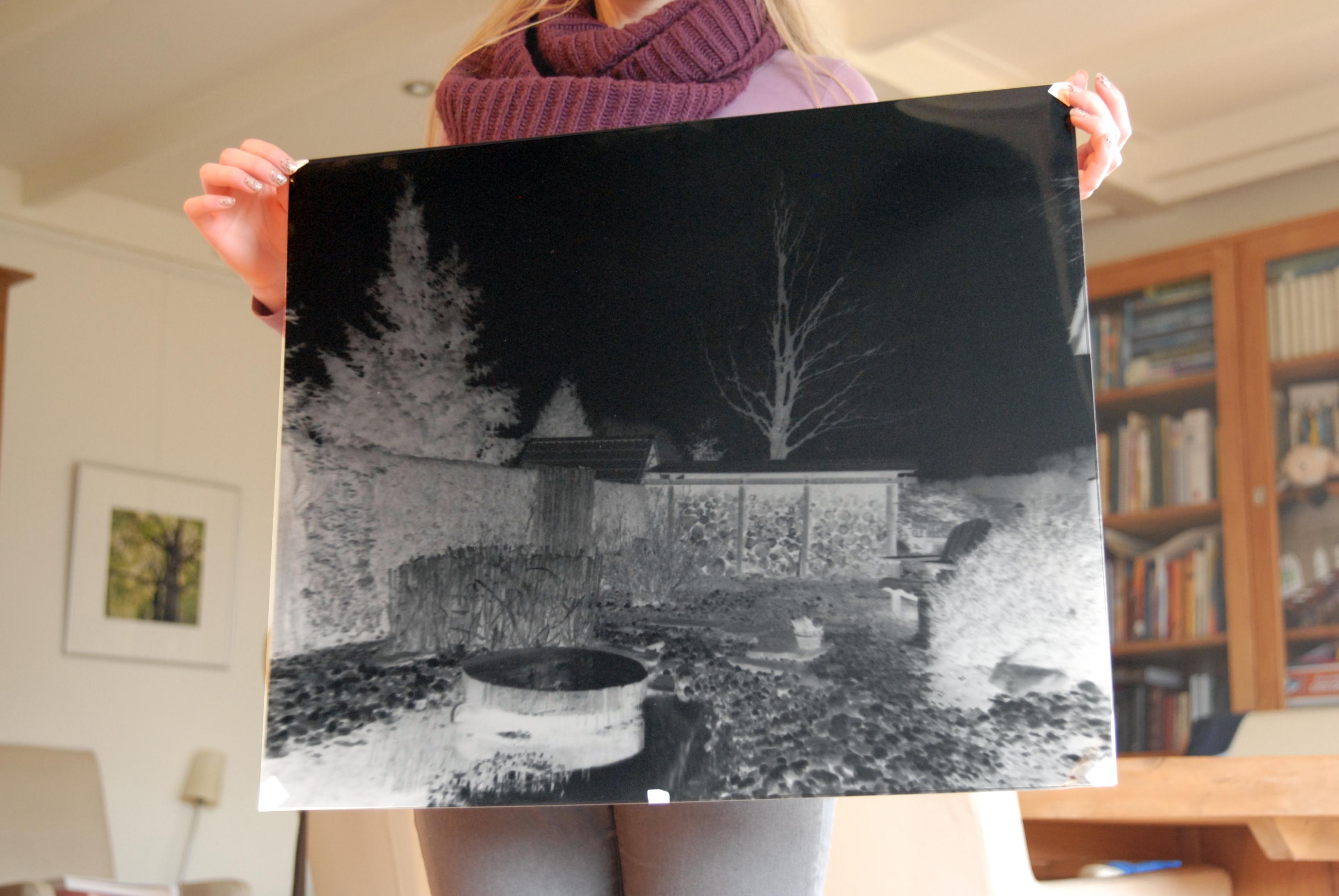

I have tried to make a better photo of the negative, since I can't scan 20x24 inch negatives. But there was always the problem of reflections. This is glossy Ilford photo paper. Lesson learned: don't use glossy paper for paper negatives.
The best try was my daughter holding the negative and have her moving around the room until there were (almost) no reflections:
daughter-holding-20x24-pos_8754.jpg using Photoshop to make negative positive: daughter-holding-20x24_8754.jpg
Maybe this will also help you to get an idea of the size of this negative.
I made a close up shots to show you more details:
excerpt-20x24-pinhole-neg.jpg blow up section: excerpt-20x24-pinhole-neg-blow-up.jpg
The image is rather sharp, but not as sharp as I hoped for (even for pinhole). But this may be due to the fact that the camera is very light and very big and might have been moved by wind during the 4 hours exposure. I'll make a still life scene indoors and shoot it with this camera to test it.
I'll also make a contact print of this negative in the near future. First I must locate a glass pane larger than 20x24".

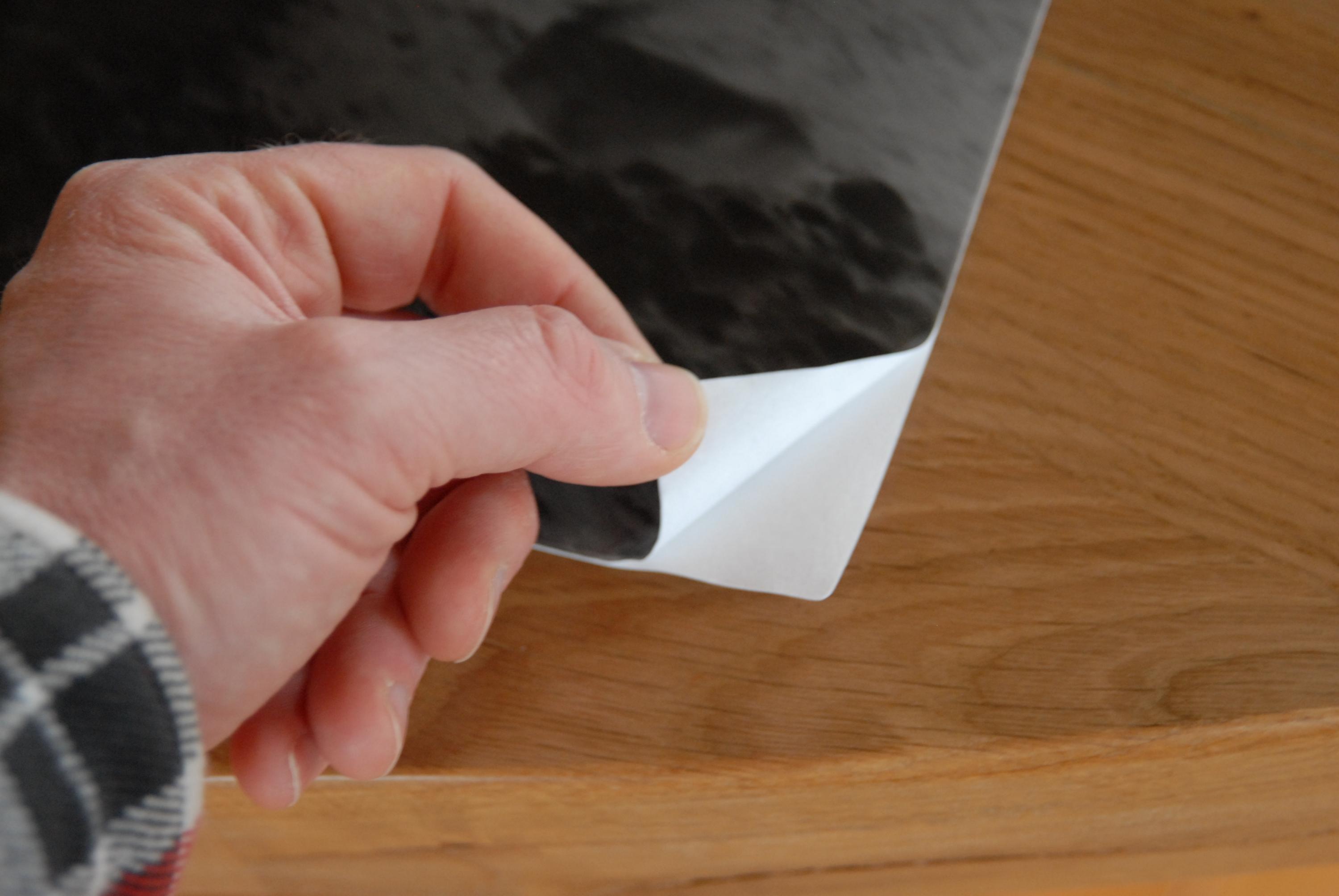

I'll also peel the paper apart: separating the image from the plastic back layer and rub it in with lineseed oil, until it is fully soaked. This will make the paper negative almost transparent, thus reducing exposure times by half for contact printing with alt-photo techniques.
I already loosened the corner:
This works best when the photo has almost dried, but is still fresh.
Well, this will conclude my contribution to this MSA, never thought I would enter a large negative in the end. But the fun isn't over yet. I'll continue on this road ...

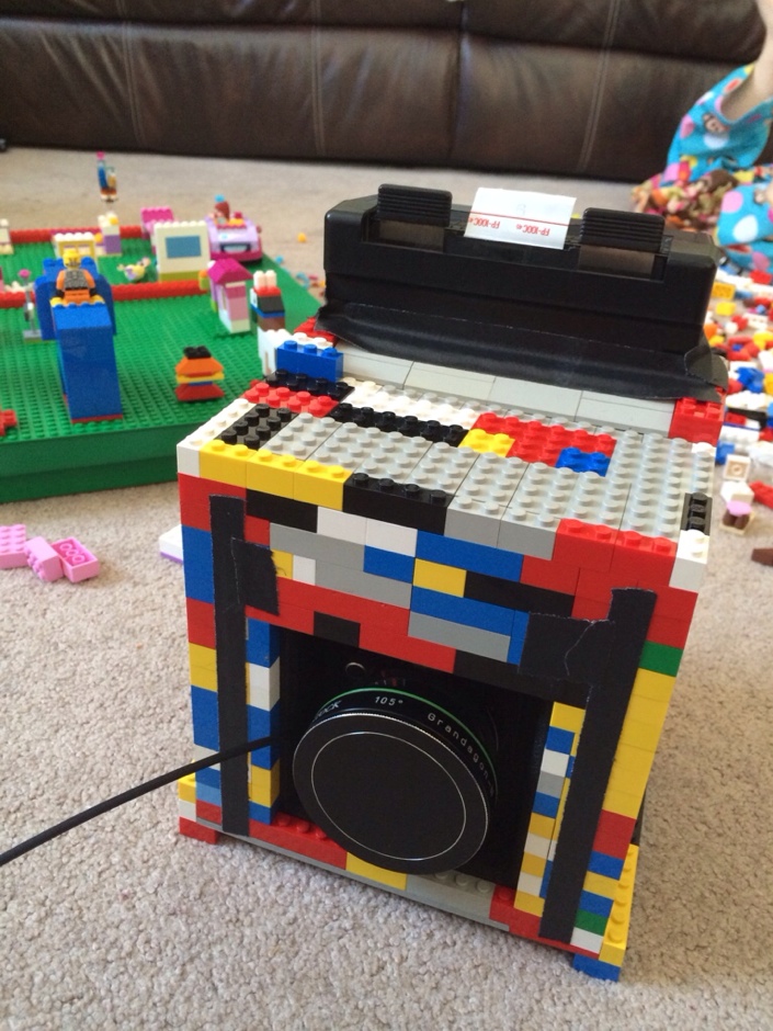

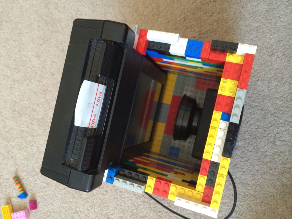

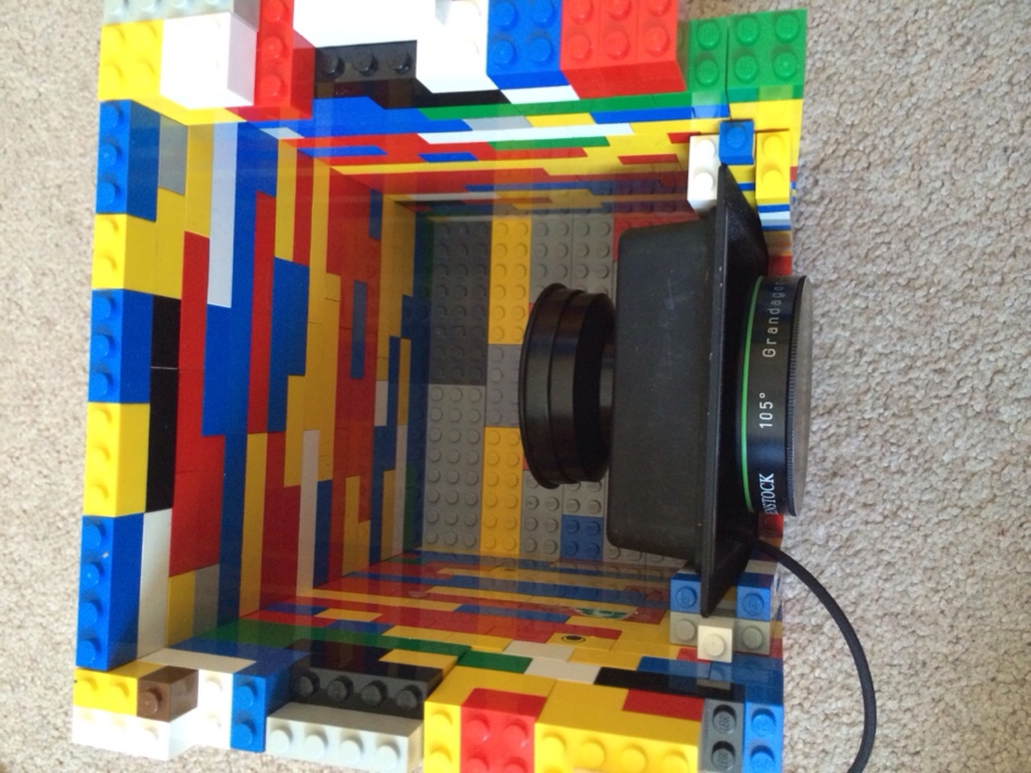

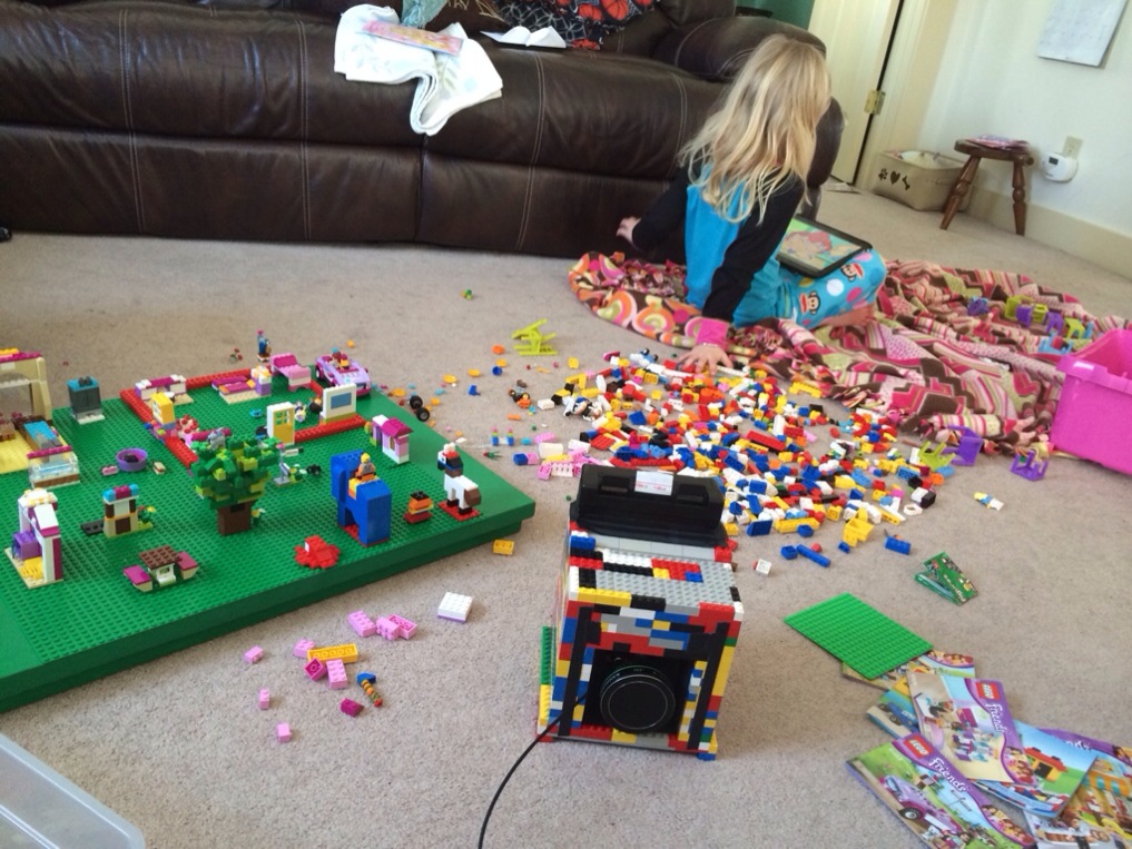

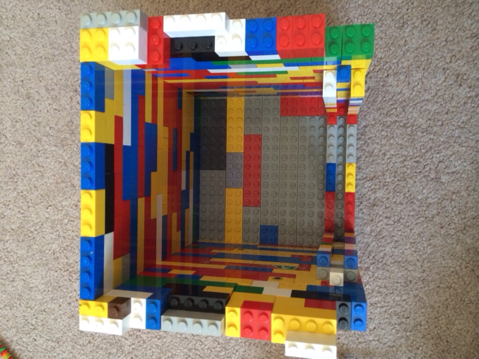

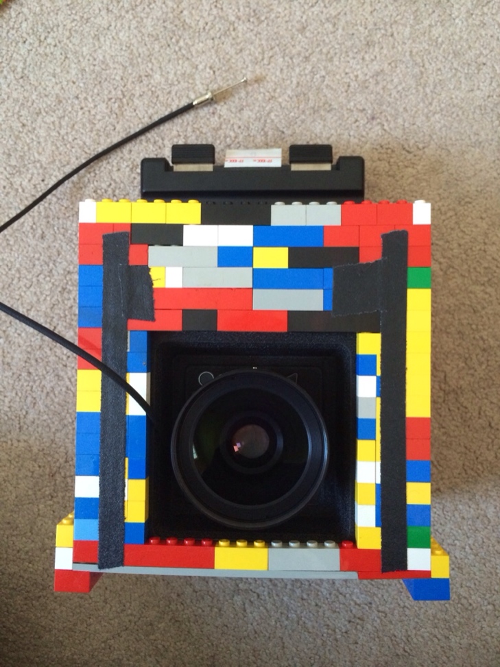

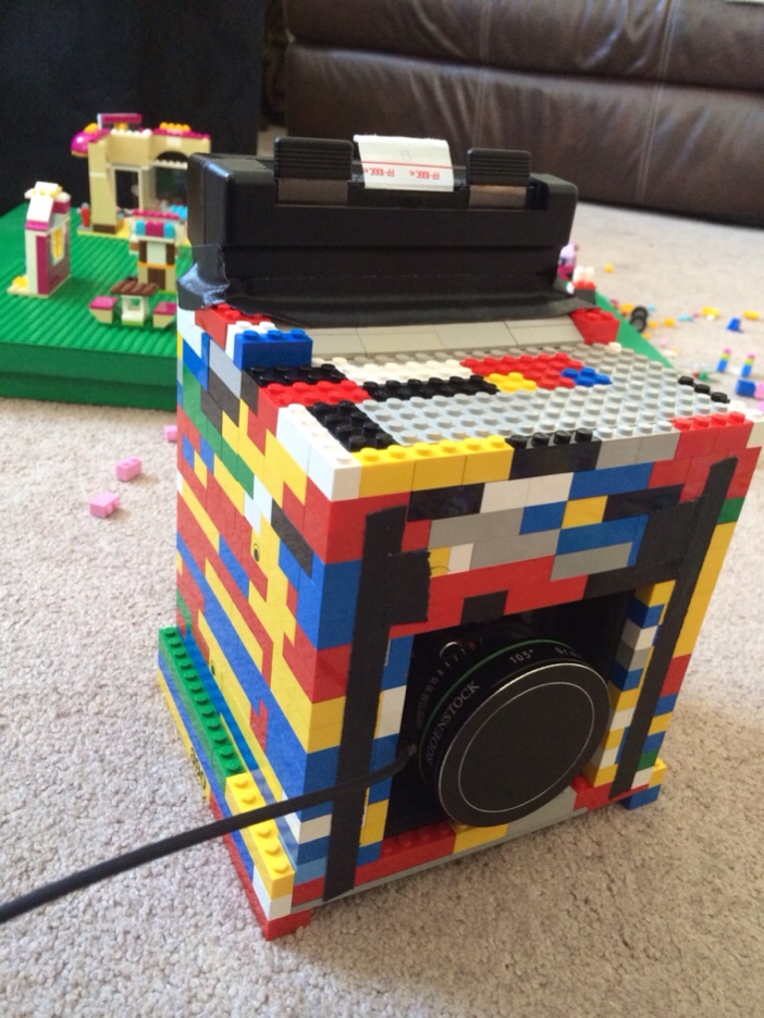

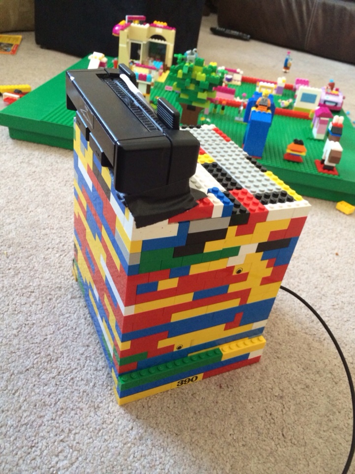

Few! Last minute submission....
It's lame but, this was a hail marry pass...
LEGO camera :smile: built with the little one while she was making a fun lego friends setup I was making a boring square box with lots of light leaks, no focussing, and terrible aim.
Shot on my last box of FP100C45 Fujirpoid film, as I have no film developing equipment where I am so the Polaroid and a cell phone snapshot of the Polaroid was all I had, but it was fun to build a lego camera, if I had more time and more Legos I would have made it focus able and more light right but as is it was fixed at about 15 feet on an ultra wide angle 75mm lens.
And the two image submissions...
ImageUploadedByTapatalk1393733613.591512.jpgImageUploadedByTapatalk1393733620.207108.jpg
Hi Stone,
Nice admission!! Lose the lens and make it a pinhole camera to make it really cheap. It can be done, see:
View attachment 83416View attachment 83417
That's pretty awesome. I'm sure you've seen the focusing box camera made out of legos that's floating around?
Might have to go visit my parents so I can dig out my childhood legos, haha.
I've seen it, but had the idea before that, and mine would have been similar on design but I 1 didn't have enough time and 2 didn't have enough Legos without taking the "girl" Legos from the little blond there in the background... But I was allowed to use the "boy" Legos HAH! :wink:

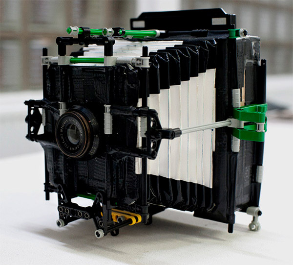

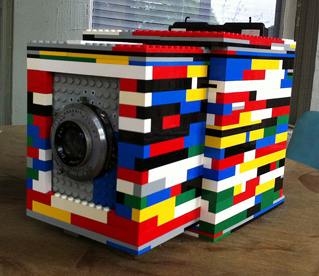

If any of you wins a MSA, you can choose Lego as a theme.
Here some random examples to get inspired.
By doing so we could invite Lego as a sponsor of APUG :whistling:
images3.jpeg duct_tape_lego_camera.jpg images.jpeg lego-leica-m8-camera-01.jpg
images2.jpeg images4.jpeg legoslr-2-copy.jpg Working-Lego-Camera-Build-4.jpg
