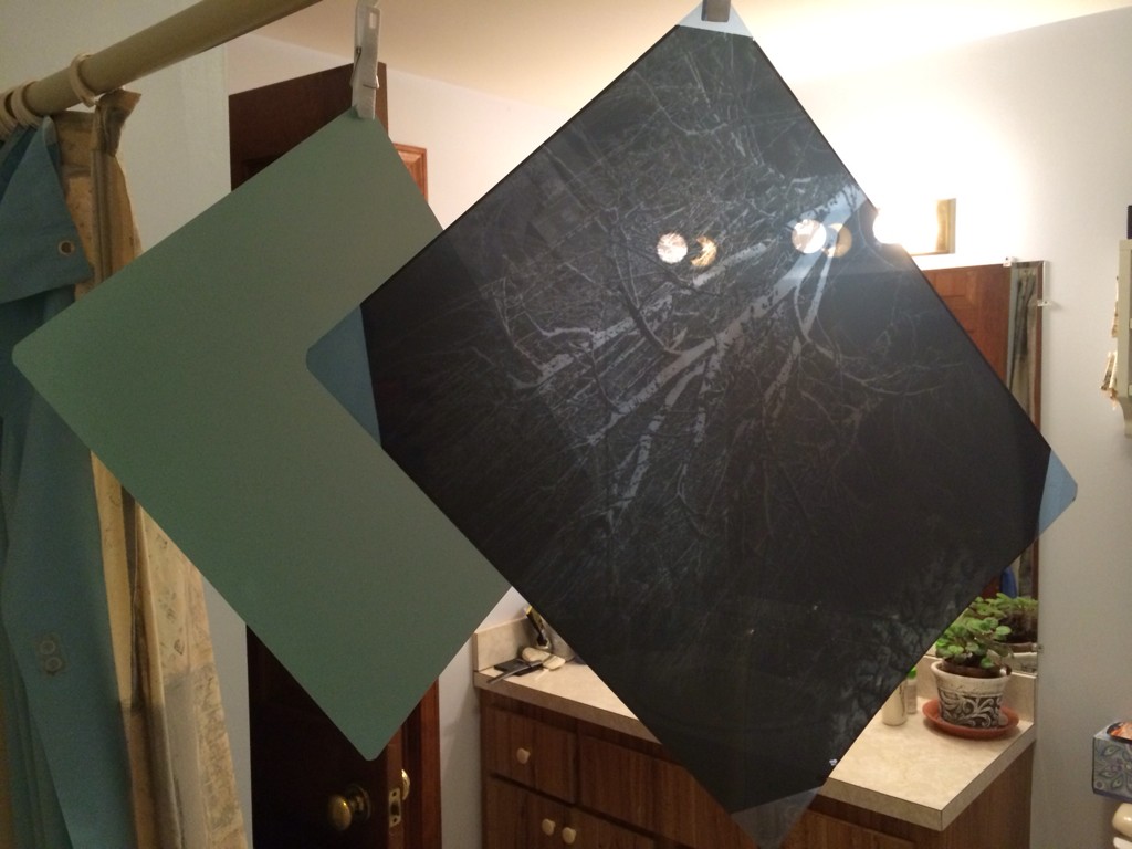

Second try is drying! :smile: it seems a lot more even but still is unsharp, and I went through the process of completely re-doing the "lens" (hole) and sanding and measuring etc.
Well I think this will be my final entry.
It takes me a long time to do this for just one image but it was totally worth it, however I think I'll have to wait until I can get a real lens (and camera) that covers 11x14...
Also stripping the neg is a pain, it's hard to get even development on both sides so you have to strip the side that's against the tube wall.
I do kinda like that the corners are missing, gives it that "custom made" look, but it's uneven.
I had a mishap and one of the sheets fell out of the "holder" so I wasted one (plus travel to a spot to shoot it) and then re-designed the holder to grab more of the edge for the second shot.
This whole MSA has been a learning experience in design and given me a new respect for camera makers and photographers from 100 years ago.
I also totally realized mid way through development that I never heated up the development to temperature so I measured it, and it was at 60 degrees Fahrenheit (instead of my normal 68, so at 6 minutes I dumped and added 225ml (which is all the tank holds) for another 3 minute run (total of 9 minutes at 60 degrees Rodinal 1:50).
It was an estimation of the difference in temperature and the action on the developer. It looks like I guesstimated pretty well (I think...?).

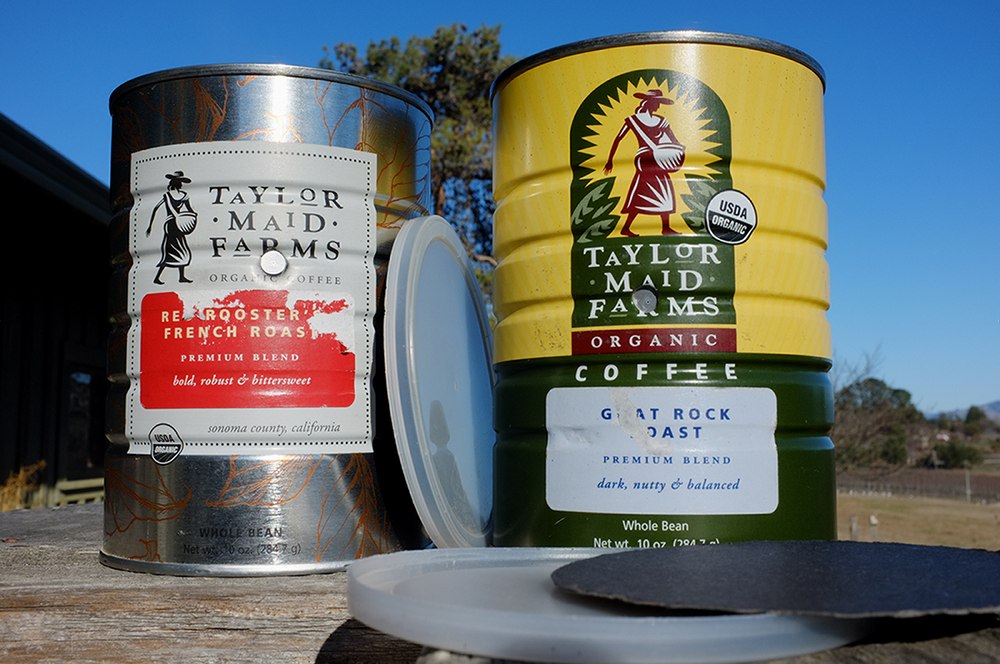

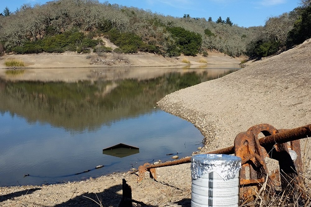

Meet Red Rooster Cam and Goat Rock Cam, two of my favorite pinhole cameras. Sorry they were not constructed just for MSA. Taylor Maid Farms is a favorite coffee roasting company here in Sonoma County, California. I actually roast my own coffee, but friends are happy to save these for me.
These cans are great for pinhole because there is a lip inside the rim to hold a 5x7 paper negative perfectly. The lip also supports a black paper insert as a light seal. I think they are light tight, but I put a small piece of aluminum foil on top as a failsafe, which also indicates they are loaded. The pinholes were made from drink can aluminum, and the shutters are tape. Red Rooster Cam has built in "rise", and if you want "fall" just turn it upside-down! Both are spray painted flat black inside, and I usually use "pearl" paper to reduce reflections. GRC has a distictive blockage on one end, RRC has a shiny spot that makes a flare on the right side of every picture... these are part of the "character" of the cameras and I like them as they are.
You can see a few more photos from the cameras here: http://www.ipernity.com/doc/295785/album/357355
We are having an unusually dry winter, so the first MSA picture is a reservoir where I often walk the dog. I have never seen it this low. The camera location is usually under more than 15 feet of water!
Here is RRC making the MSA photo a week ago:
Yesterday we finally got some rain so here is Goat Rock Cam making a counterpoint photo:
And here are the results. The first is a contact print and the second is a neg scan:

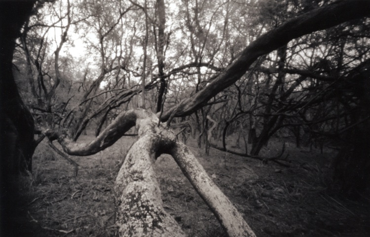

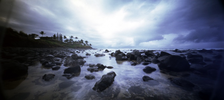

Wow Ned! Those are gorgeous! The oaks especially. As always your pinhole images are inspirational.
Here's a couple more of mine from Maui:
More details about them in the gallery.

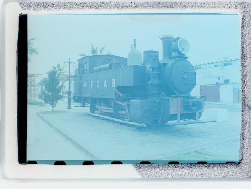

Shot with free graphic pack film but shot with modern camera, scanned using quarters to hold it down instead of the film holders.
GAF-Ansco Super Hypam expired in the 1960's
Shot with my 4x5

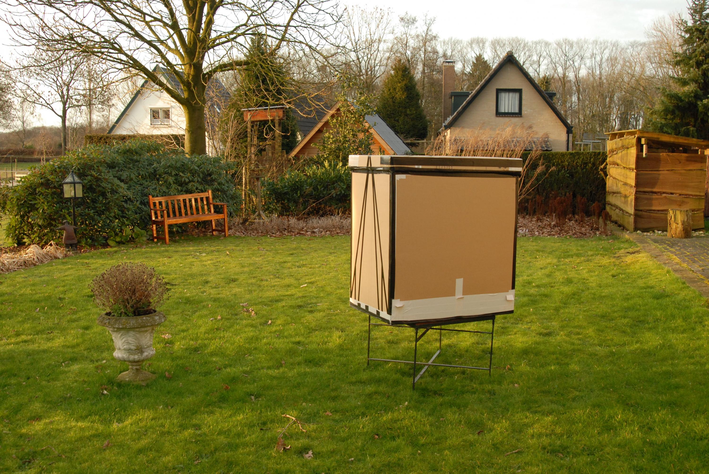

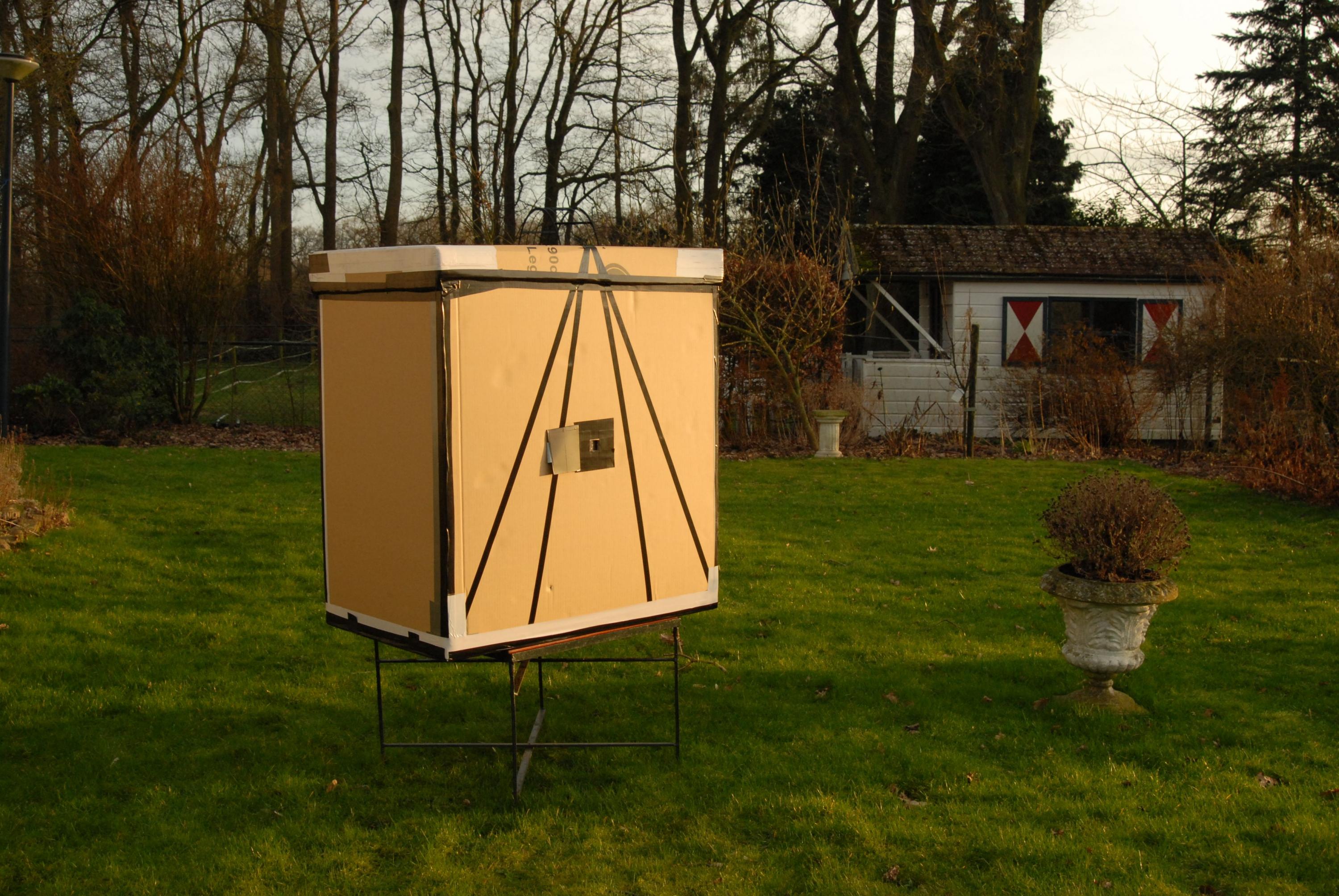

I finally found some time this evening to tinker something for this MSA. I passed my last exams last week (Lean Expert Black Belt) so I don't have to spend all my free time studying and making reports for the exams anymore. So, I made a start today.
I bought a new garden table last summer. It came in two large cardboard boxes each 100x170 cm (40x68 inch), that I saved to build a prototype ULF camera for a Wollaston meniscus lens made by Reinhold: a lens with 790 mm (31 inch) focal length and a diameter of 153 mm (6 inch). It will cover negatives from 1.4 meter/56 inch (@ infinity) up to 1.8 meter/72 inch. The cardboard prototype camera will be a template to build a wooden camera, after I decided on the specifics about the right focal length (bellow draw) to use it as a "point & shoot ULF camera" for landscapes .
But - inspired by Stone - I'm gonna use the cardboard to make a very ULF pinhole camera for this MSA, that I can later transform into a lens camera (maybe).
These are the measures of my design:
- focal length = 600 mm (24 inch)
- pinhole diameter = 1.0 mm
- f-number: 1/600
- negative size: 500x600 mm (20x24 inch)
- angle of view: 66.66 degrees.
I'll call it my "600 pincam" or something.
The pinhole will be made out of an empty soda can.
I was also given an open box of very, very old Ilford B&W photo paper size 51x61 cm (20x24 inch) for free some time ago. I'm gonna use it as a paper negative in this camera. I have no idea if this paper is still any good at all, but we'll see.
Developing will be with a sponge on a table top with some left over developer, since my trays are too small.
Total costs: 0.00!! Since it was all for free. I'll even use some old Duct tape, that was also given to me - instead of throwing it away - for being old & sticky but still somewhat usable. This should fit this MSA theme perfectly!
I started measuring, cutting and folding the the cardboard tonight and taped the first parts together.
The total size of the camera will be 90x98x60 cm (36x39x24 inch) so it will be hugh. I taped the four sides together. This weekend I'm gonna make two lids for it: one front lid with the pinhole and one back lid to tape the negative into. It will be a single shot camera. Maximum negative size will be about 80x90 cm (32x36 inch).
So the Ilford paper will fit in nicely. And when I use three sheets of normal photo paper (30x40 cm/12x16 inch) togehter. I can even make some nice panorama shots (40x90 cm/16x36 inch) for contact printing processes like gum, cyanotype or salt printing.
Or make some multi-pinhole exposures, or ...
But first finishing the simple version this weekend and make a test shot - if weather permits (forcast: a lot of rain and wind). I'm gonna put four old quarry tiles at the bottom for stability. I'll make some snapshots of the camera this weekend and post it here.
And I should be able to post a test shot here before the end of the month, shouldn't I?
Oh, and I must calculate (=guestimate) the exposure times. The exposure factor compared to f/22 is 743 x. That is without reciprocity failure.
I'll rate the photo paper @ ISO 2. An exposure of 1 second @ f/22 compares to 12.5 minutes @ f/600. And an exposure of 40 seconds equals 8.5 hours ;-)
So, making some indoor test shots (on smaller sheets) will take some time... but that's okay: it's my birthday this Friday and I hope to get some books so I can read while exposing the photo paper. Now that I think of it, I could make a setup for a self portrait, reading a book in a chair under some bright lights.
To be continued ...

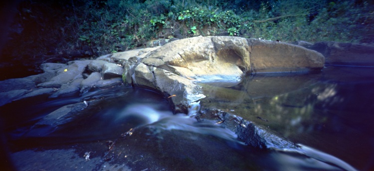

Well, dam, Bert, and all you other build-it-yourself guys, I'm feeling like my Holga is over the top, and downright lazy. I've done lots of DIY stuff in my life, but it's mostly been about gardening, cooking, or textiles. My one attempt at punching out my own pinhole and making a cardboard box camera was very disappointing.
None-the-less, here are neg scans of some of my colour pinhole images. Shot on 120 Lomo film. I assume that's rebranded something or other.

Hello Sly,
Don't look too much at the type of "light tight box" the film was in: it is the result (i.e. the print) that counts!!
And yours are very fine, indeed! I couldn't decide if I liked the first or the last best. The last is a great landscape shot with very nice colours and a beautiful sky. But - because of the composition - I like the first also very much. The second image must be great to print it very, very large (like 4 feet high) and hang it on a wall.
The Holga panoramic pinhole camera is a very good camera, so don't be ashamed. It is still just a piece of plastic with only one guarantee from the factory: light leeks ;-) So it fits right into this MSA.
And good of you to use color films. Pinhole always give some nice off-colours, don't it? I never correct it when I scan the negatives.

Hi Ned,

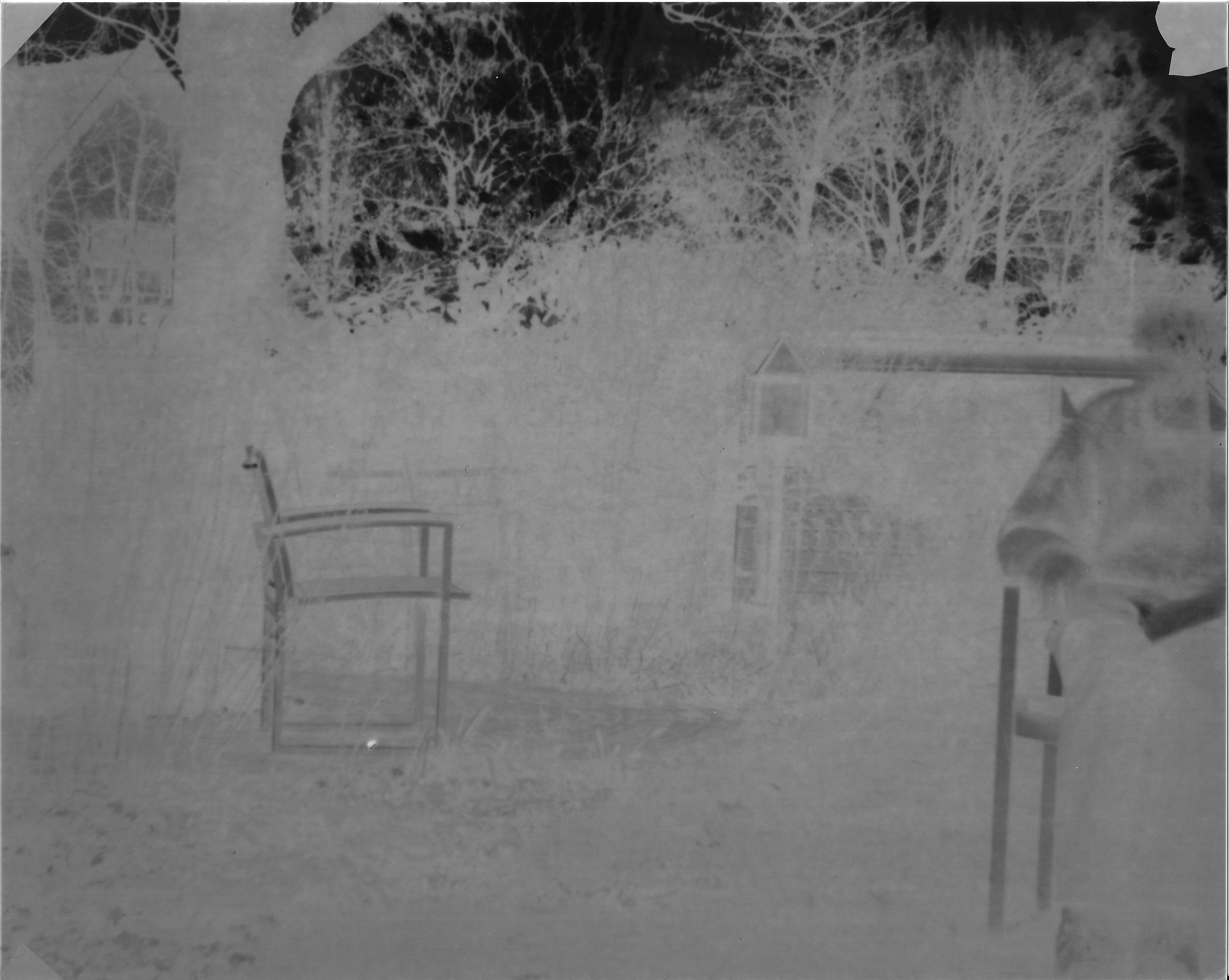

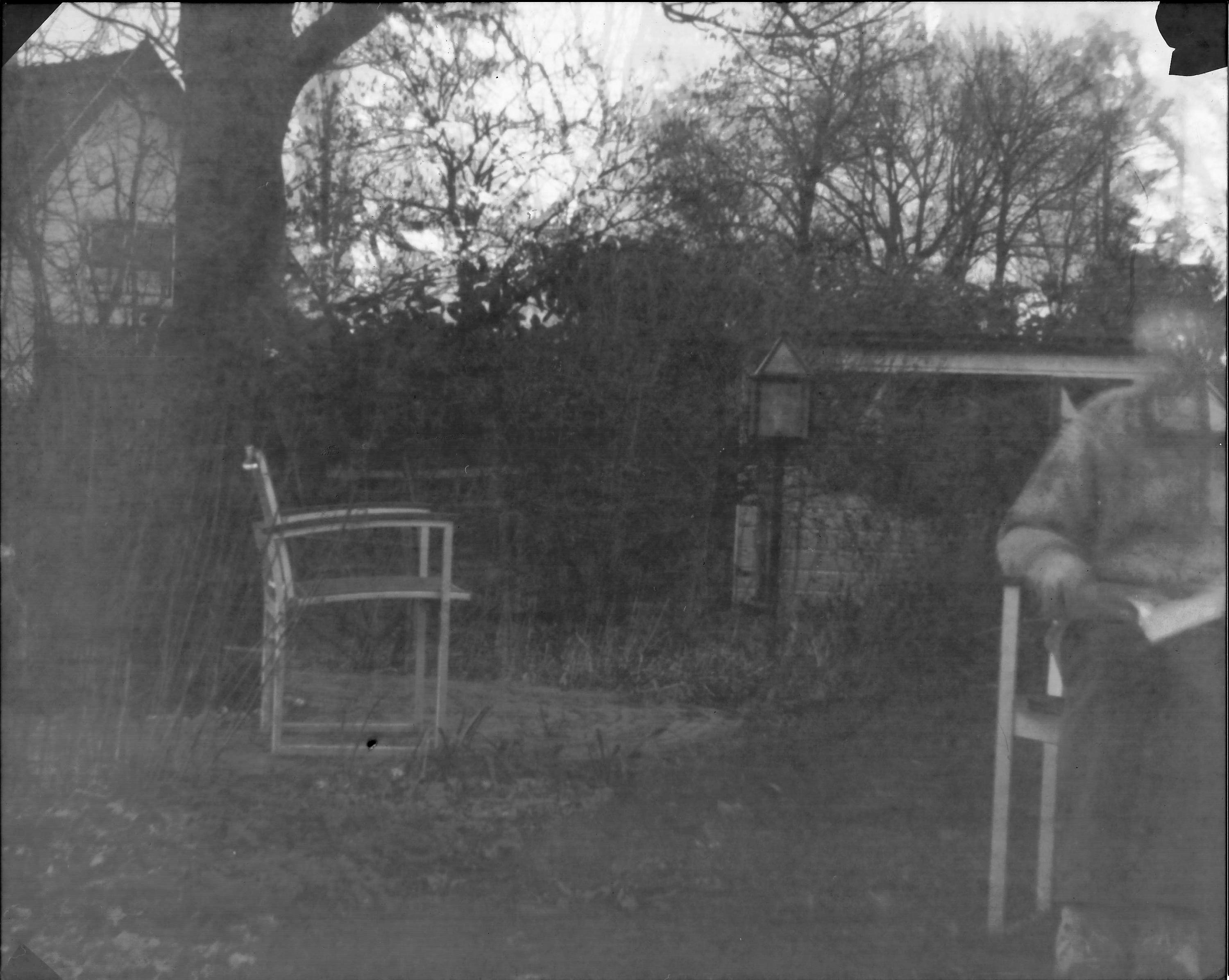

I used even a smaller one (as you suggested): a pinhole of 0.6 mm. I finally taped the whole box together. I even made a large door, hinged with Duckt tape alone! The camera is big enough for me to get inside and fix a pinhole or the paper negative :wink:
I made a quick test shot just before dawn to see if it worked at all. I used a 8x10" Ilford B&W paper first because I have only 9 sheets of the 20x24" Ilford B&W paper. Since I have a f-number of f 1/1000 and ISO of 2 I had a calculated exposure time of 2 houres. It was already 17.20 hours (5.20 PM) and the sun sets at about 18.00 (6.00 PM). But I tried anyway and wouldn't mind if it was underexposed since it was a simple first test.
I placed the camera in my garden, opened the shutter and got me a chair and a book. I sat for about 20 minutes and went inside. I left the shutter open until about 15 minutes after sunset. The total exposure time was about 1 hour. I then took the camera back to the darkroom (wouldn't almost not fit through the staircase) to be opened under a darkroom safe light.
And then the light bulb popped ...
So - in total darkness - I opened the camera, took the paper negative out and dropped it in the developer tray. Luckily I always work from left to right so I new what tray would be the developer. After counting out loud I pulled the negative after 1 minute and dropped it in the stop and fixing tray. Then finally turned the light on to see if there was anything there. And there was!
So - for an totally unprofessional test - I was very happy, since the camera worked. the negative itself is underexposed off course, but there is a nice sharp image. I turned off the light again and loaded the camera again in total darkness with the 20x24" paper and taped the camera up again.
This week (Thursday?) I'll make a real exposure and will develop properly (as far as possible with this size since I don't have a tray for it). I hope I'll find the time this week to finish this paper negative and post before Saturday, making the deadline of this MSA at the end of this month.
To be continued ...
This is the test negative (underexposed & improperly scanned):

... almost not fit through the staircase...
:D Fantastic, that is a huge pinhole camera!
Looks like it is working very well. And you had an adventure developing, but it worked! Can't wait to see results from the BIG negative. That will be a challenge to develop and also to scan or photograph or contact print!
