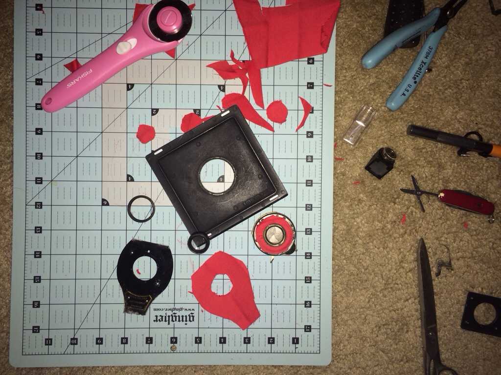

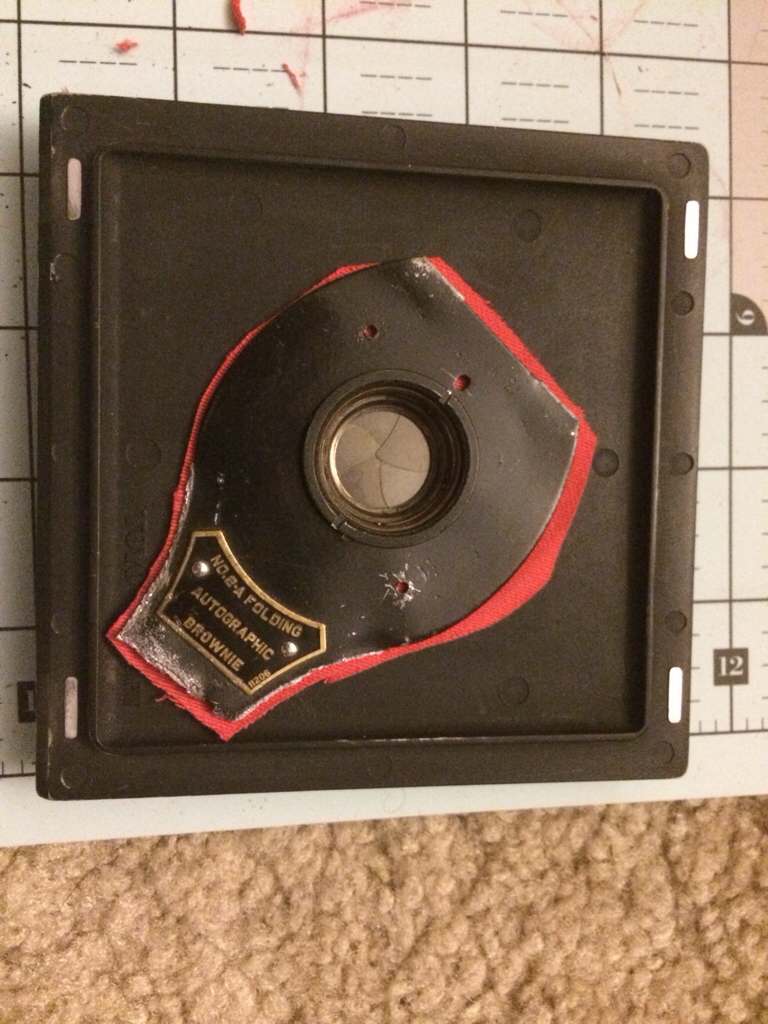

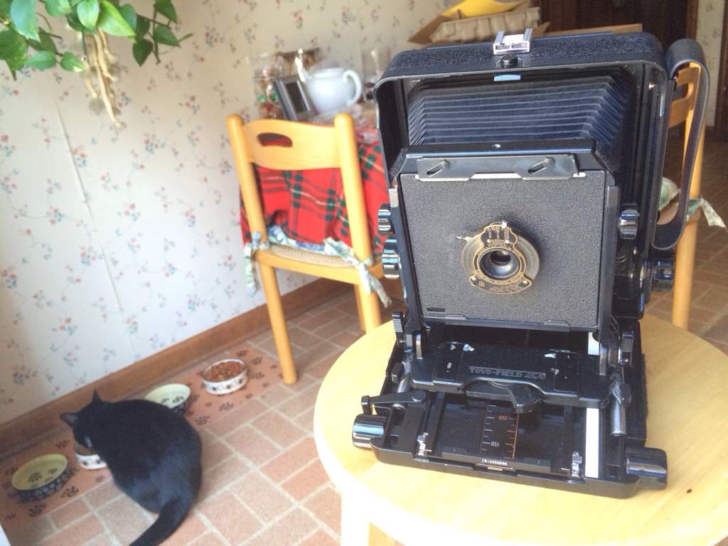

In pieces

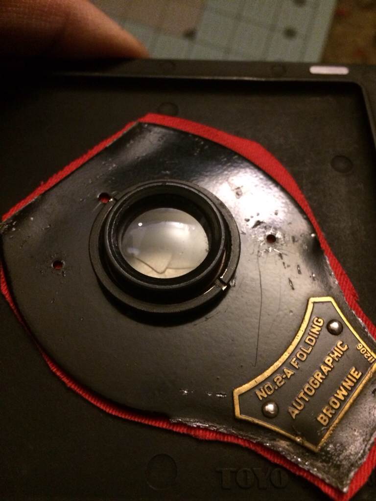

Shutter in
Element in
Tada!!
Kodak 2A folding Autographic repurposed, 1/25, B(not working), 1/50, T, 1/100

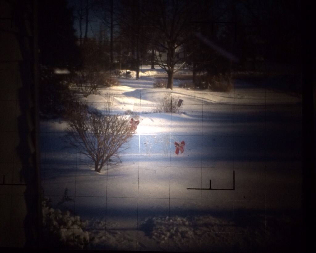

Seemingly no light falloff (cell phone example is bad) AND movement capability...
So excited to try this!!
I don't know what focal length this lens is but my other one (that has a nice filter thread but also is in better condition and I wasn't willing to sacrifice) was 130mm I believe, so about that.
Stone that looks awesome. I have one of those old Autographics and that would never have occurred to me. Can't wait to see what you can produce with it.
Thanks, it's a 116 not a 120 and so I figure the image circle would be big enough for 4x5 with a little nice vignette but it looks like it actually covers way wider than that. We'll see though.
The red cloth is duvytine, I know you are supposed to use black, but I have a ton of this red lying around so just figured I would use that instead and it's mostly recessed so should be fine to prevent any light leak and not reflect too much light.
I'm mostly worried about metal particles getting caught in my toyo body, but I think it's ok, we'll see how it goes.

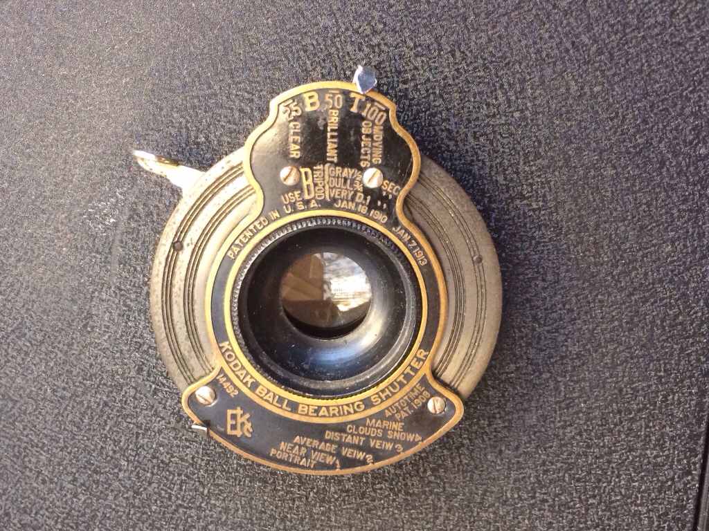

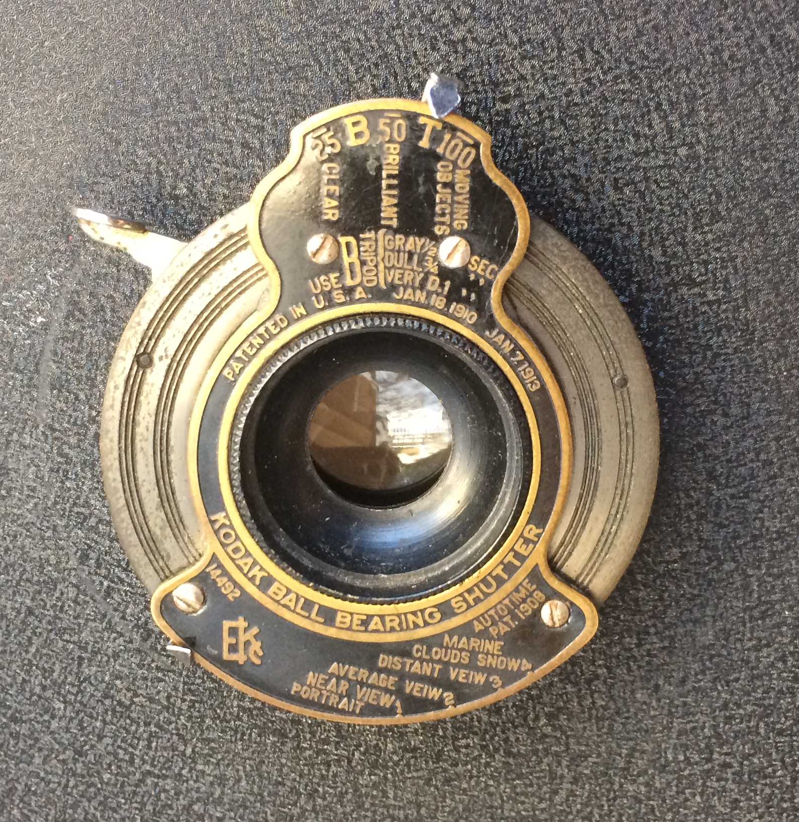

Shot with this lens...
Graflex Holder Image #4
TOYO45a, (Kodinar? still confirming) 122mm f7.8 shot at "#2" stop (f/16? still confirming) @ "1 Mississippi".
TMY-2 in Rodinal 1:50 "Tea Time"
If you look at the difference between the two images up close you can see degradation in the edges as far as sharpness, and even at the sharpest part near the top of the kettle, the Schneider does better, however for a lens that was made in the late 1910's for a 116 brownie folder, not 4x5, I'd say it did fairly well.
