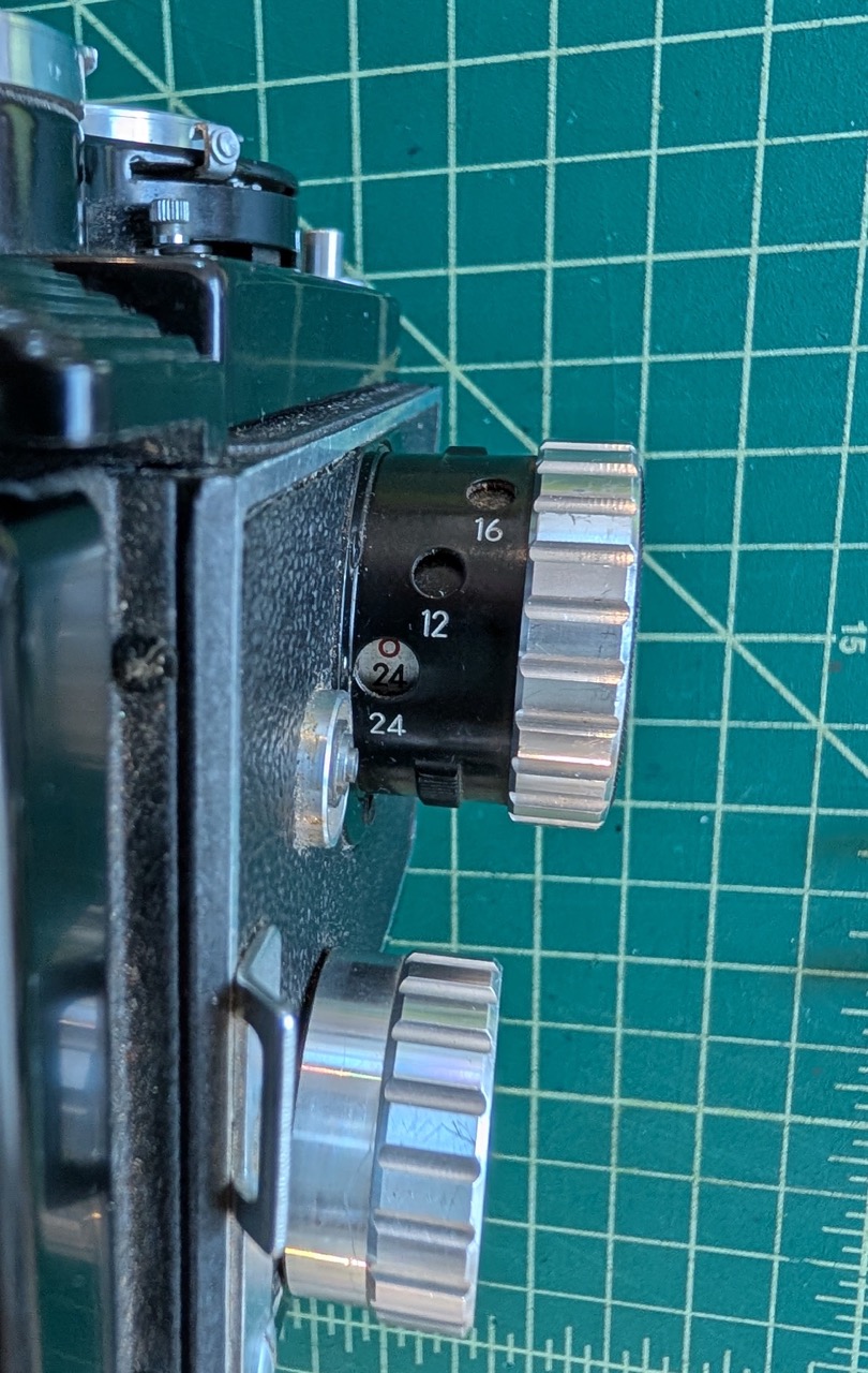

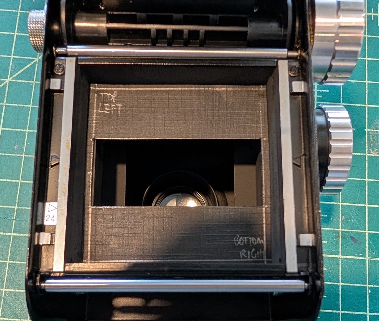

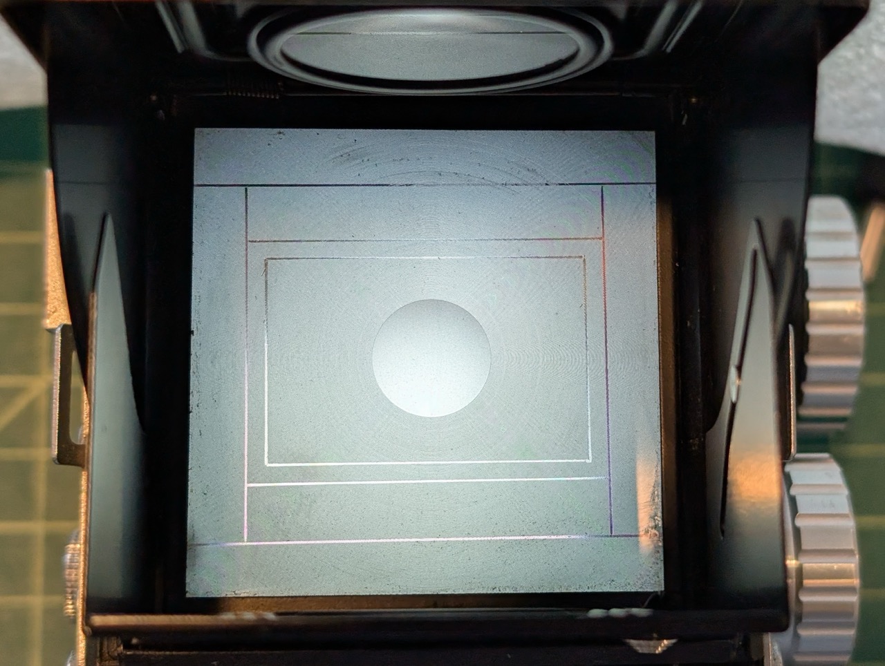

I found another odd TLR (Kallovex) that natively supports 24 frames on 120 film, as well as proper masks on ground glass. So I made a 24x52 pano mask for the film gate, and now I can get 24 frames of pano.
