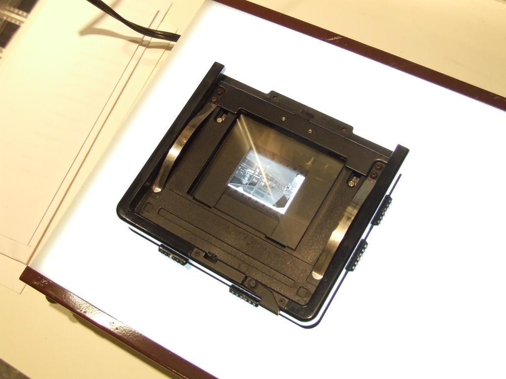

Converting a 6x9 folder is a good idea, since it only needs to mask a small portion of top and bottom (3.75x9) to make 2.39:1 anamorphic ratio. And it is compact enough to bring along trip. There are high quality lens choices out there, together with red window. But the focal length will be limited to 90-105mm.
Mamiya C3 is good since you can get 55mm and 65mm lens to get wider angle view. And I see you already made it working for you.
Another high quality TLR with red window is Ikoflex with Tessar. They are quite inexpensive nowadays, and quite compact.
I tried 35mm panorama in Pentax 6x7 with 45mm lens, and it is seriously high quality. I can imagine it matches XPan. And you get all kind of lens options, and WSIWYG. But it is big, heavy and bulky.

For the Mamiya C, you should be able to put the finder mask into the recess in the base of the waist level finder - it is intended for masks and exposure adjustment plates.
I took off the entire hood and put the paper under it. Can you clarify how I would go about doing it your way?

Trying to modify or replace the darkslide of a Mamiya RB67 or Press film holder, you will find that the RB67 and Press darkslides are made of very thin sheet steel. A 4x5 darkslide is thicker and won't fit. I believe the 4x5 darkslide is also thicker than the Graflex RH slide (I have tried). Best bet would be to get a thin sheet of stainless steel and make a new darkslide. The challenge is keeping it flat while/after cutting, and finishing the edges so it doesn't tear up the light trap. You can cut the outer shape with a guillotine style sheet metal cutter, but cutting the internal edges of the "window" neatly will be hard, unless you have access to a milling machine or a Dremel and a steady mount.
Trivia: Even with the Mamiya C330 cameras with auto shutter cocking, you can also cock the lens manually (just a bit awkward), so it could work.
Couple of remarks: The cut down dark slide idea is something that people use to shoot two 4x10" panoramics on one sheet of 8x10" film. I think usually they cut half of the DS entirely off rather than making a window. You need an unmodified dark slide as well to remove the holder from the camera, of course. I have not done this myself.
Confirming that you can do with with the C33. My C3 is a bit of a beater so I figured I'd mess around with the one that has already been messed with.
I'm wondering if one can accomplish this with a Mamiya C330 by combining the multi-exposure switch and advancing the crank 1/2 turn for each frame?
One would need to manually cock the shutter every second frame (at least) and it may mean that only 23 frames would be available.
The C330 (and C220) have the advantage of always requiring the same turn of the crank for each frame advance. Other Mamiya C series cameras may be the same - I don't know.
