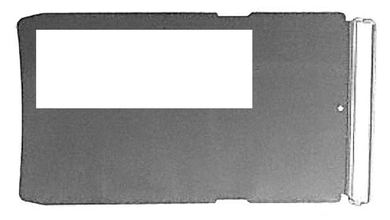

This would work well with a Mamiya Press if you had an extra dark slide and cut it in half. You could put the dark slide in, take one photo, then flip the dark slide over for the next photo. Something like this:
