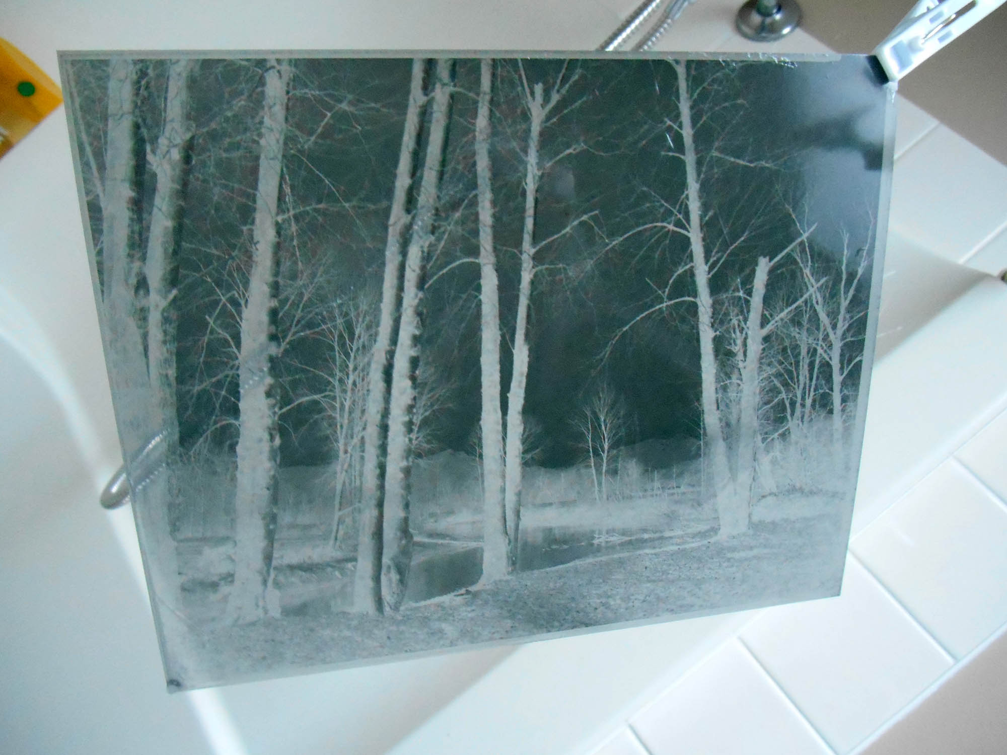

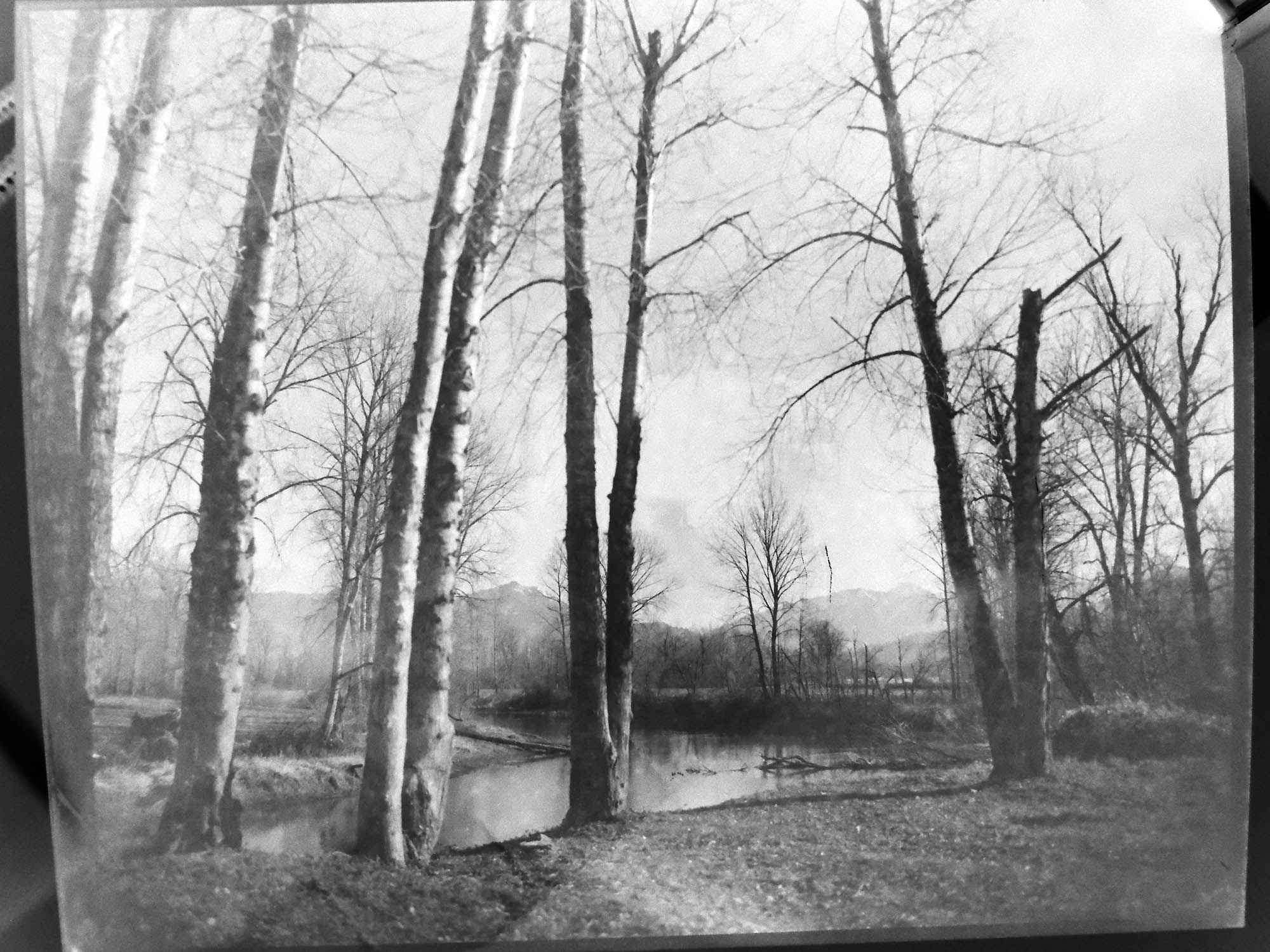

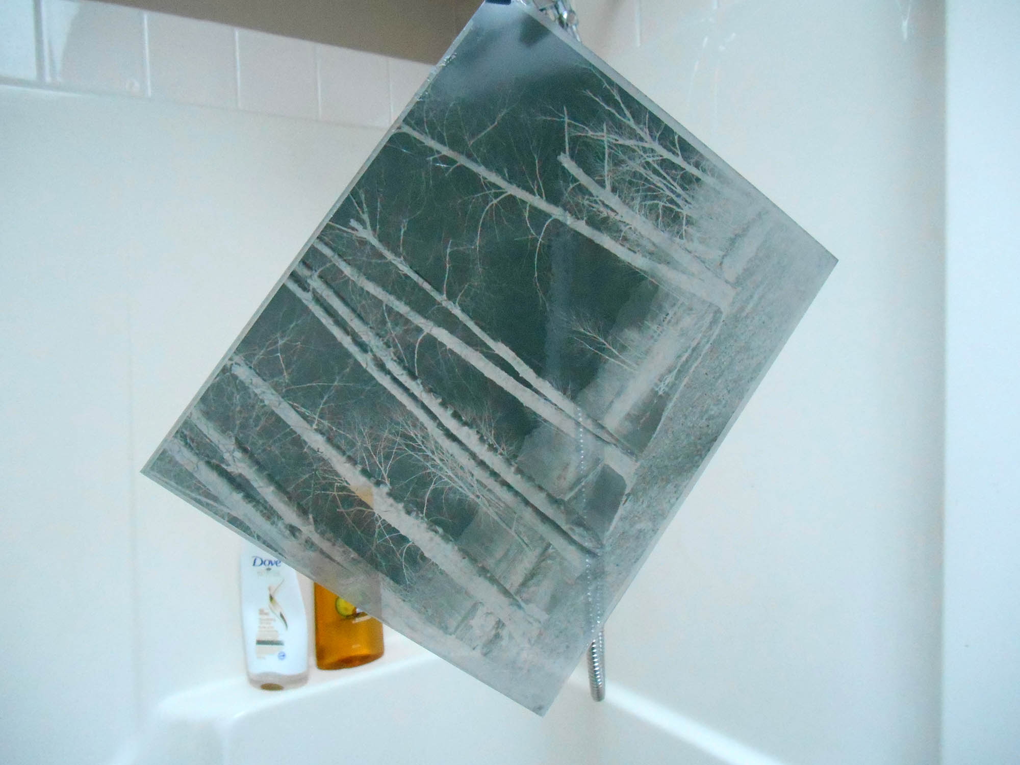

Well I shot my first 2 sheets on the camera today. The lensboard I bought wasn’t fitting into the camera properly. I'll have to get some wood shaved off it to fit. I had the board that was given me with a modified adapter, so I used my Fujinon 210mm 5.6 lens which is wide angle. Took my two shots. The rail wasn't rolling too well when I tried to bundle it all back up.
Developed 1 sheet in Xtol straight. I still have the other sheet to do, but my Unicolor paper drum is leaking. So I was only able to use it the one time. Needless to say the film sheet turned out ok regardless. Its still drying as we speak, but here are a couple pics while its hanging in the bathtub.

As you work at it, it will improve. Good start.
If I ever win the lottery, an 8x10 camera and suitable lenses and kit is on my short list. 4x5 seems so small these days...
