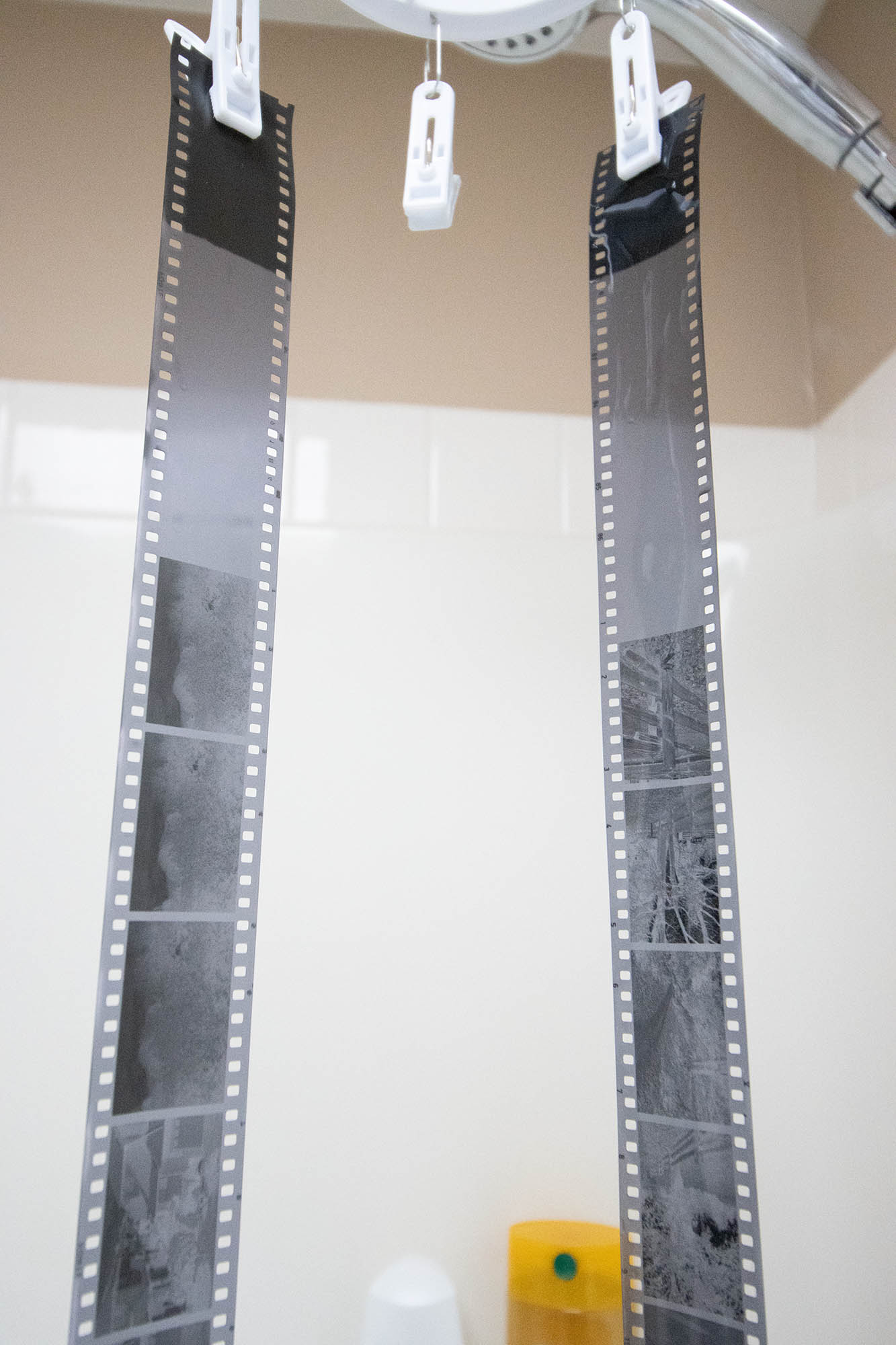

Well the films are hanging to dry. I think I did pretty good for a first try in 24 years. The negs look a little denser then maybe they should be, but not by much. The unexposed portion looks darker then normal, but that could be film film age as one roll was 20 years old and the other 10. Here some pics of the negs. The one roll of Classic Pan I shot at 400, and the other of Forte 400 I bracketed exposures from 400, down to 100 in 3 shots. So this could be why some are more dense then others.

BrianShaw
Nov 30, 2005
16,981
La-la-land
My film drying cabinet has the same shampoo bottles!

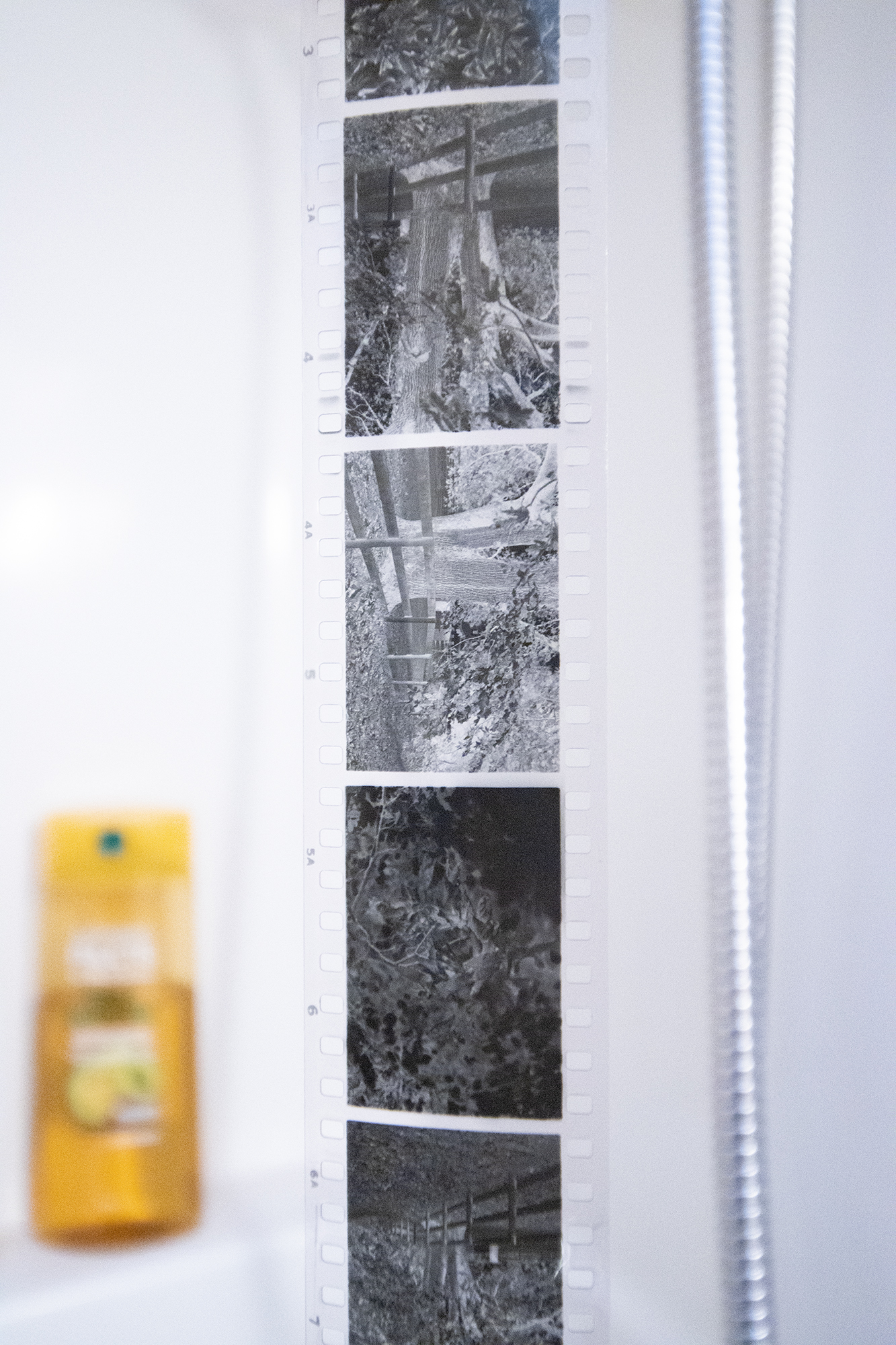

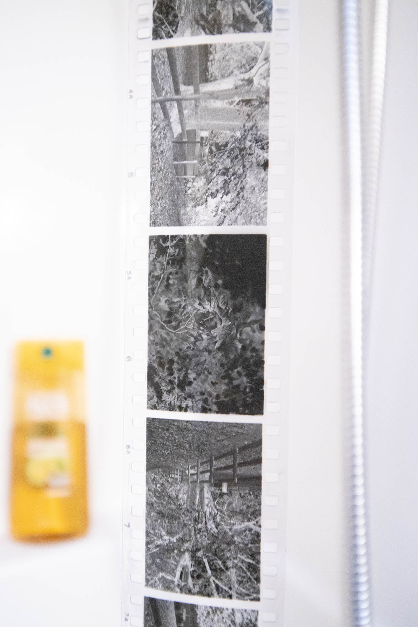

So I developed the Efke 25 roll I intended to do once I got chemicals and for a video, so I did that next. 6 minutes in Xtol straight. I should have double check the temp on the Xtol, as my negs came out very dense. Overdeveloped Im guessing. Still very usable once scanned, though I should have maybe cooled off the developer a bit. I got sloppy on the second round. Its hanging to dry now as well. The negs in the clear areas are clean and clear, so no aged negs here (even though the film is 6 years expired, but always kept frozen). This is fun. I still have more rolls to do, but Im not sure I'll do them today. My stop needs to be used a few times before I dump it. I only have a couple days on it -correct? I didn't buy a bottle to store the mixed stop in, so I'll have to dump it fairly soon.

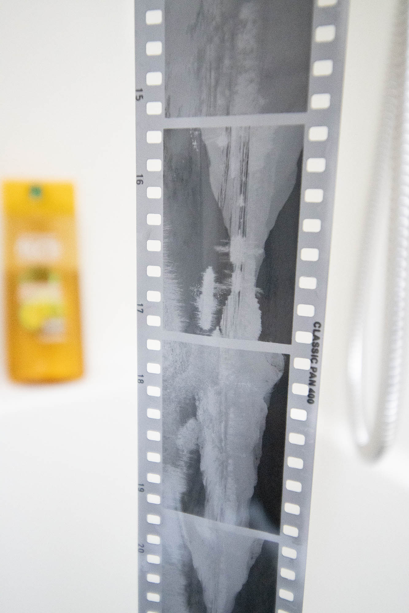

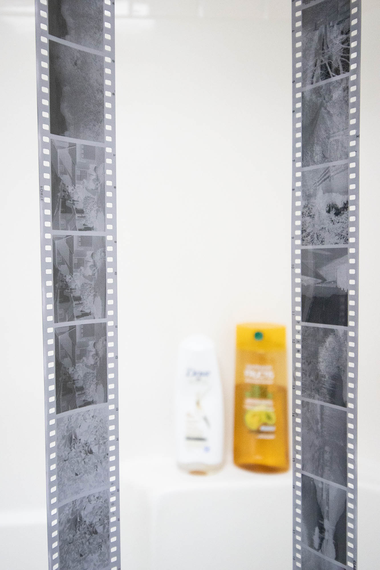

I did a total of 5 rolls of film today. Still have a couple more to do, but Im going to stop for today. 2 rolls of Tri-X, in 35mm and 120. Those turned out fine no issues. My rolls of Forte/ J&C Classic 400 seem to have a lot of fog or darkness in the clear areas. So it seems they have aged. They aren't clear like my other 3 rolls. My bag of Xtol seems half gone already. That was fast.
