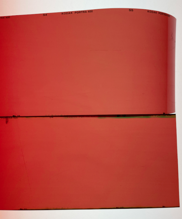

Hello! Posting here for the first time and in search of some help on an issue I've been having in my C41 process.
I've been running a Tecnloab dip and dunk for 4 years now, it's been serviced by a professional when first set up at my lab and I've hardly made any changes to the setup, times or workflow.
I use Champion chemistry and monitor sensitometry daily, with pretty consistent results or at least nothing that ever granted for major adjustments.
Since a couple of months I've started noticing these flowmarks on the negatives (attaching scan below from unexposed MF Portra 400 I used as test), they are clearly visible on less dense parts of the negs and sometimes even to the naked eye on the base when I look at them on the light table.
I did some troubleshooting with the knowledge I have, but feel like I need the help of someone more experienced in the use of these machines.
This is what I did
- skip the stabilizer bath: I was afraid of the stabilizer being overly concentrated/not replenished enough so I skipped it on a couple of racks and the marks were still there.
- skip the dryer: I pulled a few rolls out of the machine right before the dryer and dried them at room temp in the cabinet I use for B/W. Same result.
I am now afraid that this has to do with agitation in either the dev or the bleach. My sensitometry tells me the agitation is correct but I feel like I might be missing something.
Any help/input will be greatly appreciated. Thank you!

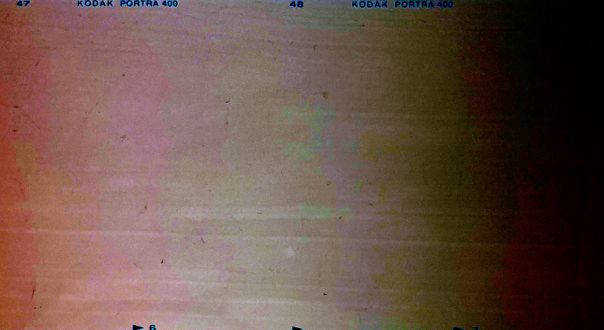

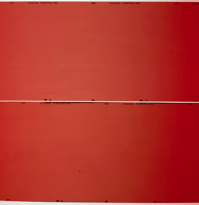

Here is a link to the inverted scans of the full length of the original example I sent (2 rolls of 120 Portra 400) and pictures against a backlight of the same two negatives, taken halfway down the length and at the end - https://we.tl/t-O90VAXI1sl (please disregard the drying marks for now)

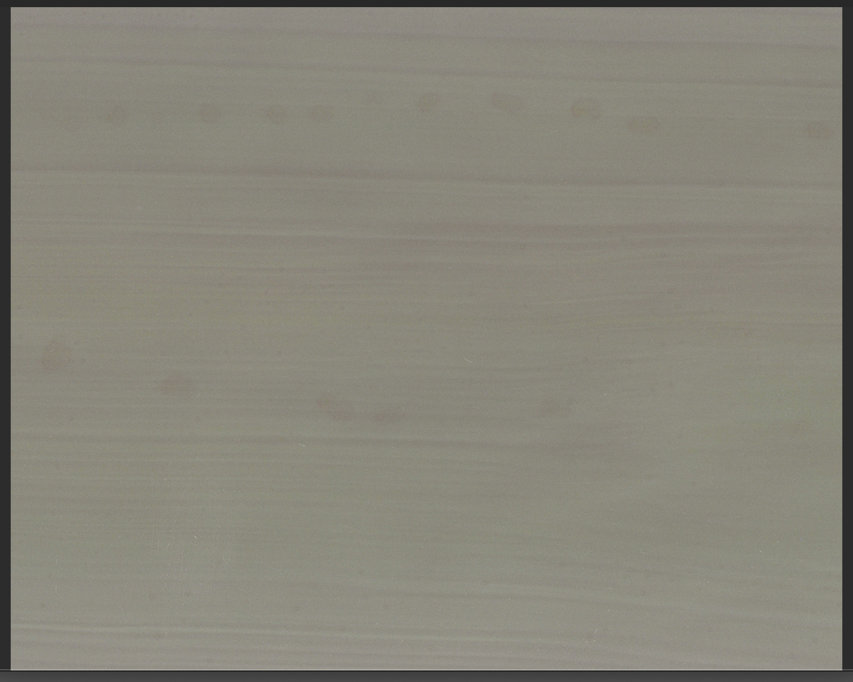

Thanks for posting the additional illustrations. For anyone interested in the same things I am, I'll post the (to me) interesting bits here if you don't mind:
This is part of the first strip in the top image with dramatically increased contrast (but no inversion):
1769527399762-png.416654
So logitudinal stripes of varying density with, no particular color.
First strip in the second photo (with the curled end) seems to be much less severely affected. Is there a pattern to the severity along the length of the roll?
Does the problem also occur to the same degree on 135? If you also have 135 that's affected, is there anything odd going on around the sprocket holes?
I think a contamination problem of the developer is still a likely scenario.
Apologies, I think that might be due to the top strip being curled and showing less of the effect in this particular picture I took. If I lay it flat next to the other one they appear to be affected in the same way.
As far as I can tell there is no pattern, the marks appear to follow the way the chemistry drips down the roll while it's being lifted maybe? They're hung with the end of the roll at the bottom.
