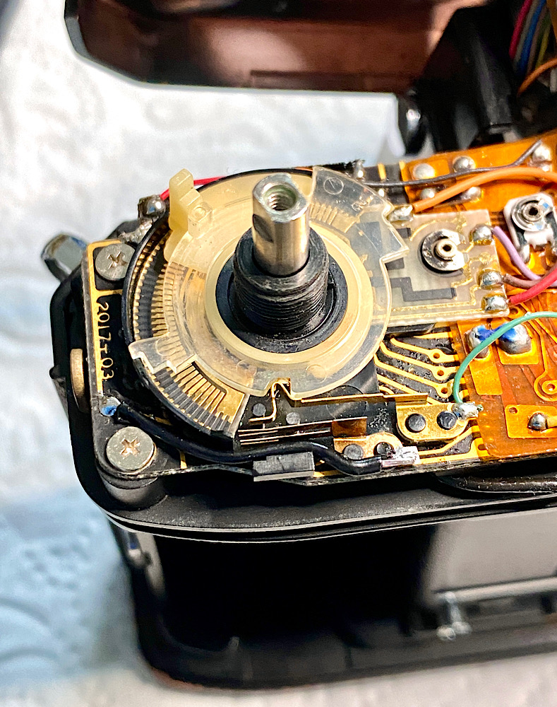

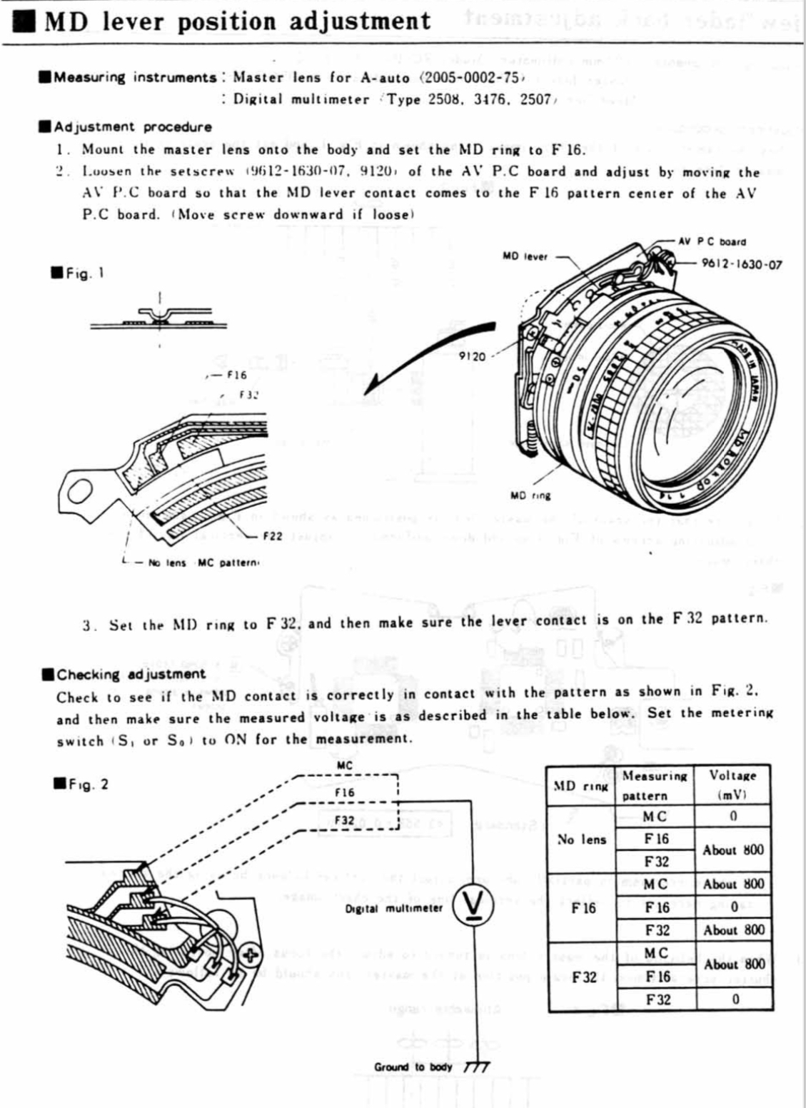

This is about adjusting the coupling for the aperture simulator (source: Minolta Service Manual for the X-700).
At this point I had removed parts so that I could clean them. Assembly went without any problems, but is the adjustment correct now? I'll check that out.
I must not forget to check this.
I just went through the previous report again and saw how the contacts are adjusted there.
Since this is also my repair log for the project, I'm making this note.

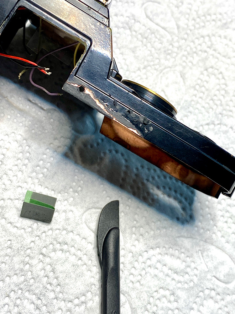

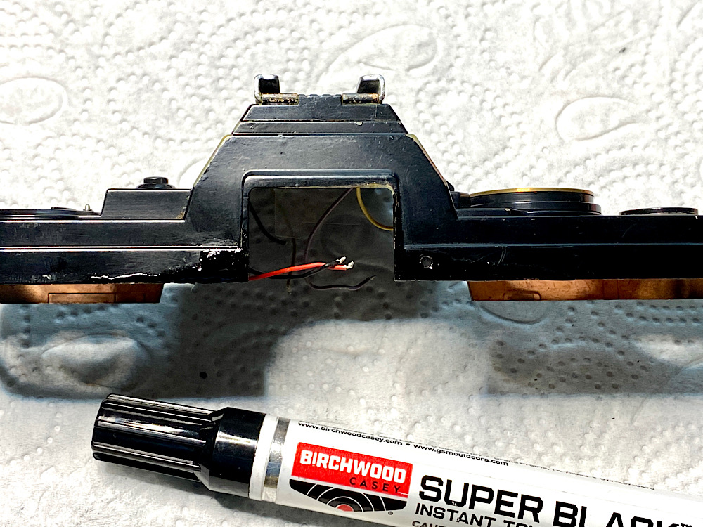

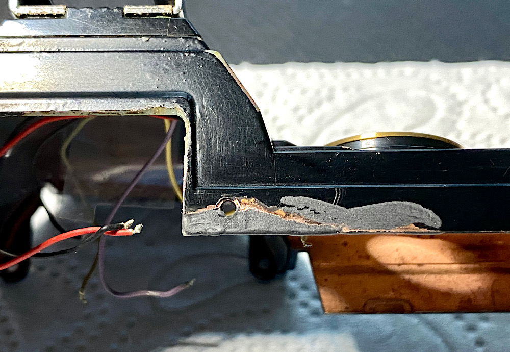

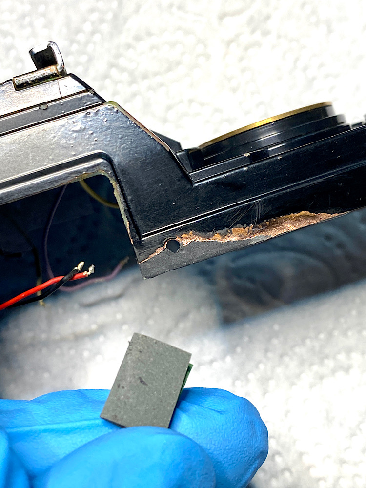

What's still missing is repainting the areas on the top cover that were repaired with Sugru, checking whether everything is OK, assembling and testing for functionality.
Let‘s start!

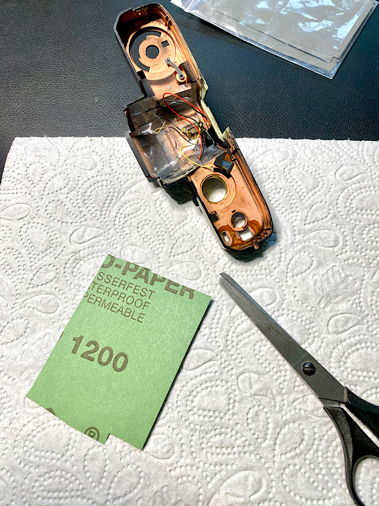

Repainting
The areas repaired with Sugru have hardened after 24 hours.

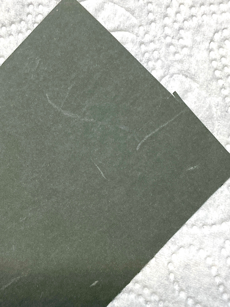

I use fine-grained sandpaper to smooth the areas.
Sugru can be easily scraped off the copper areas with the Spudger.
There shouldn't be any Sugru there, because I can repaint these areas directly.
Sanding
Paint over with black gloss paint and let dry.

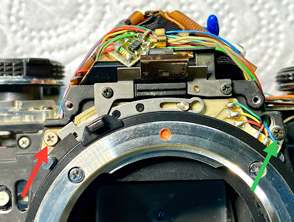

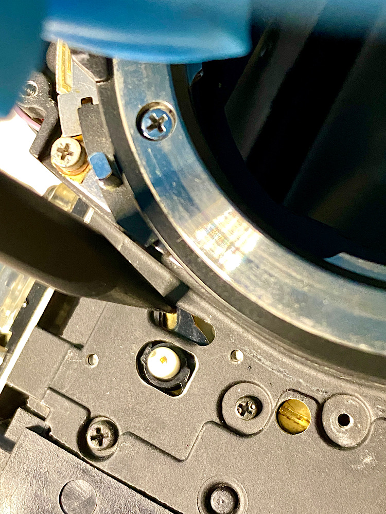

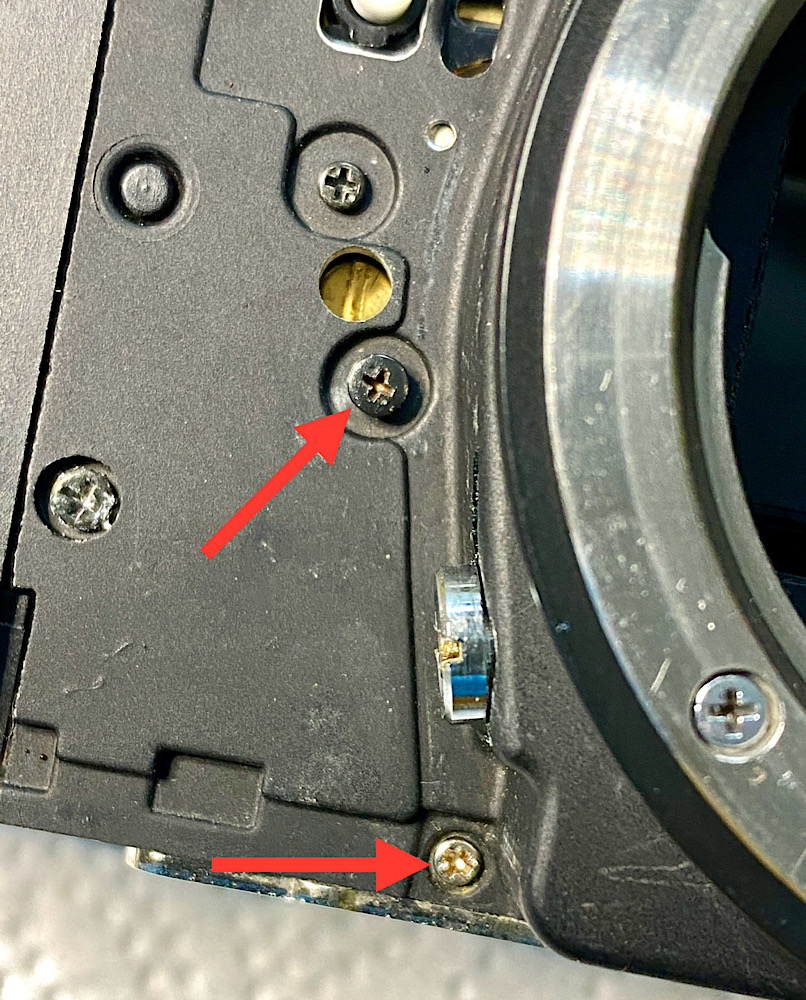

Check the clutch for the aperture simulation
Here I wanted to check whether the contact plate is seated correctly.
Everything is ok, there is only one position because I only loosened the left screw (red) but not the second one to fix it (green).

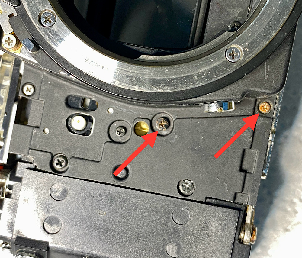

Check before assembly
Before assembling, I check the camera again to make sure everything is seated correctly.

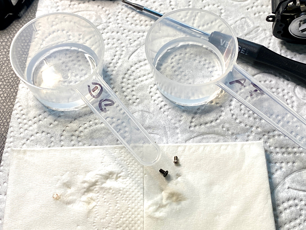

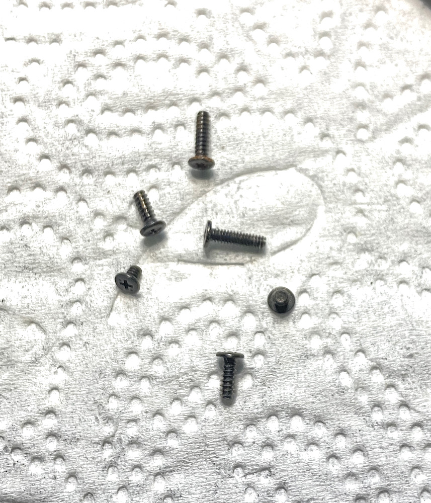

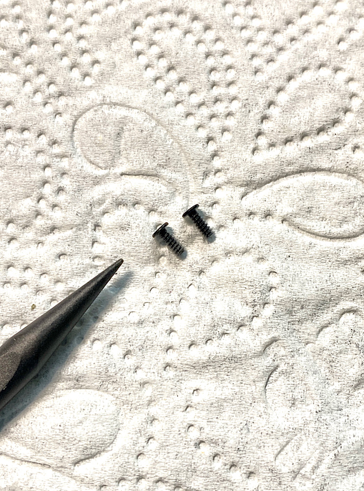

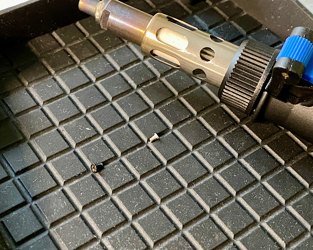

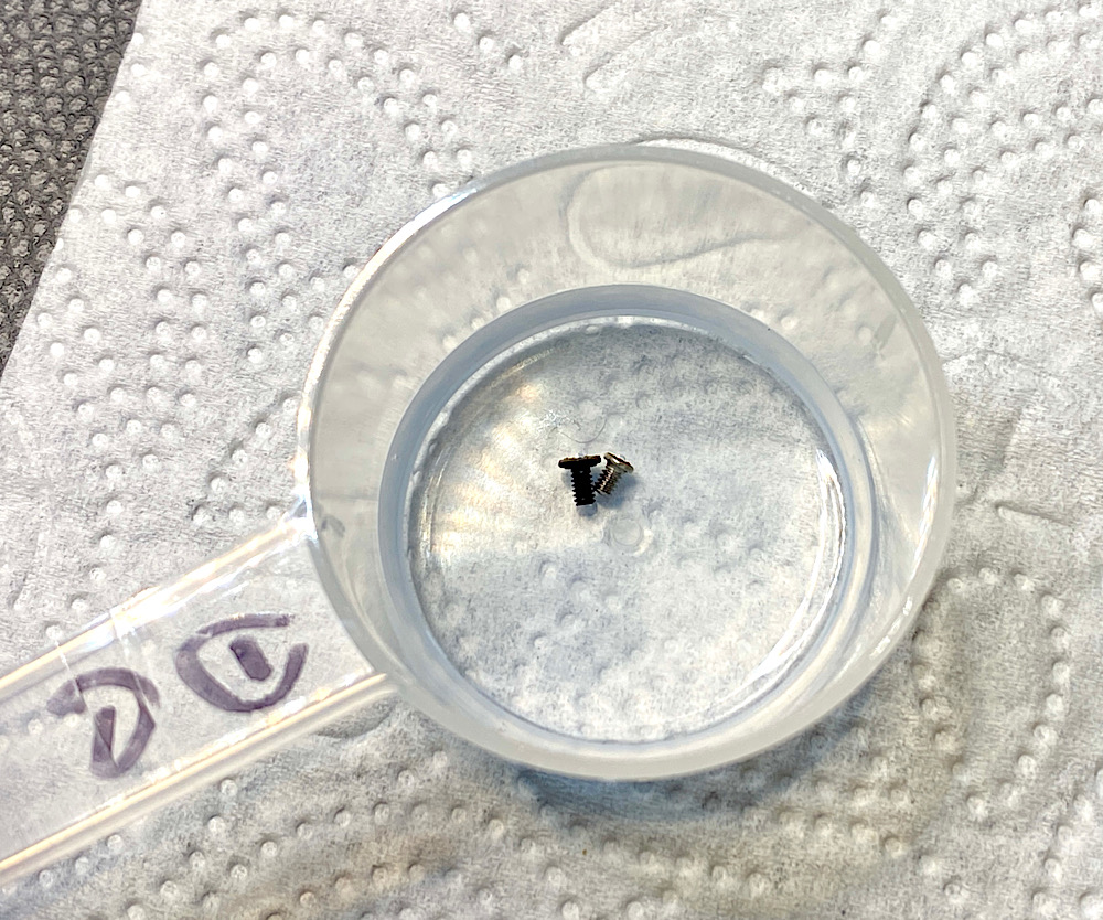

There is still rust on both screws.
The switch for the self-timer and storage of the exposure measurement value can be moved in both directions, as it should be.

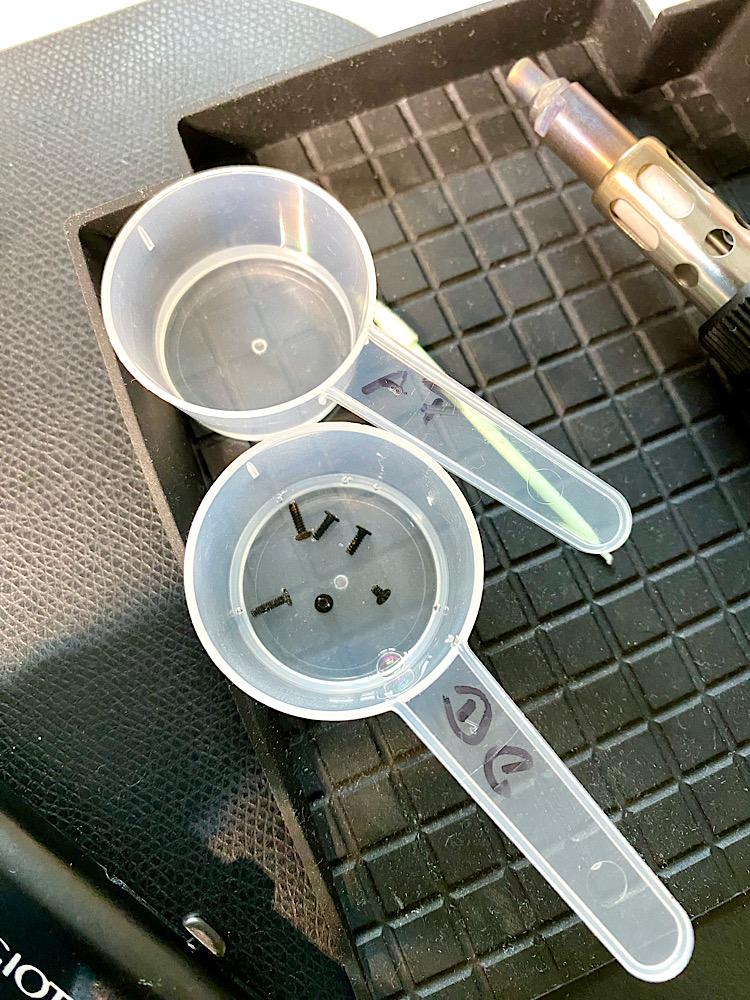

The screws get a bath in Durgol.

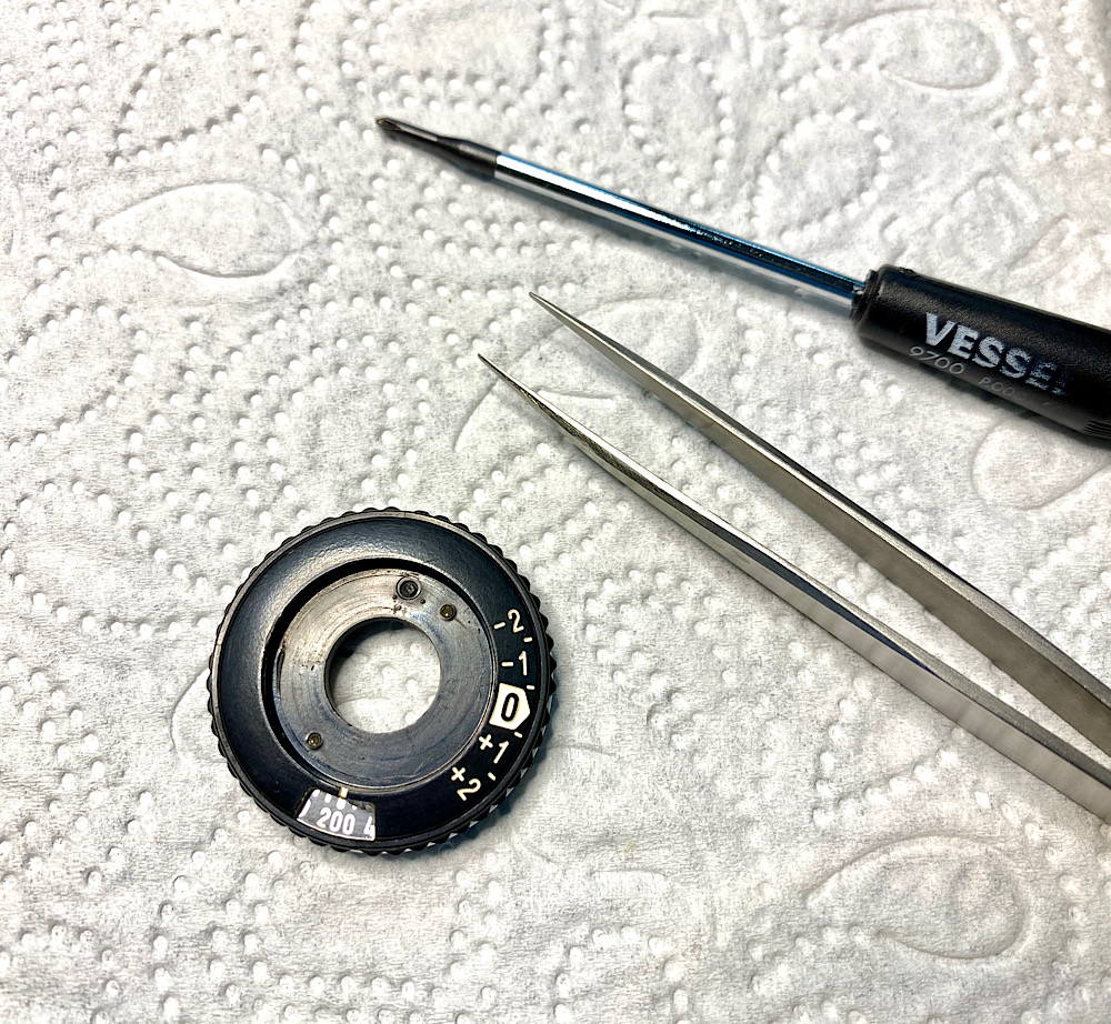

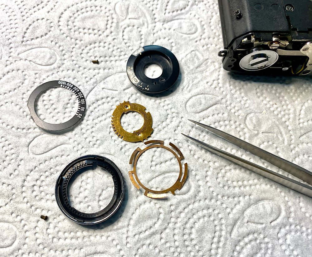

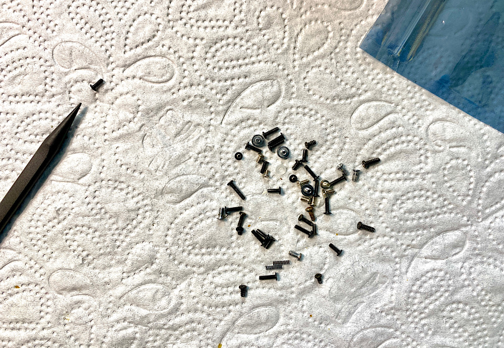

In the meantime, I'm assembling the ASA/Exposure Compensation Wheel, which I had disassembled to clean.
The parts waiting to be assembled.
Both screws are rinsed in Aqua Purificata and then quickly dried with the Dremel Versatip butane gas burner on a heat-resistant silicone mat.
An attached hot air nozzle reduces the heat and can be controlled better than when working with an open flame.
This looks good now.
Same procedure for other screws with rust.

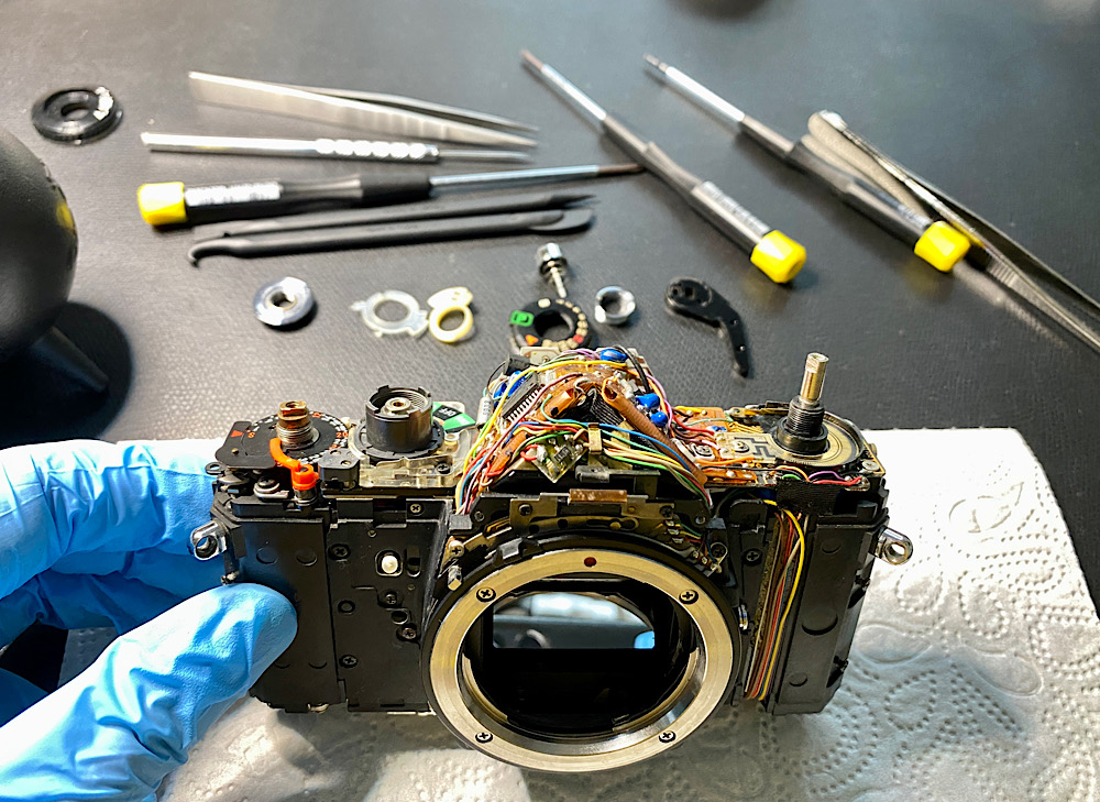

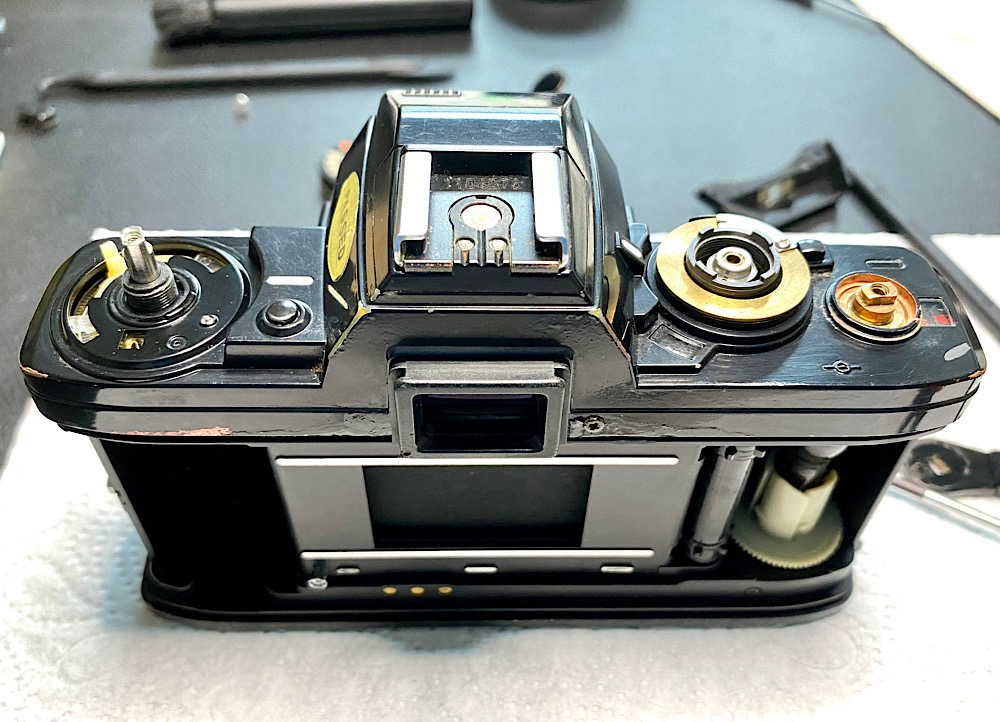

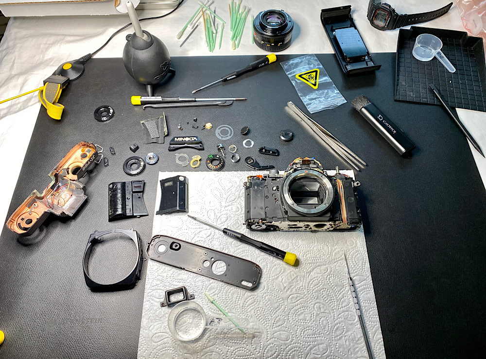

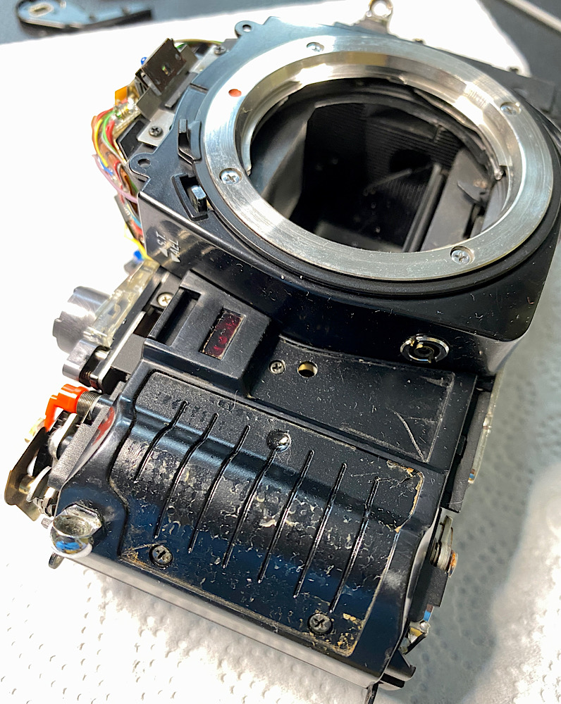

Assembly

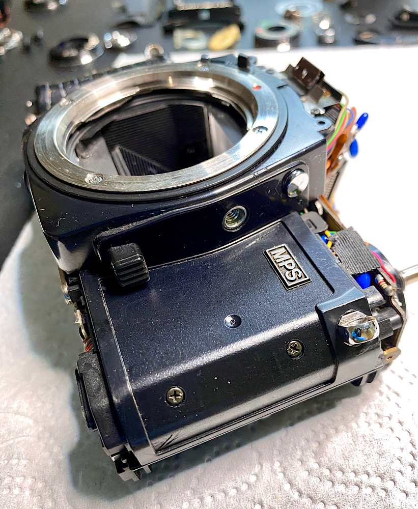

The casing for the bayonet is put on for testing, without the button for the lens release and stop down button inserted.
Now with the buttons and fixed with its two screws.

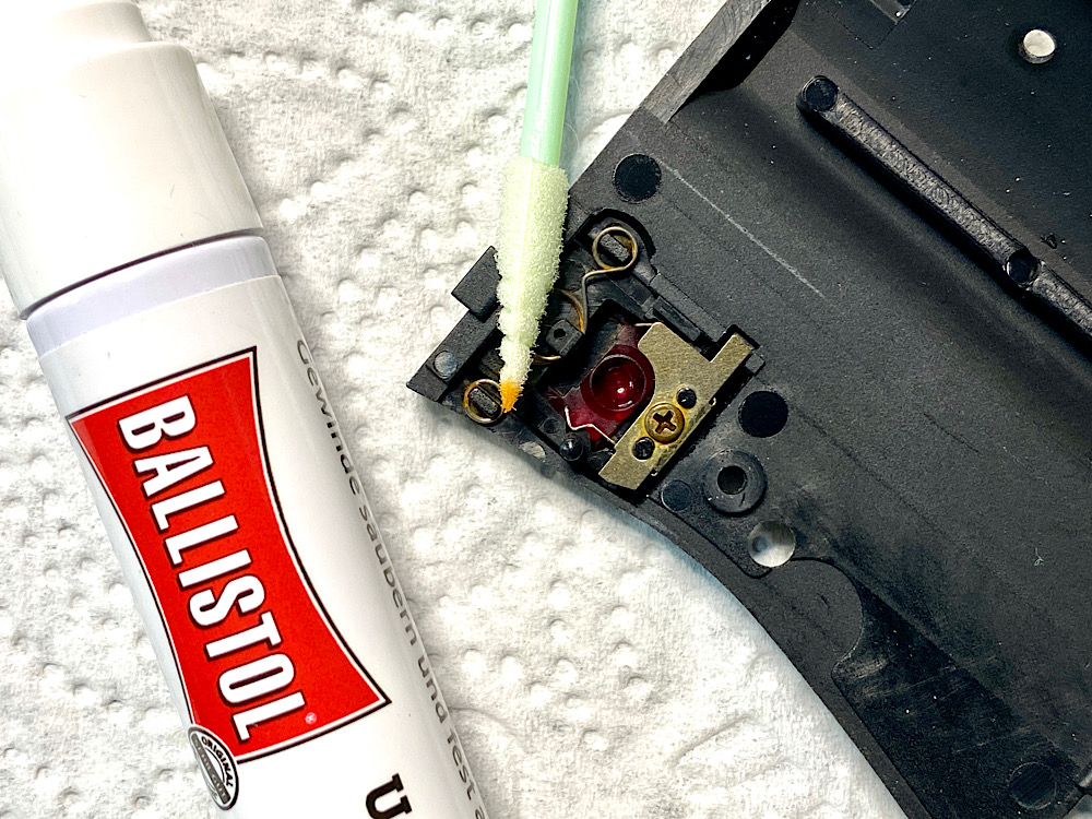

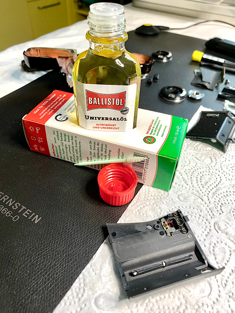

The spring and screw on the self-timer/measurement lock button are slightly rusty.
I apply Ballistol universal oil, which dissolves and protects rust.
The right part of the cover is assembled.
Likewise the one on the left.
These two parts of the leatherette are self-adhesive. Still, after around 40 years!
The rust-free screws are now ready for installation.

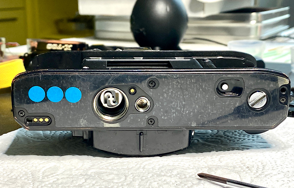

The base plate is screwed on.

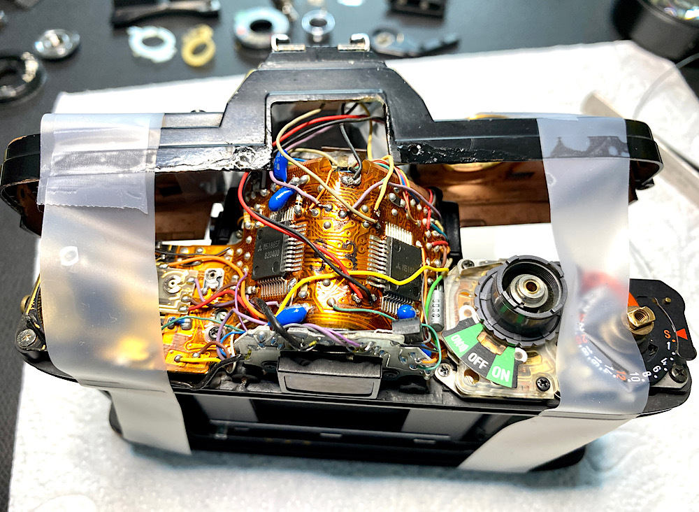

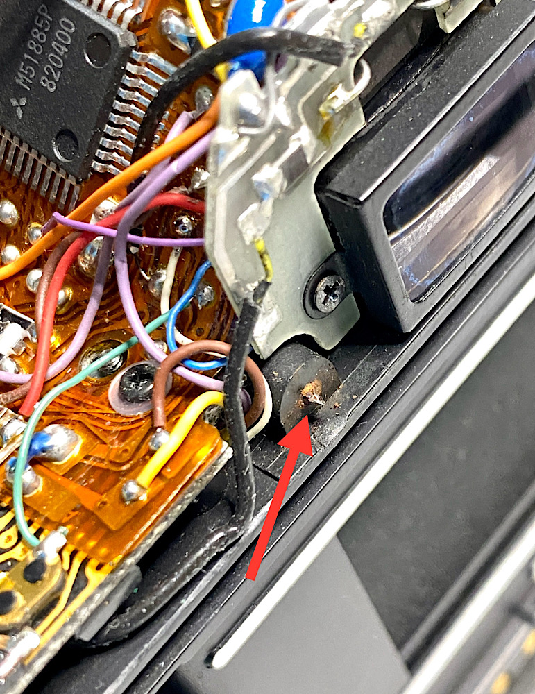

I put three marking points for three installed blue tantalum capacitors. So I don't need to check this X-700 later for expired electrolytic capacitors.

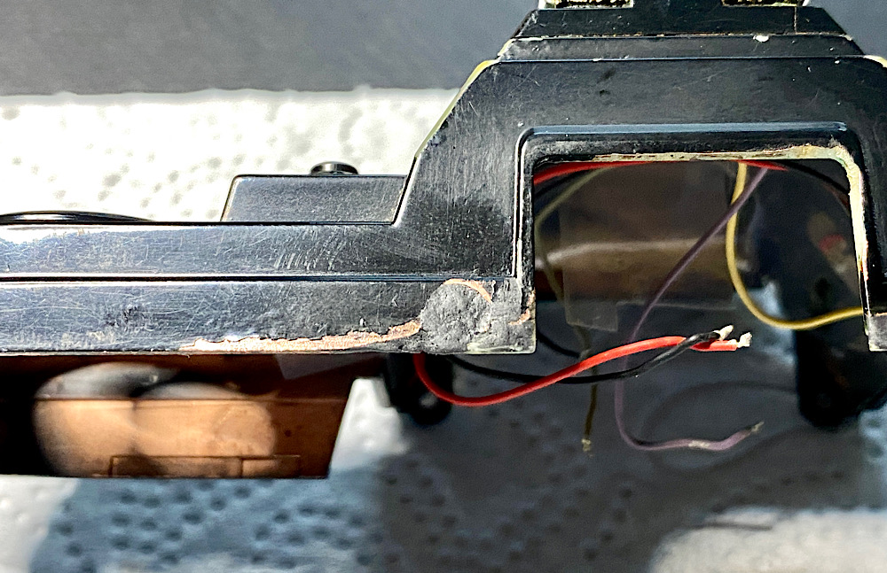

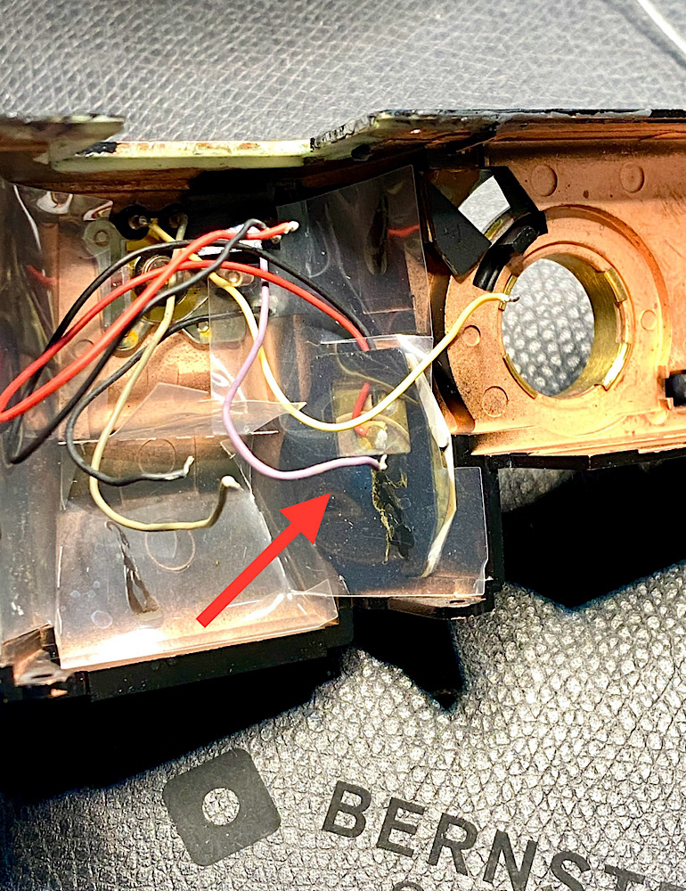

The piezo element for sound generation is located in the top cover.

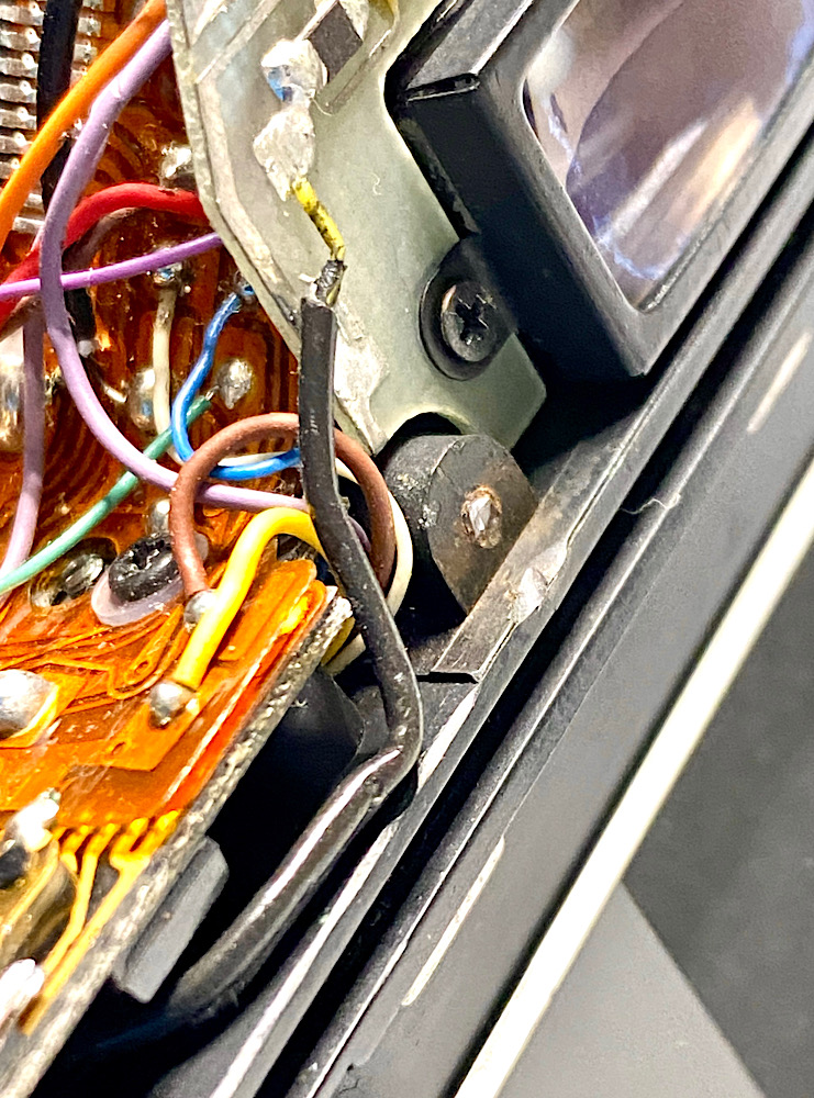

The cables from the top cover are soldered back to the board.
A cable that couldn't be soldered securely kept me busy.
But now everything is in place.

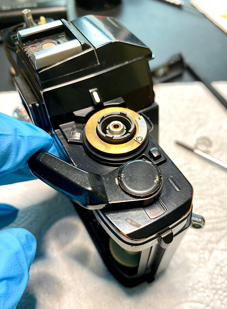

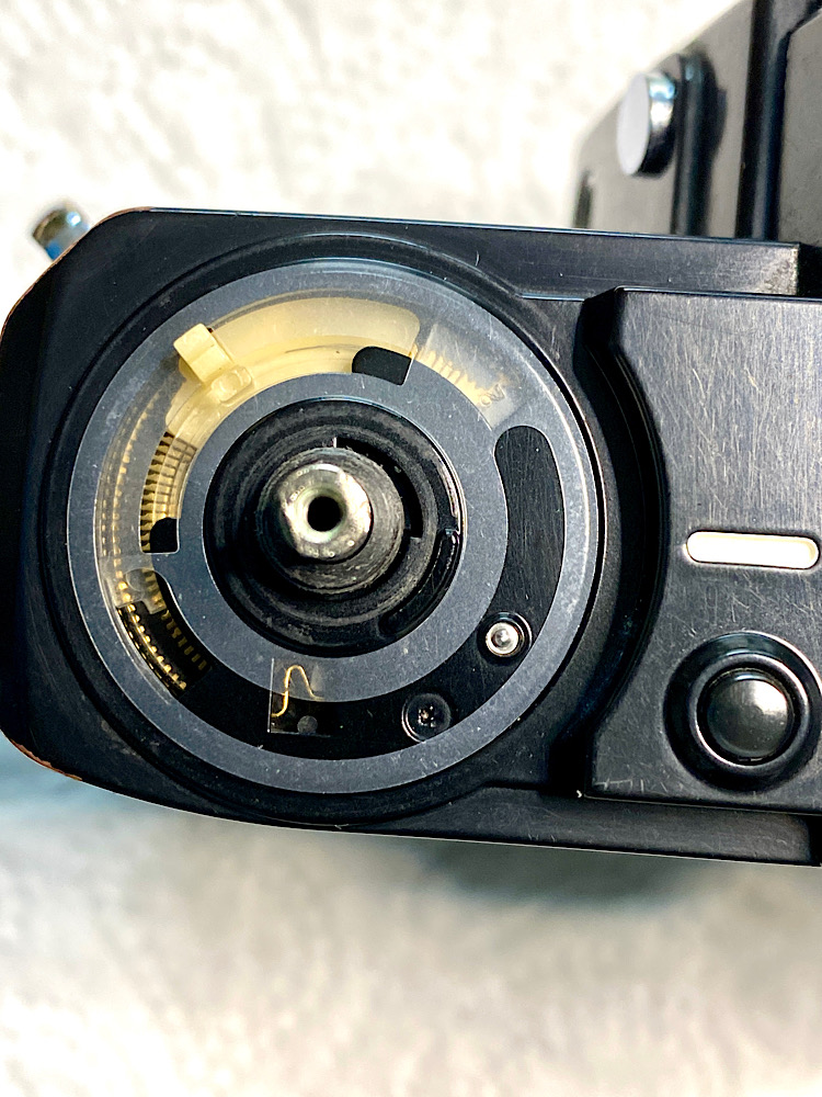

The parts under the ASA/Exposure Compensation Wheel are attached.

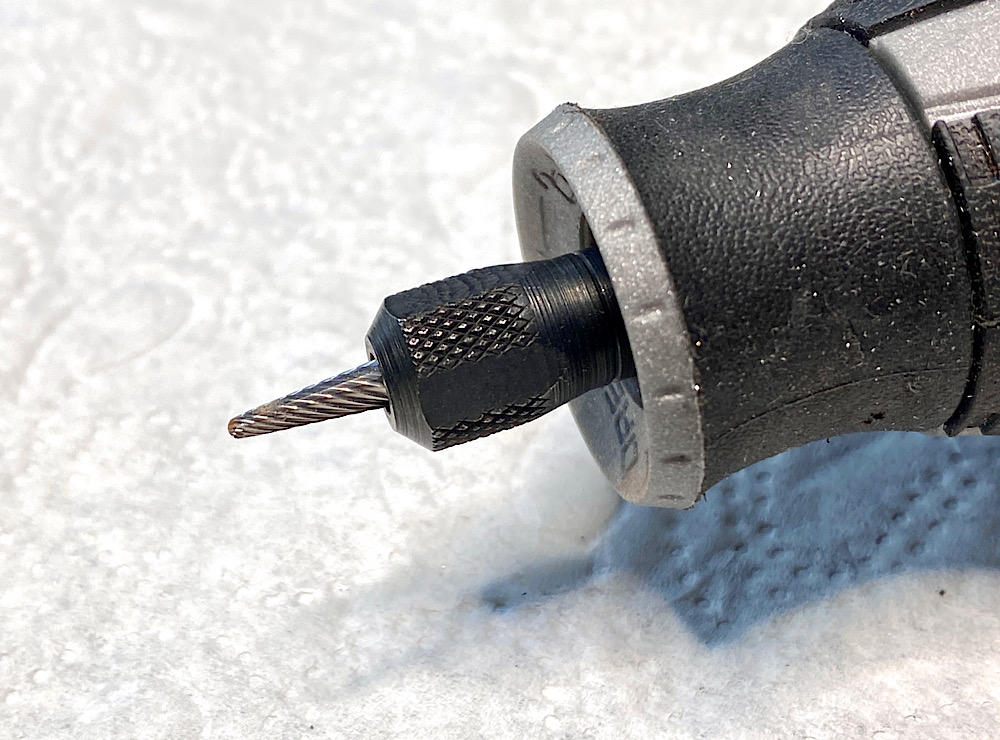

The remains of the milled screw next to the eyepiece prevent me from putting the top cover on.
I solve this with the Dremel with a tungsten carbide cutter.
Some of the plastic underneath came off.
This is not nice indeed, anyway this spot will no longer be visible 🙃
The top cover can now be put on.

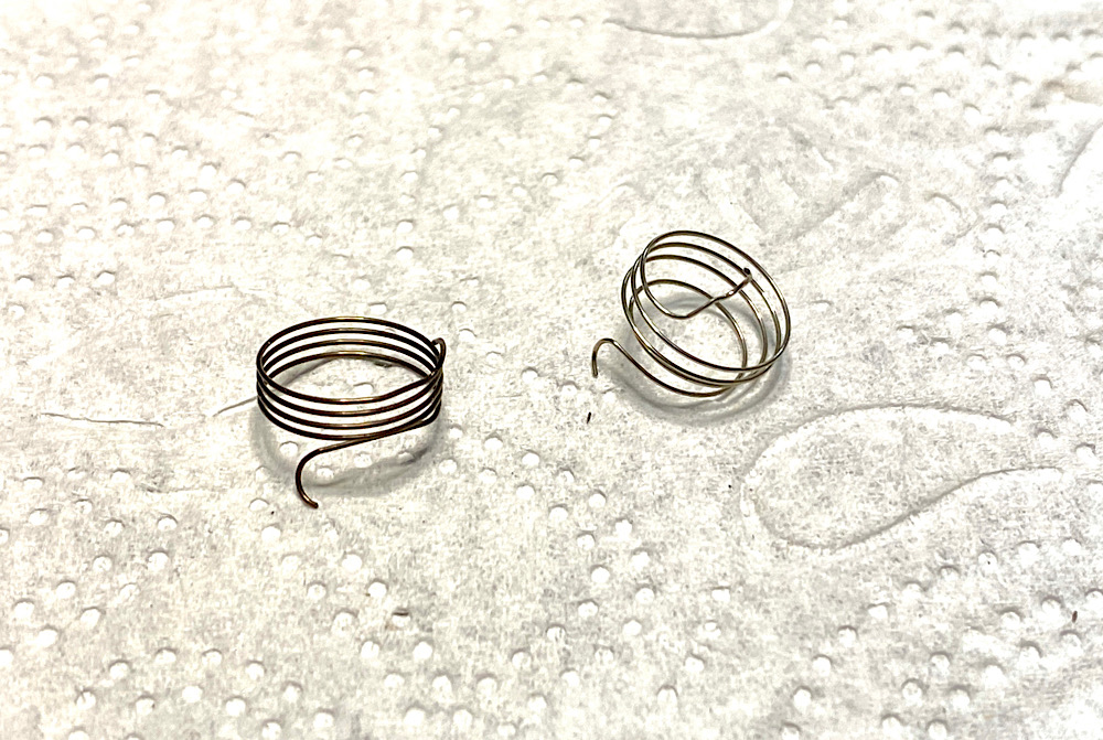

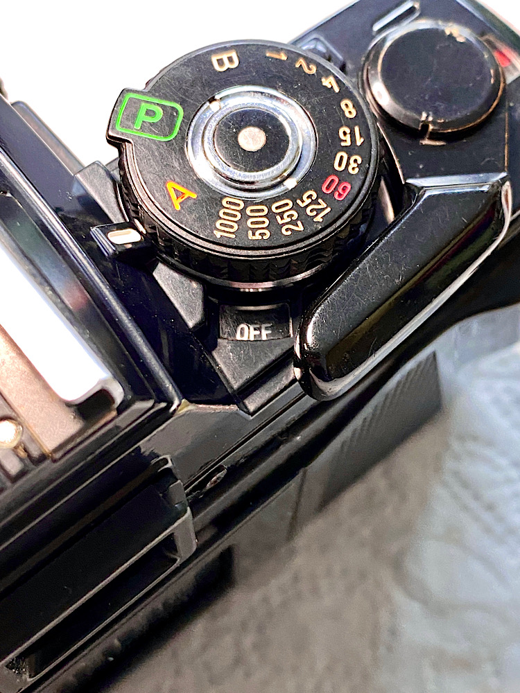

The winding lever got a new spring (left) because the old one was weak. But it can no longer be locked in the unfolded position.
It's annoying, but I won't bother with it now.
Maybe I will check this later along with removing and cleaning the focusing screen.
However, the screen is only slightly dirty and I don't want to remove it if not required because it is very sensitive to scratches.

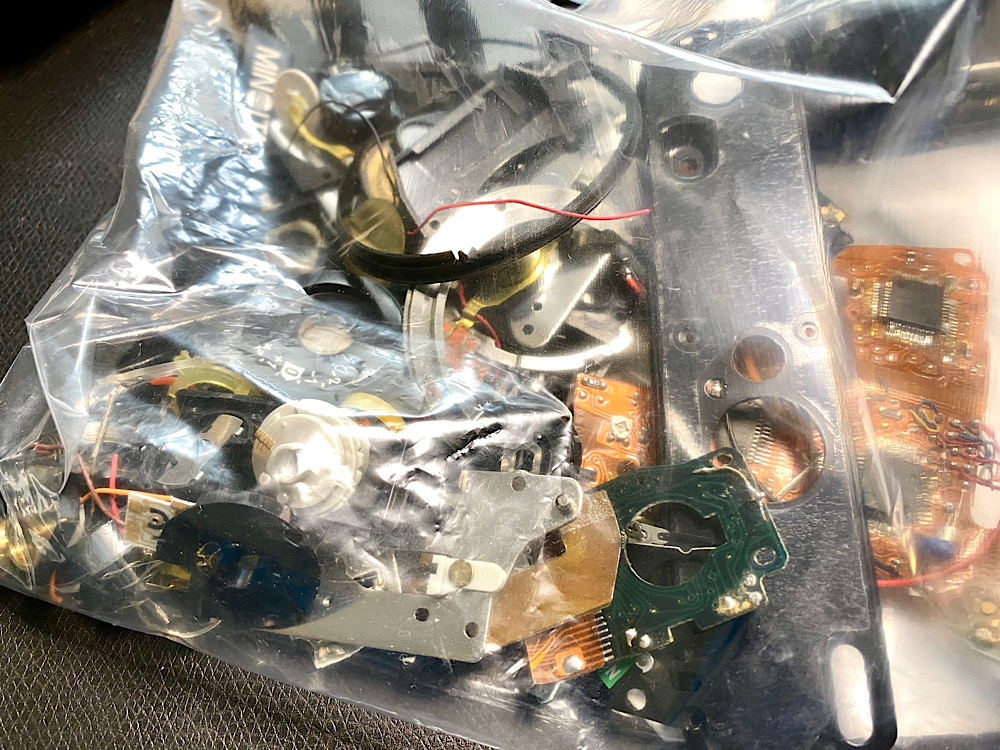

Here my bag of original X-700 spare parts saved me once again.
The ASA/Exposure Compensation Wheel is mounted.

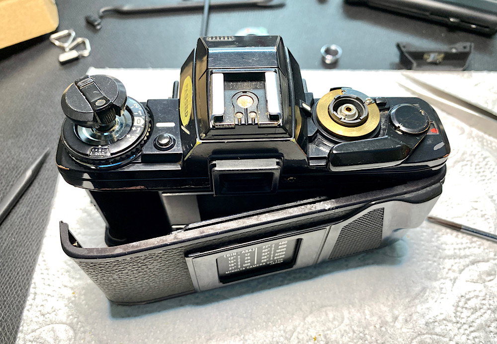

Rewind crank and back door are installed.
Functional test
Everything works as it should 👍

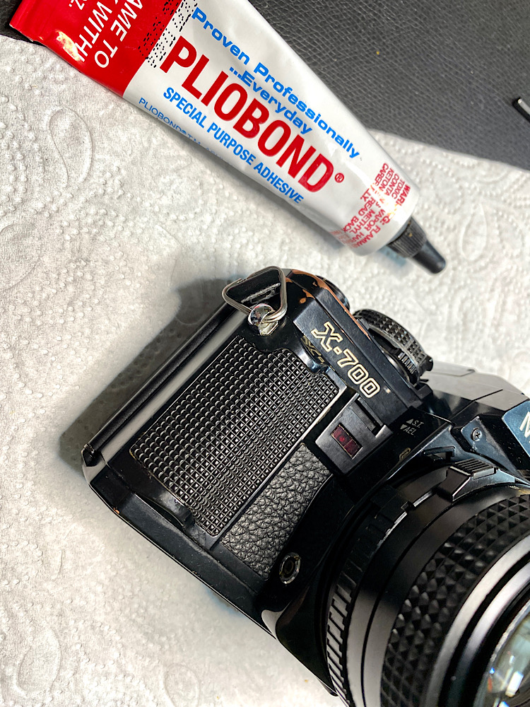

I attach the remaining third part of the leatherette to the handle with Pliobond.

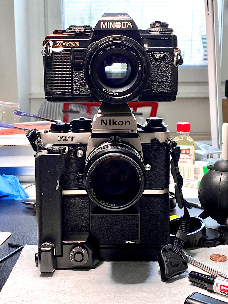

The exposure metering is also OK.
The measured values agree with my Nikon F3/T 🙂👍

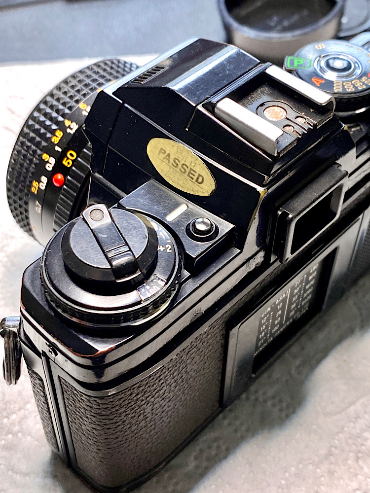

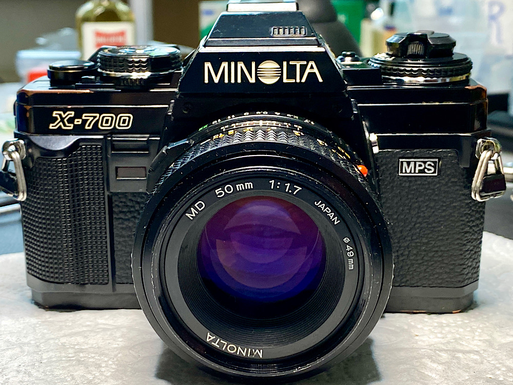

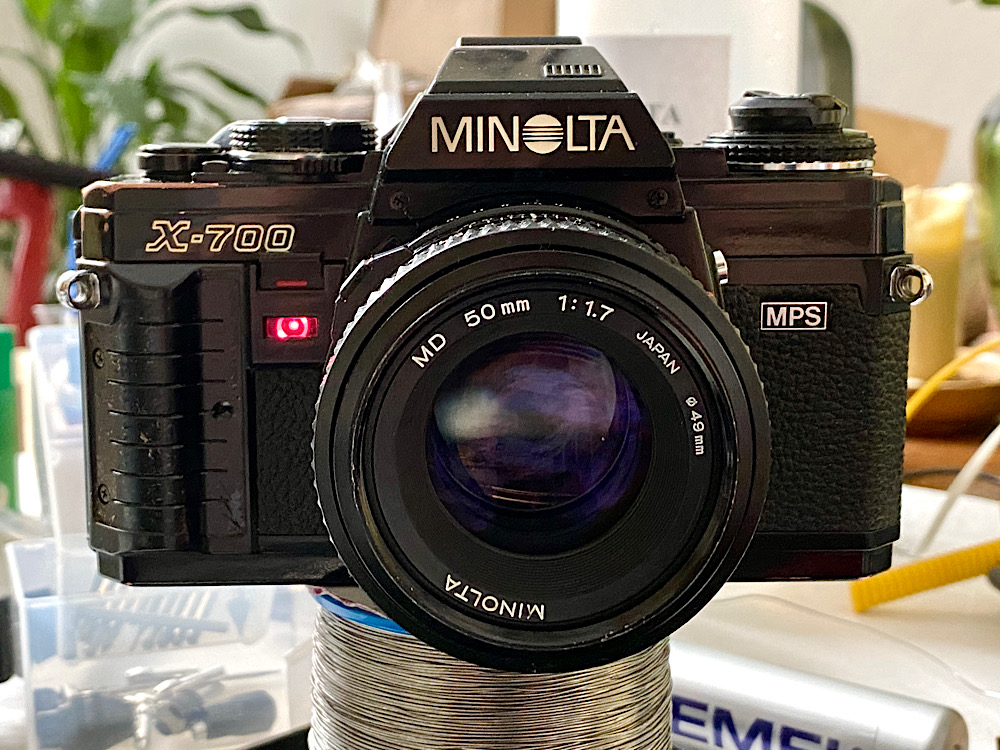

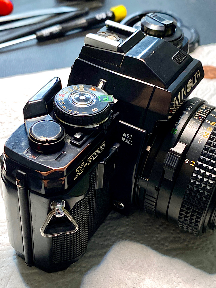

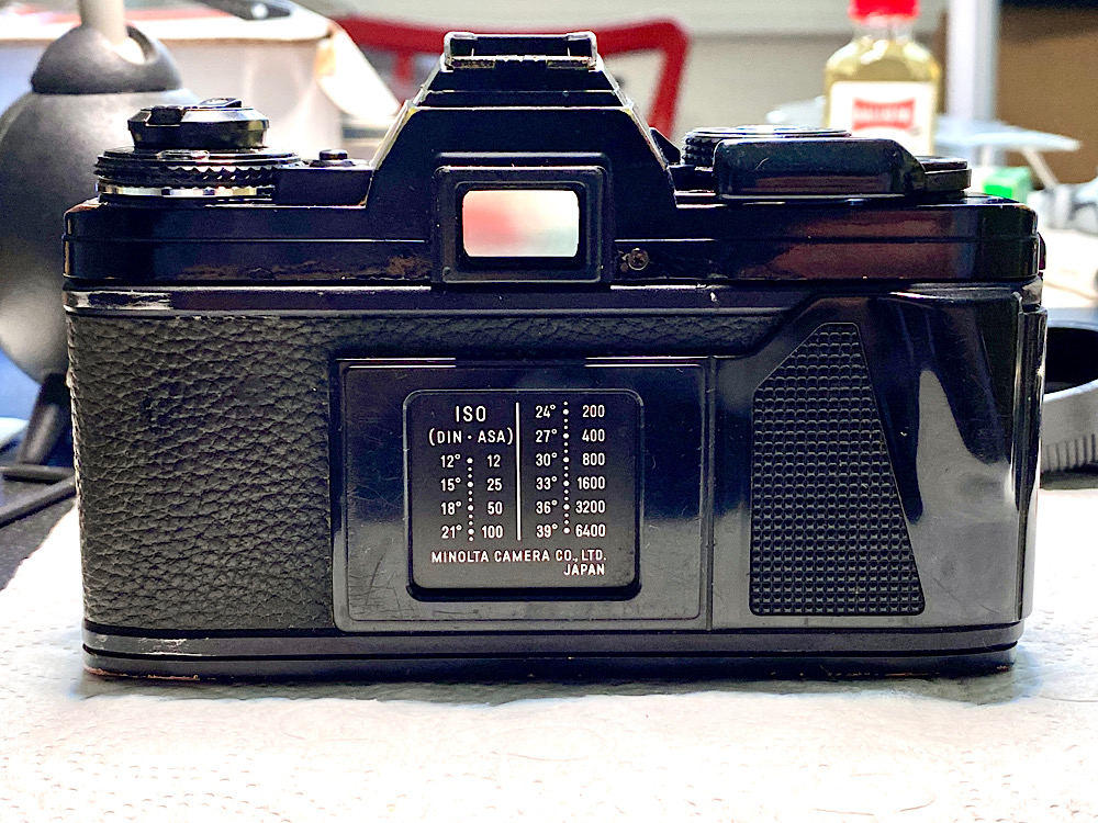

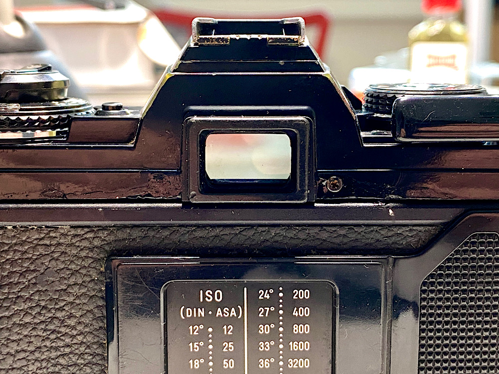

On the catwalk
An X-700 that still shows that she has been used intensively sits on the table, clean and ready for use.
It looks quite different now than it did at the start of the project.
Replacing the light seals and mirror shock absorber is a follow up project.
Anyway, the next film is hers! 🥰

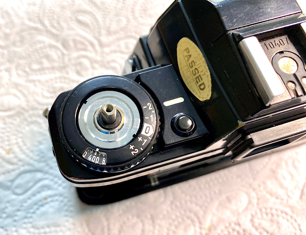

I have but a question: Why don't you remove this PASSED badge and clean the place where it was, as you cleaned the rest of the top cover?

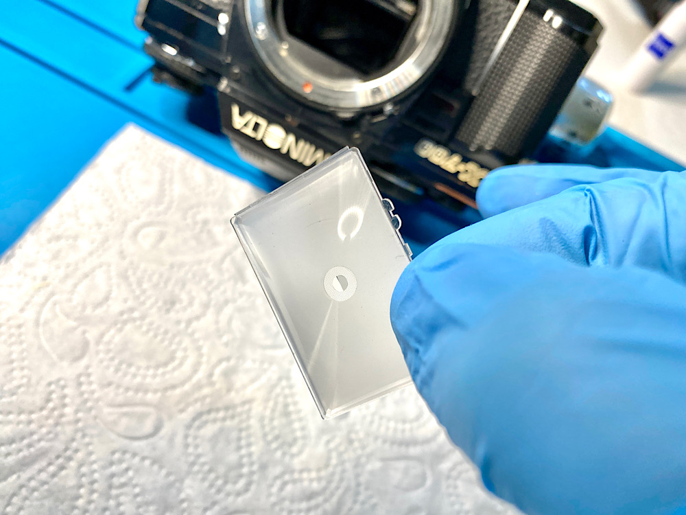

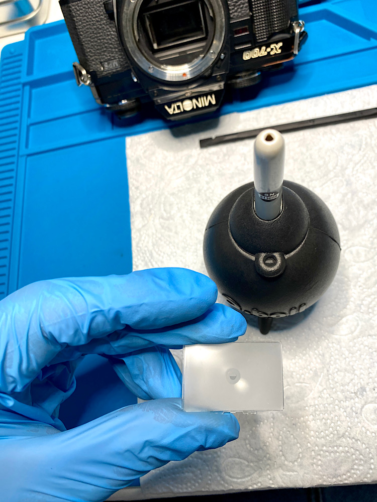

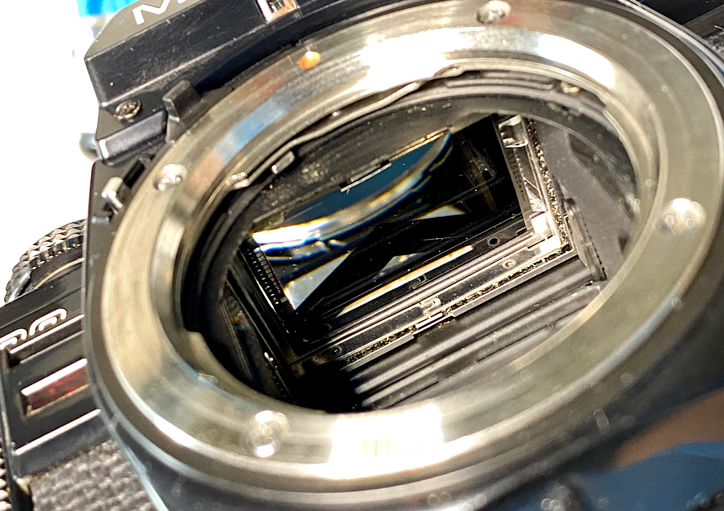

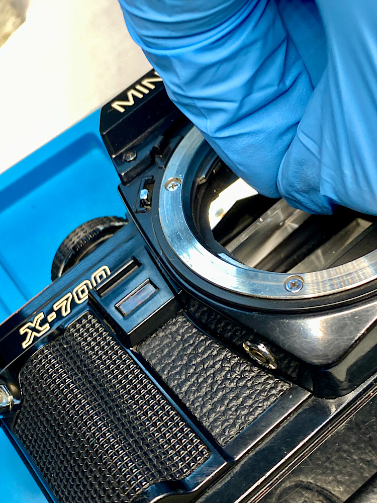

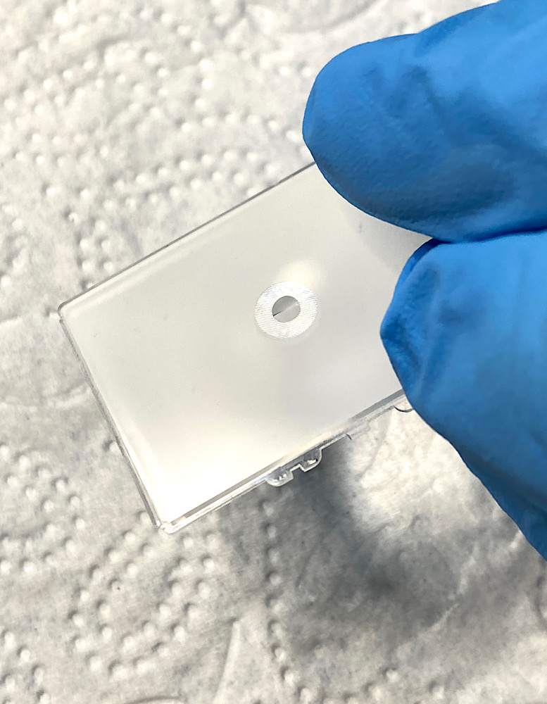

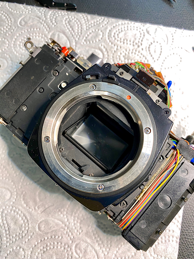

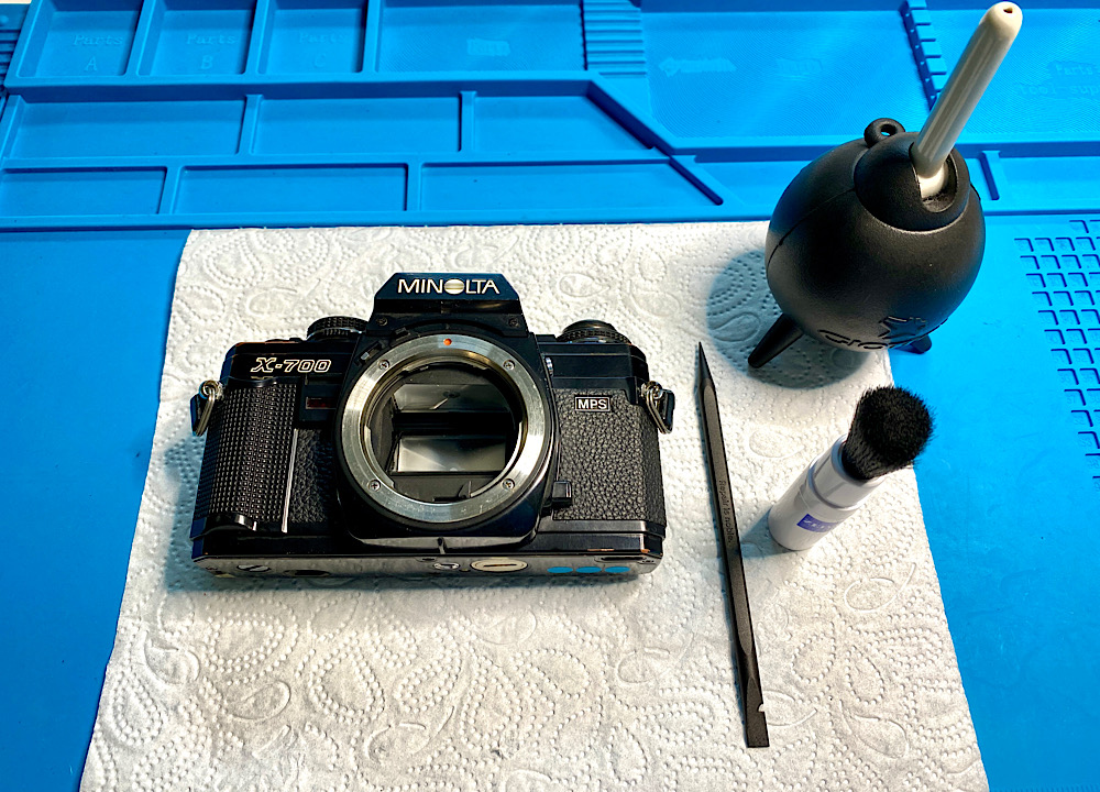

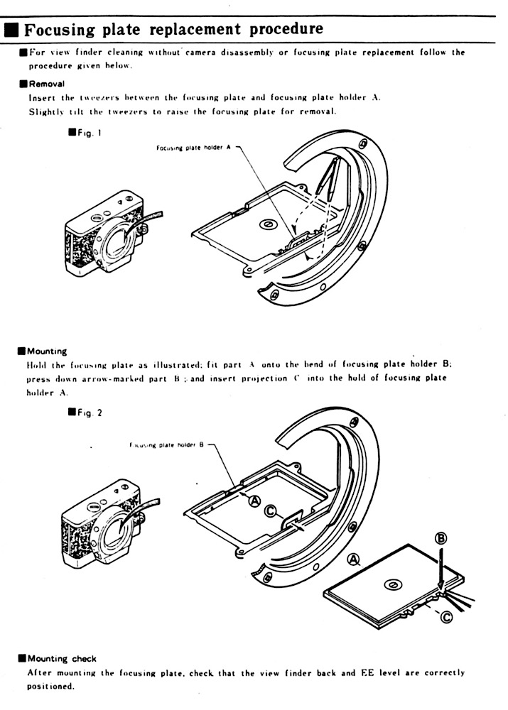

Mini tutorial: Removing and installing the focusing screen
Since I wanted to get rid of the dust and dirt underneath the prism and on the top of the focusing screen, I looked at how to go about it.
These are the instructions for removing and installing the focusing screen in the Minolta service manual for the X-700.
I understood the fastening principle, but couldn't handle the recommended tweezers.
I decided to try the plastic Spudger, which now accompanies me on every project because it can be used universally.
Of course, any other suitable tool can be used.
In addition to the Spudger, there are also bellows and lens brush.

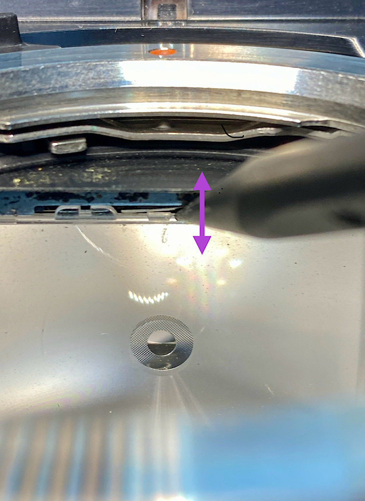

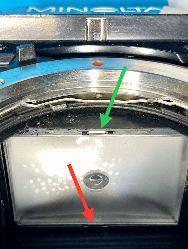

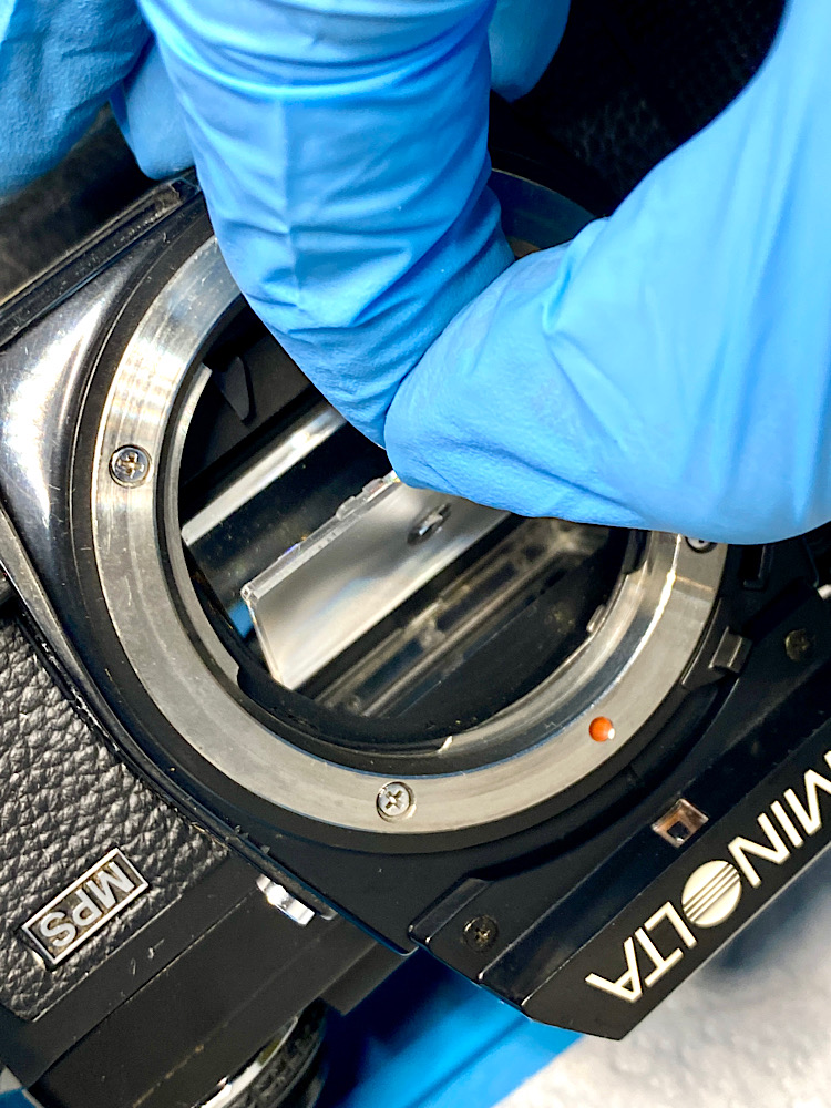

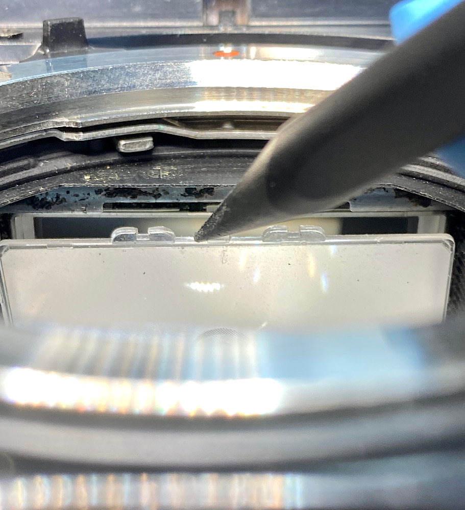

The fastening system is simple:
The clamp at the back (red arrow) holds the focusing screen, the tab at the front with opening (green arrow) fixes it.
To release the focusing screen, I push the tab upwards with the Spudger.
The nipple on the screen then slides out of the opening of the tab and the screen is free.
The camera stands upright so that gravity pulls the focusing screen out of its position.
It would be ideal if I placed the tip of the Spudger in the middle of the tab to prevent bending the edges. But then I don't have a holding point for the Spudger on the screen and I can't press it down.
It would be possible to work with two hands and fix the camera, you have to try out what suits you. In my repeated attempts I didn't bend the tab or it already was.
The focusing screen can now be moved further down and pulled out of the mirror box.
Be careful, the screen can easily jam when pulled out in the mirror box. Since this only affects the edges of the screen, it cannot get scratched.
I wear gloves here and work with my fingers because I don't want to use tweezers due to the sensitivity of the screens surface.

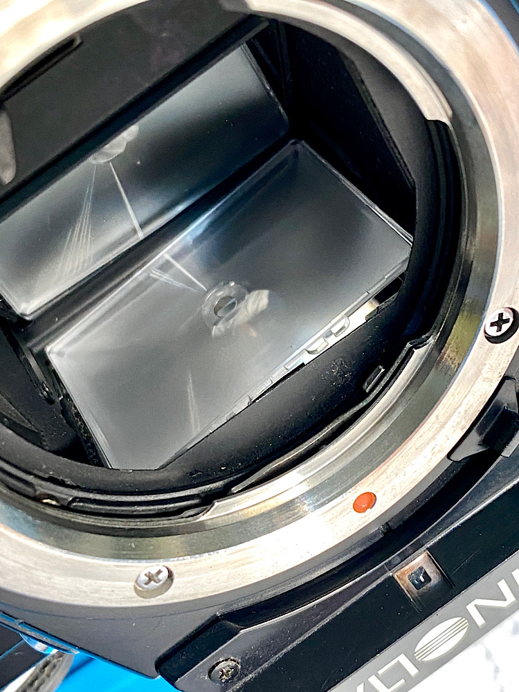

Done
Now the underside of the prism and the focusing screen can be blown off with the bellows. The brush also helps.

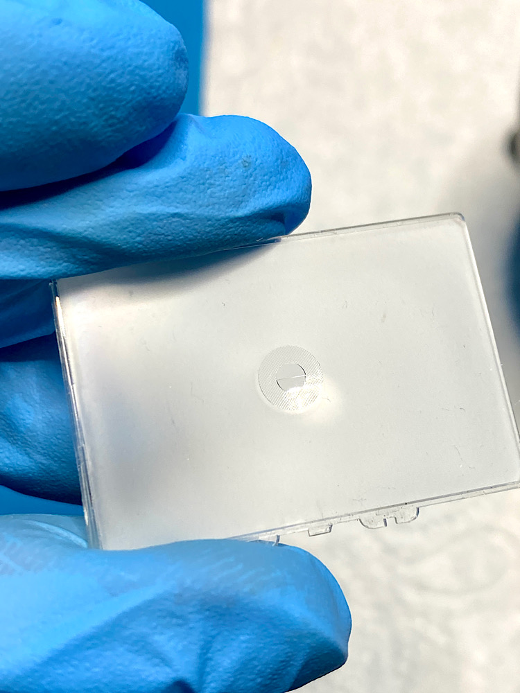

To install the screen, I place the camera on the top cover.
The side with the elevations of the microprism ring and cross-sectional image indicator faces the underside of the prism.
Again, no tweezers
I carefully push the screen into the mirror box up to its holder.
