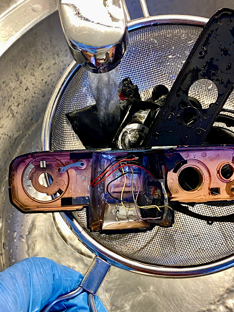

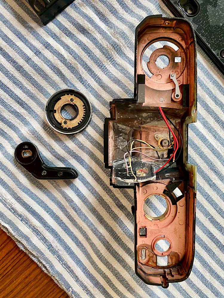

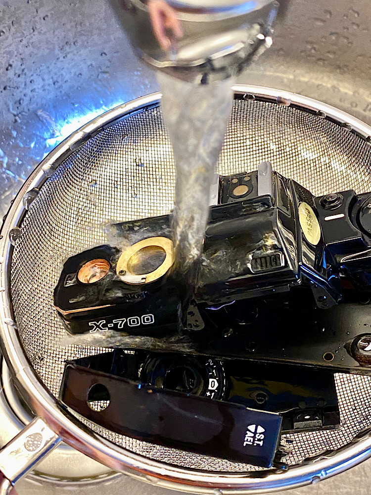

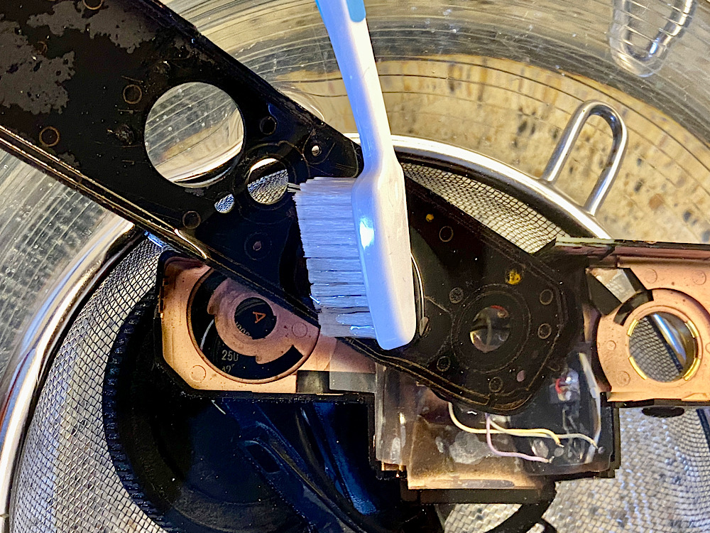

When the time in the descaling bath is up, the brush is used to rework it.
Rinse with clean water.
The greenish coating has disappeared, the place where it changed the surface remains visible. This doesn't matter here because it's the inside of the top cover.
Then it goes into dishwashing detergent for about half an hour. If there are still dirt residues that did not come off in the descaling bath, they should be removed now. At the end, rework with the brush.
Here I use a soft, medium and hard toothbrush, depending on which grips better into the corners and joints of the parts.
Rinse again with clean water.
Water is shaken off the parts. They are then placed on a cloth to dry.
If things have to happen quickly, you can speed up the process with warm air, for example from a hairdryer.
To get water out of the joints, I blow with extra strong compressed air.
After the drying process, I dismantle screwed parts or those where the water cannot dry and remove the moisture.

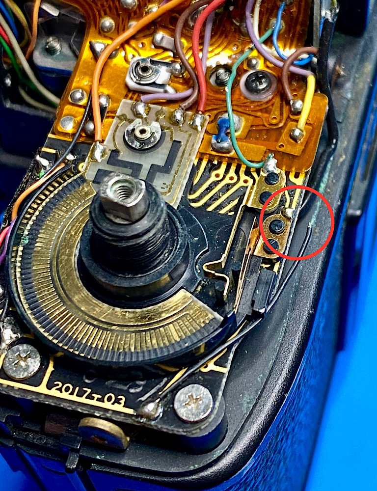

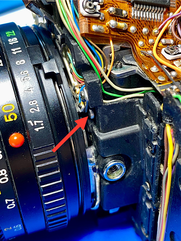

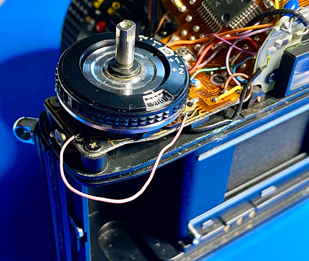

The black cable has come off here, which often happens at this point. I will probably swap it for a slightly longer cable as it is very tight and therefore subject to tension.
Let's see. Minolta must have thought something about this around 40 years ago 😉

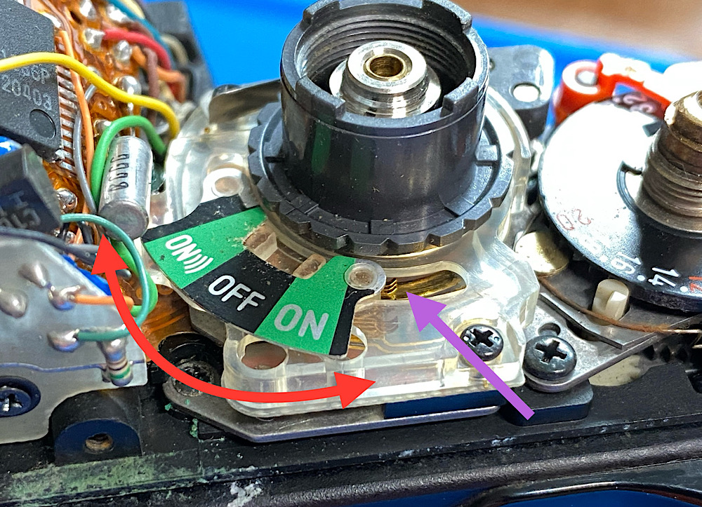

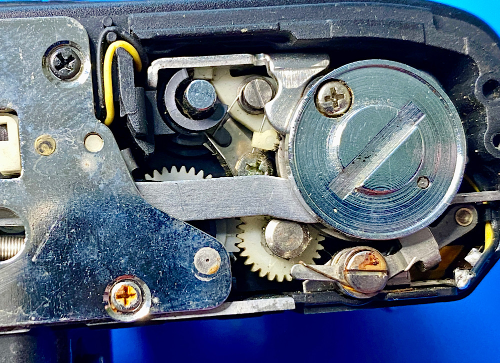

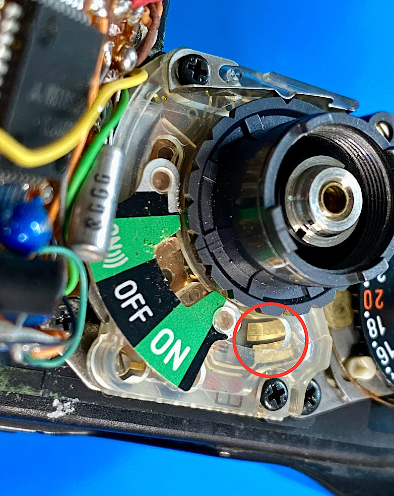

The main switch with its three positions is easier to turn here. This means that the detected heavy gear is due to the clutch in the top cover.
But that doesn't explain the fact that when in position ON/SIGNAL the camera obviously doesn't get any power.
I will disassemble the structure and clean wipers (violet arrow) and contact tracks there (circle).

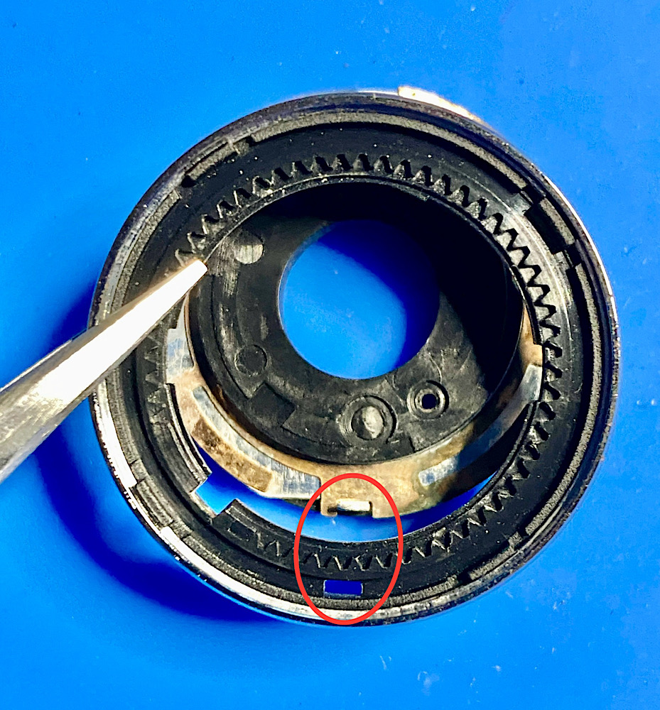

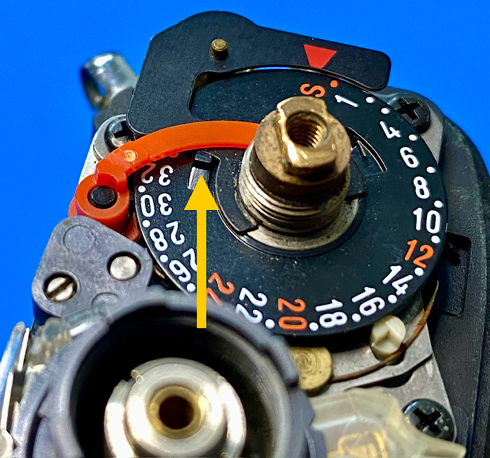

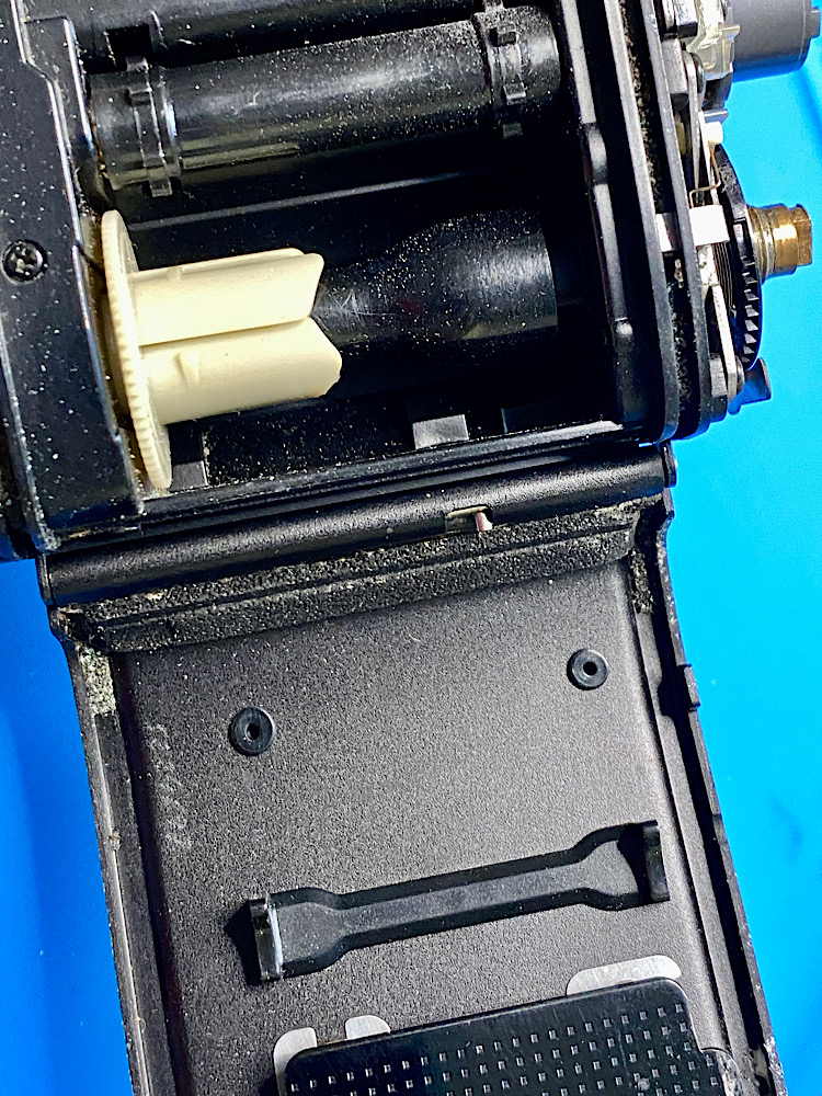

The small cam on the number disk of the picture counter is intact. It can break off because it serves as a stop when the back door is opened and the spring driven disc snaps back to position S.
Dirt and corrosion but not that bad.

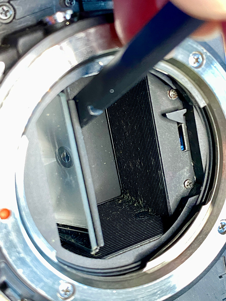

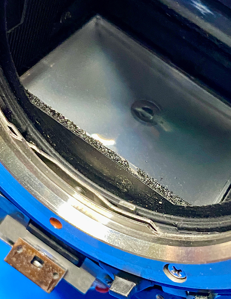

The mirror shock absorber is crumbling and the light seals are no longer fresh either.
I will remove the fungus on the mirror with hydrogen peroxide 3 %.

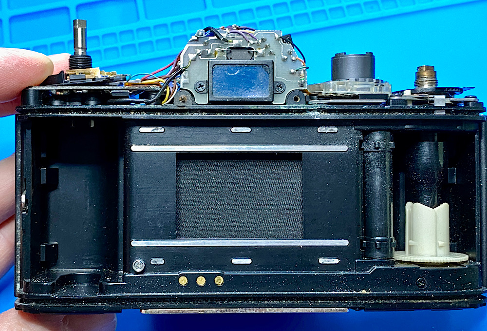

It looks good on the board. No dirt, no corrosion, no abnormalities such as detached cables, cold solder joints, broken conductor tracks or other damage are visible.
Some dirt and rust on screws on the underside. The board on the left looks good. Likewise the plastic wheels.

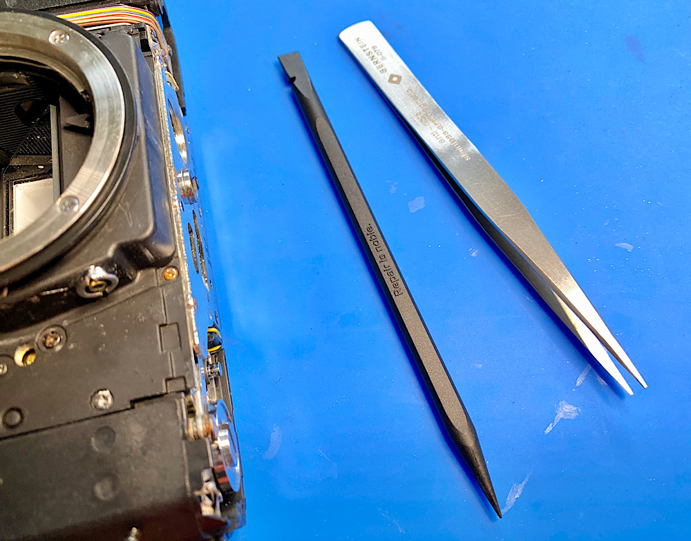

My two favorite tools for checking circuit boards are the Spudger from ifixit and my anti-magnetic tweezers from Bernstein, which are an all-rounder.
You can use the Spudger to push cables aside, wiggle components, scrape away light corrosion and dirt, or even lift circuit board parts. Since it is made of plastic and does not conduct electricity, there are no short circuits if power is on.

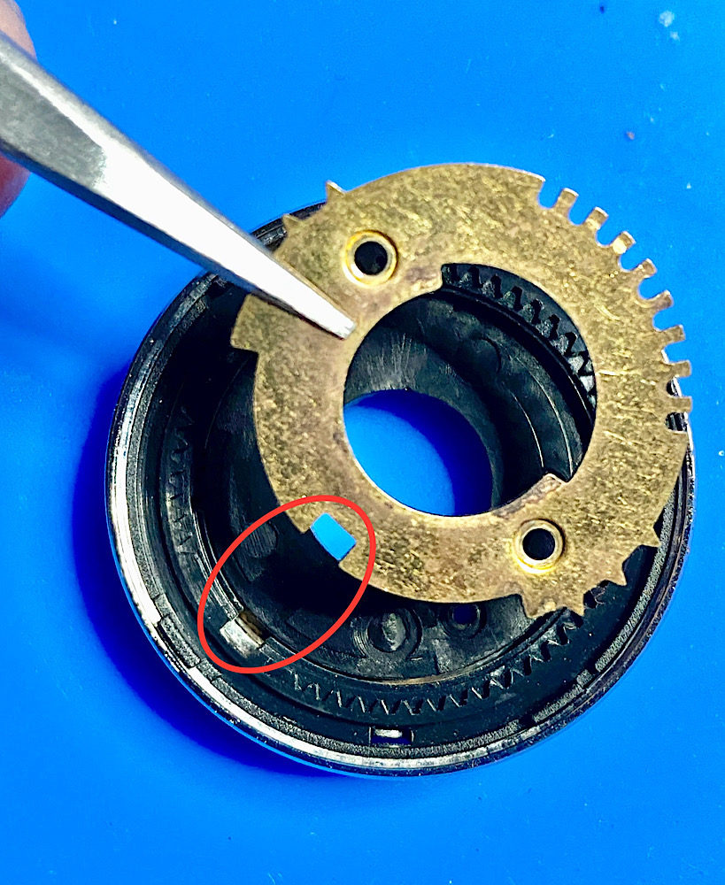

Mini-Tutorial:

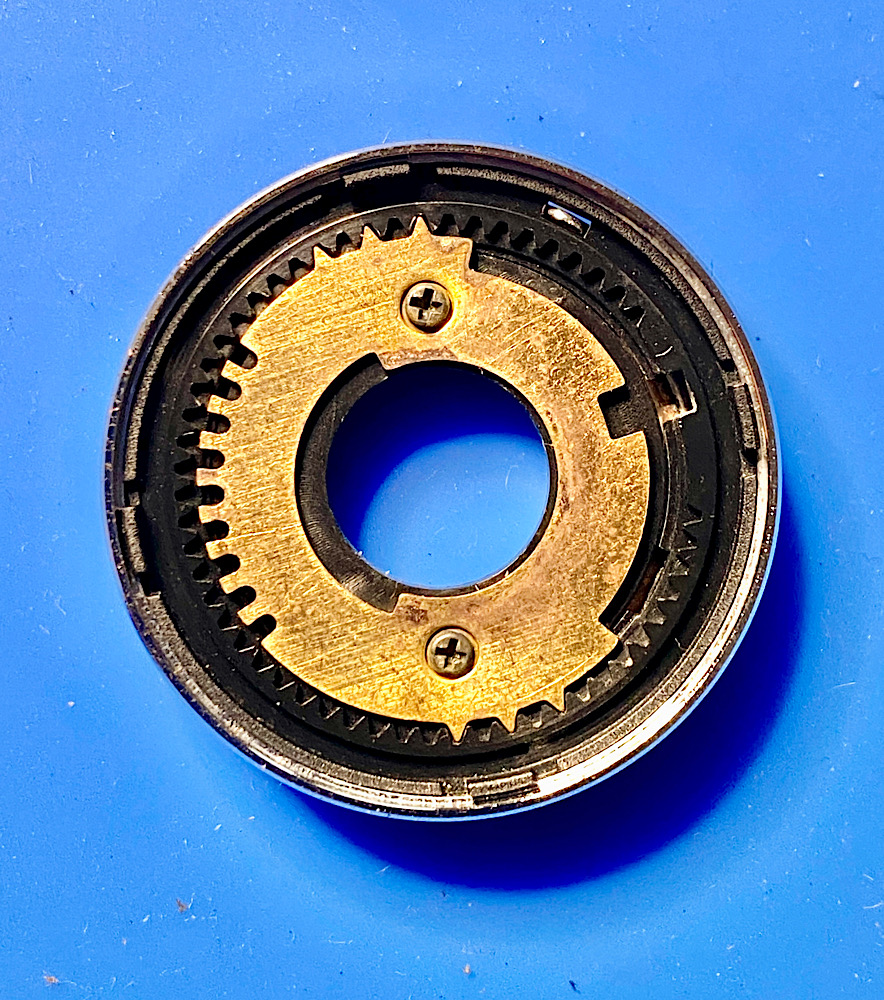

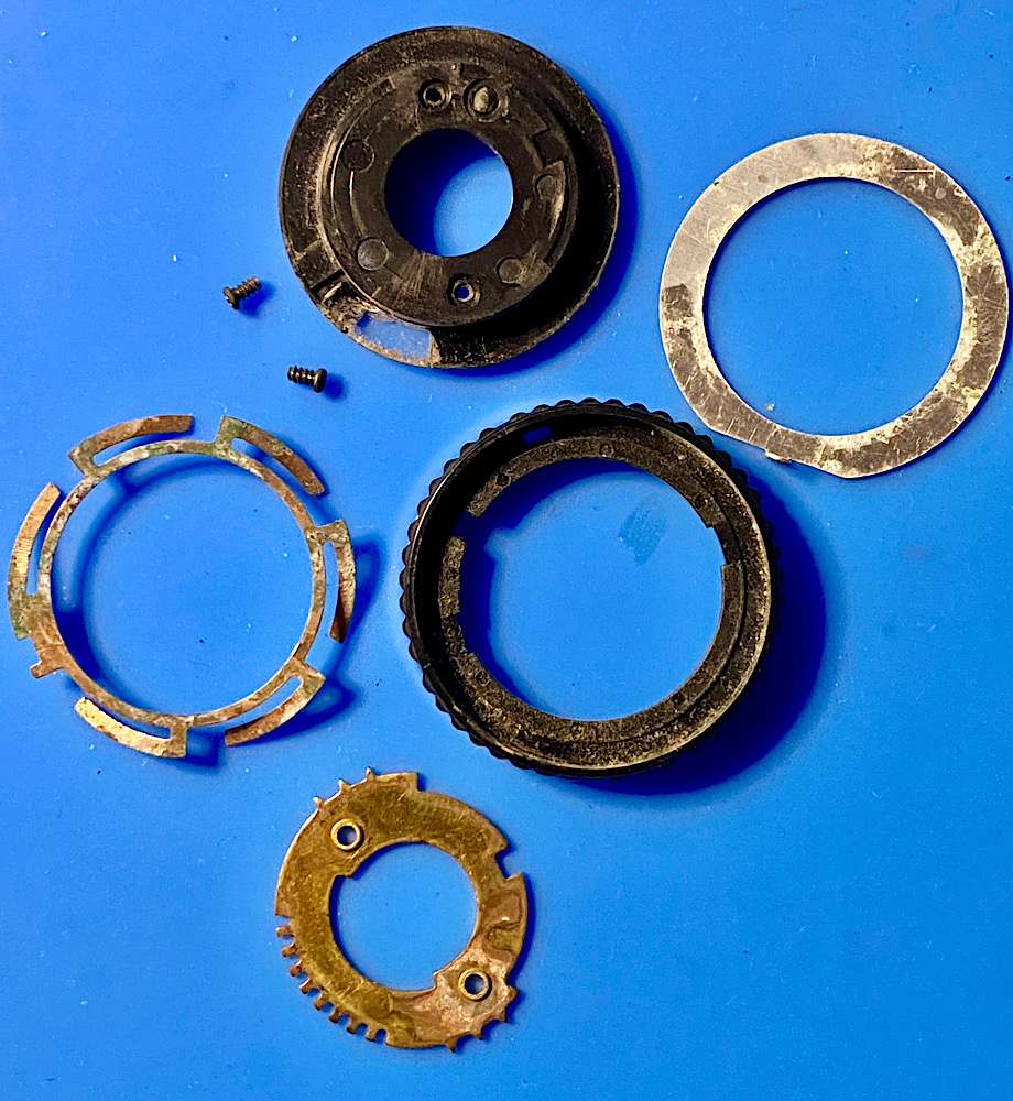

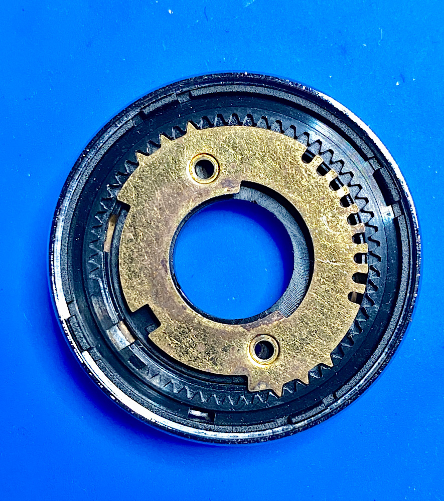

Disassembling/Assembling the ASA/Exposure Compensation Wheel
In order to dry all parts of the wheel, we have to disassemble it. Otherwise the metal parts inside can corrode.
Here is the disassembly process:

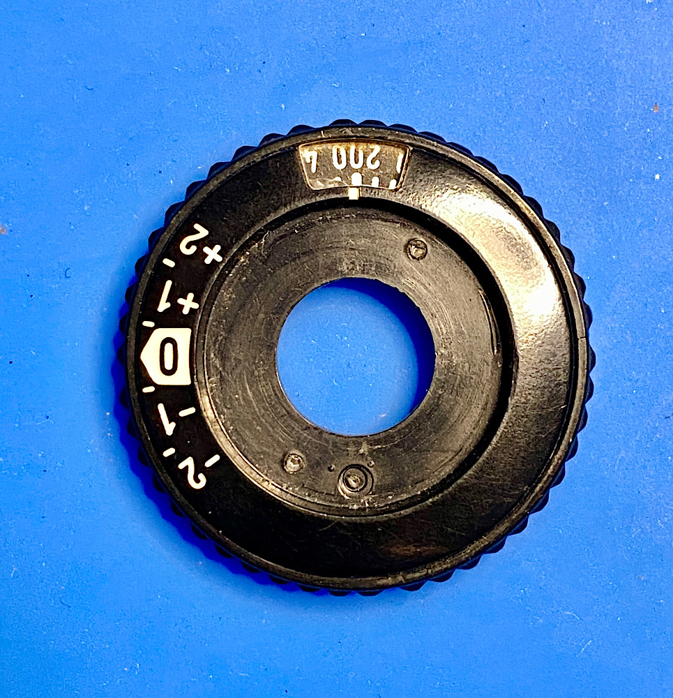

Front and rear view
The spring washer at the top right holds the ASA setting in position. To change it, you have to pull up and turn the outer ring. The spring works against this pull.
This system is also available on other SLRs.

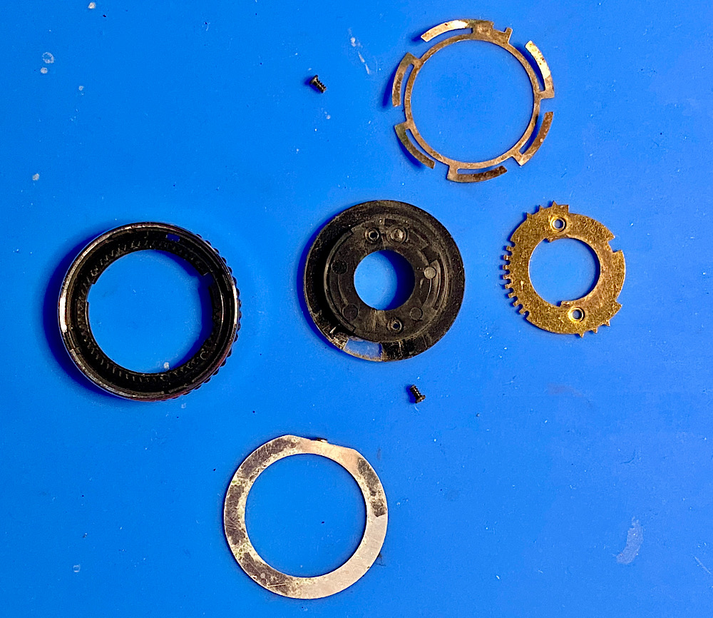

All parts in the rear view …
… and in the front view.
It was good to have the wheel disassembled.
Dirt has accumulated here over the decades and corrosion can also be seen. And the small transparent window for the ASA display also needs cleaning.

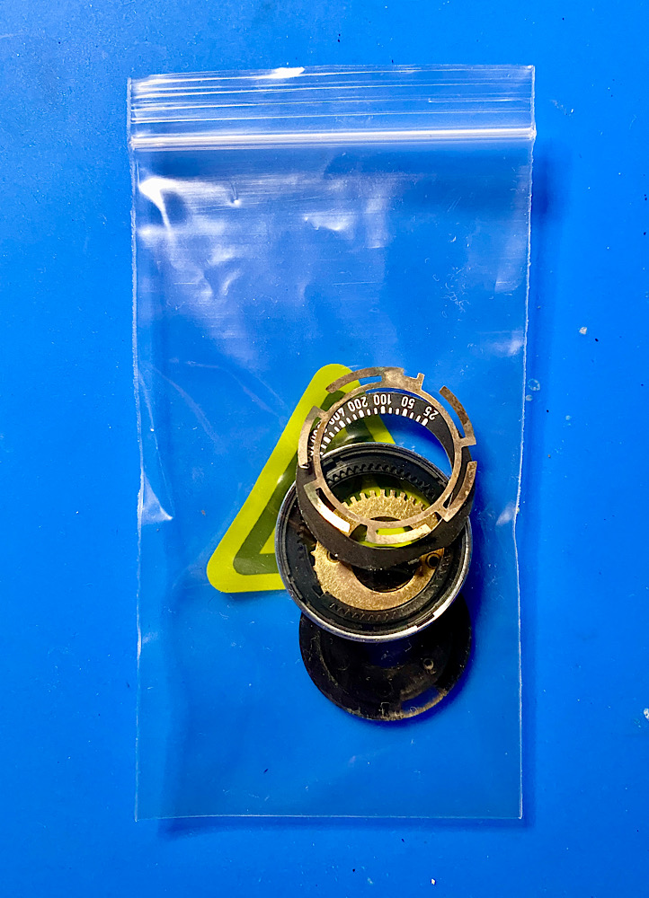

I will clean the parts at the next session.
The parts get their own bag so that nothing gets lost.
A very laborious undertaking, Andreas!
Do you think you can mount every piece togehther sometime?

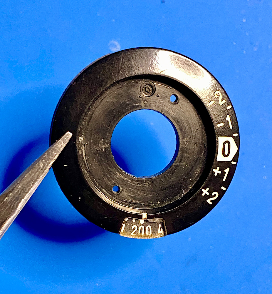

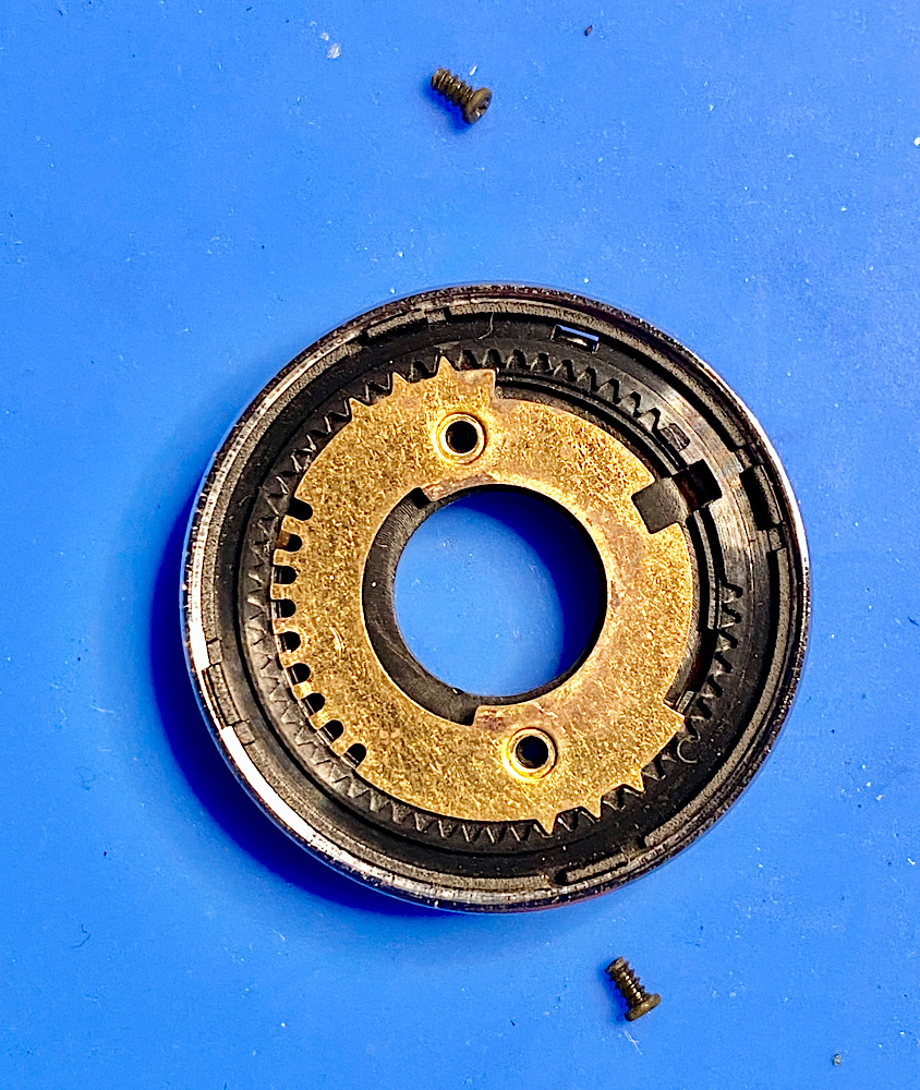

Assembly
The ASA scale is applied to the aluminum ring on the opposite side. For orientation, I rotate it here so that ASA 200 appears.
Here the groove on the spring is where the nipple of the aluminum ring engages.
Here is the next groove where the nipple goes.
These two recesses are aligned with each other. Then the four screw holes are on top of each other.
Both gears only grip in the right position.
The screws are in.
Done

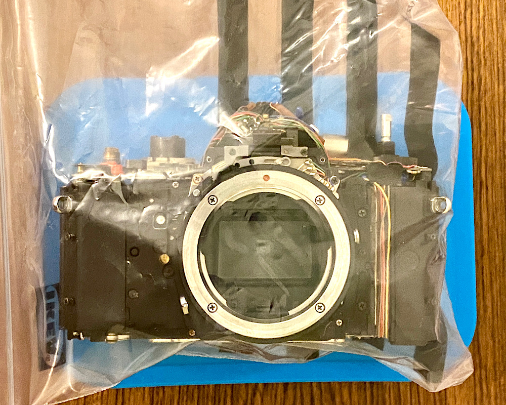

Today I will test whether the camera triggers, this can also be done without assembly.
Was it wise to put the case in the plastic bag without a protective top cover? Electrostatic discharge could damage the ICs on top of the board.
We will see …
Triggering and exposure metering work
Excellent news!
The camera can be wound up and released.
The operating modes P, A and M (program, automatic, manual) are displayed in the viewfinder, the shutter speeds formed are plausible.
This means that the camera is working so far and further work on it is doubly worthwhile.
Because it would have been enough for me to go through the individual steps. But if the X-700 still works, all the better 🙃

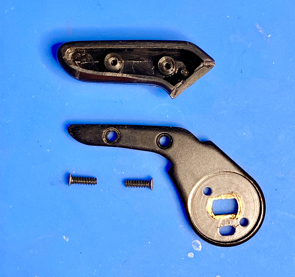

To test the camera, I temporarily replaced the cable on the ASA/Exposure compensation wheel that had come off and attached a complete wheel from an abandoned 700. Also the operating mode selector, the trigger and the winding lever.
The construction is a bit shaky, but it works.
You should remember the position of the operating mode selector before removing it. But the correct position for putting it on can also be determined by trying.
The arrow points to the lock button for operating modes P and A. To release it, simply press it.

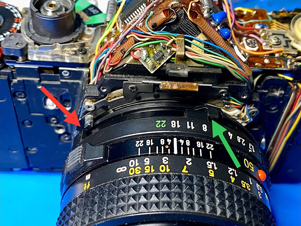

Here you can see the lens/camera couplings that I had previously worked on (cleaning and replacing).
The red arrow points to the clutch for the program automatic. If the aperture ring is turned to the smallest aperture (the green 22), the internal switch closes.
The green arrow points to the aperture simulator clutch. Since all aperture settings are made with the aperture open, the camera is so informed of the set aperture.
Both clutches now work perfectly, and the times displayed in the viewfinder no longer jump around.

On the left is Spudger's brother. For example, you can use it to safely fold up the mirror.

  1. The next step is to dismantle the main switch to clean the contacts (ON/SIGNAL still does not work). Also I'm trying to make the associated switch in the top cover easier to turn. This switch couples with the main switch.
  2. I will also replace the temporary cable on the ASA/Exposure compensation wheel.
