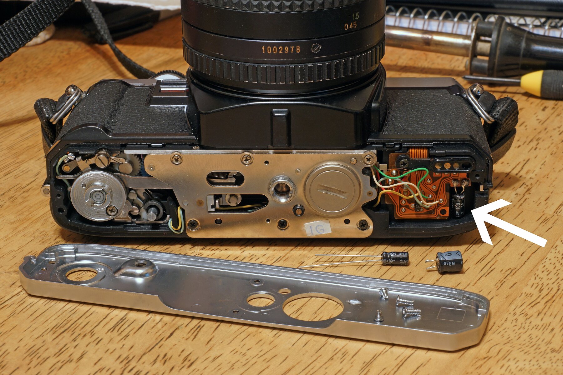

Also had two X370's that both had shutter failures within a few years of purchase. Not a fan of x series Minoltas.
A lot of times those Minolta X-300/X-370 cameras just need a capacitor replaced under the bottom plate. It's a relative easy fix if you have a soldering gun. And here's a good test to see if it's the capacitor that needs replaced or if it's something else. Put fresh batteries in the camera, set the self timer and push the shutter button. If the self timer light flashes for 10 seconds but then the shutter doesn't fire, that means a bad capacitor.
I've fixed a dozen of them or more in my collection. Here's the capacitor that needs replaced. Pictured is a clone of the Minolta X-300, called a Carena DF-300:
