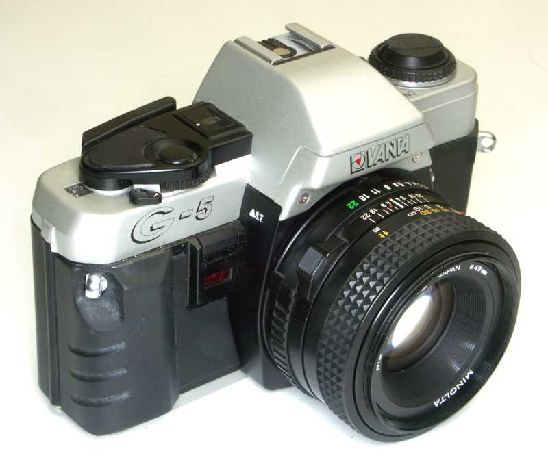

The good news is that there are several POST-Minolta models that were made in China that have shutters that are mechanical -- and some have speeds up to 1/2,000s.

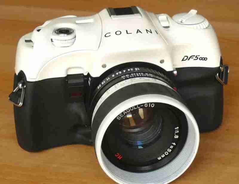

The details are in the link. While there is not a exact Chinese copy of an X-700 with a mechanical shutter, there are copies of the Minolta X-370 with mechanical shutters, and a couple have 1/2,000 of a second. Some of those with mechanical shutters have TTL metering, but they do NOT have auto-exposure.
All totaled, the Chinese camera manufacturers made more SLR models -- with a Minolta lens mount -- than Minolta did. Minolta made many more SLR cameras, but the Chinese made more different models. Some are pretty rare:
