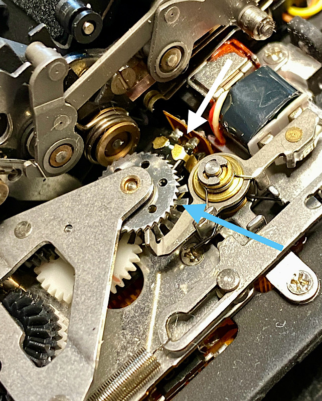

It's not corrosion it's the old 'anisotropic conductive film' breaking down. Isopropyl alcohol doesn't touch it. What worked for me was acetone, but be careful to keep it off the polarizing films on the LCD itself since it dissolves those.
Just saw it in the C & C Troubleshooting Guide for the 7000.
The question is whether I can actually install the solenoids I have seen so far (see picture, please disregard both arrows) and I don't know the electrical values either. But a resistance measurement at the input of the two solenoids should provide clarity.
The input voltage for the solenoids is specified as „B+“ in the C & C Guide, which I read as the operating/battery voltage, i.e. 6 volts for all 7000. If that is the case, the solenoids should definitely be interchangeable as far as the electronics are concerned.
However, the 7000 has a built-in DC/DC converter, which means that a higher input voltage could be present. But that can be measured.
If the replacement magnet doesn't fit here, I may have to replace its mounting plate as well, etc.

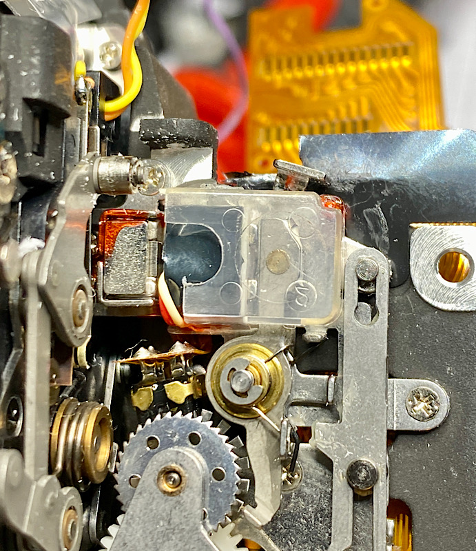

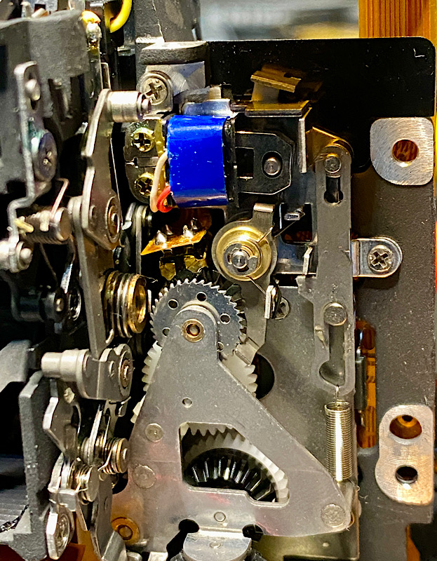

As far as I can tell from my documentation photos, the mounting of the two types of solenoids is different, so an exchange will not be possible (please disregard the arrows):
Type A
Type B
Of the three possible errors mentioned above (diagram), only the third (solenoid stuck) is possible, as the solenoid was working before. Problems with the power supply or coil (continuity/resistance) are therefore ruled out.

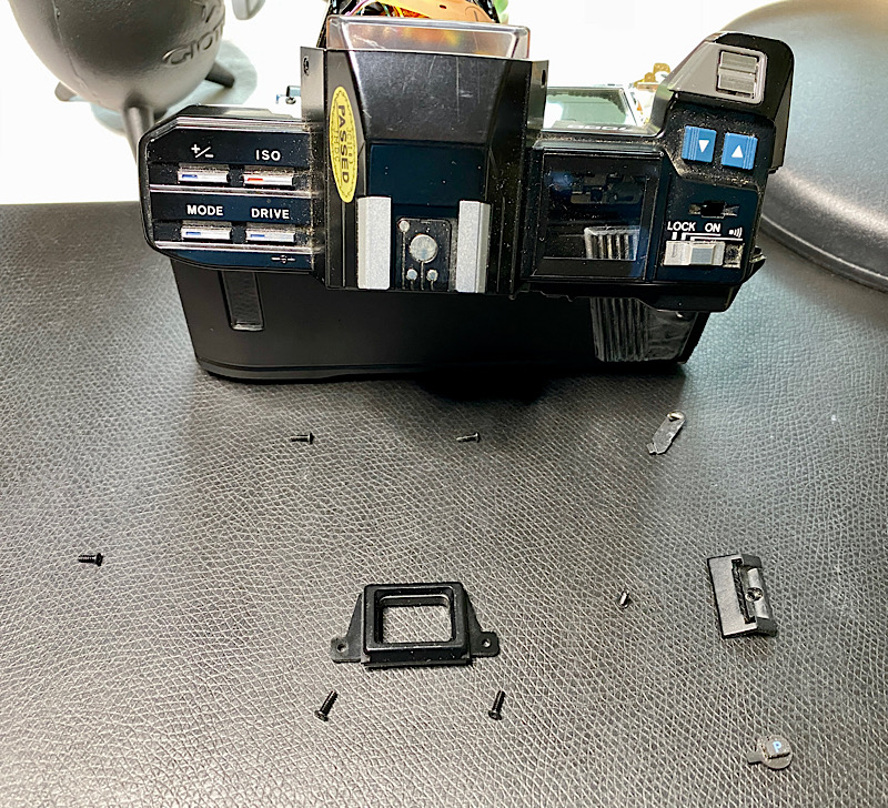

Easy removal of the top cover. Cables to the hot shoe do not have to be desoldered in this case.
This is easy with the 7000, you only need to remove the top cover to have a look.
Solenoid type A with plastic cover and accessible contact surfaces.
Solenoid type B without cover and not accessible contact surfaces.

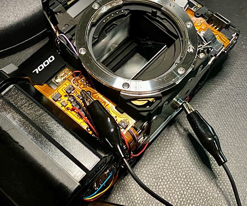

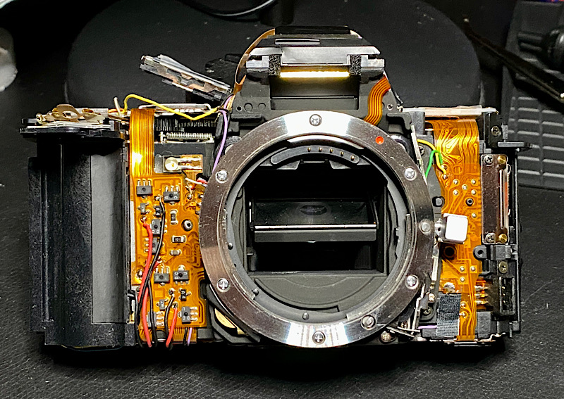

The aperture solenoid connectors are accessible on the circuit board after removing the left front panel.
  • Red arrow: positive connection
  • White arrow: negative connection

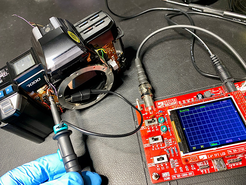

Here I can use the oscilloscope to measure the voltage when the camera is triggered. It is best to use a longer shutter speed, which should produce a clear curve.
When the mirror box is removed, this part of the circuit board remains. To test the solenoid, I only need to unsolder the cables and connect them to an external voltage source with push button.

Since I assume that the contact surfaces are contaminated, I remove the mirror box so that I can clean the solenoid.
First, I use the oscilloscope to measure the voltage on the positive contact of the solenoid against ground (bayonet ring), and then supply the solenoid with voltage via my laboratory power supply. The battery holder is then no longer connected to the mirror box.
6 volts DC against ground are present at the contact of the red cable, i.e. the full operating voltage (4 x AA).
This voltage is also present at the second contact of the solenoid (white cable). This means that current flows through the solenoid when the white wire is closed to ground.

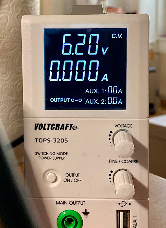

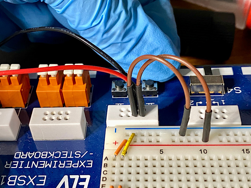

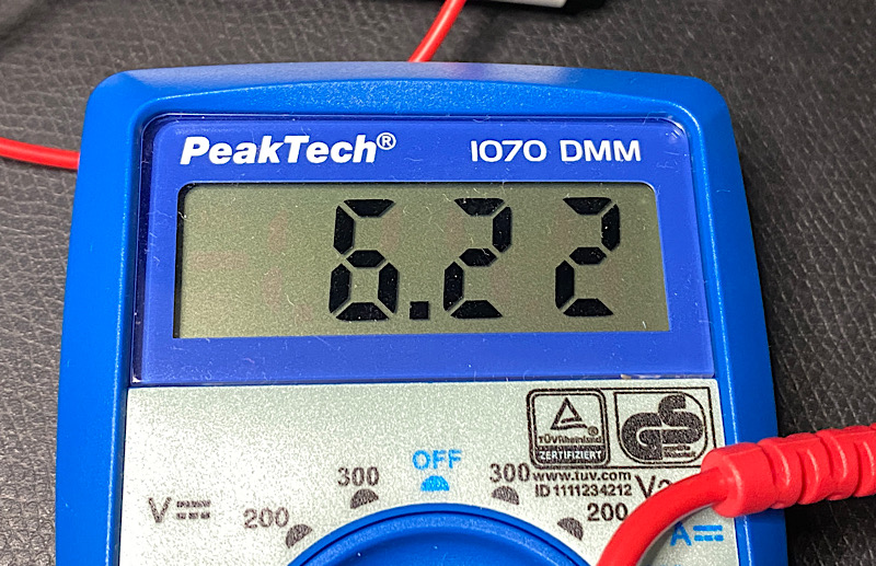

The setup with the laboratory power supply. There is a push button on my experiment board with which I can trigger the solenoid when it is connected.
6.22 volt output voltage is available.
The mirror box is removed and the solenoid is connected to the laboratory power supply.
After a few activations of the button, the solenoid is triggered and the armature swings to the right with a quiet click.
From this I conclude that the solenoid is disconnecting unreliably due to contamination. I clean all contact surfaces with surgical spirit.
The solenoid is now separating properly.
I leave the mirror box removed and test it a few times to make sure that the solenoid remains in this good condition.
