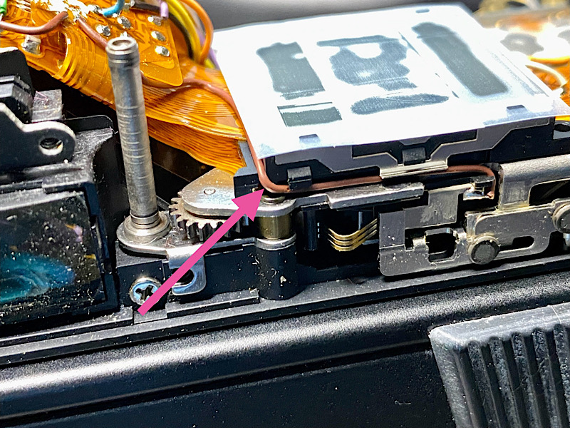

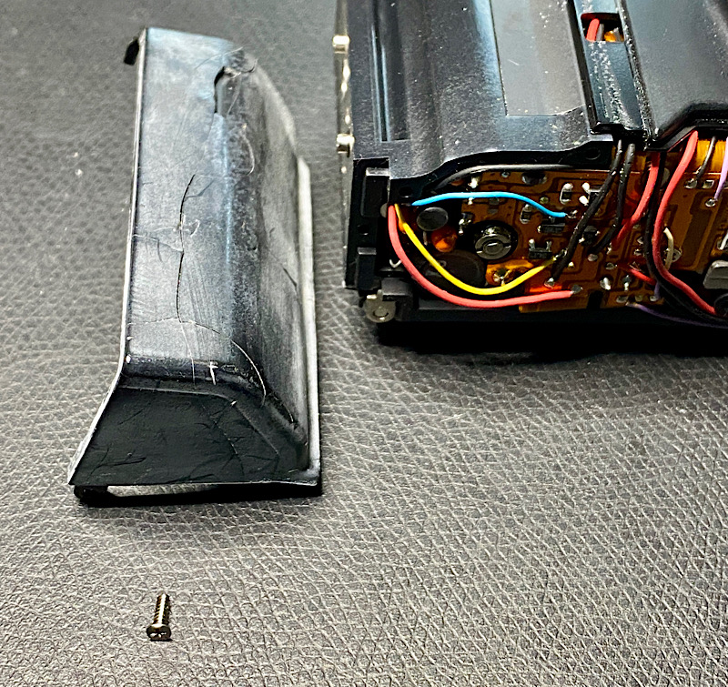

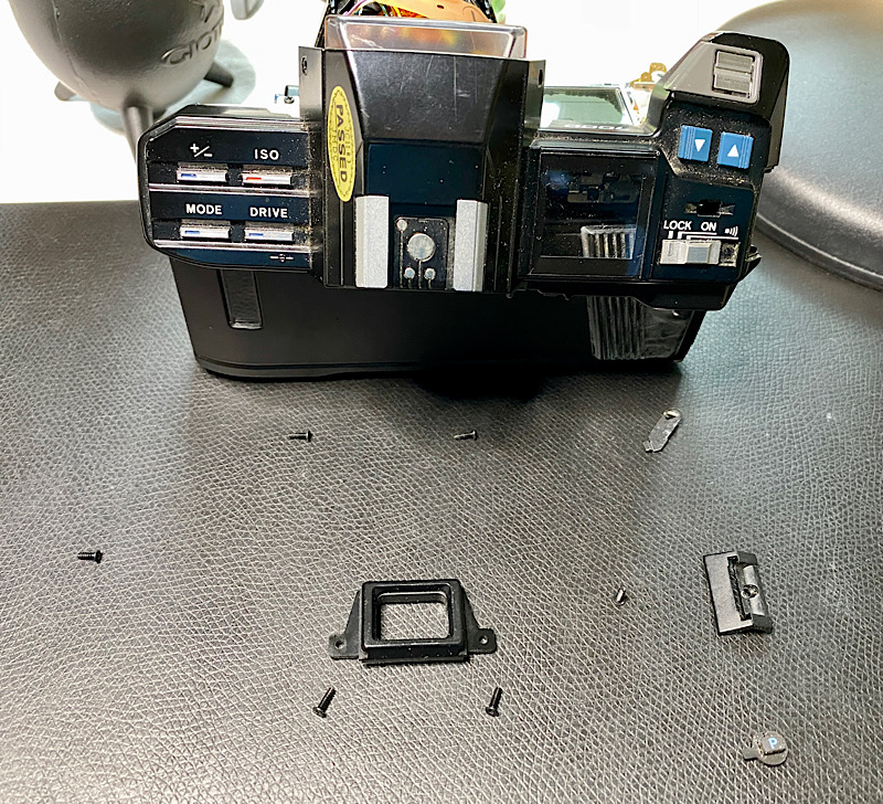

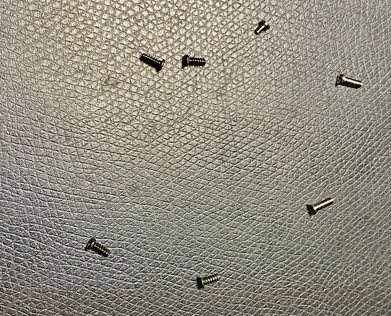

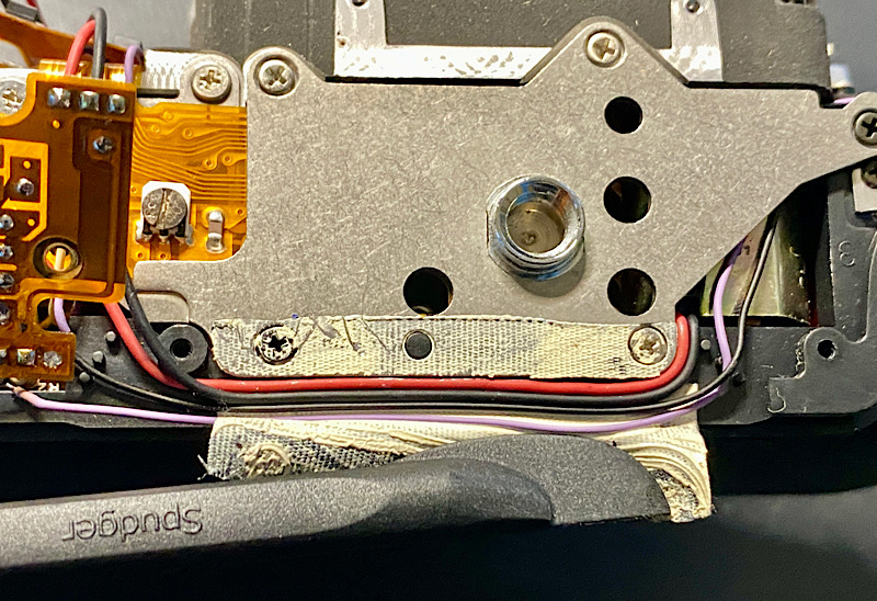

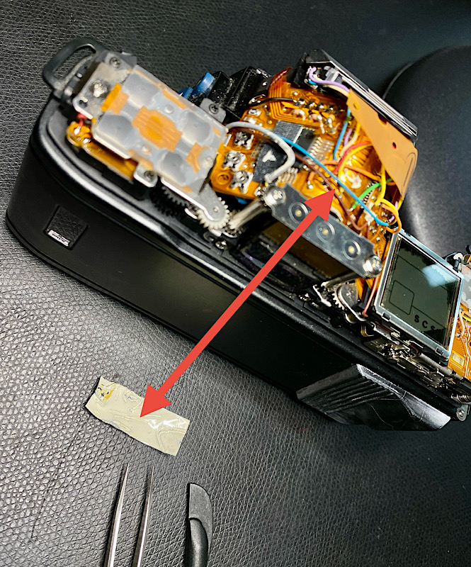

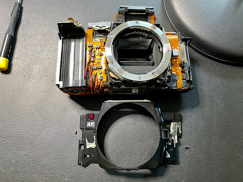

Removal bottom plate, handgrip assembly, top cover and front plate

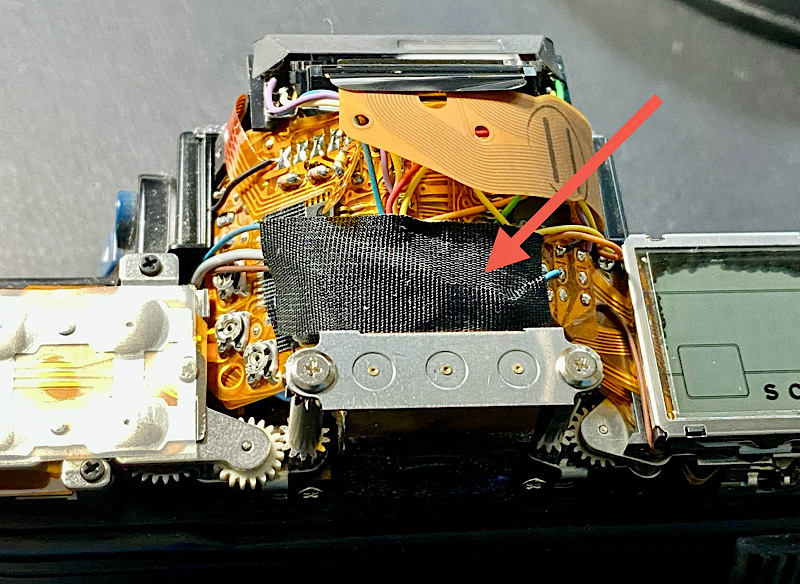

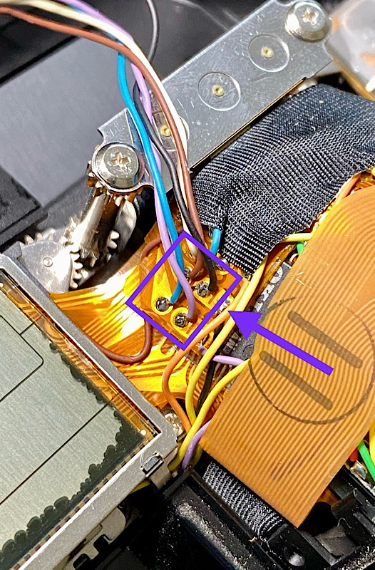

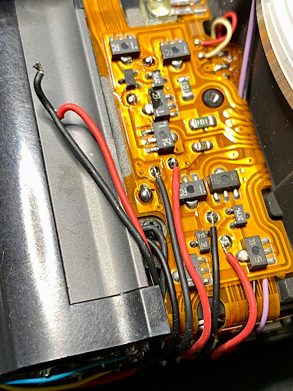

Unsolder hot-shoe wires blue, violet, white, brown, black.

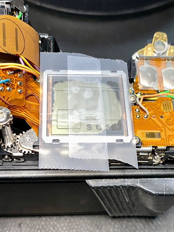

Protect LCD from scratches or solder with tape.
Interim conclusion
  • With the step-by-step instructions in the SPT Journal and the exploded drawings in the service manual, disassembly was problem-free.
  • The adhesive tape on the prism must be carefully removed so as not to damage the soldering points of the cables on the circuit board.
  • The front decorator panels are attached to the front plate with double-sided adhesive tape. They can be carefully pried off.

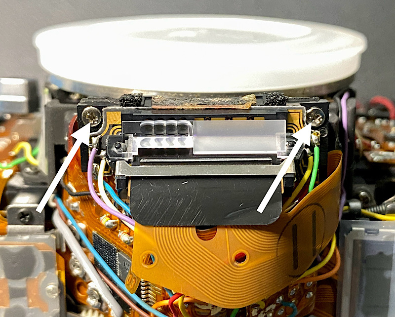

Further disassembly steps

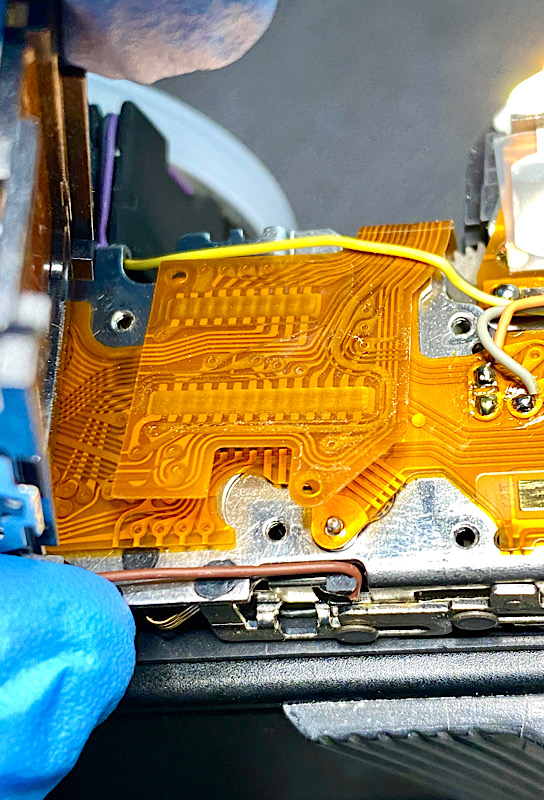

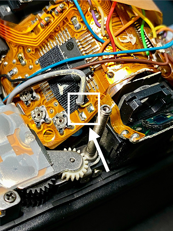

The LCD is folded towards the prism, pay attention to this cable.
The two flexible circuit board parts are held in position by two pins and are now separated.

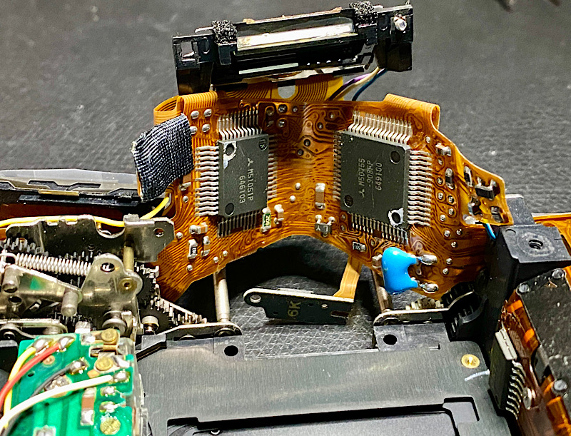

Desolder

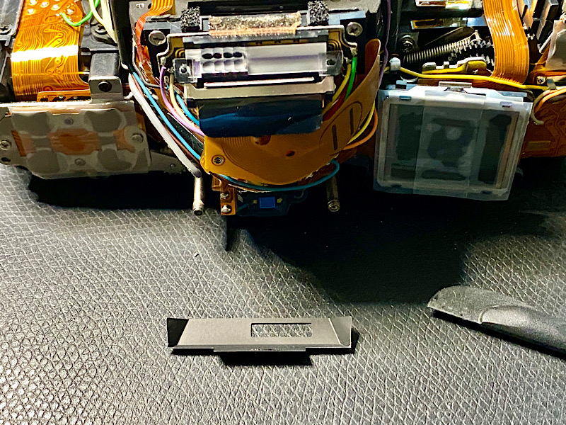

The light-shield plate for the finder LCD is held by double-sided tape. Be careful to avoid distorting the plate.
Desoldering with desoldering braid.
Desolder
Desolder

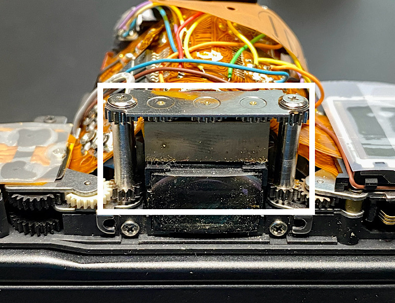

Fixing the camera in a grounded vice for soldering work on the bottom of the housing.
Desolder

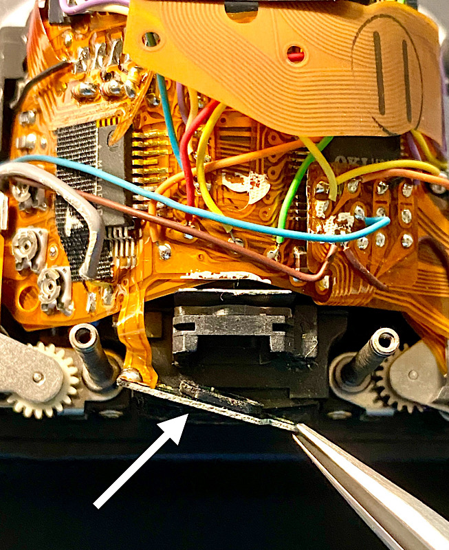

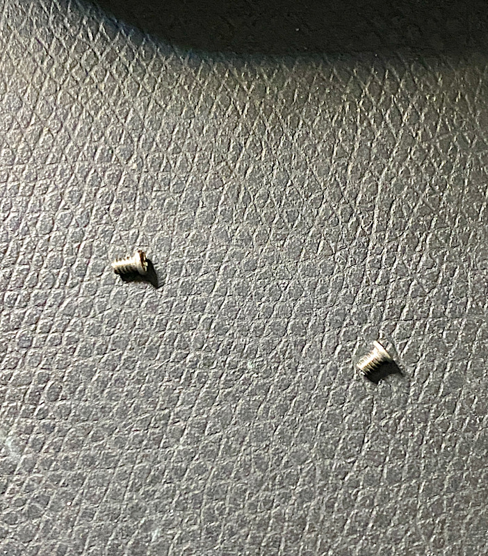

Loosen this screw.
Exposing the cables.
Desolder …
… this makes the mirror box mounting screw accessible.

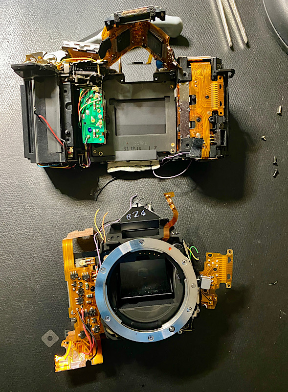

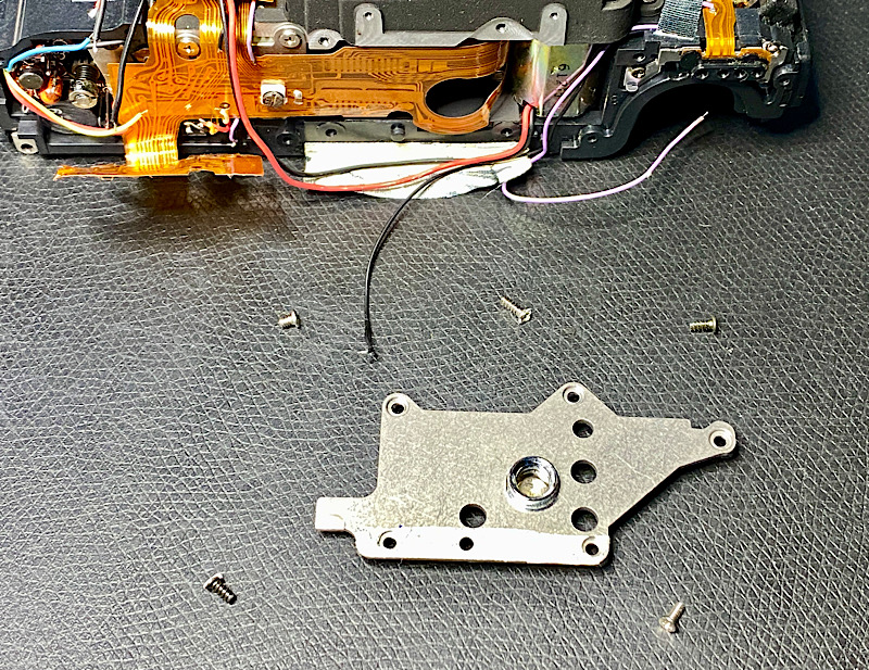

Done!
The mirror box is removed.
The mounting screws for the mirror box.
Electronic shutter control with magnets.
Shutter made by Copal.
The goal of the journey: the switching magnet for the aperture control.
The contact surfaces of the magnet are accessible after removing the cover. Cleaning them should solve the problem with the aperture, which always closes to the smallest setting.
