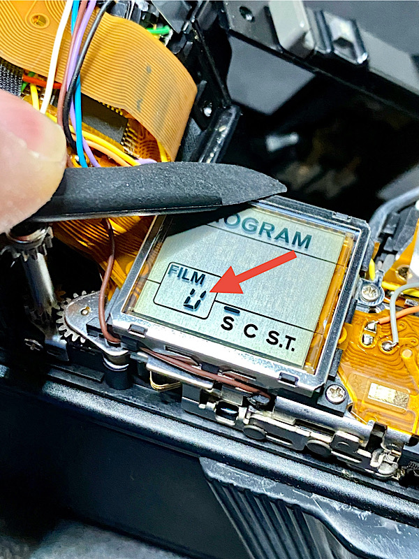

Replacing the main LCD on the top side of the camera - test run
The main LCD on the Minolta 7000 AF tends to bleed, black spots appear on the edges, but the display is usually still legible.
Since I have a spare 7000 whose main LCD is still intact, I would like to use it to replace the LCD on my work camera.
Before that, I will look at removing it from another spare 7000 as a test run.

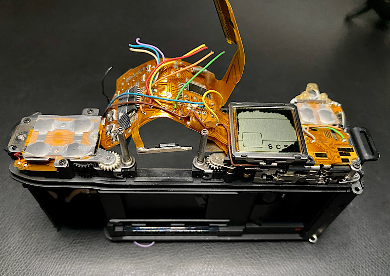

The main LCD on a partially dismantled 7000.
The LCD is fixed by a silver retaining clip that is locked in place by two latches.
A latch is levered out with tweezers or a small flat-head screwdriver and the clip can be removed.
Now you can see the two zebra conductive rubber strips on which the LCD rests and is electrically connected to the circuit board underneath.
The board with the LCD can be lifted …
… and the holder underneath can be removed.

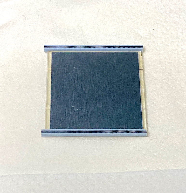

The LCD and circuit board are held together by the conductive rubber strips. I carefully pulled the flexible circuit board off the LCD. The conductive rubber strips remain on the LCD.
The circuit board with the two rows of contacts for the LCD.
The LCD with the conductive rubber strips from the front and back.
Removal instructions in the Service Manual on page 147 (PDF).
Now it is also clear that the complete LCD unit cannot be separated from the camera with a connection to the board. The plate with the LCD contacts is part of the circuit board and cannot be removed as part.

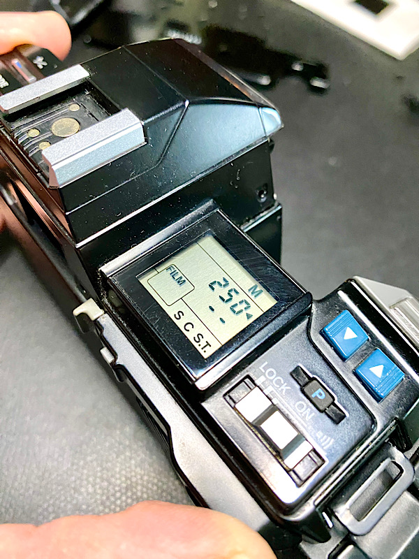

Done
The replacement LCD is on board.
First test with top cover and battery compartment attached: the LCD works.
The display is incorrect here, it should be zero. When you press on different parts of the display, the display changes.
This is obviously a contact error, which then occurs when you put the top cover back on because it presses on the LCD.
Cleaning the contacts on the board and the two conductive rubbers with isopropyl alcohol does not solve the problem. But the treatment does no harm in terms of the best possible conductivity.
Only after I put on the silver retaining clip for the display from the spare parts 7000 did the display work correctly and remain stable even after putting on the top cover.
Apparently, after removal, the clip was no longer able to hold the LCD in place evenly due to a slight deformation. This probably happened when it was pried off.
In any case, no deformation can be seen.
Mission accomplished šŸ

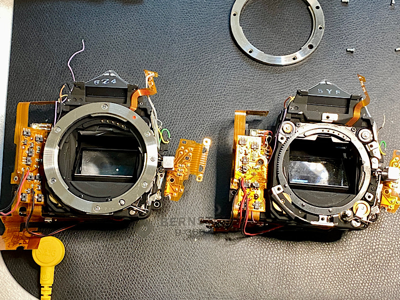

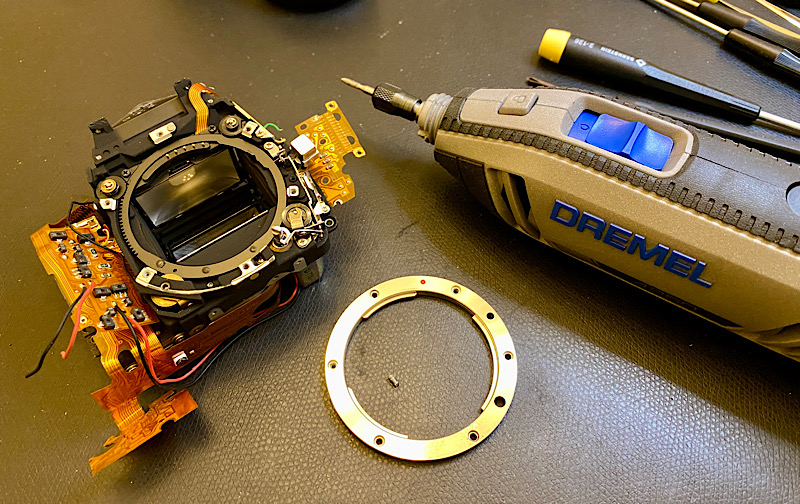

Since my diagnosis was a problem with the aperture control (encoder), I removed the mirror box to have a look.
I have already reported on the removal of the mirror box in the thread, so I will only show some impressions of today’s project here.
The 7000 has a lot of cable connections that need to be desoldered when disassembling.
To distinguish cables of the same color, I mark them with black and white paint.
The DC/DC converter, which has its own circuit board one floor below.
The mirror box has been removed.

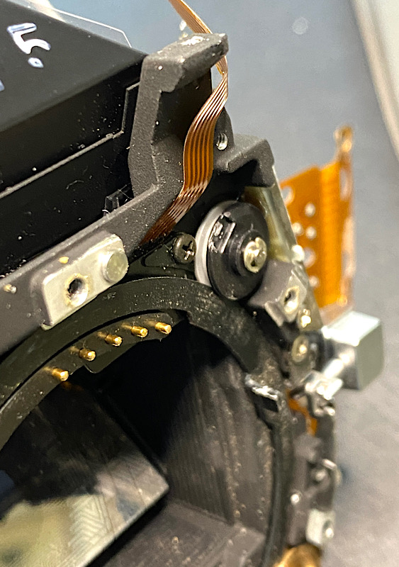

I compare the aperture control on the back of the front panel with the aperture control of a 7000 that has already been disassembled. I can’t see any differences, and both mechanisms move the same.
So I continue to troubleshoot.

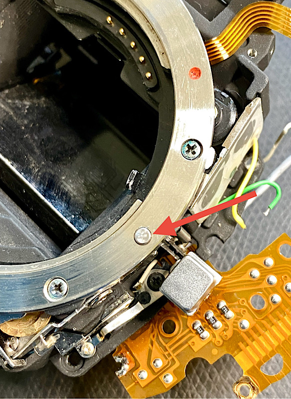

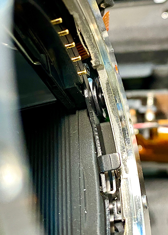

And I find something under the bayonet.

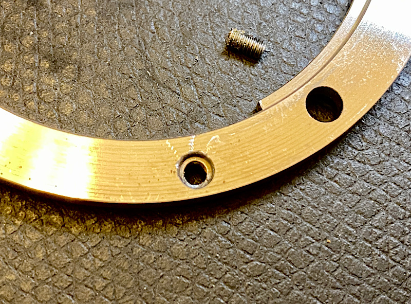

The aperture ring, which rotates in the bayonet, has jumped off its upper right roller (red arrow). The aperture coupling is also bent (blue arrow).
For comparison, here is an intact aperture ring sitting in its roller.
The lens has obviously been removed from the camera by force, perhaps to release a blockage, I don’t know.
After removing the bayonet, the aperture ring can be clicked into its roller.
Here is the roller that has no drive.
The two rollers opposite have gears that engage the aperture ring and drive it.
To solve this problem, I didn't have to remove the mirror box. But I didn't know that beforehand.

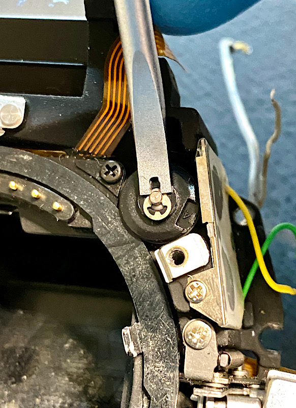

The mechanism for the locking pin in the bayonet that fixes the lens is a bit of a game of patience.
Succeeded

Squashed cables
Since I have no indication that this 7000 has been opened before, I was surprised to see several squashed cables.
This is generally problematic because it can lead to line faults or short circuits if the insulation over the cable core is damaged.
Here I have insulated a cable with an exposed core using heat shrink tubing.
When troubleshooting, I recommend keeping an eye on the numerous cable connections.
Easily breaking fixation point
The mirror box snaps into place on the left side of the housing using a plastic pin that breaks easily. I have glued the pin back in place using Loctite.
You should be careful when lifting out the mirror box.
Milling out a screw head with the Dremel has proven itself again
On my spare parts 7000 I was unable to remove a glued screw in the bayonet.
Milling out the screw head was possible with almost no damage to the bayonet. I used a diamond cutter on the Dremel.
The scratches caused by slipping were caused by inattention and could have been avoided.
I used the Engineer PZ-57 pliers (Nejisaurus) to unscrew the rest of the screw from the bayonet support.
