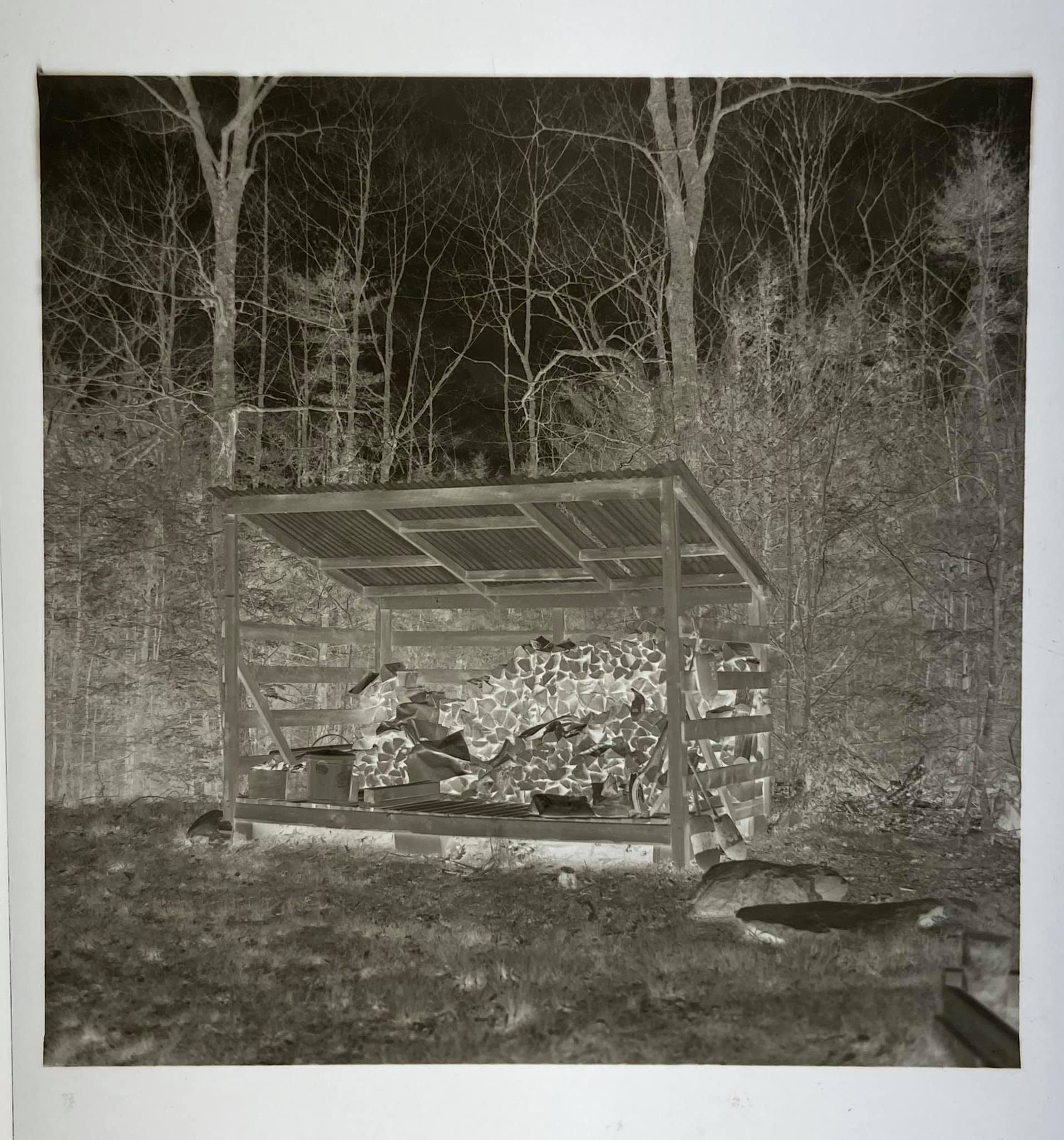

So for Catlabs X 80 I've settled on 32 ISO. I'm doing 510 Pyro at 14 minutes, 20C, 5 seconds of inversion every minute. It seems like I keep screwing up my full H+D curves but the negatives I process look great.
