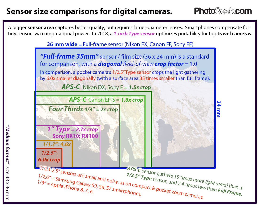

OK what about the ability of micro four thirds now? AS mentioned forget the Megapixels - you have to regard the space of sensor in comparison of full frame sensors!
(C) Photoseek.com
And (sorry to tell) mirco four thirds is not a very good option - but of course it is better than
an IPhone (look who is last and you know who is worse)
