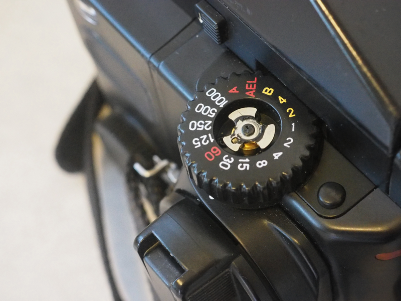

Micro 4/3 sensor, kit zoom at maximum length of 42mm, f/8, ISO 8000.
Handheld too!

Nice! Does it work that well at the focal length that is the 50mm equivalent for full frame? ... is that 25mm? I guess that is my real question. At equivalent focal lengths, do they have to have wider apertures for the same bokeh?
Also, is micro 4/3 the same size sensor as a point and shoot? I have an old Panasonic LX7 - is that the same? I've been seeing a lot about micro four thirds, and I am not sure I understand where they fit in the camera ecosystem.
I guess I could just stop being lazy and ask Google.

For depth of field questions, the 25mm setting on the zoom will give the same field of view as a 4/3 crop of a 50mm lens on 135 film, but the same depth of field as a 4/3 crop of a 25mm lens on 135 film.
So to get shallower depth of field, use a bigger aperture.
I relatively infrequently use shallow depth of field for effect, so I wasn't able to quickly find an example in my stuff of a digital shot that uses it with a more typical subject to camera distance. If I was doing it for effect, I probably would pop a 50mm f/1.4 OM lens on the camera, via an OM to M4/3 adapter. That would give me the same field of view as a 4/3 crop of a 100mm lens on 135 film, along with the same depth of field as a 4/3 crop of a 100mm lens set to f/2.8 on 135 film
