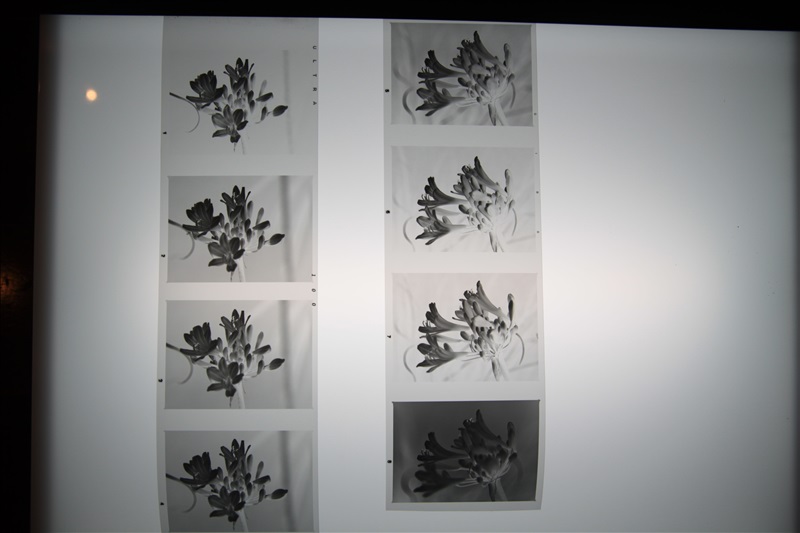

I shot a whole roll to try this, and what I did was measured the ambient using 1/60 as my base, and then dropped 4 stops. IIRC, the base was f/8 or f/11. I didn't want to go to f/32 on the lens, so I went to f/22, and then compensated with my flash output, using the flash meter to get the reading to f/22 and whatever shutter it said. I also played around with different apertures and flash settings, but got the best results (the two pictured) by doing the above.
So it looks like to get the black background, the steps are:
1) meter ambient at sync speed
2) drop 4-5 stops via aperture
3) adjust flash power to give you a flash meter reading of the f/stop selected
4) take picture
Yep. Sync speed is the hard limit. Certain cameras will allow high speed sync mode but even there the same pattern remains.
Yes, if 1/60 at f/8 was the base measurement then the theory dictates you should have used 1/60 at f/32 to get black, f/22 allowed "too much" exposure on the back ground. This assumes a fixed film speed, a straight to positive situation. Instax film or slides for example.
I'm going to assume you are shooting negatives for a moment. My fix for this situation is to change my EI. This can be done two ways: the first is a less sensitive film (Tmax 100 instead of Tri-X); the second is to use the films latitude and set the black point when printing.
The second method simply requires resetting your meters ISO setting. You still use TriX you just shoot as if you are using Tmax 100. Doing this changes the base to 1/60 at f/4 and the camera setting becomes f/16. The flash is set using ISO 100 at f/16.
The difference on the film (either switching films or EI change) is that the background is separated further from the main subject so in the print if you place the main subject properly, the background is darker.
The thing that people have a hard time getting here, because it is counter intuitive, is that more camera exposure allows you to get better blacks in the print. The relative distance between tones is what matters, the absolute exposure is (to a point) irrelevant.

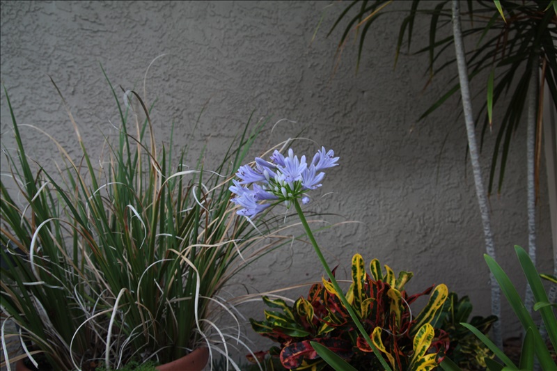

True, an under-exposed negative (as cuthbert is doing) isn't going to give the results I was going for. Just dropping the exposure values for the background so they go dark (ie, Zone I or II) under-exposes the subject, unless it's in zone VIII or IX (I think).
What I'm going for, and have achieved is learning the basic 'formula' for getting a truly black background. Drop 4 stops from metered ambient, and bring the subject back to Zone V with lighting. I have no darkroom, other than digital, so I prefer to do it all (or as much as possible) in camera.

Just for my own understanding.........how are you metering?
What I did was metered the ambient at my sync speed (1/60 on this camera), then set the aperture on the lens 4 stops under the ambient. So if the meter said 1/60 & f/5.6, I set the aperture on the lens to 4 stops under, or to f/22. Then I took a separate flash reading, and adjusted my flash output until it read f/22 at 1/60. Metering for the flash is done with the lumisphere (white dome) up, and aimed at the camera, held at the subject. So what you have done is set the background, which is being lit by the ambient light, to 4 stops under, rendering it (pretty close to) black. At the same time, the flash is giving you the 'proper' exposure on the subject.
This is how I did it for both of the shots above. Ironically, they were both the first shot taken at those angles. After the first show, I played around with different settings, just to see what would come out. These were the only two that gave me what I was going for.

The first shot you posted had close to the look I was going for; very dark background, with good light on the subject. The rest of the shots you posted, while very nice shots, did not give that look. The first shot's natural background was probably very dark, so metering on the flower, and not the whole scene, gave you that dark background. But if you look at the peachy rose shot, the background is very much there. Because of the lighter color of the background, it shows up pretty clearly in that shot (not talking about the bokeh, just saying how you can see stuff in the background).
In my shots, the background is a light tan (the side of my house), and the flower is a cornflower blue color. Not much difference in luminescence between my flower and background.
Between what each us were doing, we had very different goals. I'm not concerned at all in this situation with 'blowing out' the background by use of aperture blur/depth of field/bokeh, but trying to eliminate the background so it's just not there. In your step by step post, step "4) Shoot at wide aperture to bokeh the background" is a different approach for a different end result. Using a wide aperture is not going to darken a background (wide aperture brings in more light). Although your step "3) A spotmeter (alternatively underexpose)" is similar in that I'm underexposing only the background completely to black, and lighting the foreground subject with flash to bring it to the proper exposure. A spot meter on just the flower may get you close, but it still results in a different look.
There's nothing wrong with what you or I are doing, we're just using different methods to get different results.

I really don't think you're understanding what my initial post was about. I don't want a visible background to any degree. You're first image came close, and was similar to some of my test shots, but any high contrast scene will give you those results no matter how you frame, meter, or expose. Your last 3 photos are completely unrelated to what I'm going for, and IMO, by posting those as representations of black backgrounds, really makes me think you were not getting the point of the thread.
If you spot meter any subject that is naturally lighter then the background, you will get a much darker background, only because your meter is bringing what it metered (the lighter colored subject) down to Zone V, which would drop a darker background down into Zones I-IV, so it will of course be much darker then the subject.
What I'm trying to do for example, is take a white background, with a dark foreground subject, and turn the white background black, while exposing for the dark subject properly. Unless I'm mistaken, there is no possible way to do that without artificial light over-powering the ambient light.
