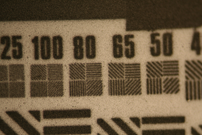

My photomicrograph of the negative of a resolution chart photographed at f8 from the correct distance on 100 T-max film developed in Xtol 1+0 supports the contention that 100 line-pairs/mm is obtainable,even with the relatively inexpensive Canon ef 50 mm f 1.8 used.This corresponds to about 35 m-pixels for 35mm with this film.It may be that more expensive lenses would do better.
