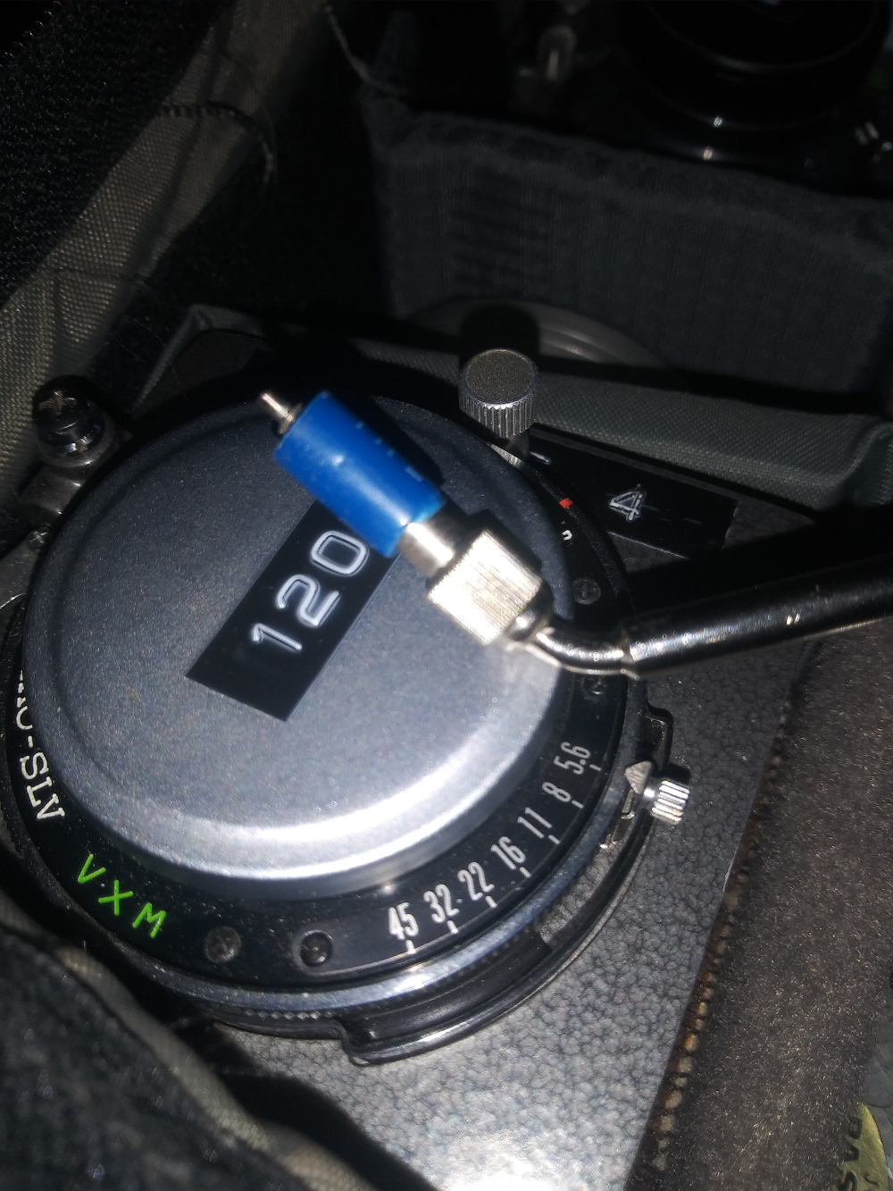

This is how I first did a work around before I found real horseman cables. I started with a Hasselblad angle adapter because I had one and pushed a short piece of 1/4" air brake tubing on the Hasselblad adapter, it pushes firmly and then any cable release now works. I used the Hasselblad adapter because it has a straight shank. You can get air brake tubing at most real parts stores or a truck repair shop. It is real cheap so most places will give you a foot for free. They even have it in different colors like red, yellow and black.
