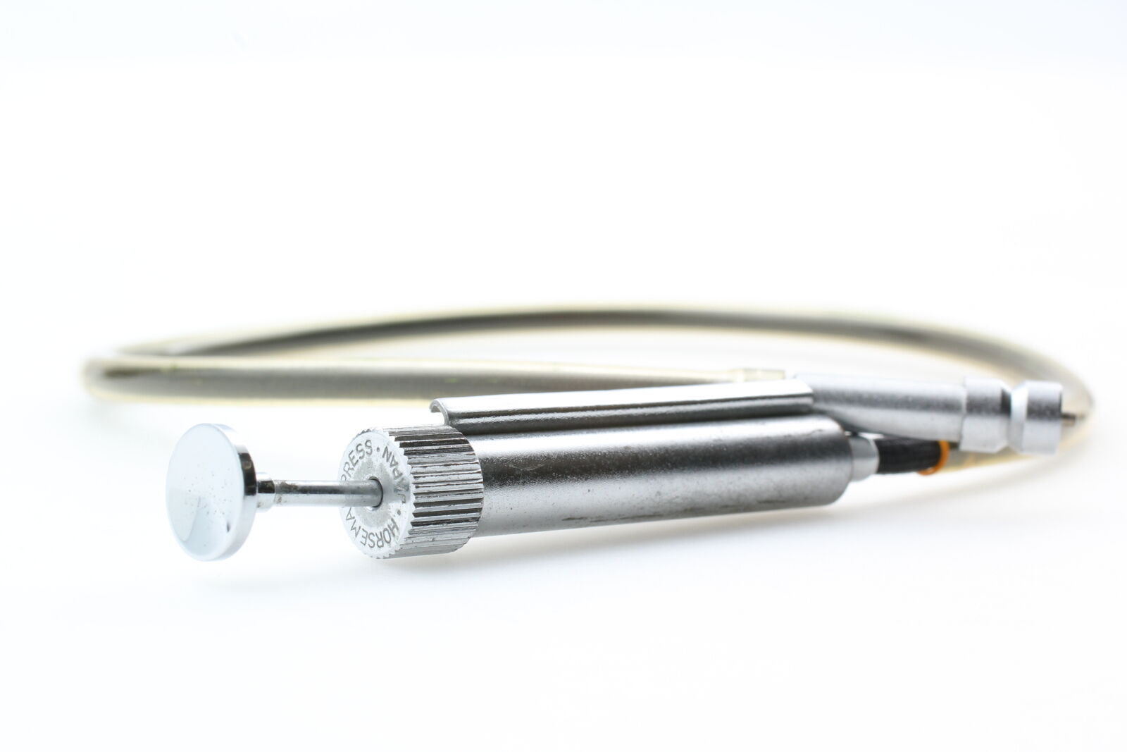

Thanks. What do you mean about the horseman specific cable release attachement? I cant use a regular release cabel?
Horseman lens boards need a release with a cylindrical tip. You can get releases with the tip built in, or you can get an adapter that attached to a regular release, so you can use that.
Here is an image that shows a release that already has the correct tip:

The item I linked above has another benefit. In addition to having the correct end for the Horseman lens boards (prior to the ER lenses which have an electric solenoid), that cable release has a rectangular slot at the plunger end that allows you to mount it to the camera and press with your thumb while handholding:
The sellers on eBay are overpricing it ($100 +$30 shipping) but if you can find one for a reasonable price--I paid $60 all in--its not bad

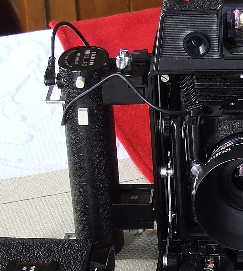

Personally I thought the cable release caused blurry pictures so I use the solenoid and smooth and soft electric switch.
The circular button is ON/OFF and the rectangular button is the shutter release.

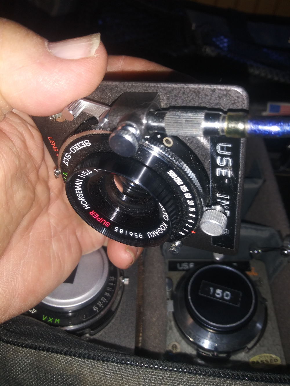

But you don't need it. The socket is threaded in the bottom. It is nice to have though because it is faster to change lenses. I have attached pictures of 2 of my lenses, one is from the 900 series and the other is from the ER series. Both have a thread for standard cable releases, that is what is in the pictures.
