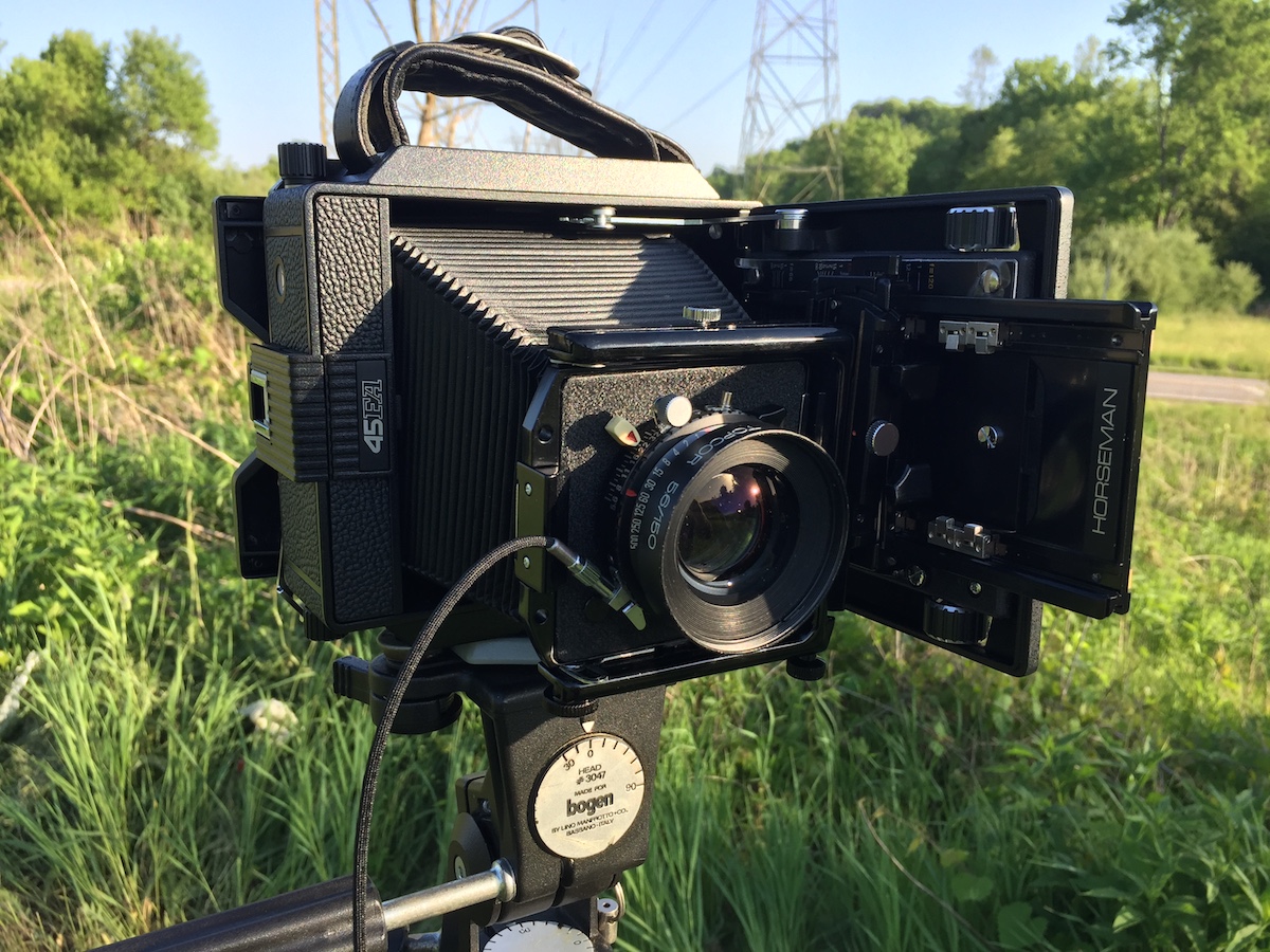

The Horseman technical cameras are pretty versatile if you know all the tricks. For example the tripod mount on the side allows front drop.
An advantage over a monorail is the ability to hand-hold with the coupled rangefinder.
This shows the 4x5" camera, but the medium format camera has the exact same front standard. In addition to the rangefinder (on some models) the medium format camera actually has a light-sealing rotating back, unlike the 4x5 camera; you can rotate it without a dark slide.
